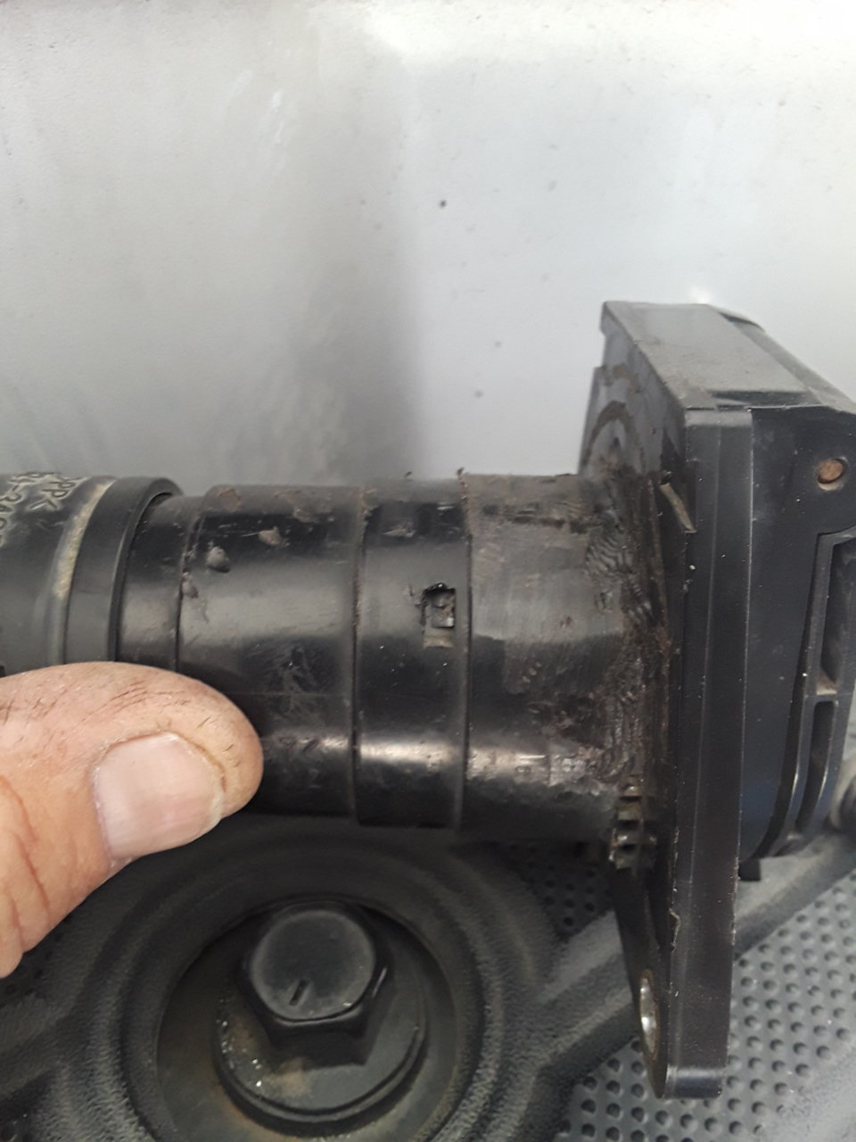

    Ok, the first thing is to remove the plug and bracket from bumper, keep the 2 ten mm bolts.
    Then u have to mark where the wires go into the plug for a reference later.
    Then unpin the wires from the plug, first u have to remove the inner plug by un clipping it and it pulls out, then u can unpin the wires.

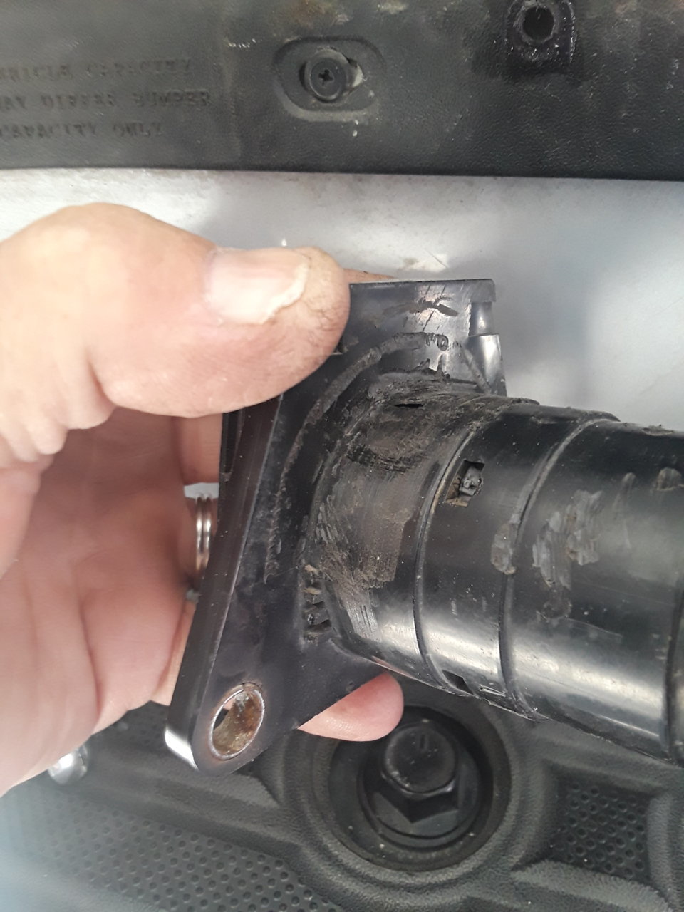

    Once the wires are off, take the plastic housing and cut off all appendages to make it round. There was some small ones I left for orientation but could do without, would be much easyer, I used a dremel.

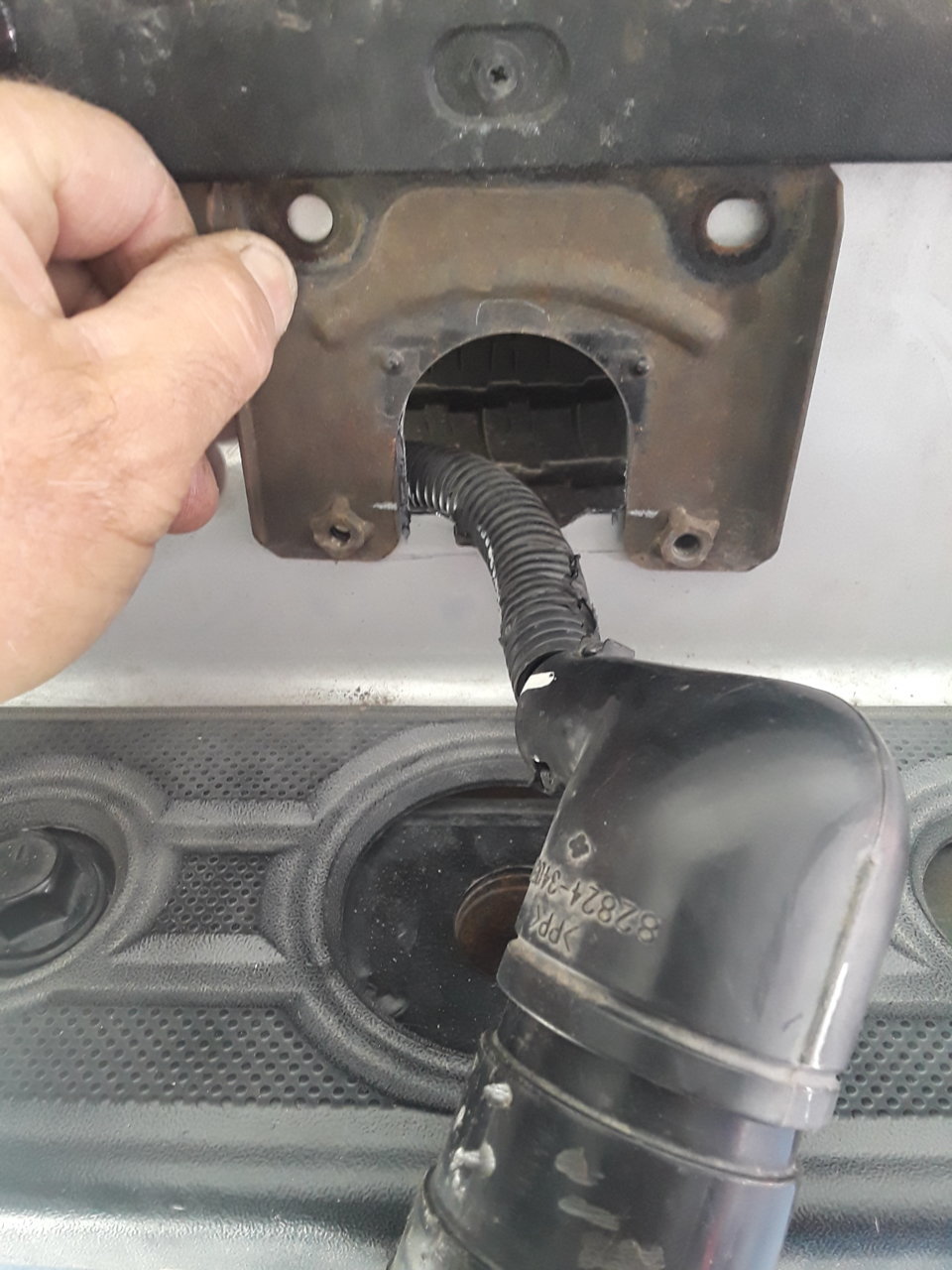

    Like I said, if u cut them all off, u could just use a round hole
    Feed the wires through the hole and repin by pushing them back in one at a time

    Use a .190 drill for the 2 holes and the stock 10 mm bolts will self tap right in
