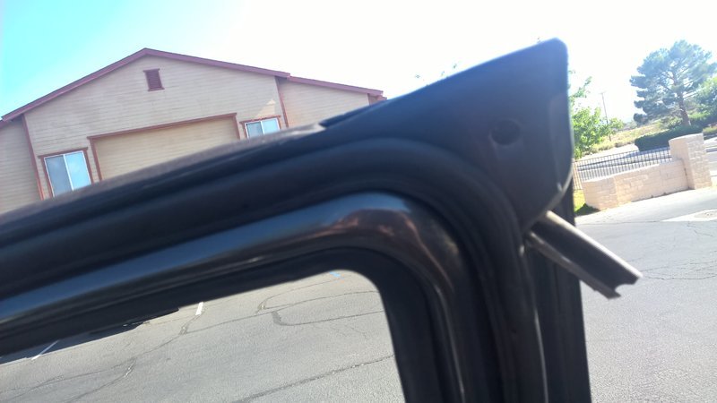

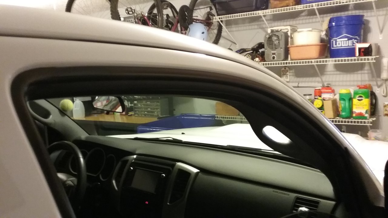

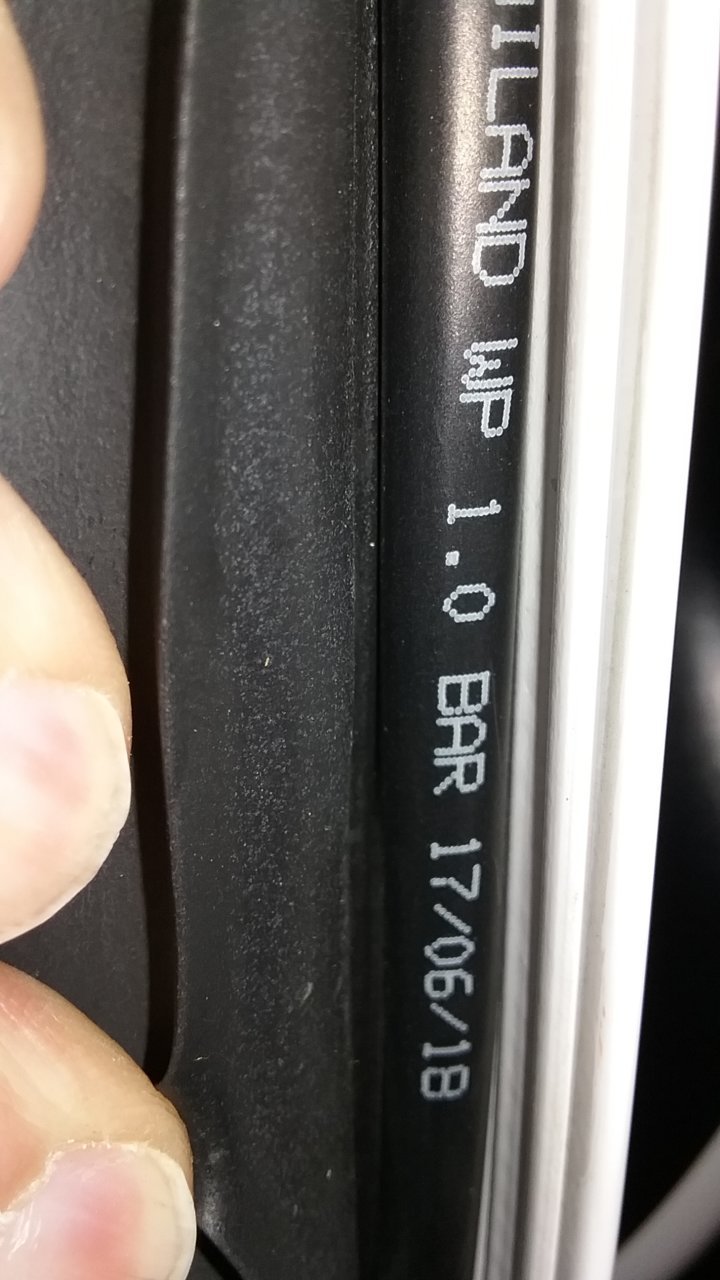

    It just lays in there. The door seal holds it in place. No way it can come out.
    That picture you see is me pulling the door seal away, far enough to see the vaccum line.
    I can get a pic of it in place if you want

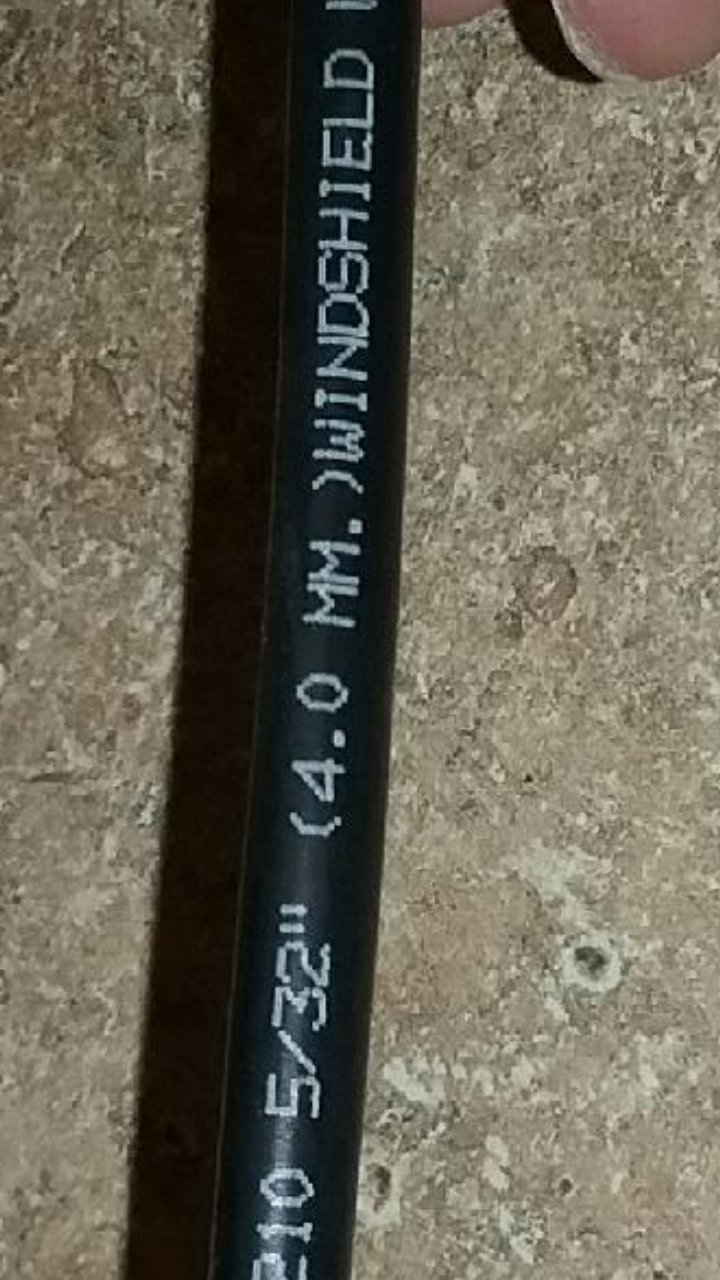

    Thanks NO picture needed I will pickup some 4mm line tomorrow :fistbump:

    Hope it works for you. I commute about 50 miles a day. I trialed it for about a week. A couple mornings it was windy and I noticed zero kazoo sound. Hopefully I've solved it. If not, I may need to step up a size.
    BTW...4mm = 5/32

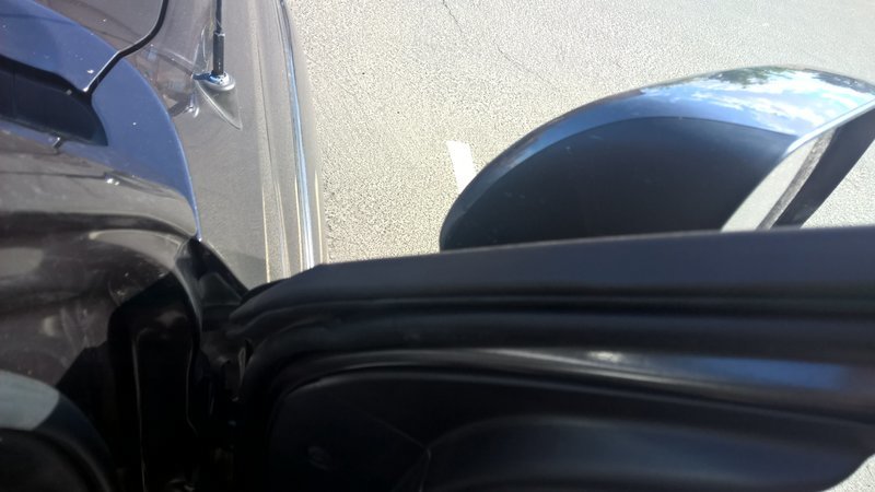

    Yep. 8' cut in half...4' per door. That took me from a couple of inches from the top corner to a 2-3 inches from the mirror...with a few inches left over.
    Just start at the top corner. It's thicker up toward the top. So I just started right after that area and worked my way down.
    Just pull the seal back and run it under it.

    I went with a smaller diameter and didn't go all the way into the corner like that. The bulk of the kazoo noise comes from about a foot up from mirror. The revised OEM seals only address that area. So what I did was overkill...in terms of length.

    My 1 week trial seems to have worked. My original piece ran from about 3 inches from the mirror to about 18" up. As I mentioned previously, I replaced it with a longer piece....that runs about 2-3 inches from the corner and mirror

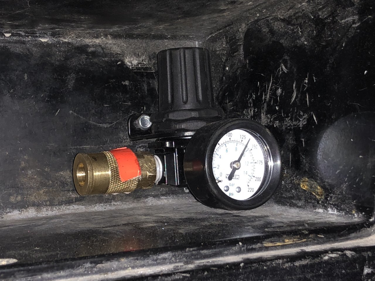

    Okay the Mobtown hidden hitch is installed.Delivered.jpg Crashbar.jpg 49348280_10211536353718346_4422243923057967104_n.jpg 20190105_131220.jpg 44416493_10211085933178114_1393236873417064448_n.jpg

    Installed a 3 gallon air tank under the bed and a gauge in the storage box in the bed
    It’s hooked up to arb duel pump 3B664359-A897-4AAA-8196-878960DB349D.jpgAnd this for
    More hp and better traction
