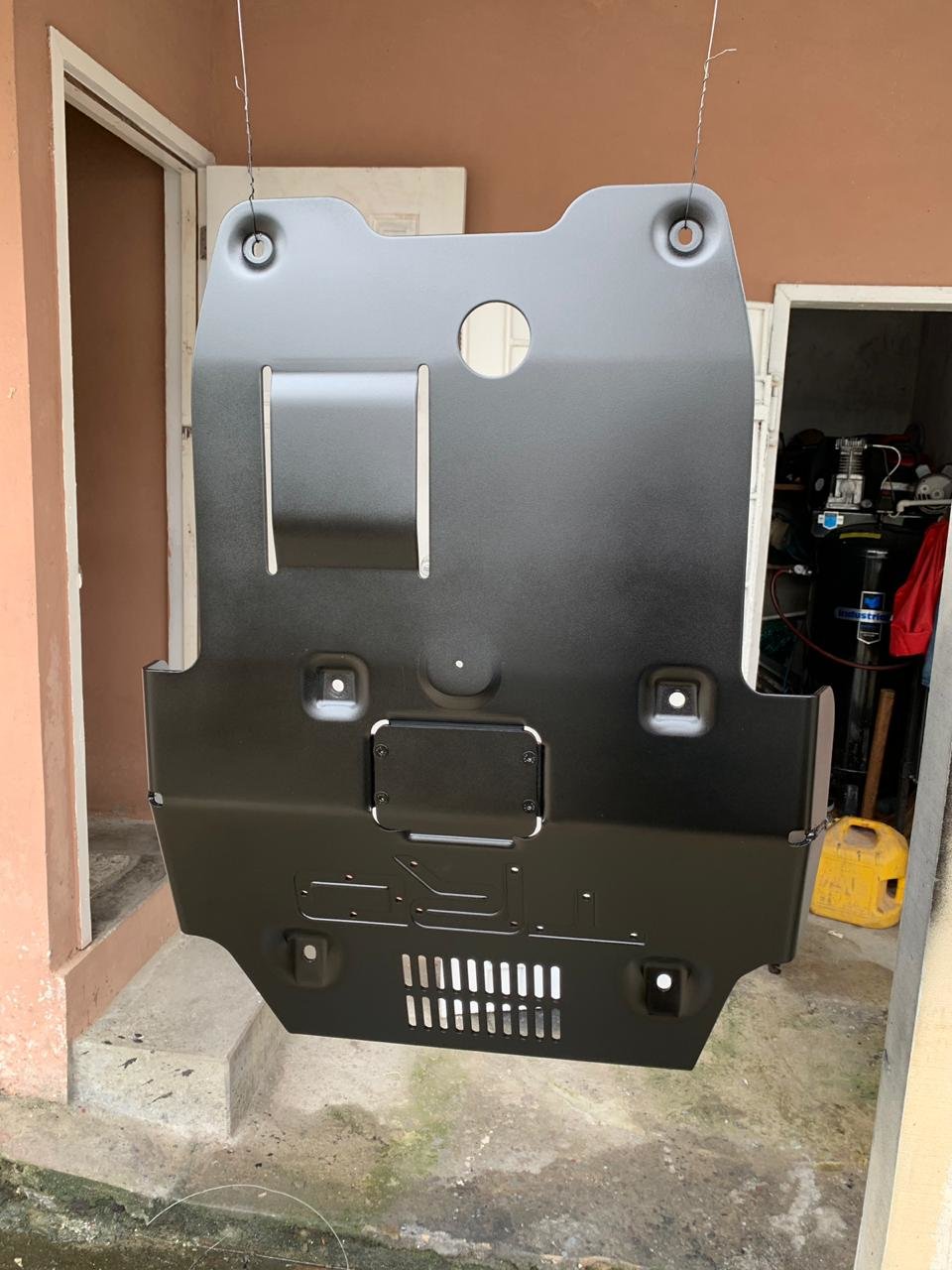

    2013 Black ACLB 4x4 V6
    Had a third gen skid painted.
