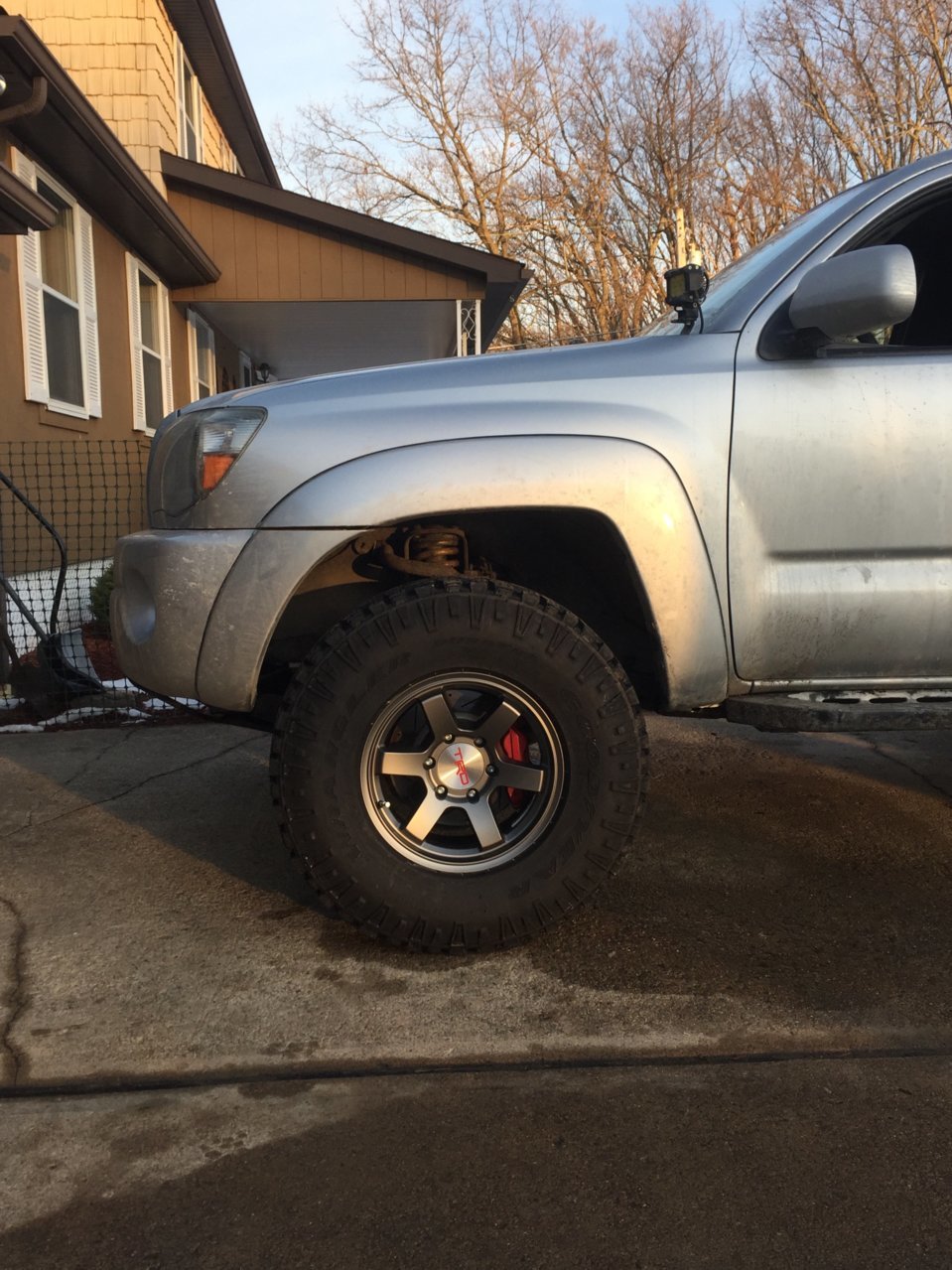

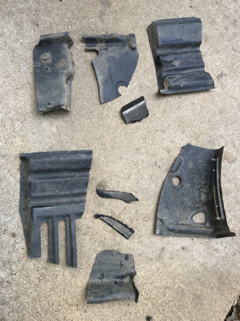

    Surgery was a success, 33’s don’t rub anymore...

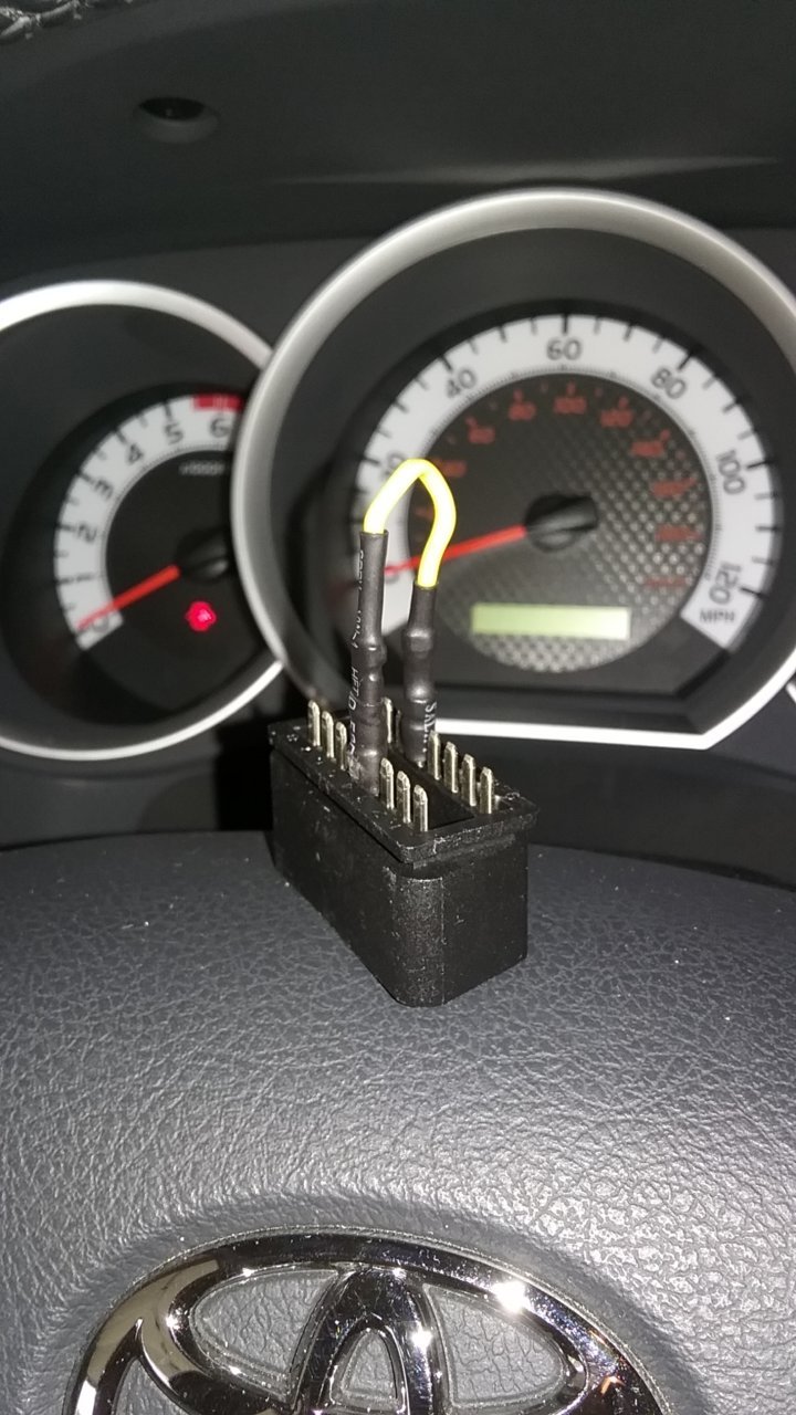

    Did 2 transmission drain and fills today...one this morning and one late in the afternoon. 20 miles driven in between to get a good mix.
    Plan to do a 3rd tomorrow morning and a 4th next weekend.
    Was pleased to see the factory fill actually looked, smelled and felt pretty good on the first drain. 55k miles on it.
    The OBDII jumper sure does make it easy to set the temp check mode.

    “Set temp check mode”. What is this?

    Utility knife and a Dremel, just cut away 2-3" above scuffed areas. Just have to check later for off-road flex and stuffing. Took less time than a full beer, but I stretched it out to 2... :cheers:
