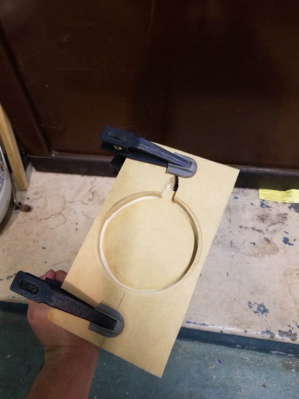

    I just bought the Tacoma yesterday, so today was mostly just going over the truck and seeing how it was taken care of for the past 68k miles. Checked all fluids, filters, brakes, changed the oil, new wipers, just easy stuff today.
    Also started on a rough draft of a wireless phone charger (similar to what the 3rd gens have). Bought a flat puck at the store, found some scrap wood in the garage with the same thickness, cut out the outline of the puck and glued another piece below it. Tomorrow I'll run it through the table saw to straighten the edges, then do endless fitments until it fits nice in the front-most part of the center console. Finish it off with a wrap in grey fabric to match the interior, and it should be good to go!

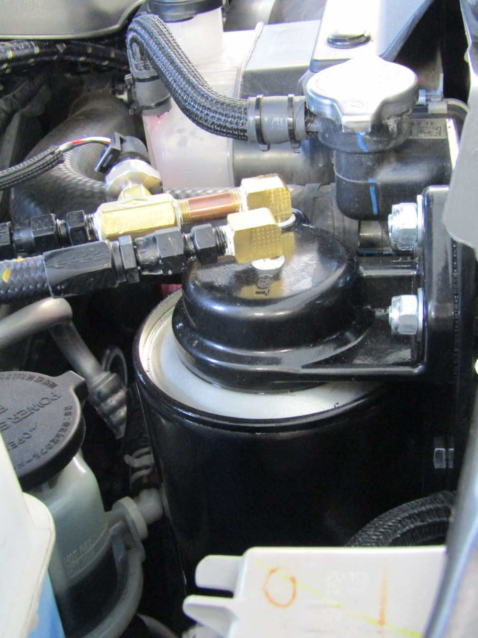

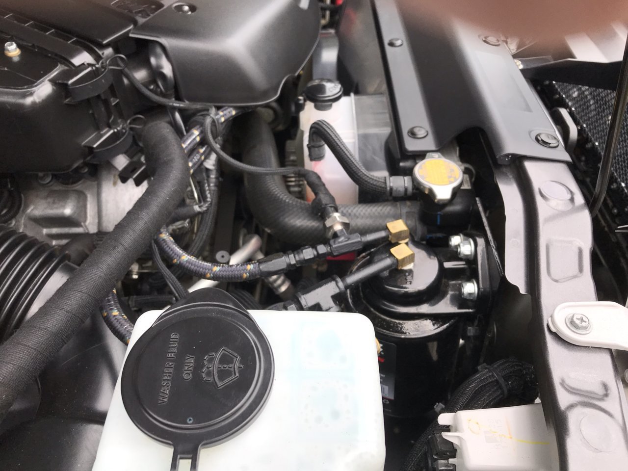

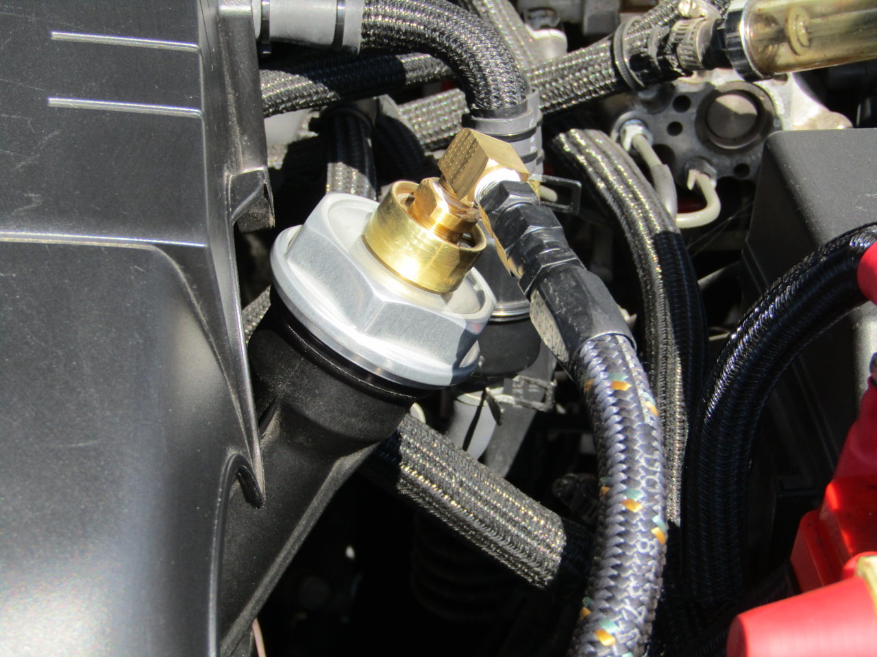

    return line from the ByPass oil filter...A 1 Qt filter ..98% eff @2 microns, vs 20+/- micron rating for a normal filter...system filters aprox 8% total flow of the system, good for aprox 60K miles....although not shown in this picture (old pic) there is a sample valve on the return side of the filter to monitor carry over and let me know when its time to change the filter......the small line on the supply side is the Oil Press gage line

    Do you have more info on this? Parts used etc?

    https://www.amsoil.com/bypassfilters/instructions/BMK21_BP83.pdf
    https://www.amsoil.com/shop/by-prod...al-single-remote-bypass-system/?code=BMK21-EA
    http://www.syntheticwarehouse.com/bypass.htm
    I fed the filter from the Lo Oil Pressure switch fitting, (on the v6 top front of engine..a REAL PIA area to work in) via A Tee.....
    you will need a Tee that has 2 BPT sides and 1 NPT
    male bpt on bottom.....female bpt on top of tee...NPT on side
    things to know
    1. mine is on a 4.0v6
    2. Pipe thread on the engine is British Pipe thread...Not NPT used in the US
    3. You can find a fitting on line in several places
    4. My advice wud be to use wicking and pipe dope rated for oil, proper temperature etc on the fitting to prevent leaks. NOT Teflon tape
    5. most everything comes in the Amsoil kit
    6. there are other filters available, I use Amsoil so used thier kit....quality material
    btw this will not effect ur oil pressure....mine is 30+ at idle

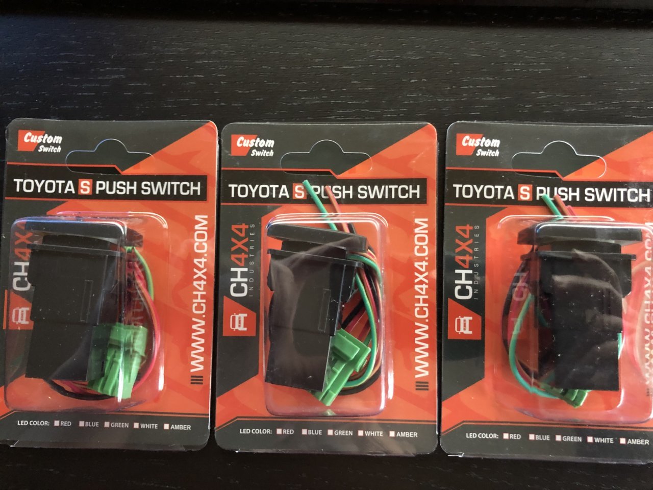

    CH4x4 custom switches arrived for my future wiring project.
    "FLOOD LIGHTS", "SPOT LIGHTS" and "REAR LIGHTS".

    What's on the faces?
