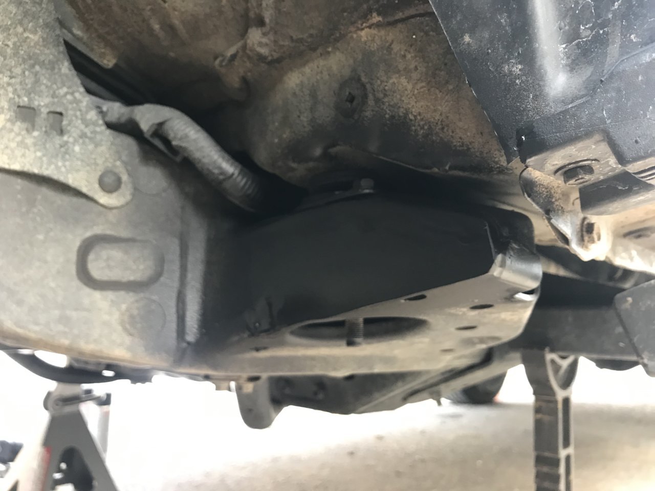

    Finally stopped all the bed squeaks and creaks. Credit to another member who already posted this amazingly cheap high payoff fix. Cutting board plastic 1/8” think cut into 2”x2” washers to go in between the bed and the mounts.

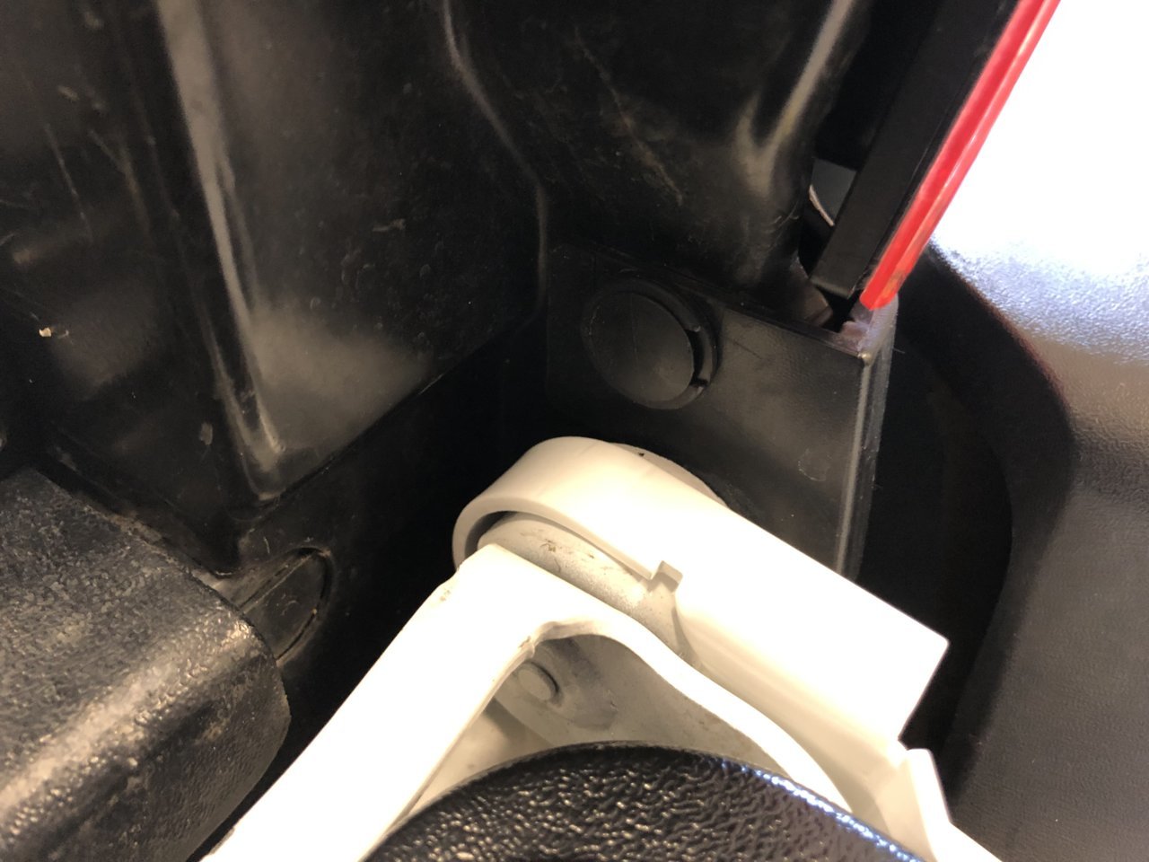

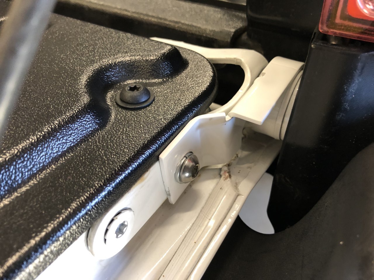

    Installed a Gate Keeper tailgate anti-theft device that I had painted to match the truck.

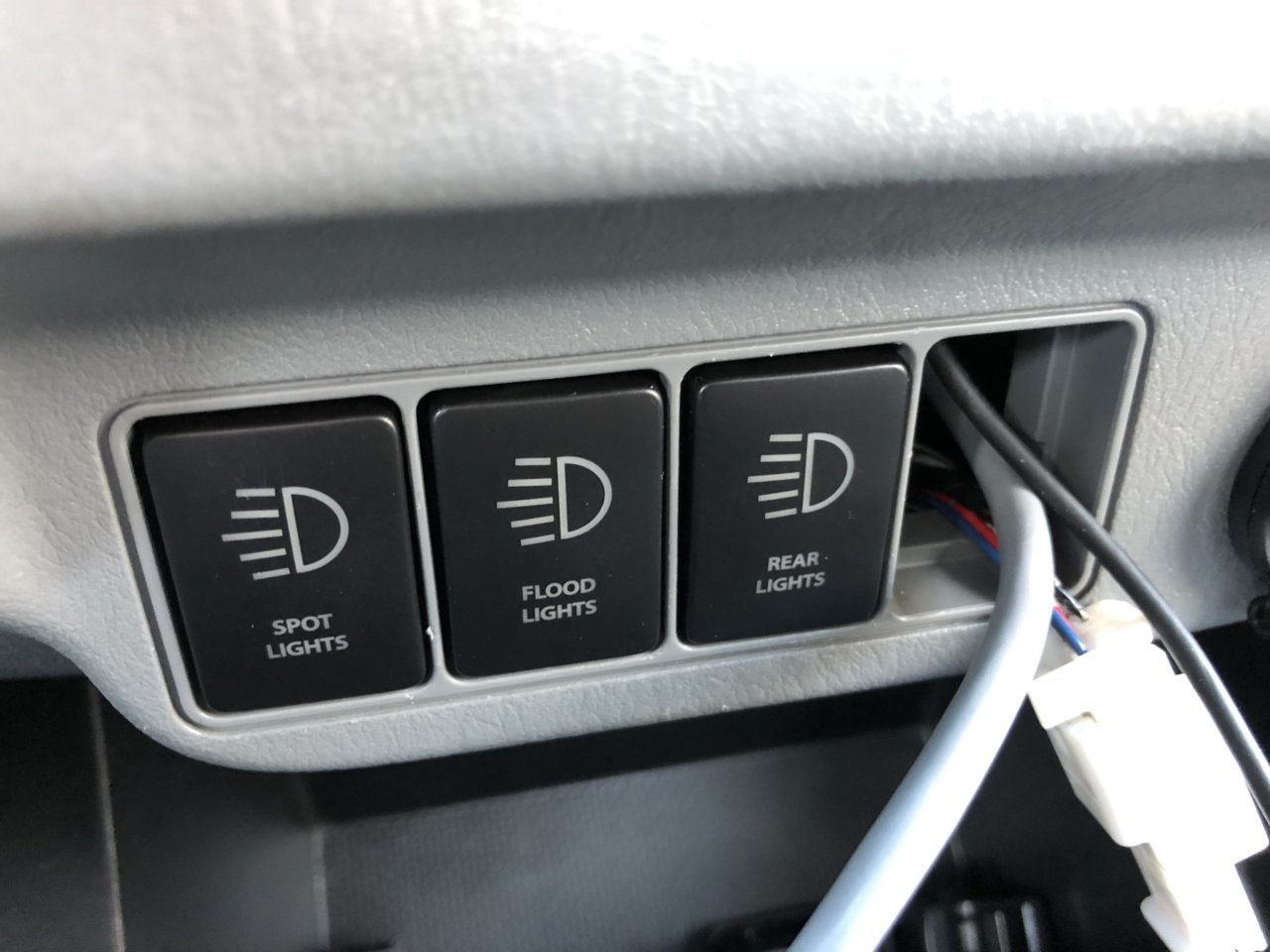

    When you trim it, can you show us what you did to make a fit? I plan on moving some of my switches to that spot soon and will need to move the aux port as well.

    Simple. File down the raised portion that I've circled in white. Not the exact same USB port but it gets the idea across.

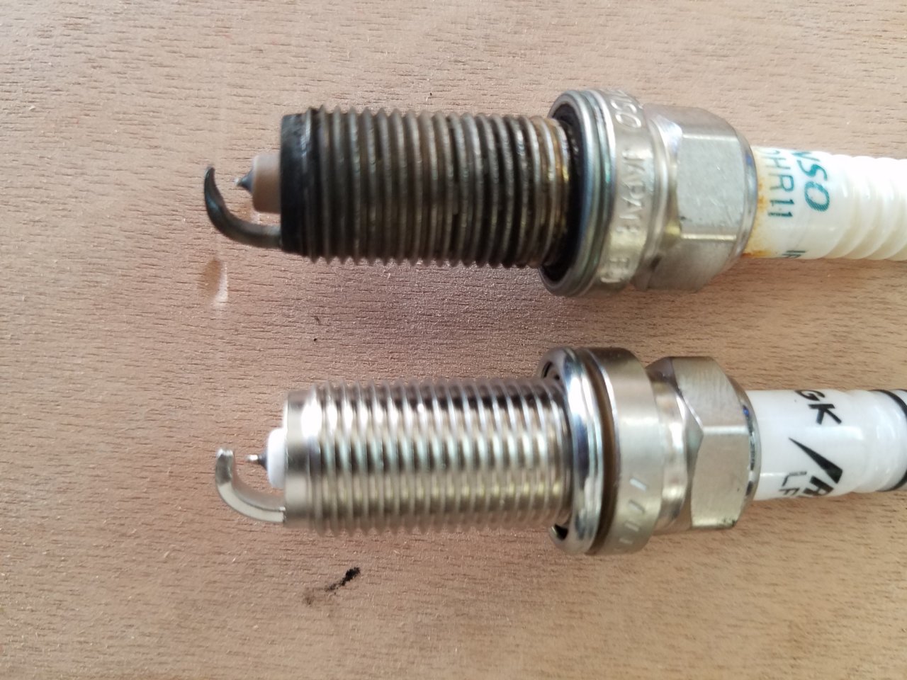

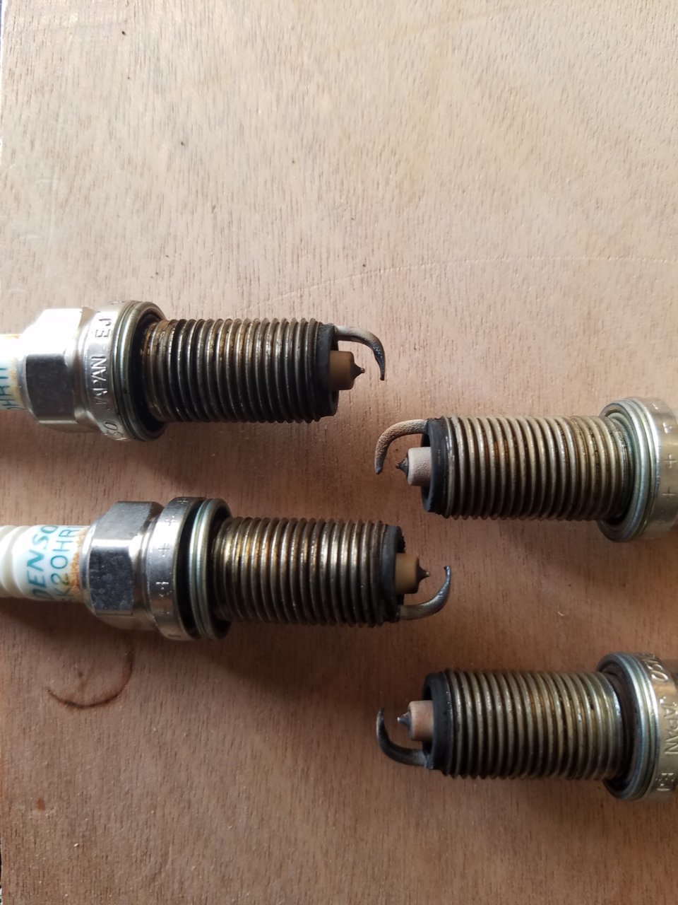

    it seems like just the other day... Back when my 2.7L/5 speed had about 90K miles on the clock, I bought the new plugs. I thought I'd wait till I saw a decline in performance or MPG before I put them in. Fast forward to this month, my valve cover gasket was letting a bit of oil pass, resulting in a stain or two on the driveway. So, a new set of Felt Pro gaskets and a warm saturday seemed like a great time to turn a wrench.
    These plugs have just 177300 miles on them. They look like it was a lot more.
    easy work on the valve cover and plugs, about 2.5 hours, about half of that seemed to be cleaning the valve cover and the intake plumbing.
