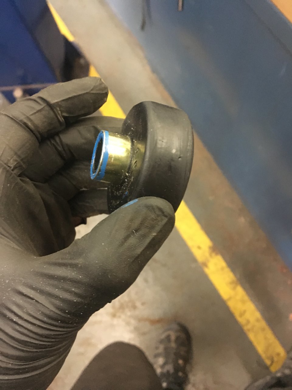

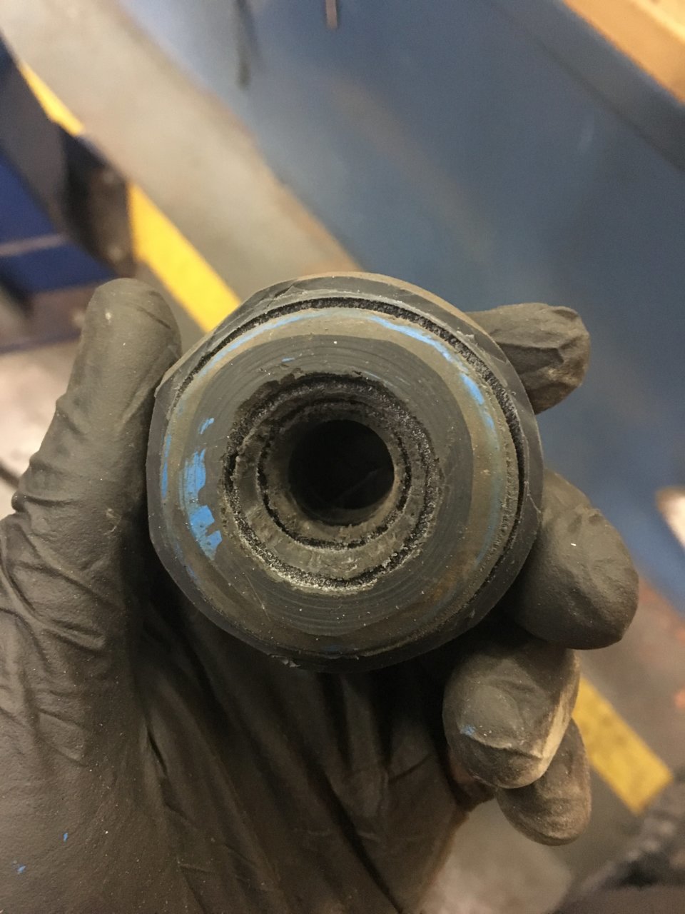

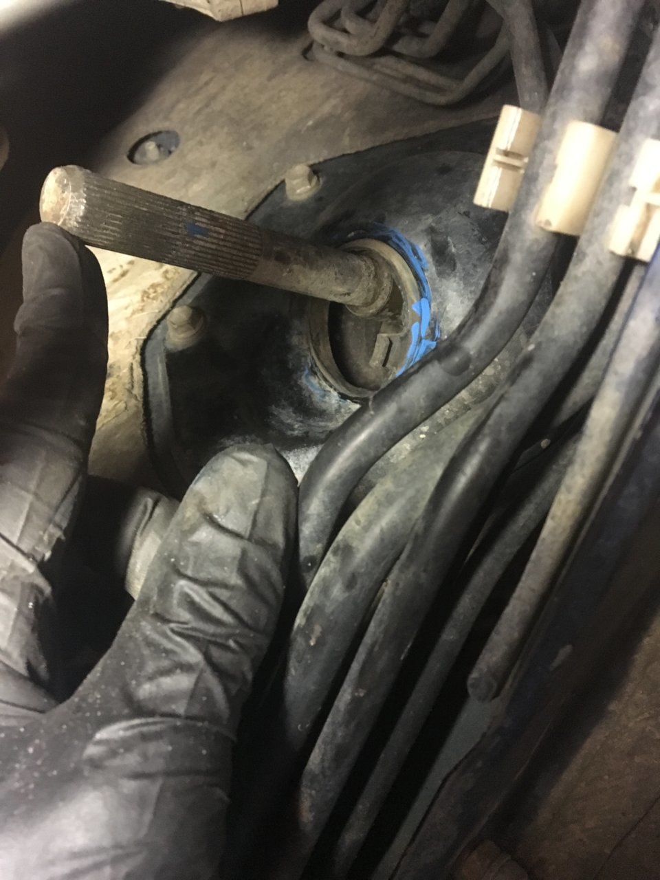

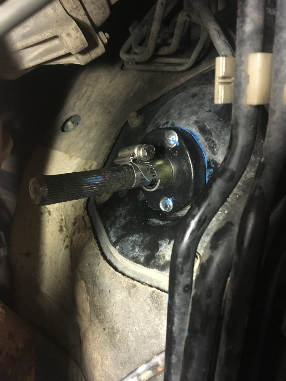

    50C9312F-4E17-4D97-B82E-844793DABC24.jpg CA5ABEAD-E053-4E12-83E3-D3D25D13B47A.jpg 07E7698B-DBF7-4084-A509-CC368080F855.jpg C96CAAC6-DB26-4FB7-95E2-E6306171BC9E.jpg So I had some serious play in the steering wheel when off roading, definitely more then the normal “bump steering” I had already replaced the intermediate steering shaft and replaced the rack bushings. So I followed the ISS up to the fire wall and found the problem. I had recently replaced my body mount bushings and had a few spares laying around so I got creative and slid one up the steering shaft into the hole. The body mount was a little big so I had to cut it to fit. The pics will explain the process. The steering is now nice and tight .

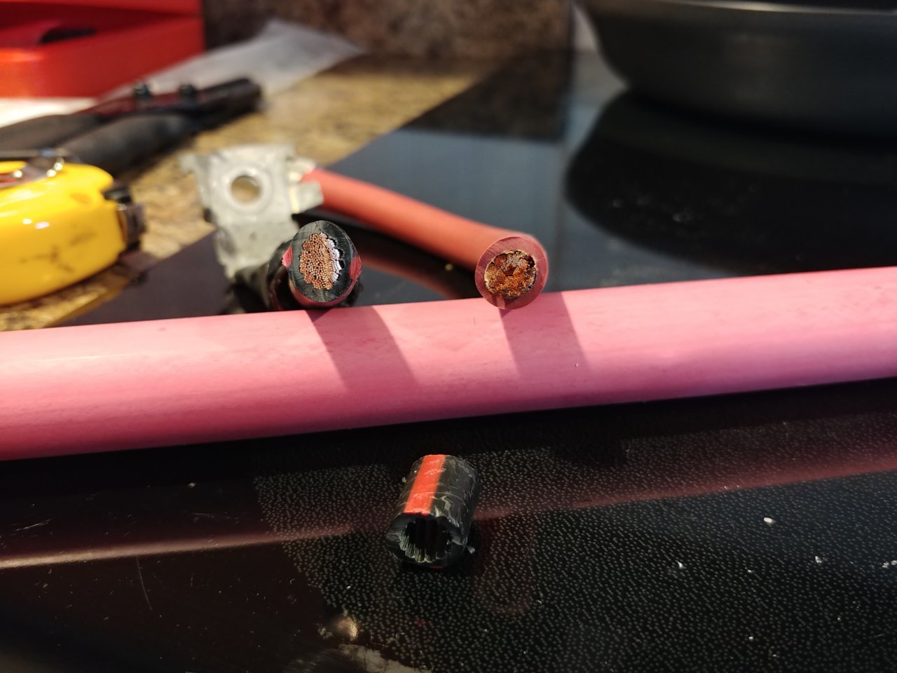

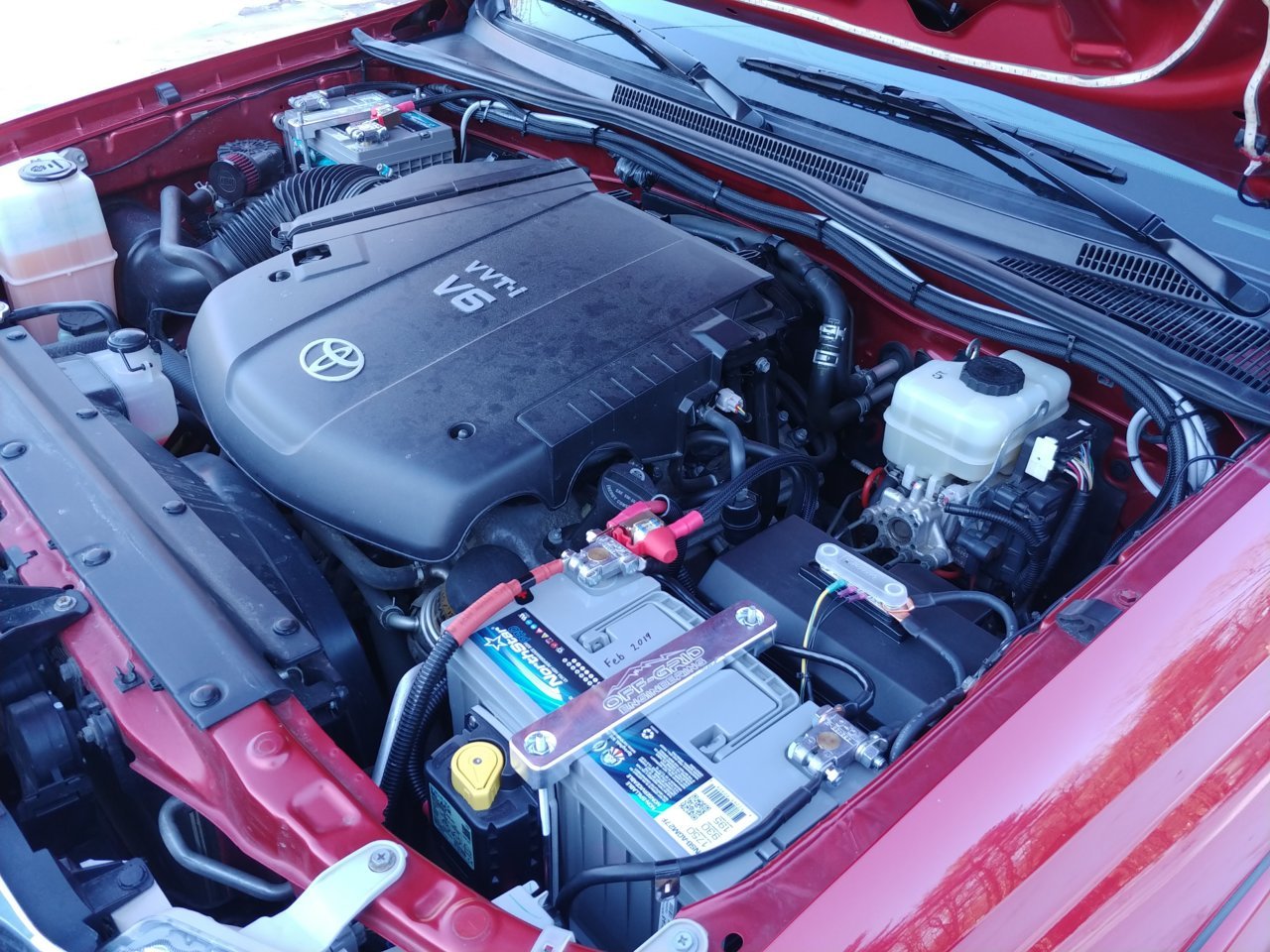

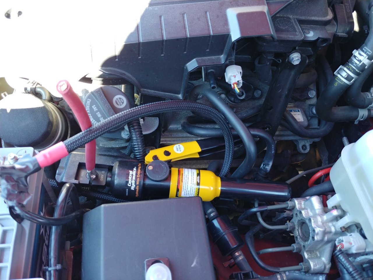

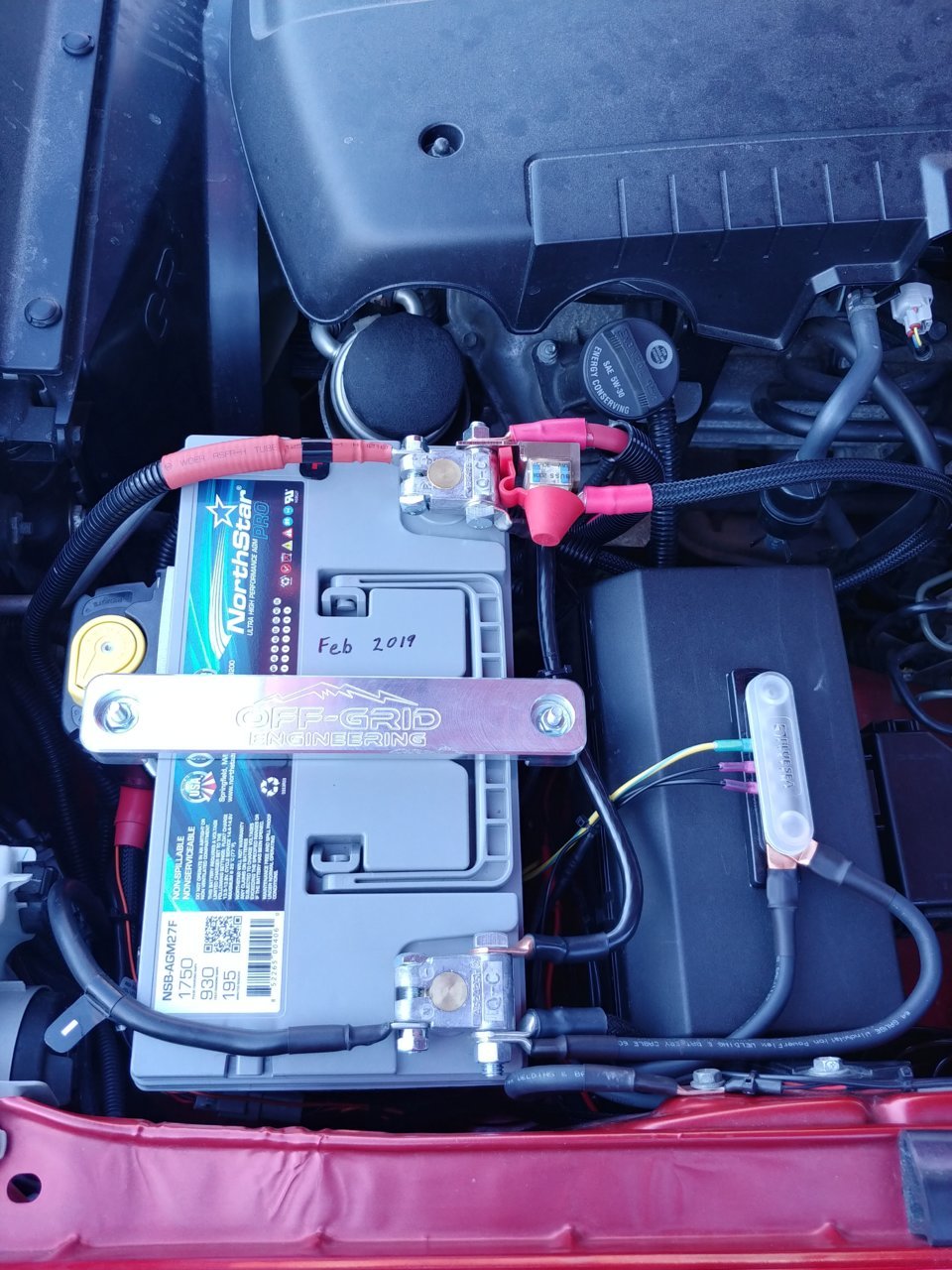

    Holy crap. I dont check this thread for like 3 weeks and theres 1500 new posts :eek:
    Latest addition to the ol girl is finally getting a dual battery system installed. Only took me three weeks.. but then again working outside in the Maine winter months isnt exactly fun.
    Cut off the factory battery terminals and crimped new lugs on everything. Re-did the chassis ground in 4 gauge and added a neg buss bar. Added about 5 inches of 2 gauge to the factory pos. lead. Big butt splice, some adhesive lined heat shrink, and loom cleaned that up. Actually used the 0 ga. jaws in my HFT crimper cause it seemed to crimp the splice best. A high quality crimper should really be on my list of things to acquire.. And ran the ML-ACR control switch into the cab, just got to mount that somewhere now.
    For future reference: the factory pos. and neg. wires to the starter are 2 gauge. Some people have thrown out various sizes, but for sure it's 2 gauge. Also, factory pos. wire to the fuse box appeared to be 4 gauge.
    Stock vs new 2 ga welding wire
    A 3 handed job
    Finished product

    Awesome! I have 3 gauges on top of my column.didnt want to mess with them to cancel the silver. The red looks sweet btw.

    That looks awesome! I'm changing mine over as well. I have way too many wires to tastefully connect to the battery. Where did you source the butt connectors and wire? I was going to yank the whole factory system and just run new 4 gauge.

    All the 2 ga stuff including wire came from https://crimpsupply.com/
    The 4 ga stuff came from Amazon but appears to be the same thick welding wire as Crimpsupply which is nice
    https://smile.amazon.com/gp/product/B01MD21BCC/ref=ppx_yo_dt_b_asin_title_o02__o00_s00?ie=UTF8&psc=1
