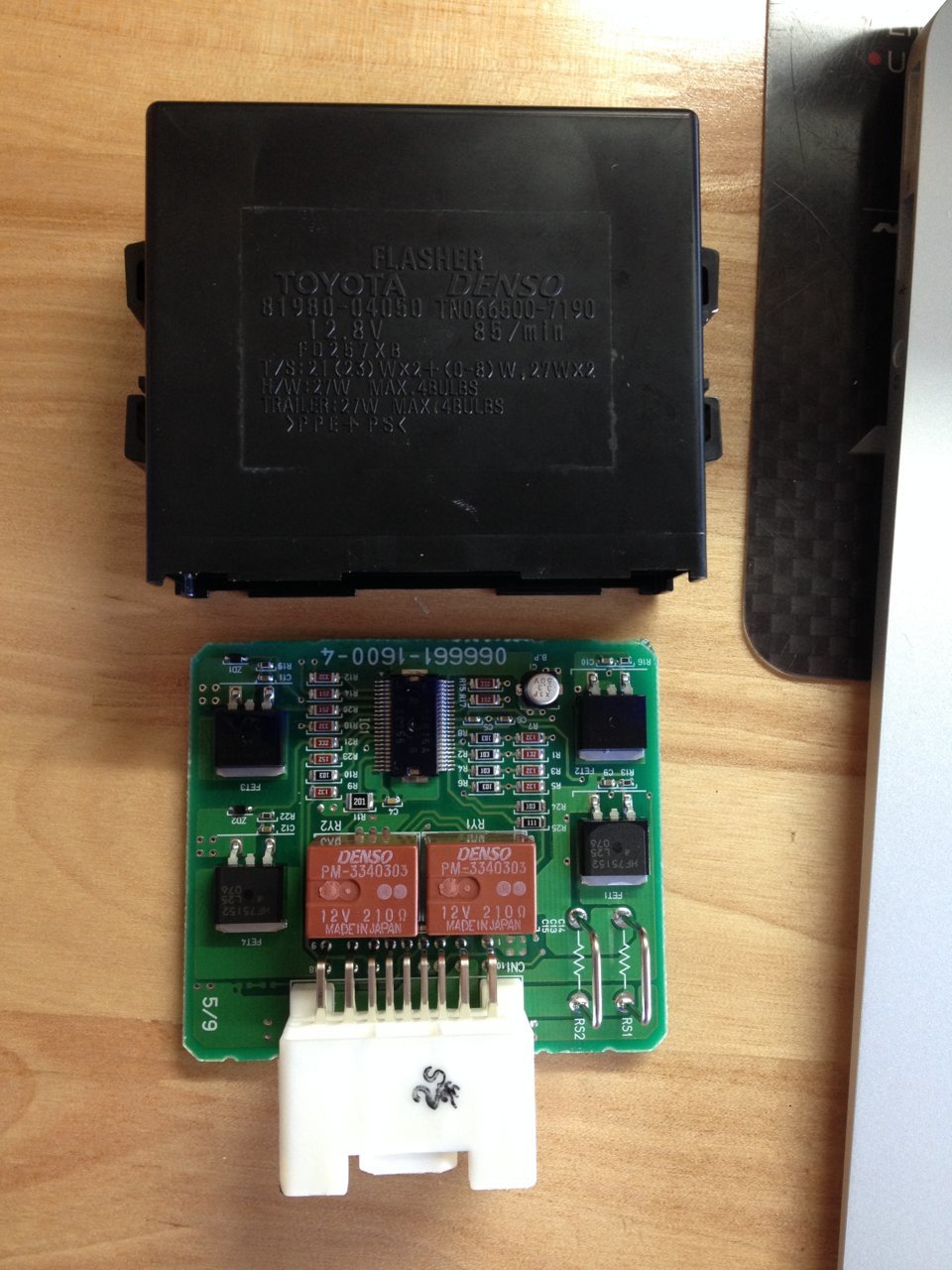

    Grille, floor mats, navi, heated seats, bed cover, fj wheels, custom door cloth.
    So what's wrong with hyper flash, its makes people really see and pay attention?

    From what I remember (I took on this project a couple years ago) the resistors will get ridiculously hot running all the time because of the DRL function, that's why I modded my relay.
    But the relay looks nothing like that one you ordered. Let me dig up a picture...
    Edit: here it is, the loops on the bottom right is what you grind down to add resistance

    Thanks for all the info on this. I think I'm just going to forget about it and live with factory bulbs. I figured it would be a fun, easy upgrade but there's more to consider than I thought.
    Unless... do you think I could use that resistor for the rear signals?
    AugustaTaco[QUOTED] likes this.

    Lol, exactly my thoughts when I took this on. Way more complicated than I expected. I ended up just doing LED's in the rear instead of F/R like I originally planned until eventually I just lost interest.
    I think you're fine running the resistors in the rear because it is off of the DRL circuit, but you may want to check around a bit on that.
    2015's with the switchable DRL seem to be the most complicated and of course that's what I have haha
