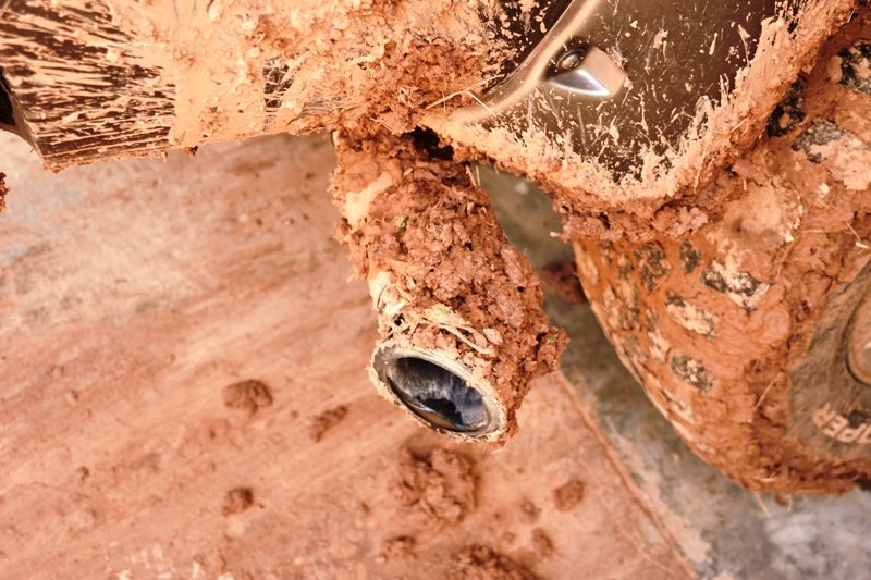

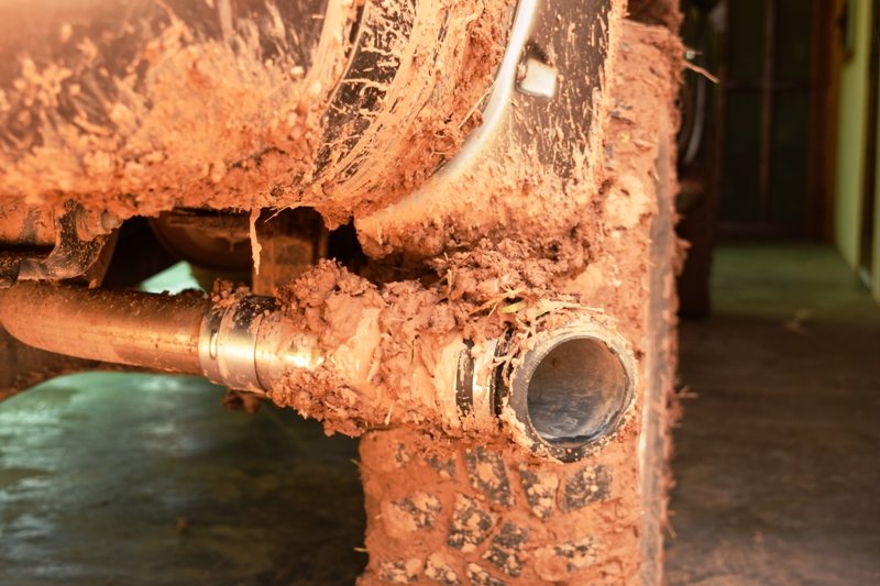

    A little adaptation to avoid my exhaust tip full and clogged with mud.
    I didn't found yet mud guards to fit the new fender flares.

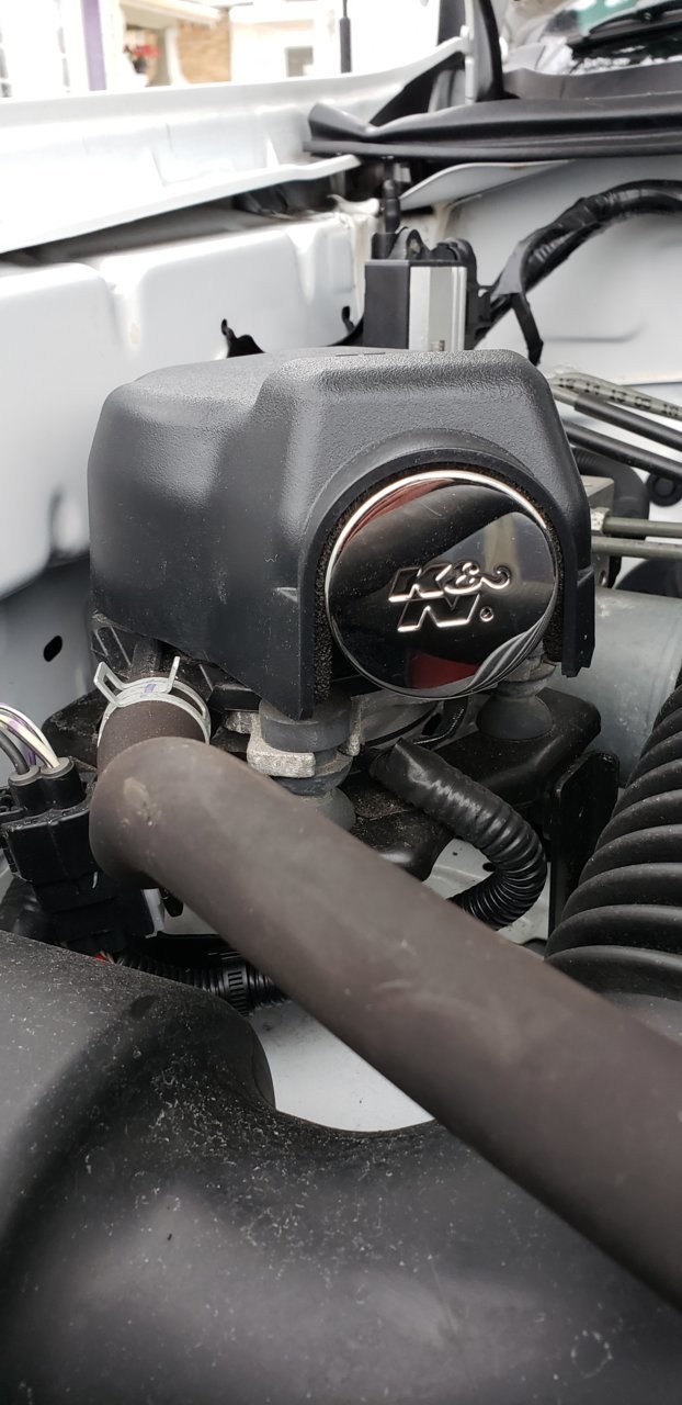

    Maybe someone here has more knowledge but, I dont think you will starve the pump of any air. It's already a big step up from that cheap plastic OEM filter. I think you will be fine. But it definitely looks good. :)

    Thank you! I think it all took what like 2 minutes to do lol

    I drilled a few small holes in mine

    Ah that's a good idea. I'm not in mud or water (besides rain and snow) so i'm not really worried about getting water in the filter. I'll probably drive a few holes in it tonight.

    Mine’s a 2012, so it never had a cover. You could also shave a little material off with a razor knife or dremel tool.

    I dont have one but looks to me that even with the cover on there is more filter exposed at the bottom than there is in the hole it breathes from, shouldn't hinder it at all, just my .02

    Changed all drain plugs to Dimple Magnetic plugs UNI filter on air pump
    Jaypown
    Leave cover on. It will help keep water etc.
    These filters are used quite a bit on motorcycles and get wet in the rain causing the filter to retain water and make the bike to run over rich.
    As me how I know.
    My 2013 has the filter mod and I used the cover.
    Some other Tacoma dont have the cover, so it's your call.
    The filter material flows guite freely so the pump will sound louder.
    Look at the original pump opening to the amount of area for air flow, I think you will be good either way.

    Thanks @TOMB Yeah I def noticed the louder sound. Which was expected. I have the cover on now and I dont mind at all keeping it on. I just didnt want to cause extra restriction due to changing the original design by adding the filter.

    I did mine over a year ago and left the cover off. No issues.
