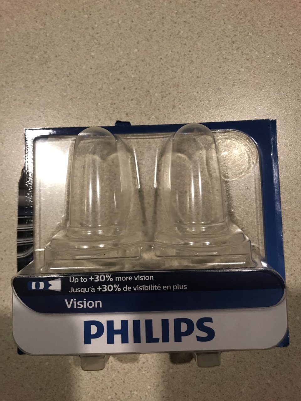

    Bought new headlights yesterday. Am not happy with the Silvanias that burnt out after less than 2 years... I’m sure the recent polar vortexes had something to do with it. I’ll give these Philips units a try...

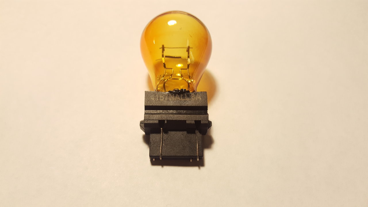

    Just don't put their bulbs in the dtrl
    Stock headlight. Stock harness. 3 weeks, daily driving. Will never run a Phillips bulb again, ever.

    2008 here, no DTRLs on my truck. Thank you for the advise though.

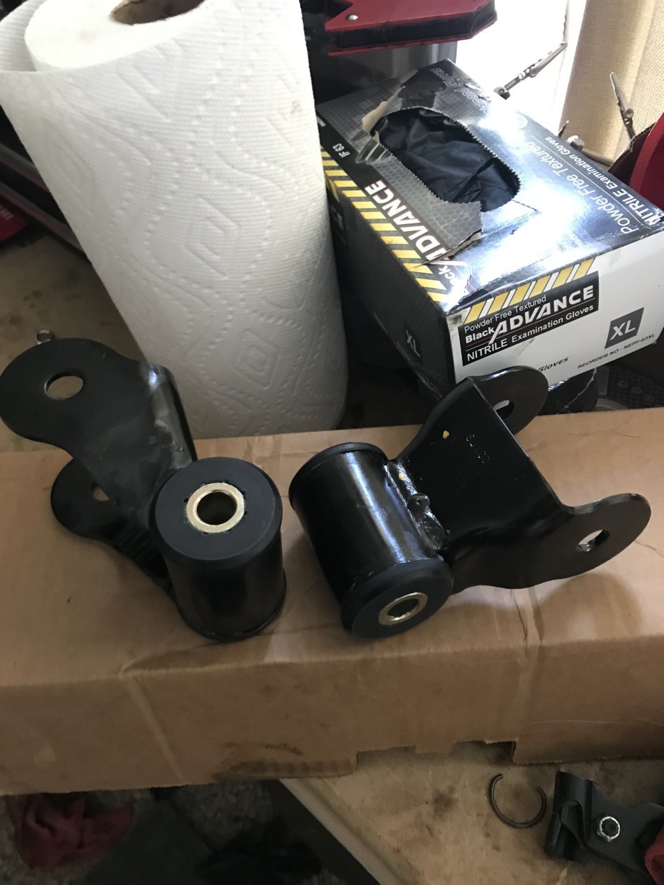

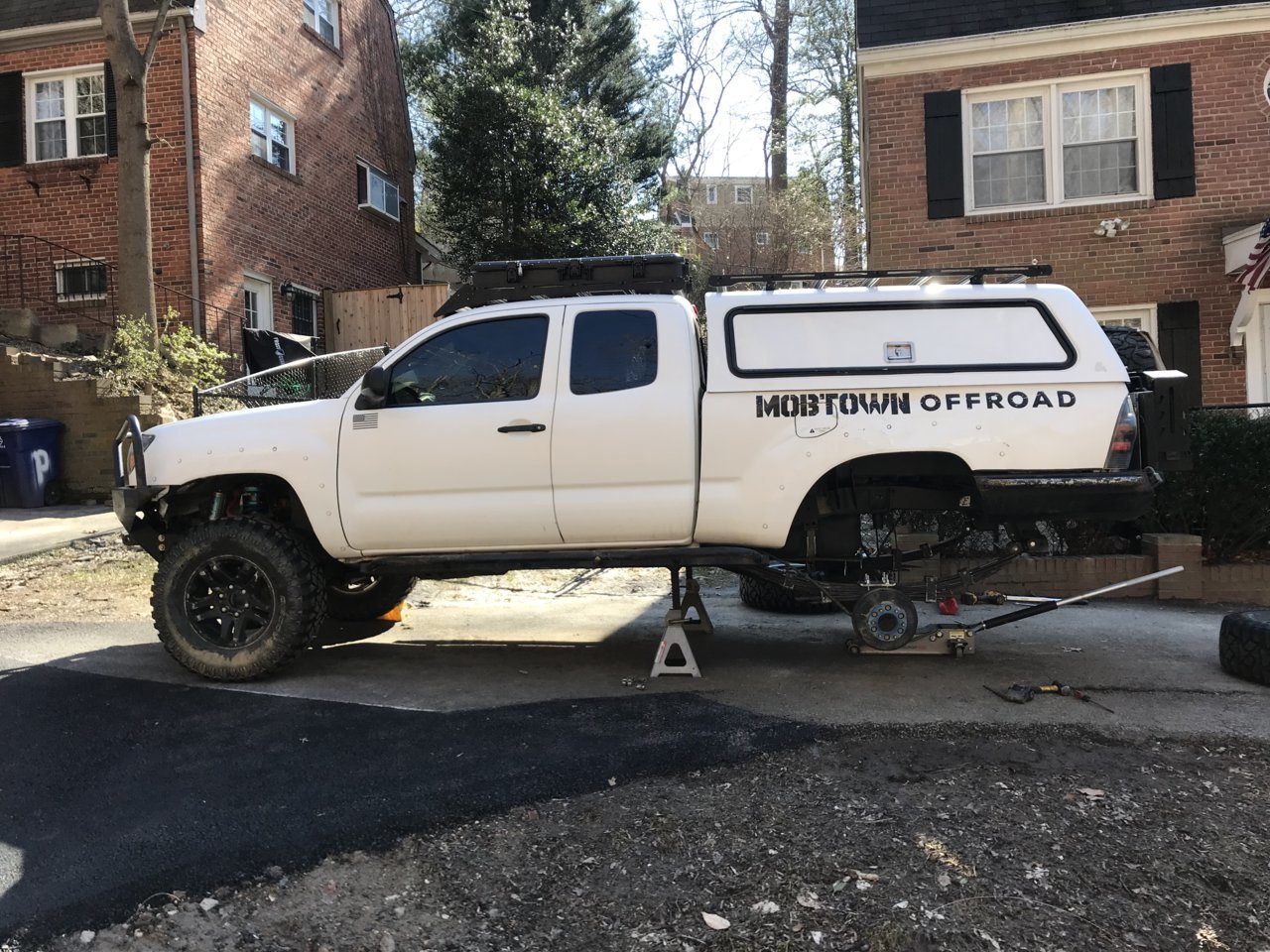

    Swapped in new OEM shackles with energy suspension poly bushings. This will allow the rear end to droop and not have the stock bushings bind.

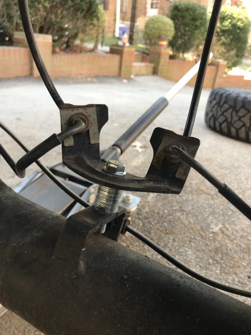

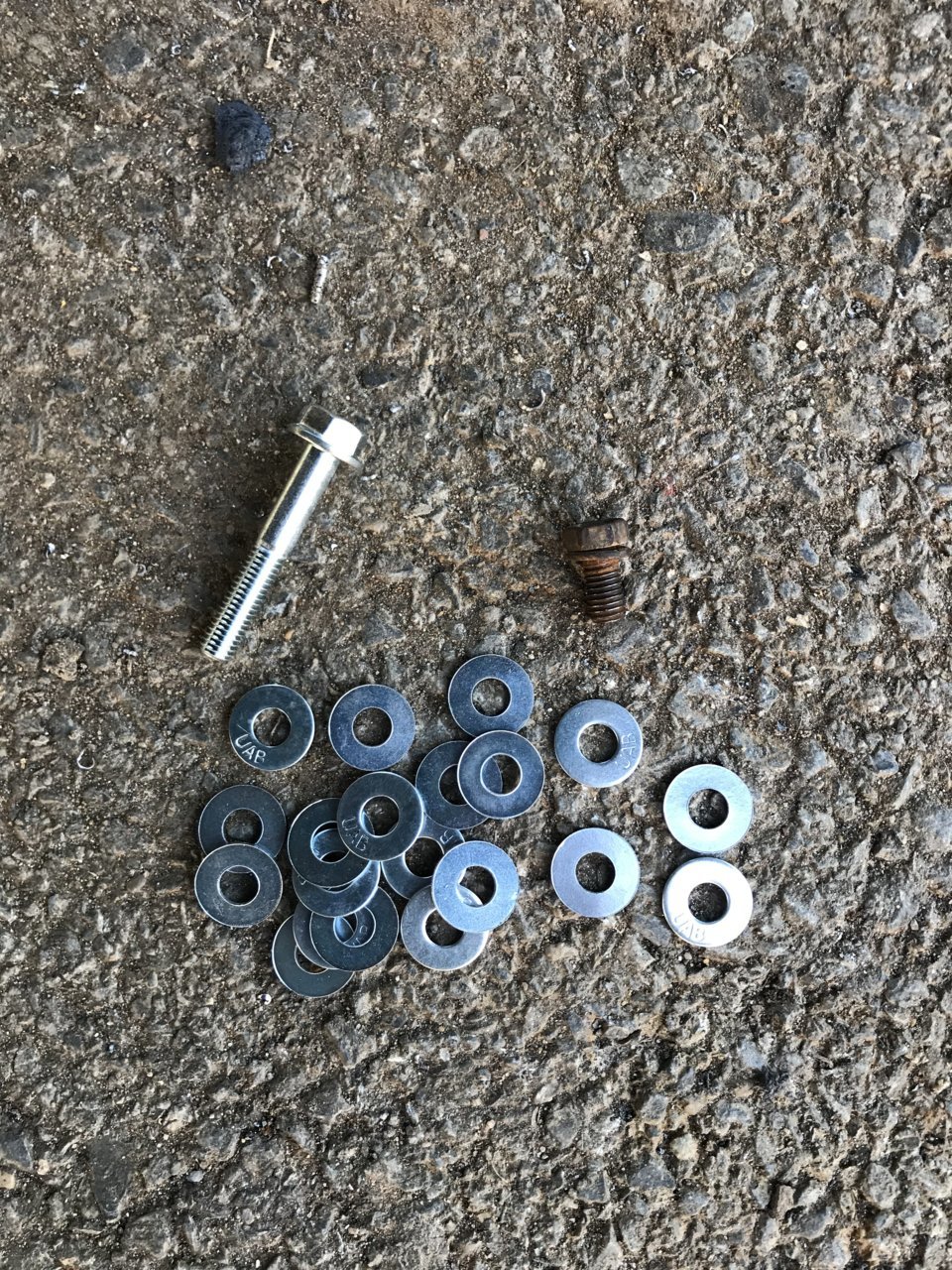

    While at full droop my +4” brake lines were a little snug for my liking. Took a page out of biksteins book spaced up the hard lines on the axle.
    0C0F29F5-63BB-4A62-B32D-41E4E0720969.jpg 428B25ED-4F48-4027-8F25-E5669CB533C3.jpg 1250EF21-2253-40E4-8865-BB040C1CD876.jpg F73A1802-2392-4BC5-9D83-FC658EFE088D.jpg 6F53727B-E8E3-4383-A4B2-FD23EE02F322.jpg

    Do you happen to have the part number of the Energy Suspension bushings?

    Didn't want to just get a sleeve? :laughing: that's awesome

    LOL my friend said the same thing. A quick scan of the hardware aisle and I didn’t see any. You know how much of a PITA it is to line up 20 washers??

    I had to buy this whole kit, and I’ll be selling off the rest of the bushings. As far as I know you can’t buy just the shackle bushings on their own. Oddly enough though I have an extra set of shackle bushings I’ll sell you for $35 shipped
    Energy Suspension 8.2116G LEAF... https://www.amazon.com/dp/B00LSTUAQ6?ref=ppx_pop_mob_ap_share

    I've shimmed a bumper or two so I know how it goes :p

    That’s where I was. I didn’t look hard enough apparently :laugh:

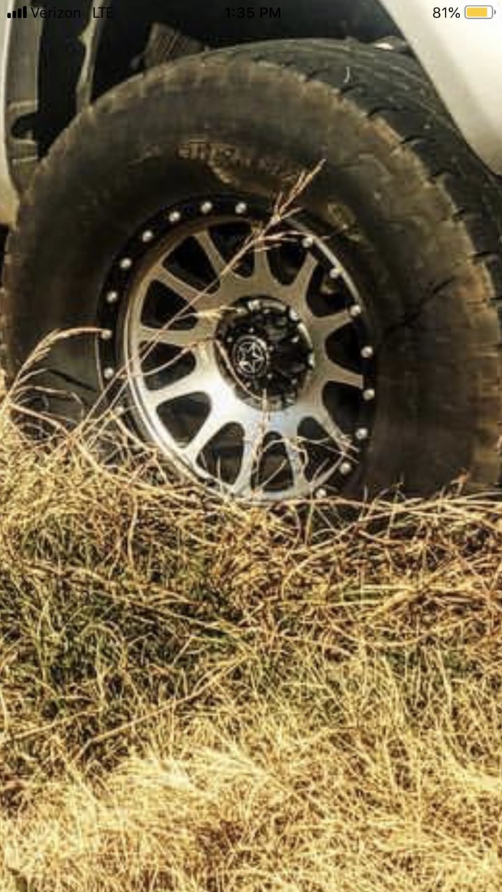

    D942DAB0-3C35-46B6-B4DC-D665AD254E97.jpg Anyone know what wheels these are?
    Edit: They’re DWG offroad wheels if anyone was wondering.

    Look close to icon wheels
