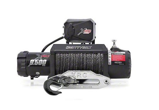

    Picked up a winch the other day w/ the eBay 15% off sale. I have researched a bit all over the interwebz (even Jeep forums :eek:) about wiring direct or having a cutoff switch.
    It's like 50/50 on those who do and don't. Since this thread gets a lot of attention, I'll ask...thoughts? pro/cons? Maybe just get a big fuse for the terminal instead of a bulky ass switch?

    I’ve ran all my winches straight to the battery with no fuses, as it’d need a 400-500 amp fuse/breaker. I leave it in free spool mode so if it ever shorts out it won’t winch itself to total destruction.
    ImMrCrash and AugustaTaco like this.

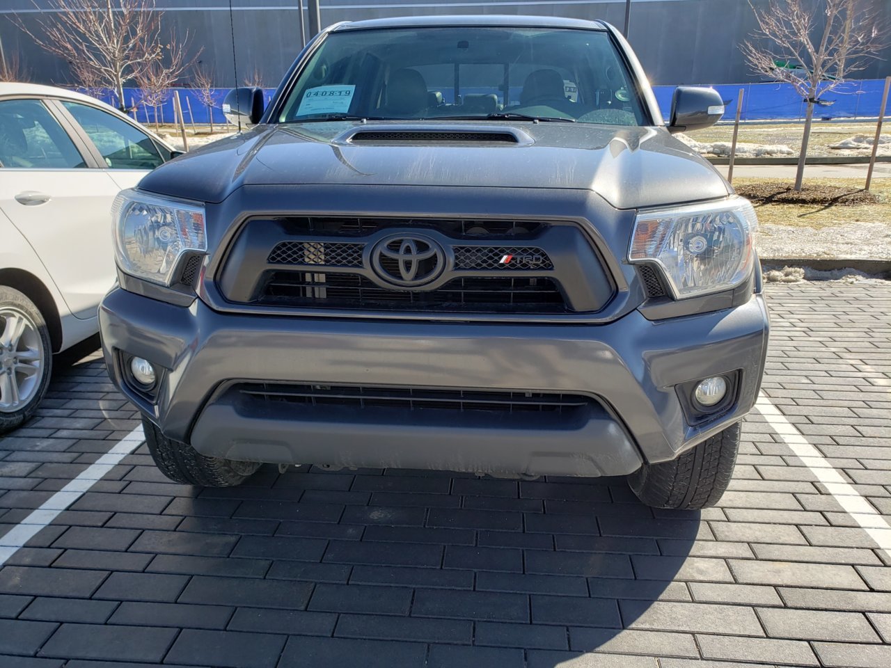

    I Plasti dips the Toyota emblem and added a TRD emblem to the front grill. I dontd think there TRD stands out. It gets lost in the grill. I will plasti dip the TRD letters red

    FWIW both of mine are direct wire and neither have had issues over the years.

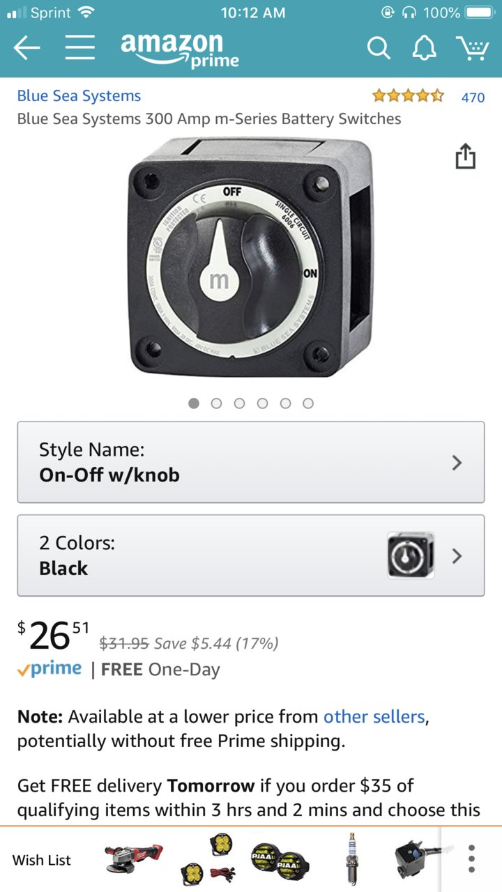

    I ordered this guy for my winch I picked up on the 15% off sale as well. It’s rated for 300A cont, 500A for 5 mins and 900A for 30seconds. I believe my winch (X20) has a max rating of 450-500A iirc.
    I’ve seen lots of people running it both ways as well, but my biggest concern is the potential for a fire in a front end collision. A switch could absolutely prevent that possibility. It would suck to have your truck burn down because of the lack of a switch. These are just my thoughts.

    A switch is a very good idea. I have a similar Blue Sea switch to install with my winch.

    Which blue sea is big enough for that? Link?

    Alright, so just like my previous research....a 50/50 split haha!
    I think I'm going to wire direct, and probably add a switch once I overhaul my electronics this summer (if I stop procrastinating that job)

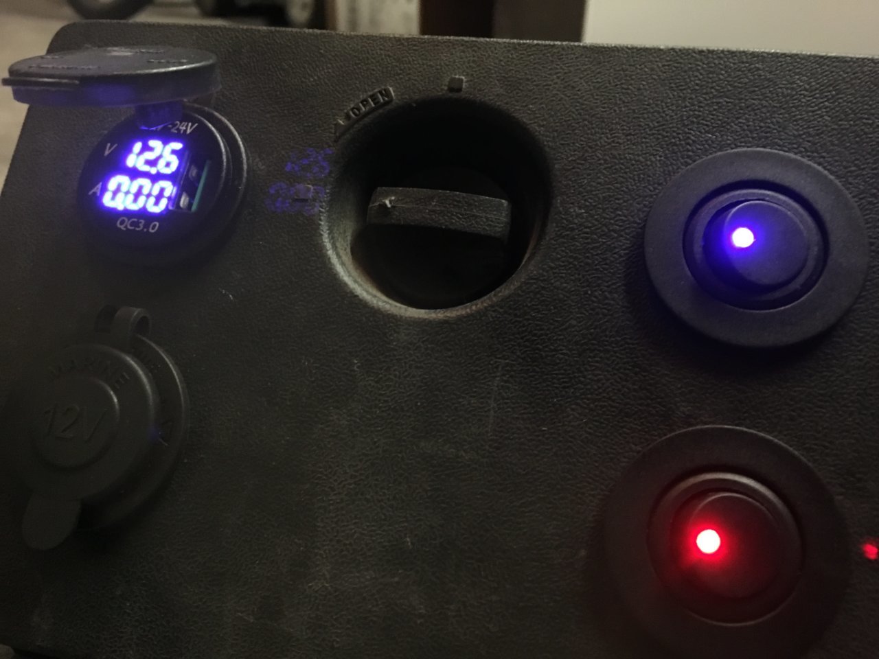

    Moar powar! Finished wiring switches for bed lights, 12V, and usb/voltage gauge. This weekend I'll run the wires back to the bed and install the six fuse panel in the cubby behind the cover.
