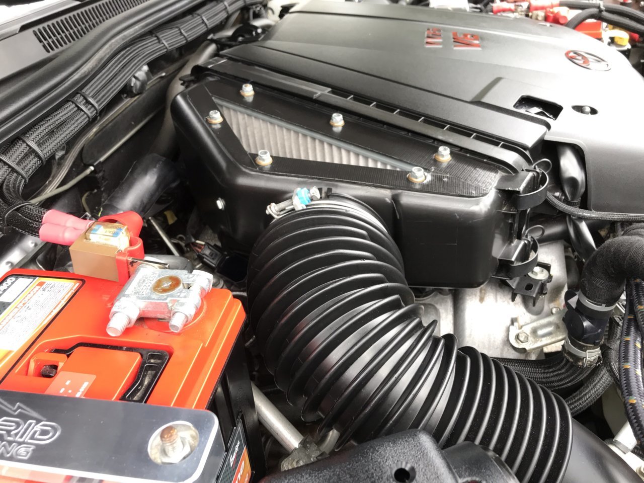

    What did you use to make this? Any write up?

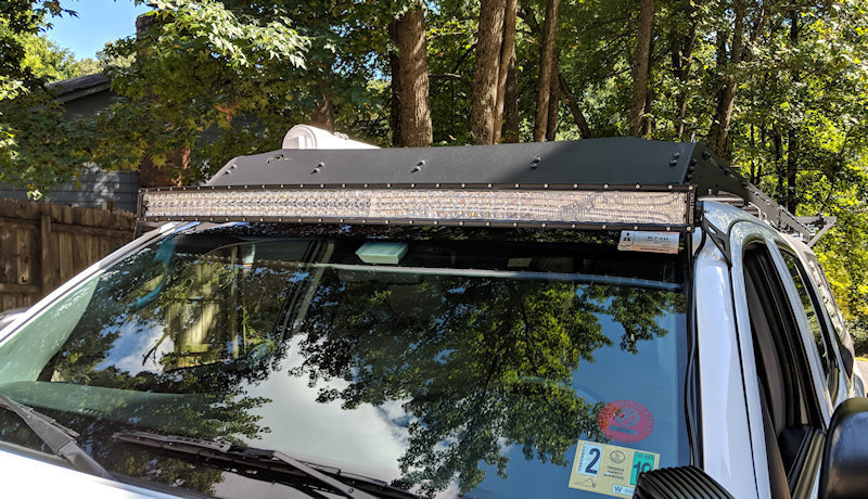

    Here you go.

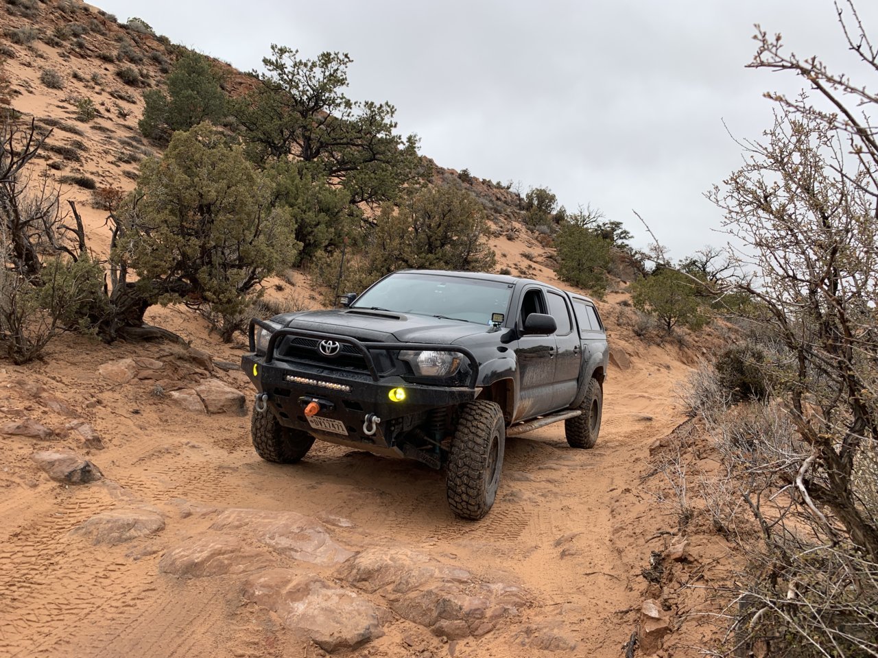

    Closed out a 3024 mile road trip from San Antonio, Texas through New Mexico, Arizona, Utah, Colorado, and back. She took my wife and I through the painted desert, past the Grand Canyon, through Zion, Capitol Reef, Arches, and wheeled a bunch of trails around Moab including Gemini, Shafer's, and Fins N Things. Didn't hit a single bypass, opted for the bigger climbs and descents, and made it look easy.
    I love my truck.
    Pardon my crappy cell phone video, I'll upload better to my bs/build thread later.
    https://youtu.be/P2g3ShqJ98Y

    Sorry no write up...its ez to do..
    draw out what you want to remove
    use a uni bit in the corners , drill out to the radius of ur corners
    jig saw w fine blade slow speed to cut it out..corner hole to corner hole
    trim inside as needed,,debur the whole thing
    I used 1/8" plexiglass as the cover
    clean the surface good, used gasket seal as a gasket and bolted it down
    if you want to be real fancy install small led light inside wire to switch and then where ever you like..mine goes back to a fused block

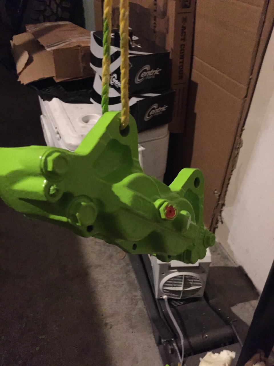

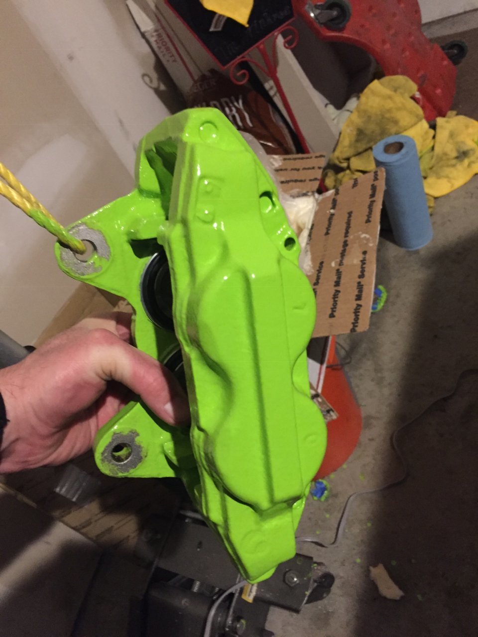

    Doing something similar but going the 5th gen 4Runner brake calipers and rotor upgrade. Had to touch them up with some G2 Lime Green caliper paint.
    28FBAEC4-C84D-465C-85C2-2E0D90D9292E.jpg 72DFED27-A7A6-459C-8EEE-4BB8E0CEB9AD.jpg
