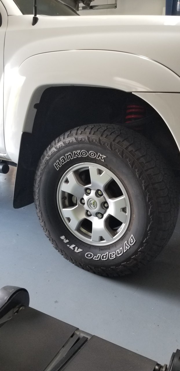

    I put on a ptr13-35150 pro kit set on my prerunner and I think the front is too high. Started at 20" center hub now at 23" center.:eek:
    Forgot before I bought the set that the 4wd is a little heavier on the front. Riding Bro-lean for a few days before aal.
    Time for some wheels and tires I guess too..Darn

    Looks good to me just slip an aal in the rear

    Im at 21" in the rear with a 1yr old tsb so I need a 2" aal at least to even out.

    That would do it yes. I prefer the ass a little higher so when you load it it isn't squatting but if level is what you like cool. You may be able to do a 2" without having to use longer shocks as well

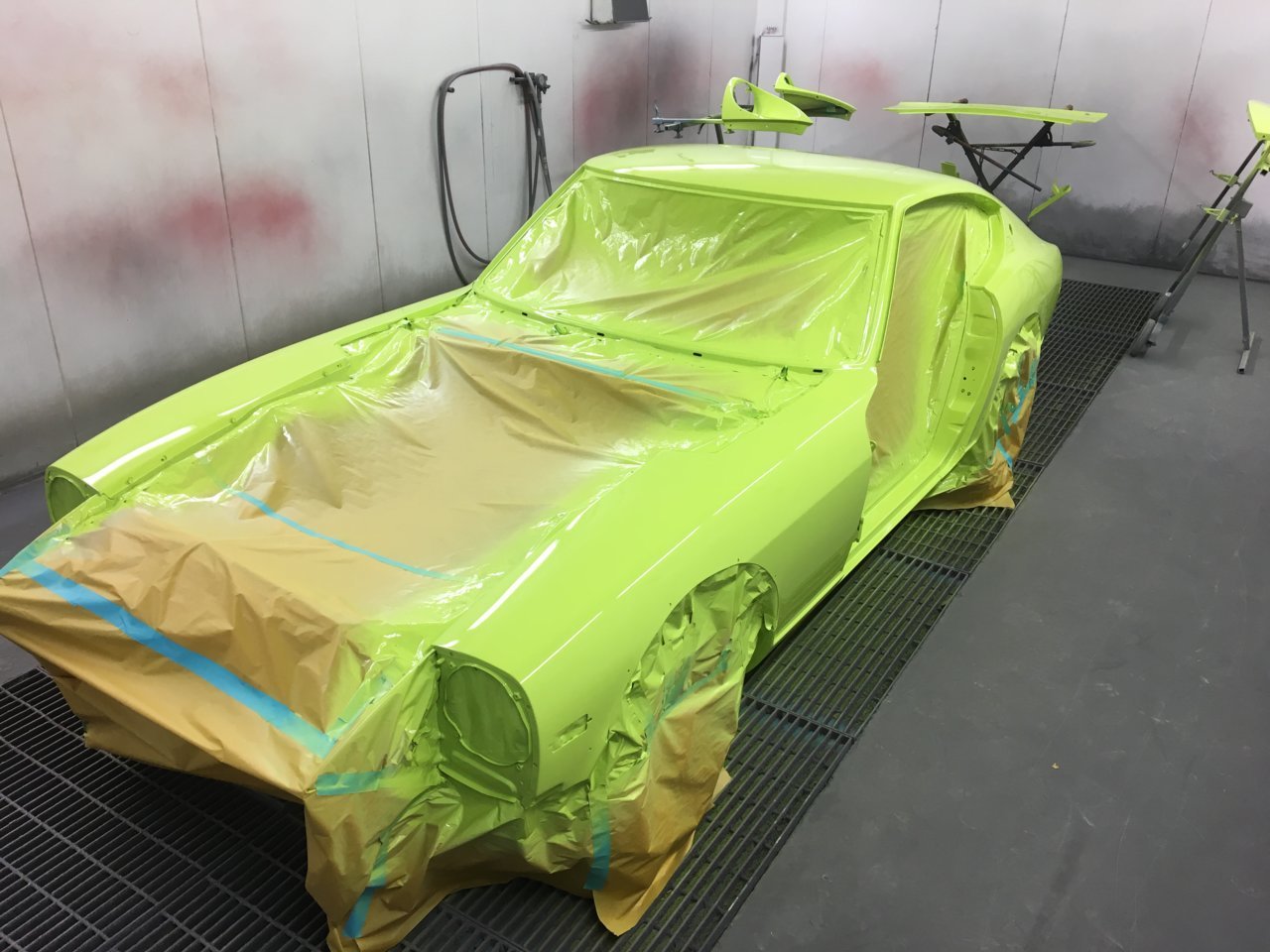

    I painted one of those last year. Very cool car.

    There are several options depending on your budget and desires. None are hard to install and you may be happy with any of them. The best "quality option" is as the other gentleman stated perhaps a set of medim duty Dakars I think they will give you about 3" of lift, don't ride harsh at all, and around $500 I believe ( I am sure if I am wrong I will be corrected). Second would be order a 3 leaf progressive AAL from Wheelers. I have had them on 2 Tacomas and got around 3" lift out of them. They ride great and work really well on the trails arounnd $160. Or the single 2" AAl depending on your usage they'll last you a good while

    If you go the 3 leaf route, on both the sets I have had, I had to remove the front alignment bracket on the overload leafs because it inerferes with the AAL. You can leave the over load leaf out and it won't give as much lift it is optional in this case. I used them because I needed the added weight capacity.

    he should be all set without removing that bracket on an 09. the newer trucks yes. I didn't have to on my 11. not sure what year it changed.
