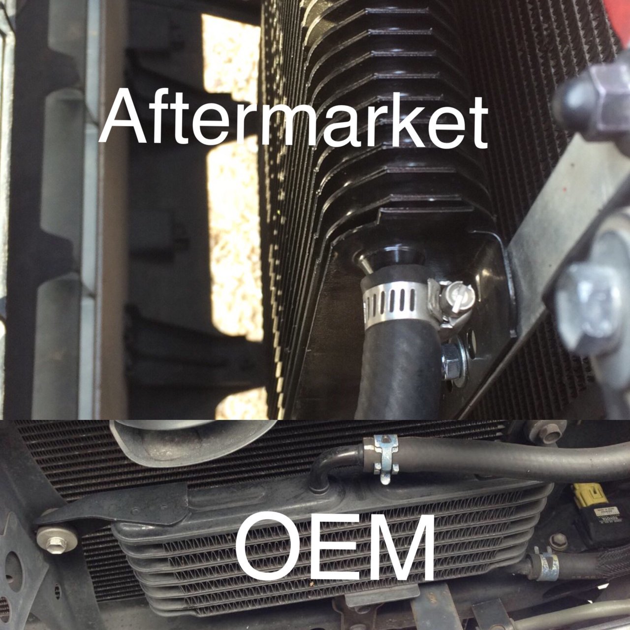

    Got rid of the tiny OEM auxiliary transmission oil cooler and installed this Tru-Cool cooler and bypassed the radiator inline cooler. She runs cool now, but not too cool. Actually helps the oil get warmer during winter, which is good.

    Helps the oil get warmer during the winter o_O
    How do you figure?

    I have an UltraGauge that displays transmission temp.

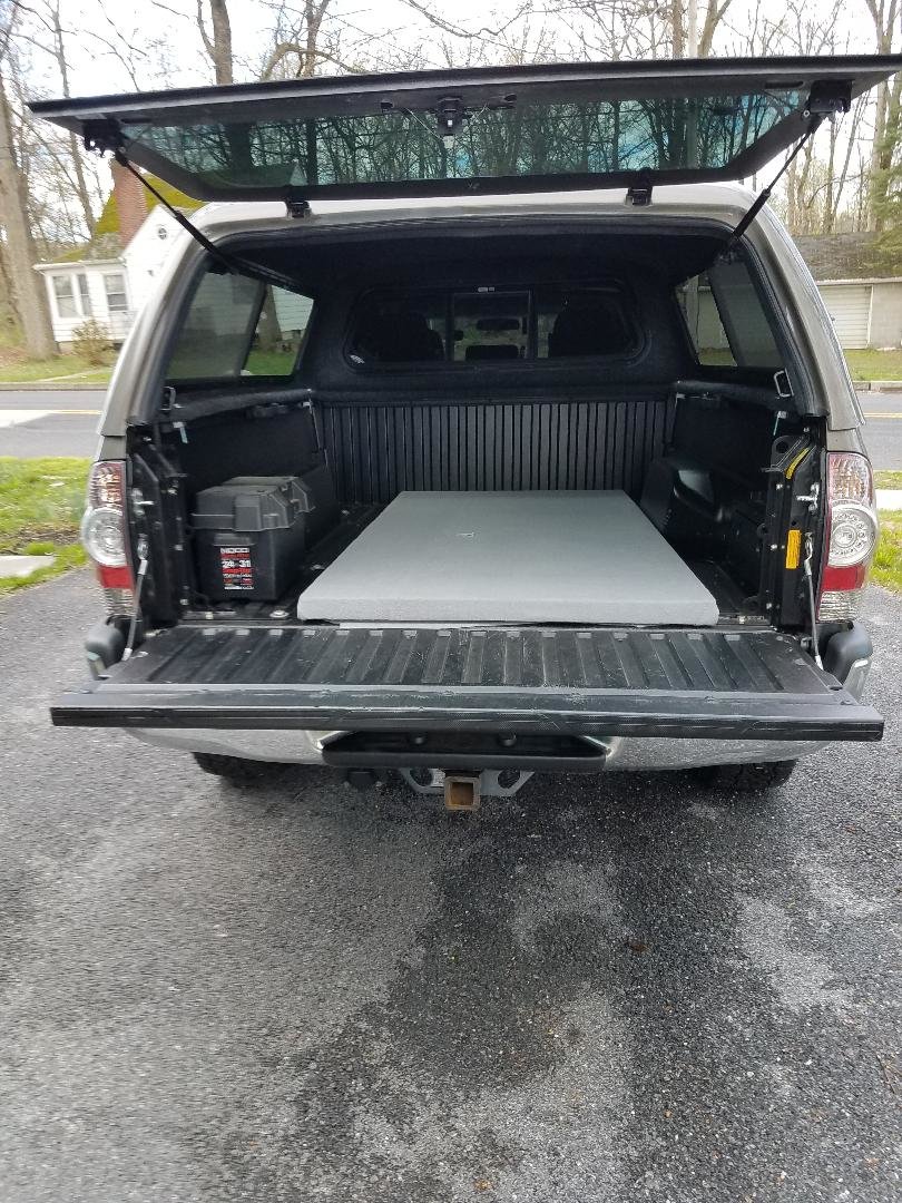

    Finished my sleeping "pad". 1" foam insulation board, a piece of luan and a small 1x3" frame so I had something to staple the fleece to. Not at all fancy but it's light and flat which were my 2 main criteria. I also needed to make it narrow enough to leave room for the battery box as I use a cpap when I sleep. It will certainly be a change going from my queen bed to this guy. Now I just need a cheap air mattress and I'll be good to go.

    Which model cooler did you go with, Were you able to bolt it up using the stock holes (without additional brackets)?
  12. Apr 15, 2019 at 9:09 AM
    fivefoot
    fivefoot Scarlett, Scarlett Tacoma is the name!
    Dec 1, 2016
    #203768
    221
    Temo
    Texas Panhandle
    2012 Tacoma TRD Offroad Barcelona Red
    I went with the 4589 cooler. I had to drill three new holes. I was only able to use two existing mounting holes. You can watch this video to see more.
    https://youtu.be/U5w6Wwmahhw

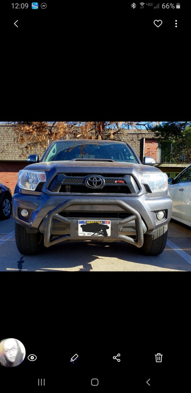

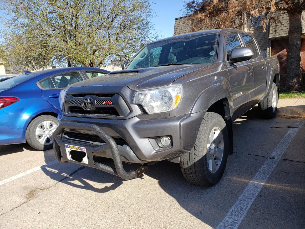

    Screenshot_20190415-121022_Gallery.jpg 20190415_120936.jpg upInstalled a
    Tyger Auto TG-GD6T60027 Front Bumper Guard in black. Took about two hours to install. No cutting just bolt on. Remove the front grill to get those hard-to-reach areas. I also added a stubby antenna.

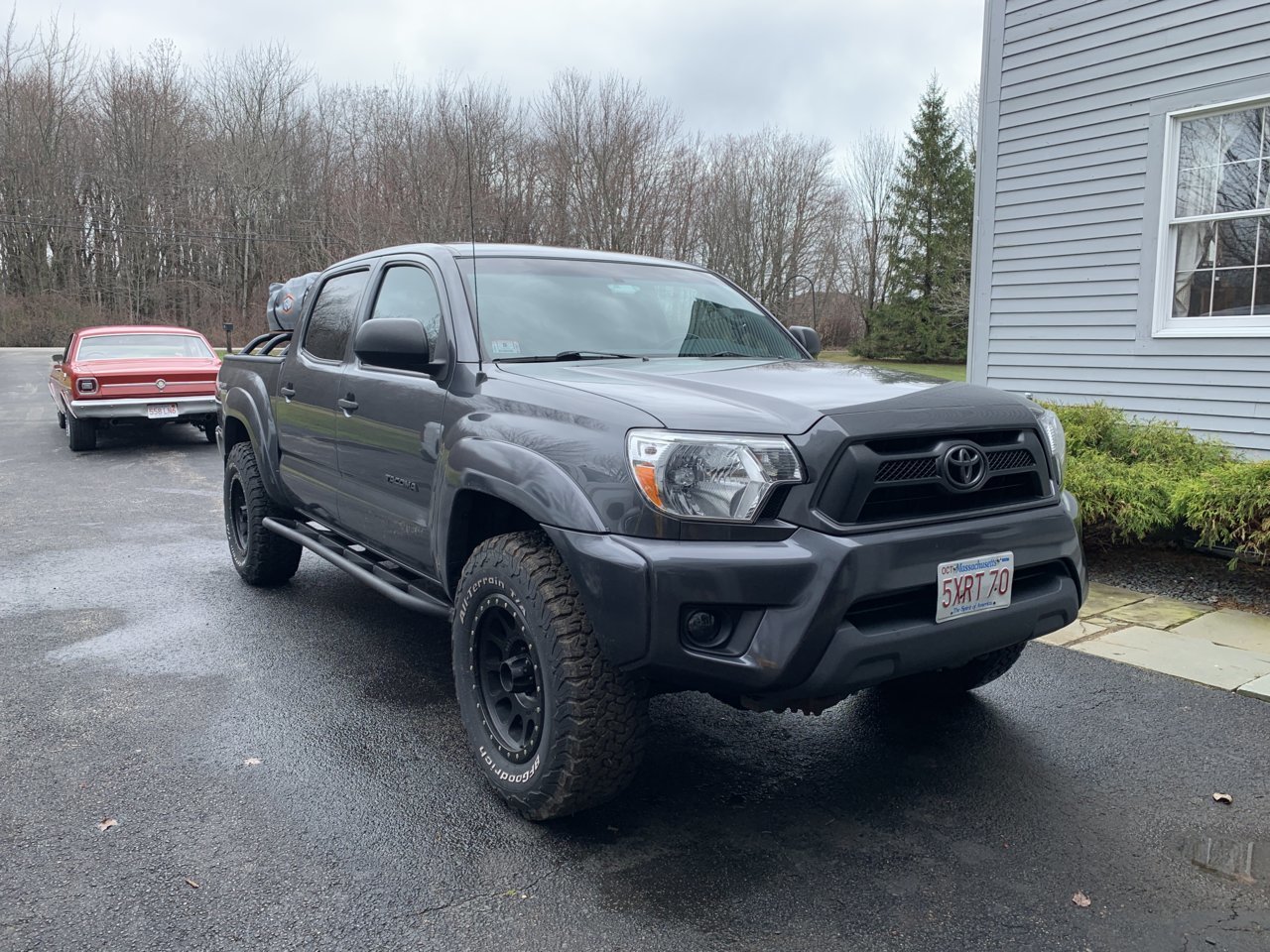

    Mobtown bolt on sliders installed. Fairly easy except for the rear driver side bolt next to the gas tank.

    For me it was the ones you have the washer on the stick for the boxed section. The first one was tricky. The second was easy.
    Also damn near lost my thumb on the one right next to the sharp AF cat heatshield.

    Love my Mobtown sliders. Solid stuff. Best of all, it protects from door dings.

    Yeah the boxed ones were kind of a pain. I POR15’d and bedlined my sliders so trying to get the bolt through the hole was a pain. Had to file it a little to open it back up.

    Did you put the flares back on?
