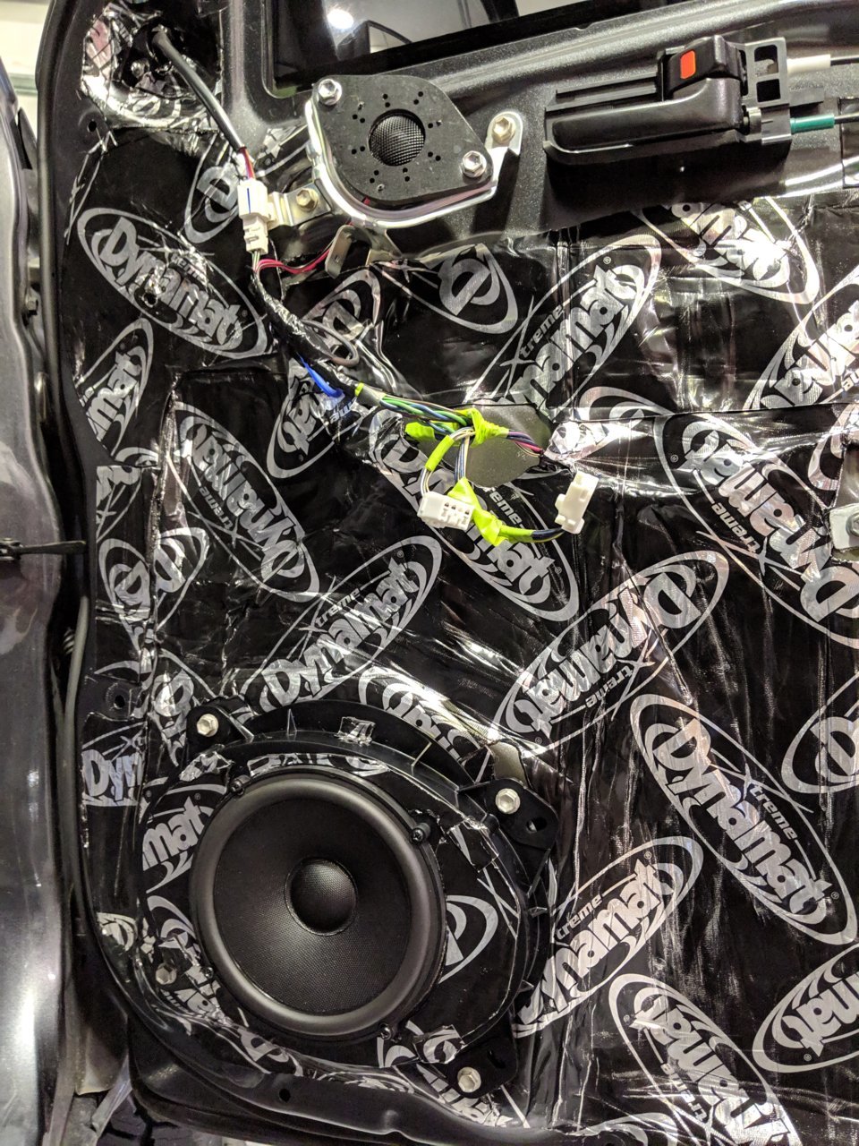

    Partway through my stereo install, did a lot more today.
    - Complete coverage of inner AND outer door skins with deadener
    - Infinty C2 components in all doors. Found an excellent little pocket in between body panels just in front of the doors to tuck the crossovers into. Stoked on that.
    - Alpine 90w x4 amp under the drivers seat
    Today:
    - Installed 7 band EQ with volume knob, sub gain, and aux channel. Chopped out tons of plastic and supports under the pioneer deck to fit it in where the clock/hazard assembly was. Formed some new, simple mounts for everything. I'm not the best with metal so the finish isn't great but it's structurally great and allows for a lot of space behind the eq and deck.
    - Used oscilloscope to dial in max volume/gain without clipping on Deck, EQ and amp separately.
    To do this weekend: full deadener/CCF/MLV on firewall/floor/back-wall. Add capacitor onto distribution block in preparation for sub amp. Take measurements to make custom 10" sealed sub box for behind the seats
    The goal for tax season next year is a system redo including JL C5's, audio source 4-channel, JL HD 750/1 and 2 - W6 10's. But for now this mid level system will be great.

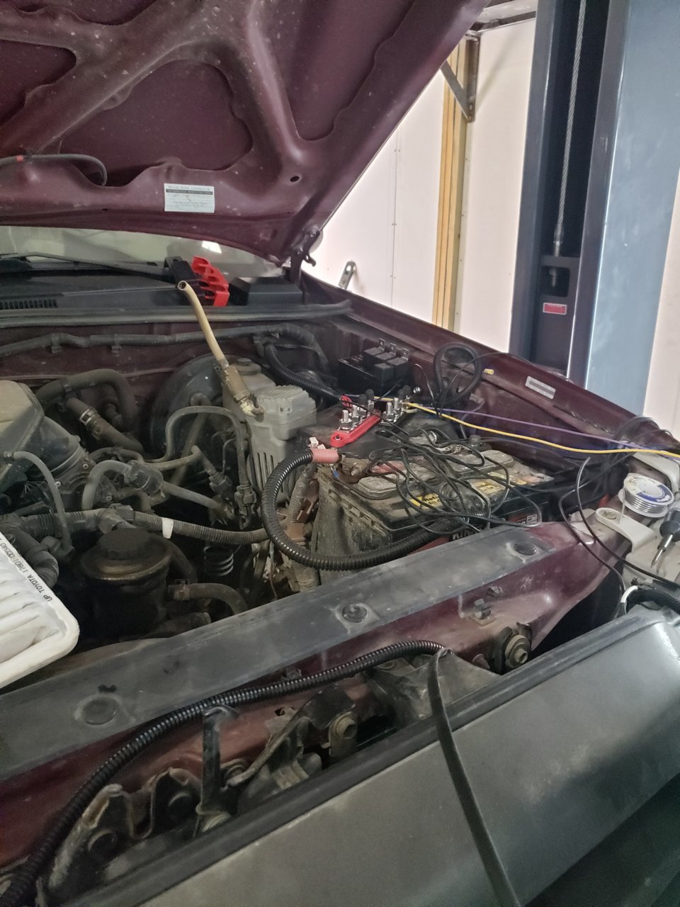

    Finishing all the wiring for dual compressors and front locker. Next is snorkel and bed stiffener as well as jba control arms

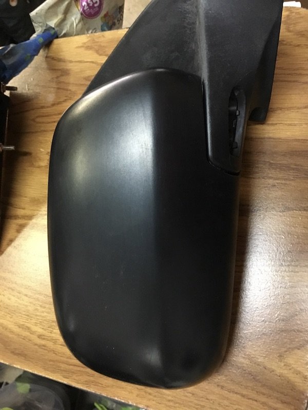

    finished re-finishing the L&R mirrors. Krylon truck bed liner & Rustoleum satin black to finish.
    Scuffed before adhesion promoter.
    After semi-gloss;

    Very nice, I did my bumpers and flares with tintable bedliner (silver streak), I'm gonna do my door handles and mirrors this weekend.

    Thanks!
    I have to do my door handles! I get constant dirt streaks running down the doors. I guess I'll do the same treatment to them as I did the mirrors. I think also, that the plastic gaskets behind the handles have dried out as well and don't seal tight against the doors, hence the streaks.

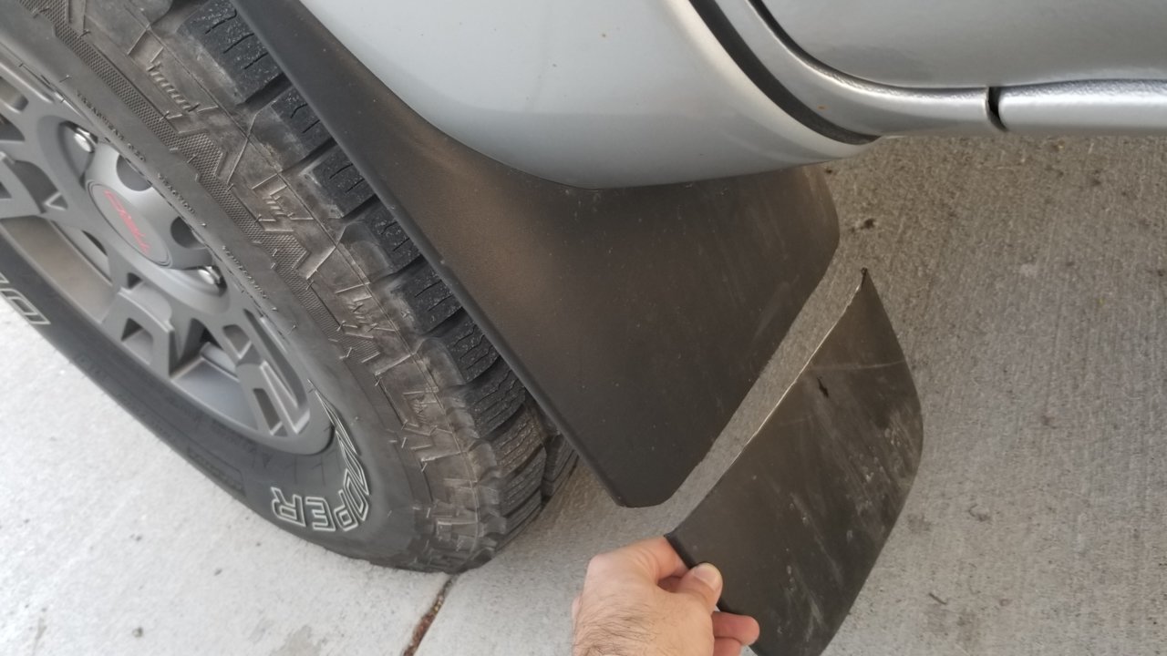

    Hiked her skirt up a bit this morning. My utility knife ran from the bottom of the body to just above the 4x4 on the rears, so used that as my "measurement" up front. Rounded the corners a little with shears and then deleted the front airdamn flap too now that it was rubbing with the new wheels.20190419_094425.jpg 20190419_094639.jpg
