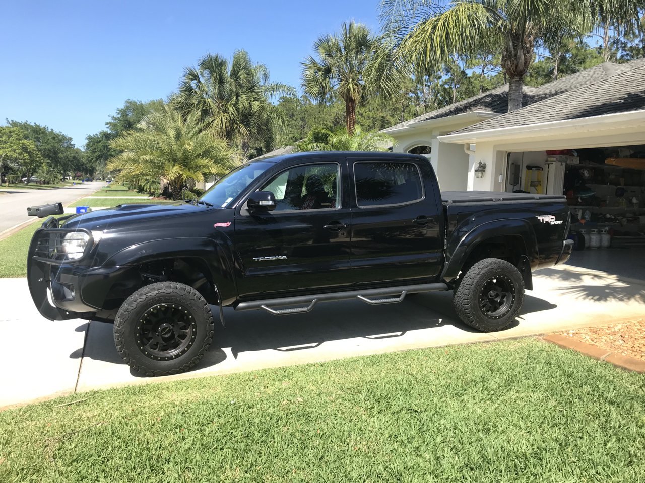

    OME 886 coils, OME EL096R HD leaf springs and Total Chaos UCAs DONE! Overall lift 3 1/4". The Westin brush guard, Bulletproof Fabricating skid plate, front & rear bumpers will come off in July to be replaced with Mobtown plate bumpers and Smittybuilt X20 Comp Series10k winch. When the KO2s wear down a bit more I will replace the stock (265/65R17) tires with 275/70R17s. Clearance is fine for this size change. Stock tires look tiny now!3 inch lift.jpg

    If you haven't already, you might want to cut down the u-bolts enough to ensure bottoming the bumper doesn't allow frame contact with the bolts. If you suspect you might need pinion shims for prop shaft angle alignment to combat drivetrain vibes, you might want to leave some threads for that possibility. It's hard to tell from this angle if they are above the bottom edge of the elastomer bumper.

    Looks awesome bud. How does she ride on 886's? Enjoy!

    I was concerned but I'm really surprised and happy with the ride. I had already removed the sway bar and now, after changing from the 885s to the 886s, there is nearly ZERO dive in abrupt turns. Its stiffer than it was, but it's now truck firm and not the plush road car ride of stock or even the 885s which were awesome. The EL096R HDs are great too. And this is all before the bumpers get swapped and winch installed. Love it!

    I had the same experience when i put 886s and Dakar HDs on. Took the sway bar off and never looked back. Handled just like my Honda lol

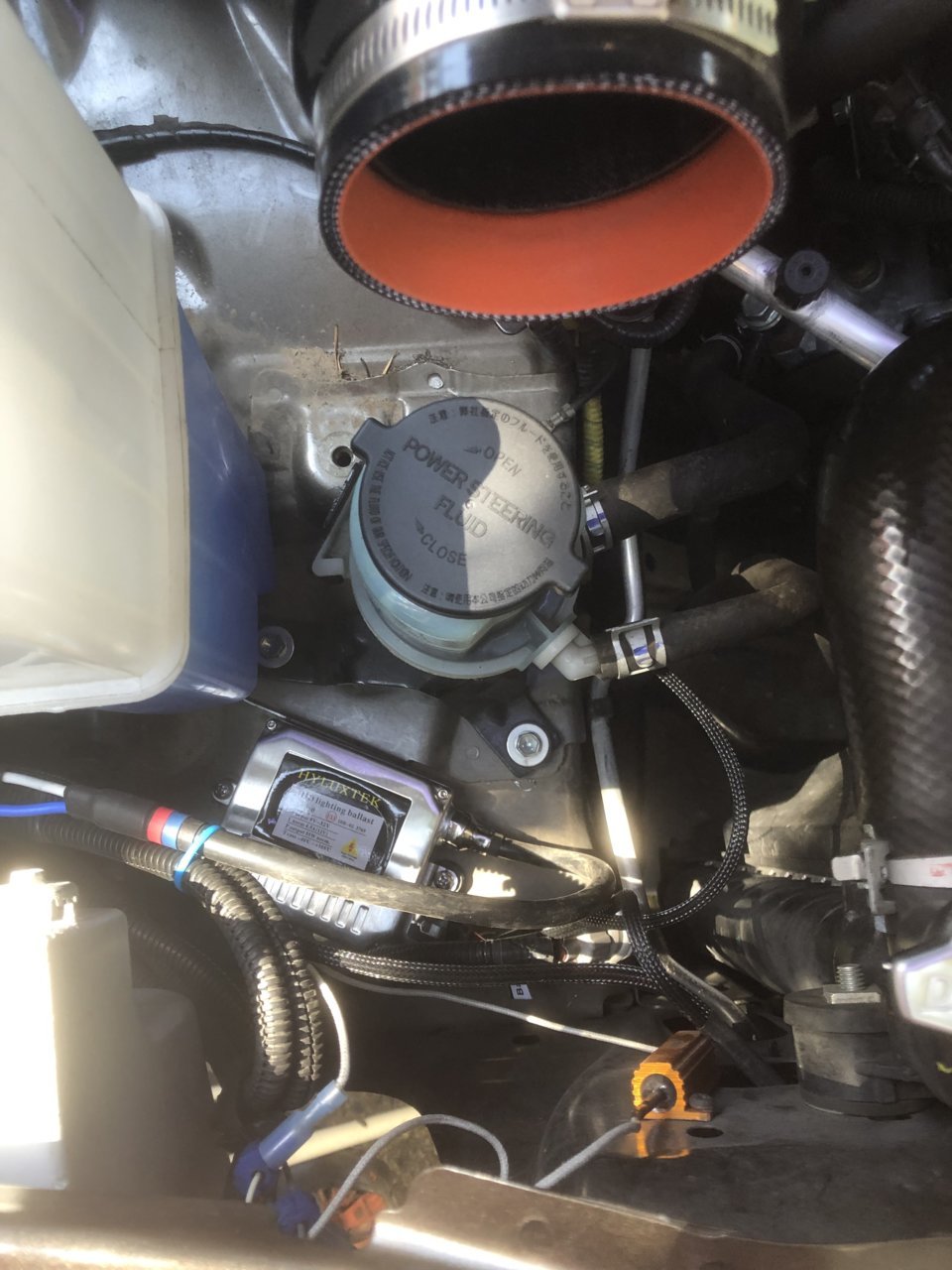

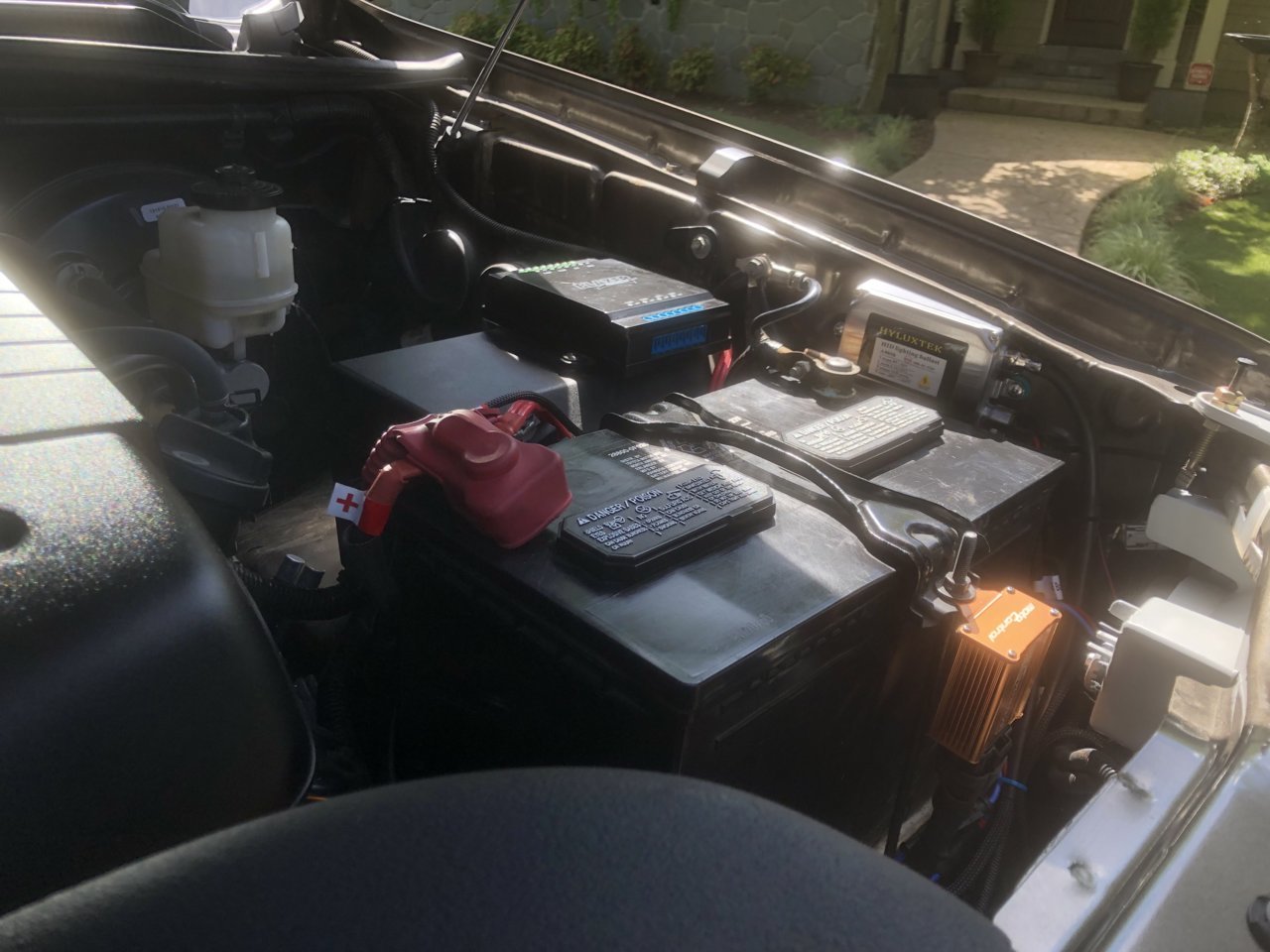

    Mounted my ballast's better and cleaned up some of the wiring. Still more to do. Nice day out so snapped a picture after I was done and she was back in the drive away from the garage.

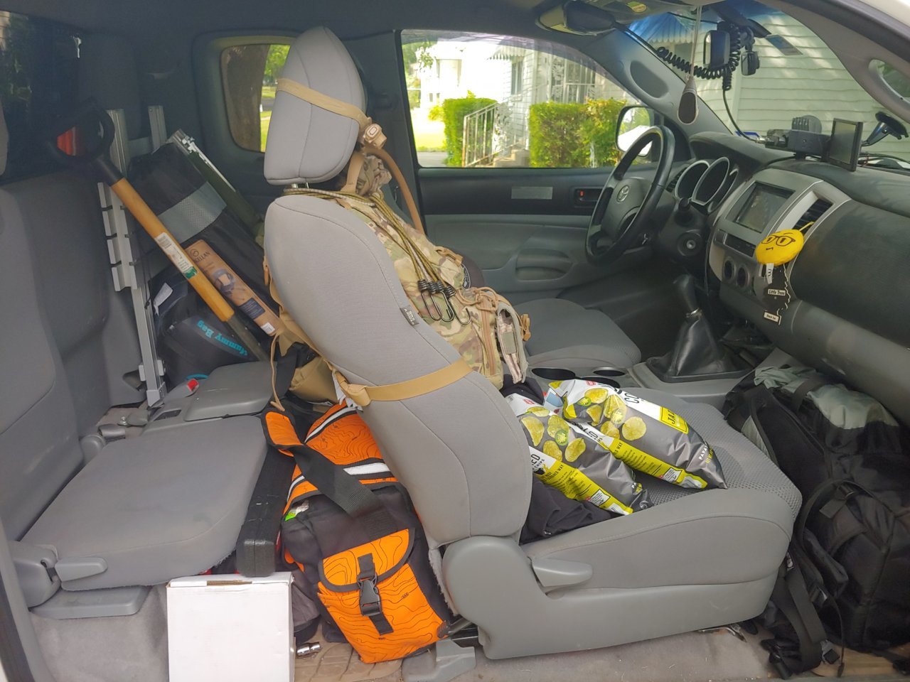

    Packed for some fun at the Texas Toyota Jamboree

    CHIPS - CHECK
    COOLER - CHILLED
    BEVERAGES - LOADED
    CAMELBAK - HOSE EXTENDED
    FUEL - CHECK
    TAKEOFF - COMPLETE

    Hundred percent lol

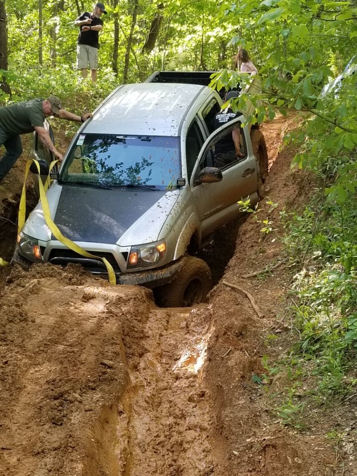

    Played lawn darts in the mud! Mitchell in his 4th gen 4runner won he didn't face plant as bad. @FadedComa played too and lost as well.

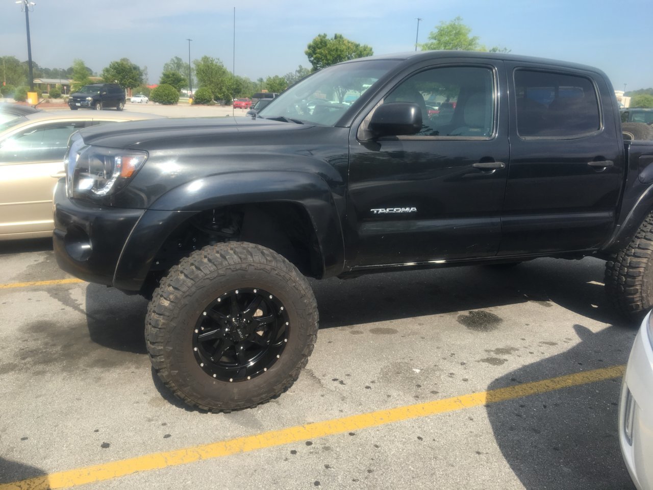

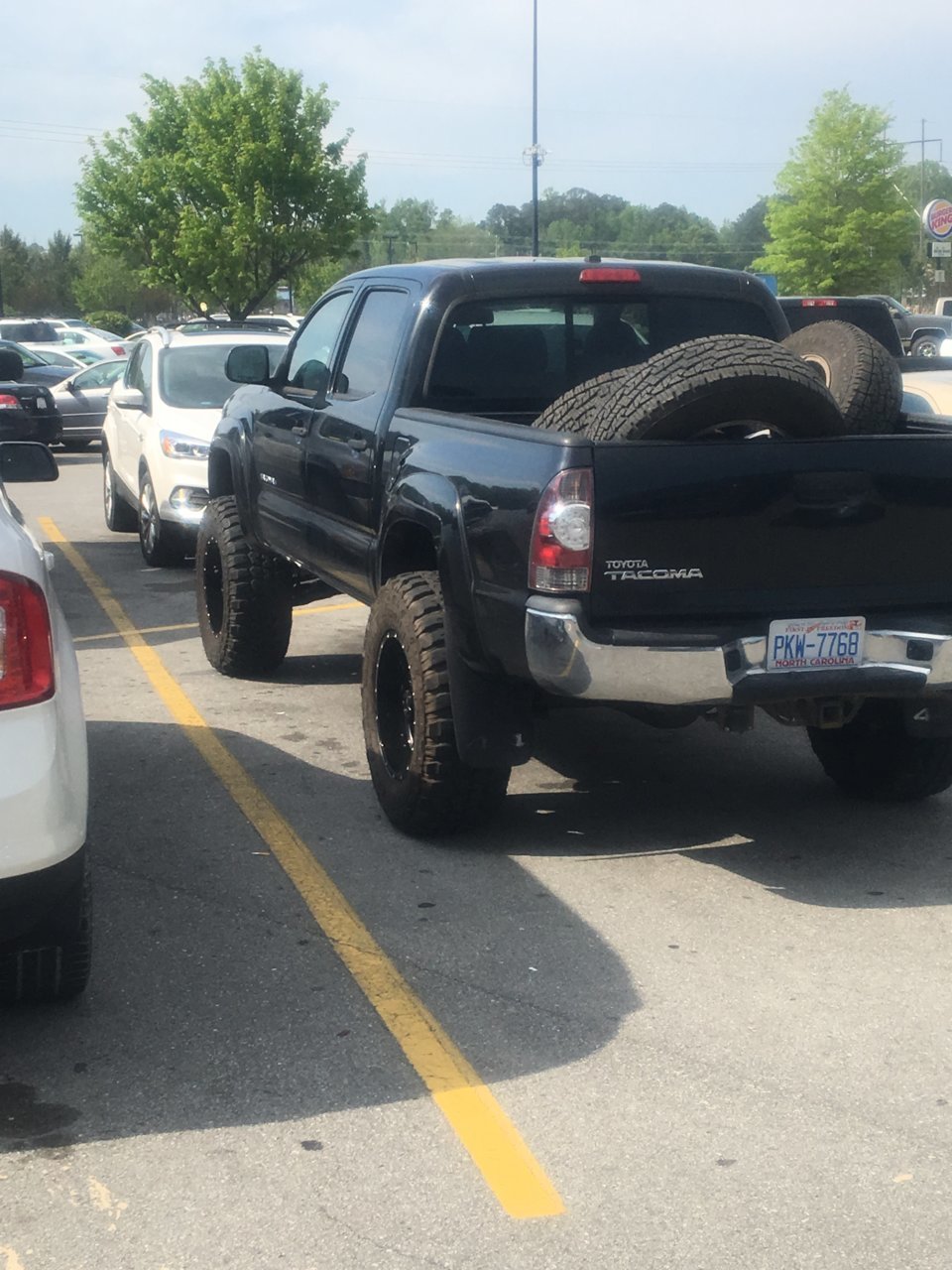

    8E2F6629-517F-450D-9621-E45506427CD2.jpg 0EBA889B-3D9A-4CCA-9F82-E439DA8B6DCE.jpg
    RC 6”
    Federal Courgia 35x12.5
    Tuff 18x10s
