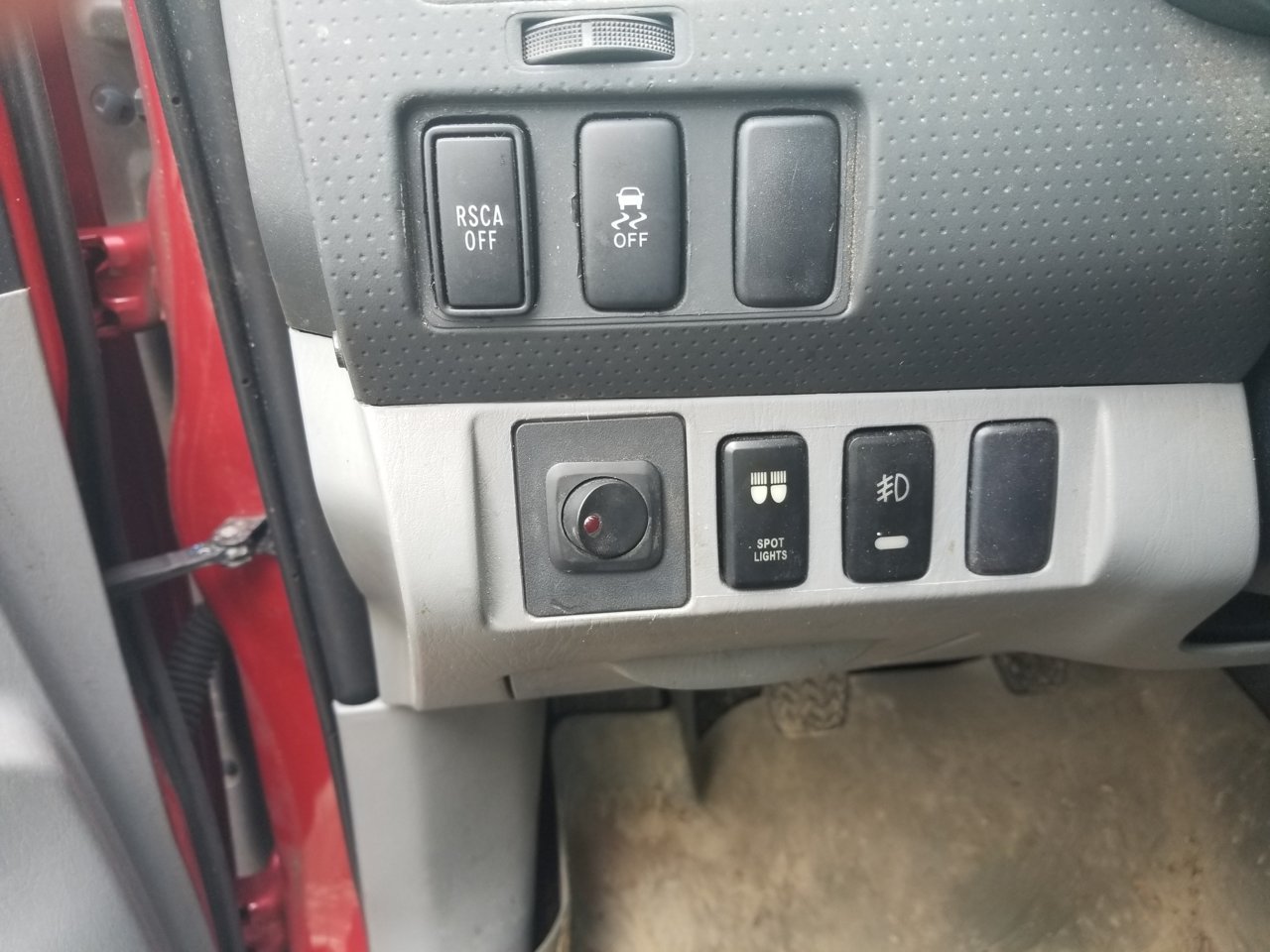

    Just fyi you can disconnect the clutch cancel w/o any problems for xtra space. I never used mine so I deleted it & moved switches up top in the blanks. Switch on far top right will be rear locker eventually. This way I can keep all lighting together.
    Bottom is (left to right)...
    Fogs, spots, bumper light bar & last will be ditch lights.

    You can disconnect the clutch cancel switch or just completely bypass it by junpwring the male connector down near the pedal.
    Did this with mine. You lose the safety interlock feature but you can start the truck without pushing the clutch in.

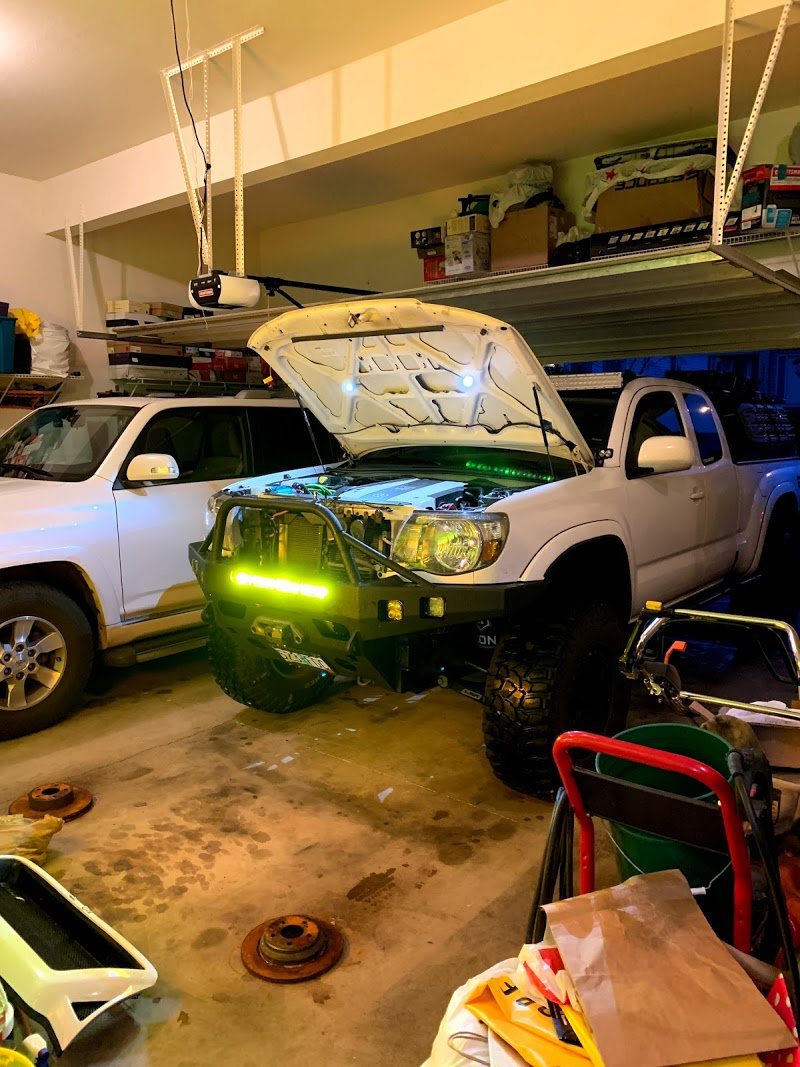

    my truck shoots rainbows :rofl:
