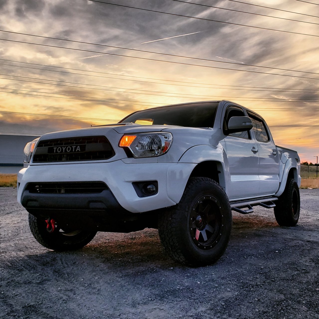

    Woke up at 4AM, installed my skid plates and had the truck alignment done this afternoon. Love the kings, ride is amazing, best spacer lift ever.

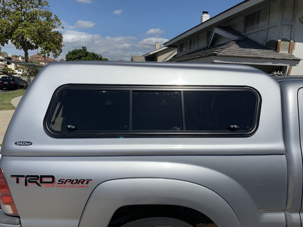

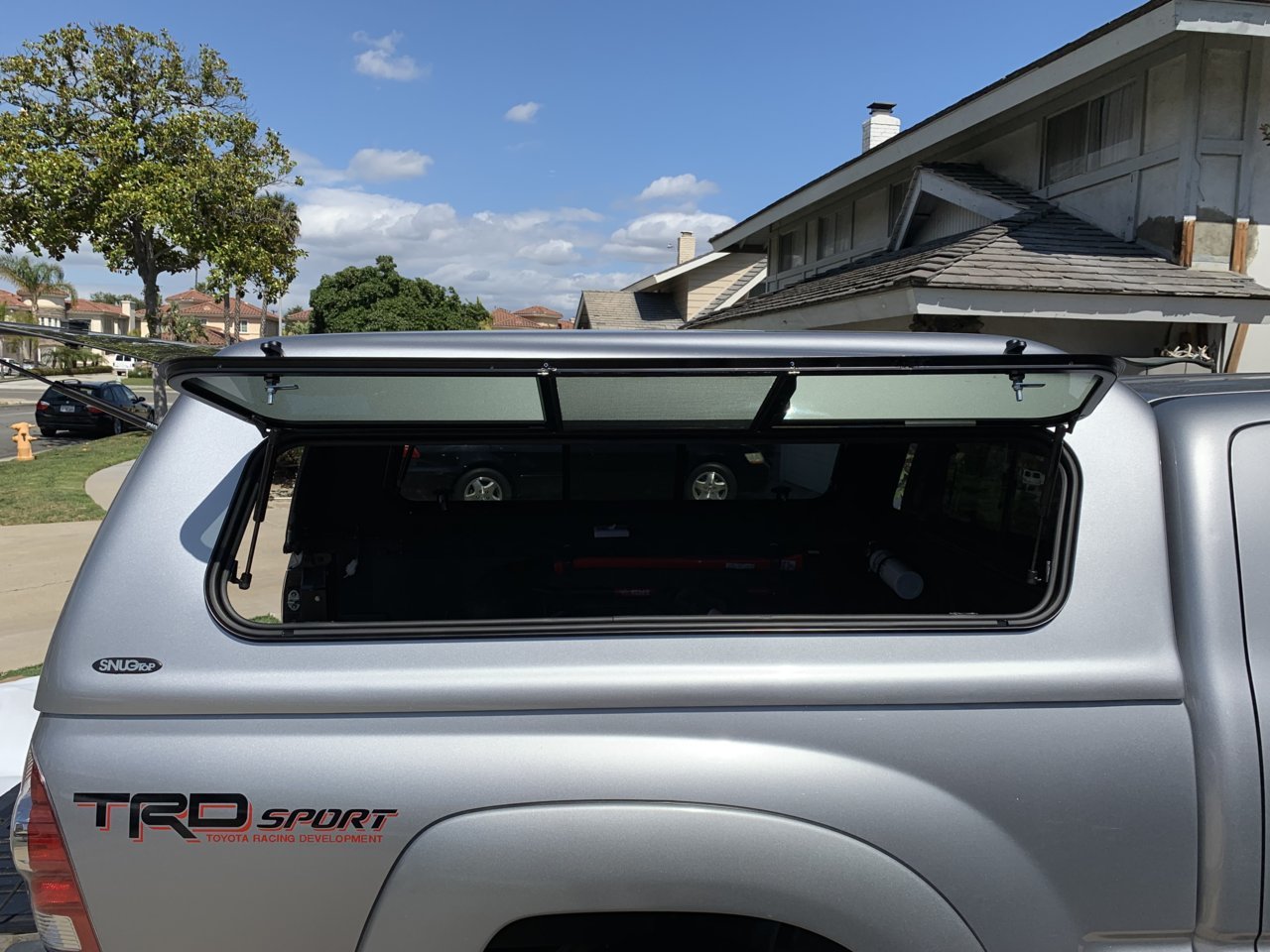

    Finally got around to buying and installing a vented windoor for the passenger side of my shell. I had already done the driver’s side late last year but held off on the passenger side due to the each window’s price tag.
    Before:
    I first masked around the old window and used a plastic drywall knife to wedge under the bezel and break the seal:
    I then spent a couple hours cleaning off the old adhesive left behind:
    I then lined the bezel on the new window with molding tape and popped the bad boy in place.
    Here’s the final product:

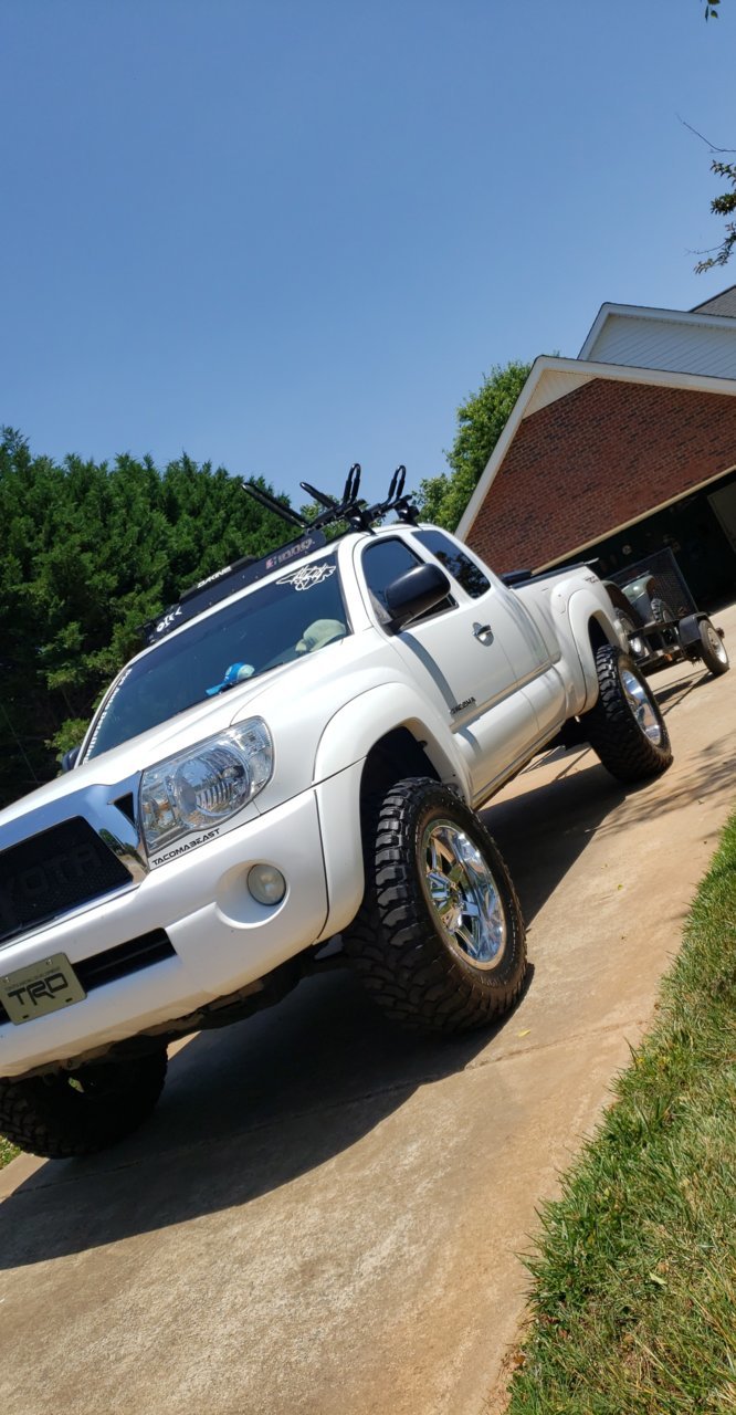

    New kayak carriers put on today!

    What rack is that? I want one

    The roof rack is an Inno roof rack and the kayak rack is just some cheap Chinese ones off Amazon lol. :rofl:

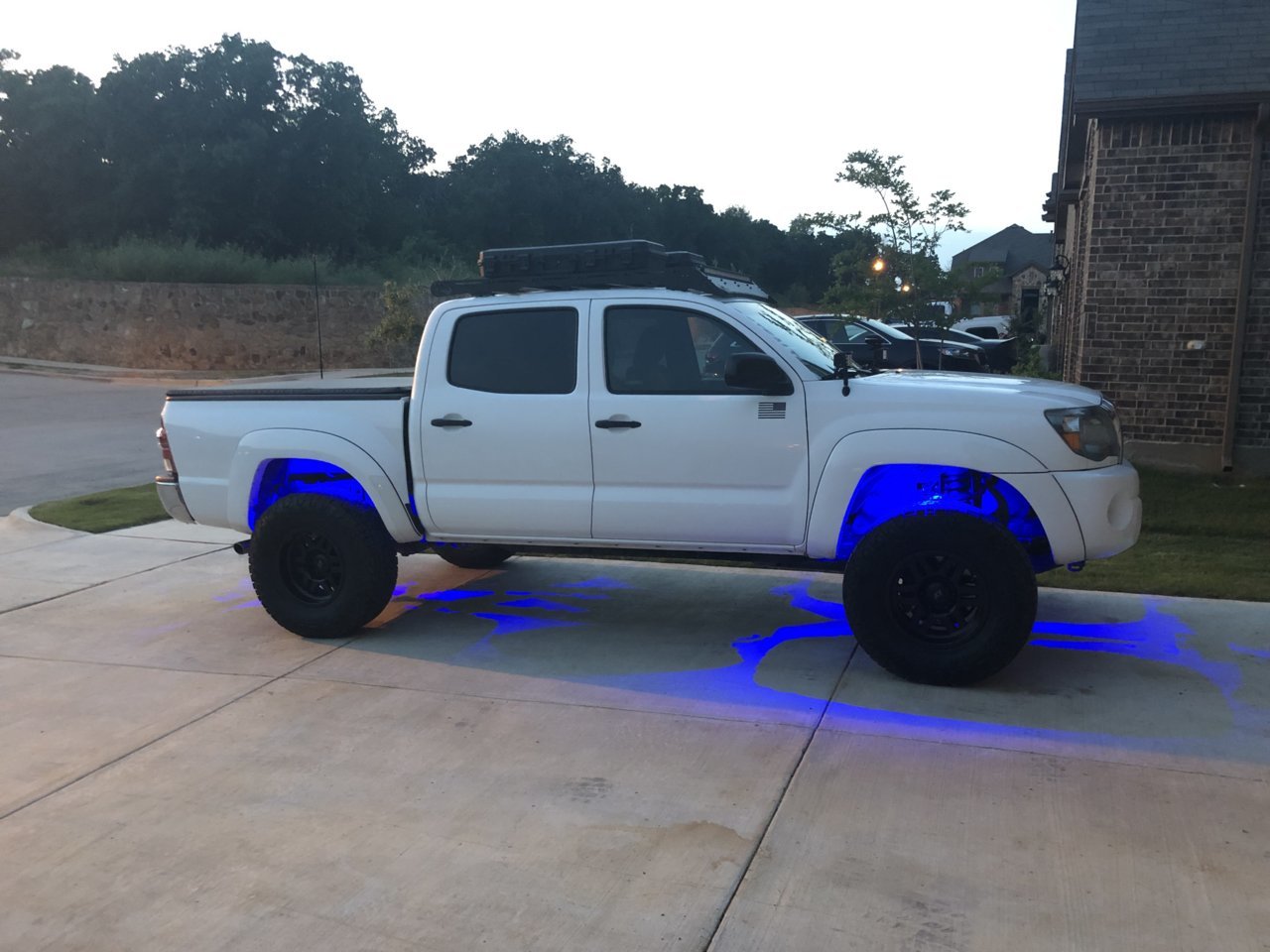

    Installed 4 out of the 12 rock lights i bought. Super bright and pretty beefy.

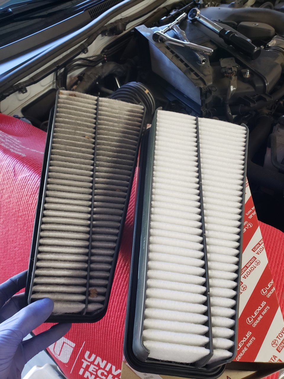

    Mini maintenance day. Plugs were overdue (40K miles), air filter wasn't too bad but had a new one waiting on the bench, and fresh pads and rotors (bday gift from the inlaws).
    and snapped a pic after bedding the pads.
