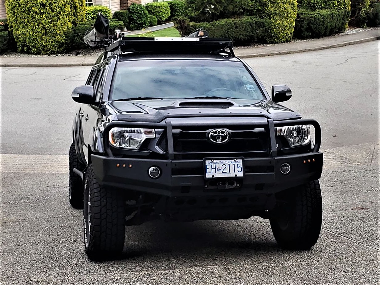

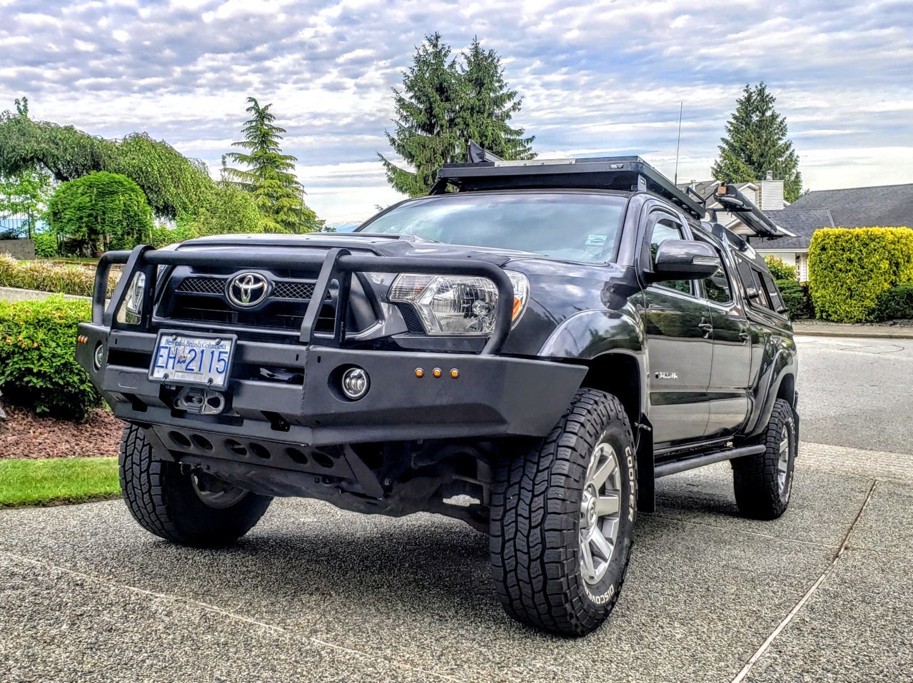

    Pre facelift ARB Bumper for 05-11 Taco made to fit post face lift 12-15's. Installed on my 2014. It sticks out 3" less than the proper year and the hoops are smaller. I got this bumper damaged for free from a friend a while back and had a local fab shop called ARC One Industries fix it and add lighting. I still need to get the fog halos wired in and ARB rubber buffers to complete the front bumper.

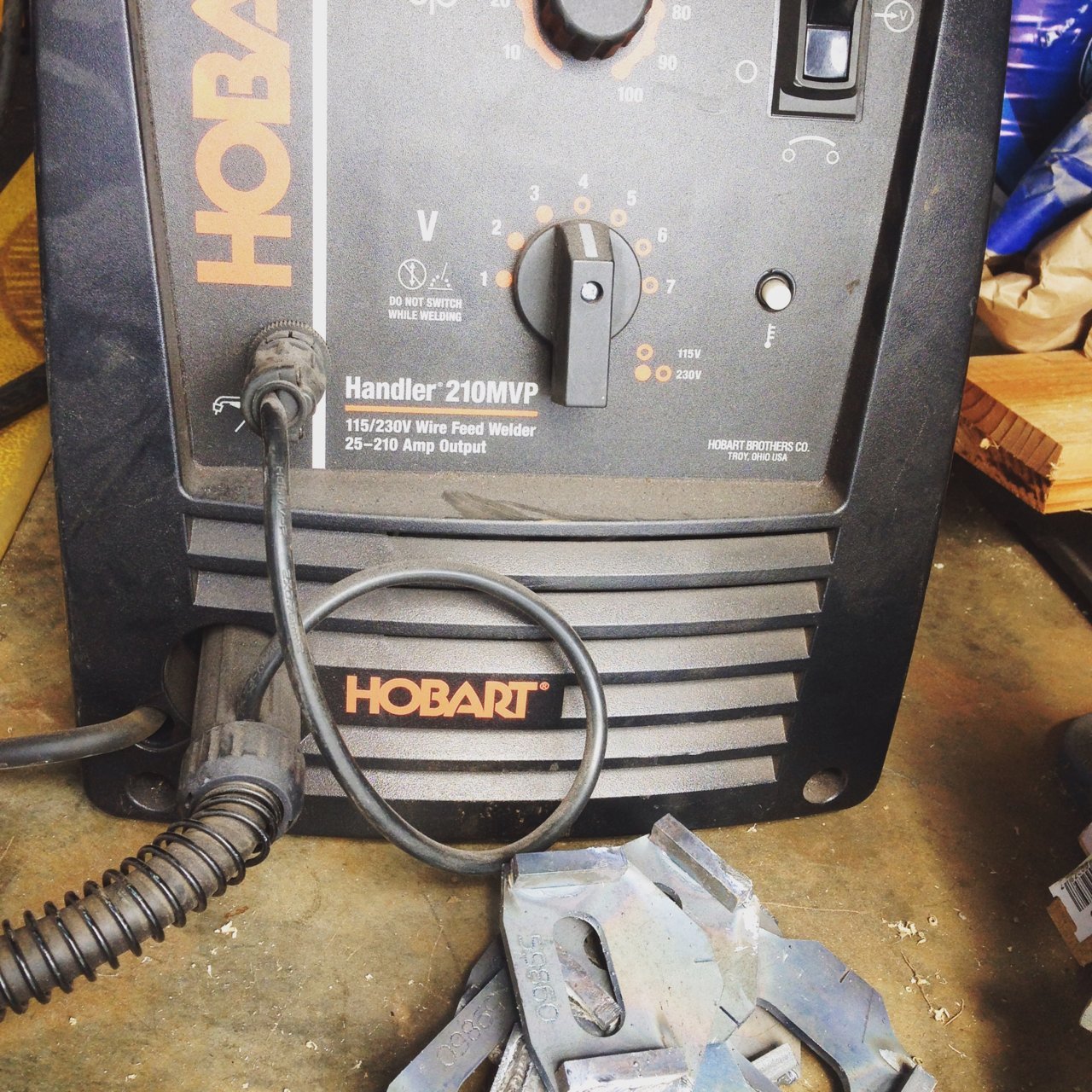

    Prepped the Total Chaos Cam tab adjusters for install. I got them all welded up now I need to grind them and I'll weld them onto the truck in about two weeks ( have work obligations)

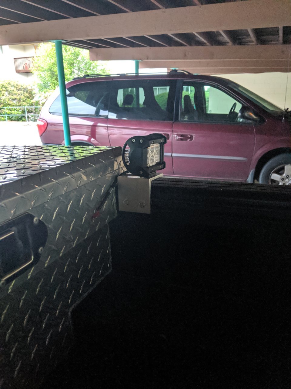

    Bed lights! Turnable

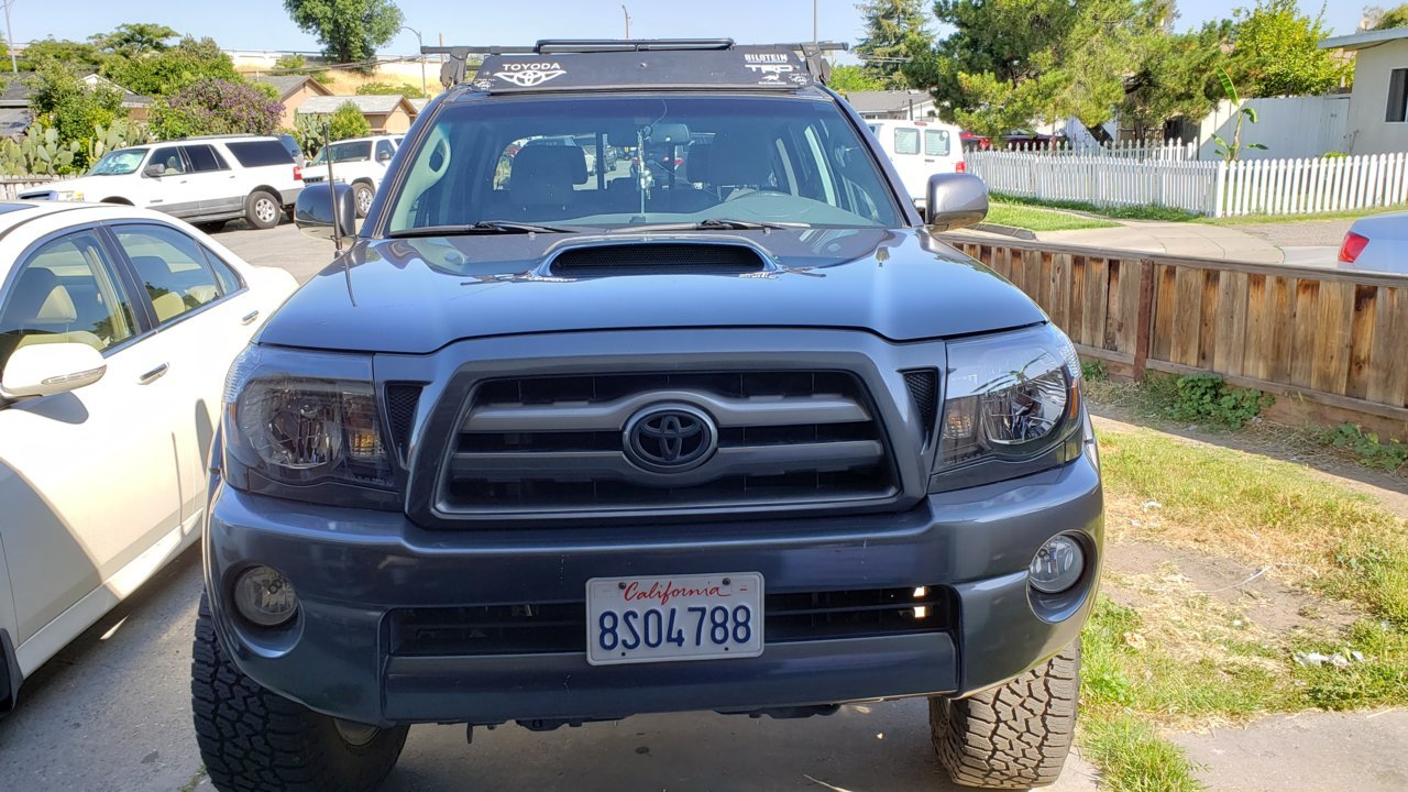

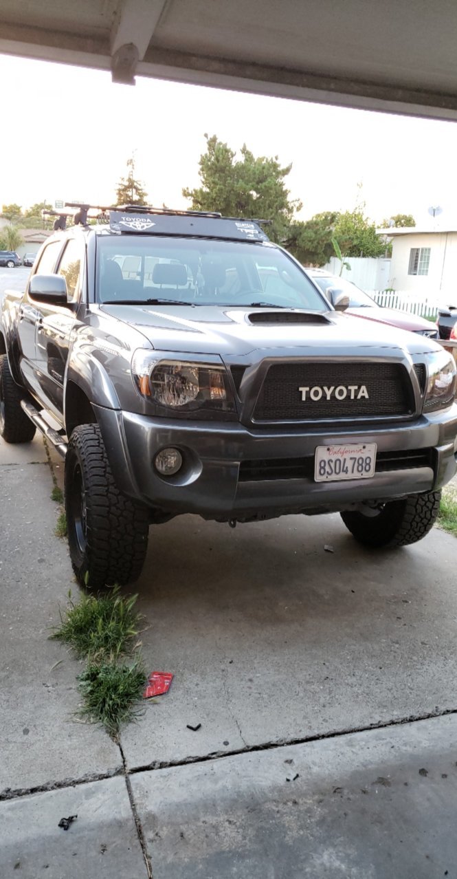

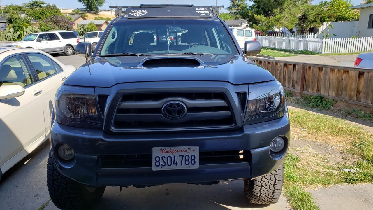

    Took the weekend to finally install a new grille. Took longer than expected with all the cutting, bondo-ing, sanding, and painting, but damn am I happy with the results.
    Before:
    After:

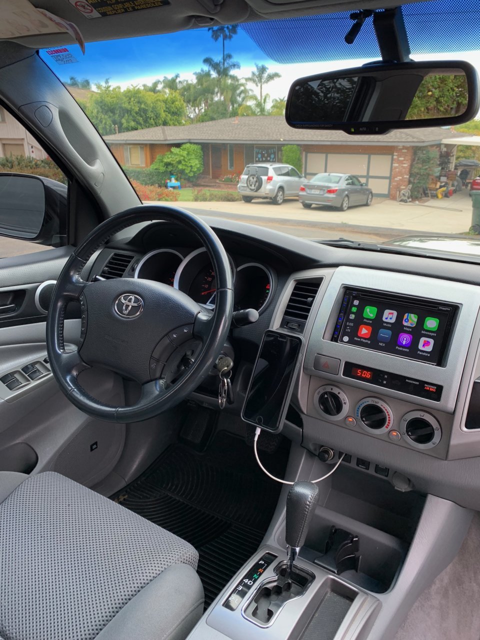

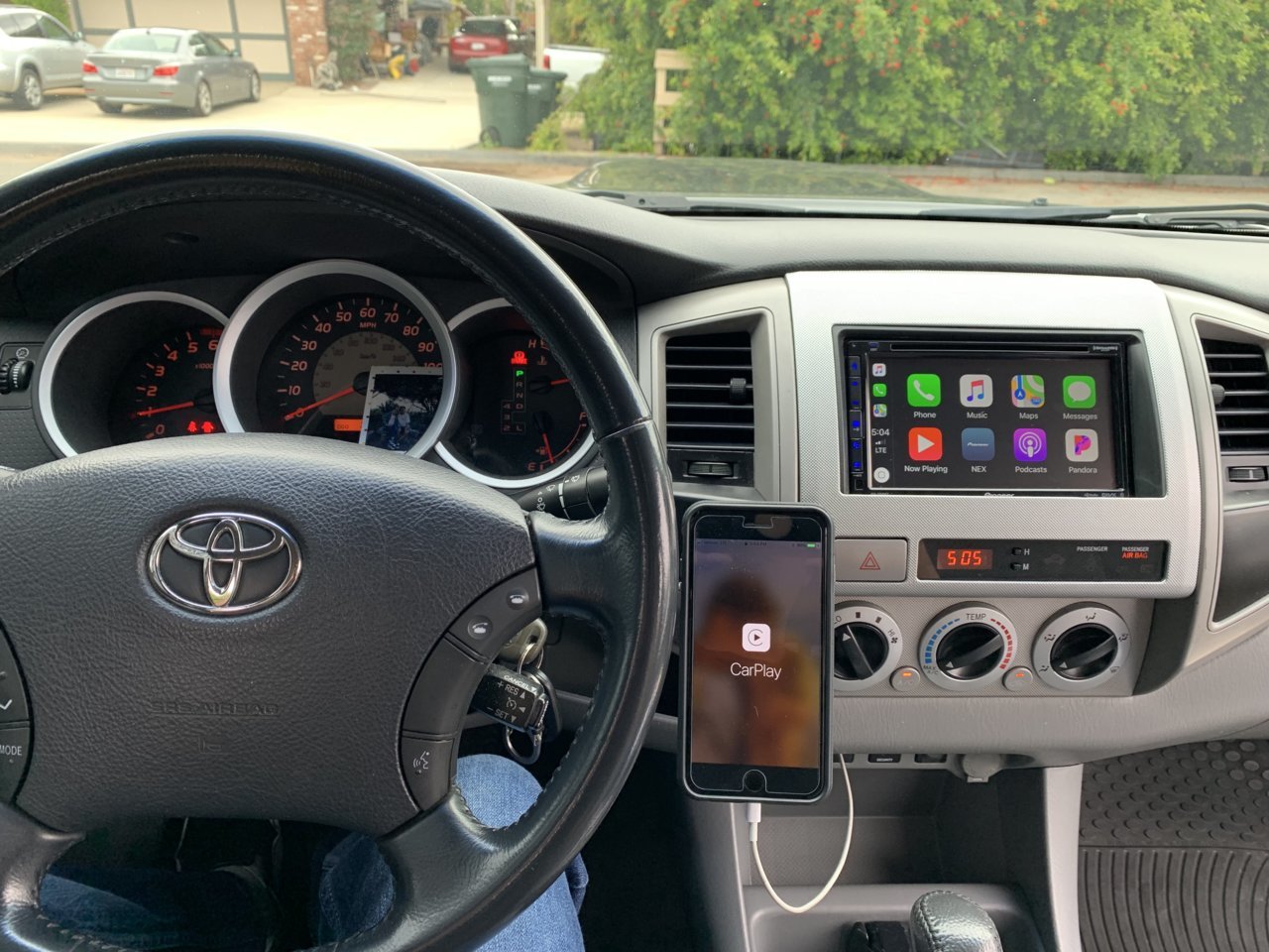

    This weekend I purchased the Pioneer AVH-2550NEX and had it installed! When they installed my new setup they routed the lightning cable for Apple CarPlay out of my glovebox (which looked terrible). So I popped out the blank piece next to the cigarette lighter and drilled a hole in the center big enough for the cable and popped it back in. I then purchased a Scosche Magnetic Magic mount for a clean looking setup. Stoked on how everything came out, it has given my 09 an updated look.

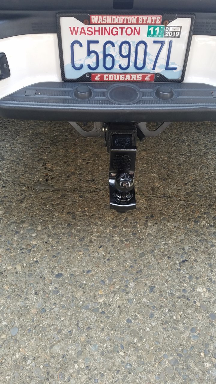

    Painted my trailer hitch black because I was bored and already had paint. Now officially all the chrome is gone from the outside

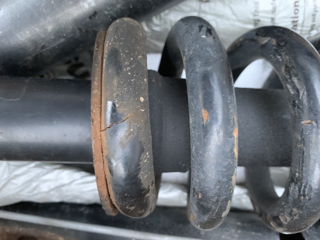

    Have been having a clunk on the front passenger side for the past couple months so finally replaced the factory SR5 struts (front and back) with TRD offroad bilsteins that I got from my brother when he lifted his (~20,000 miles on them)
    When I got them off, I found a crack in the coil of the passenger side front strut. So my question is should I take this to Toyota - I feel that this is quite abnormal? I just passed 60,000 miles this morning driving to work.

    If what you installed had springs, just huck it in the trash. That's all a dealership is going to do. They're not going to run it up to Toyota corporate for analysis. Given the rust on the spring perch, I'm sure you got some salt trapped between the perch and spring, and it ate it way like a cancer.

    Yeah I put the full Bilstein assembly in. Runs great now, havn't gotten the alignment yet but it's actually already better than it was beforehand likely because of that one coil

    Nice tie down mounts, whered you get those or did you make them.
