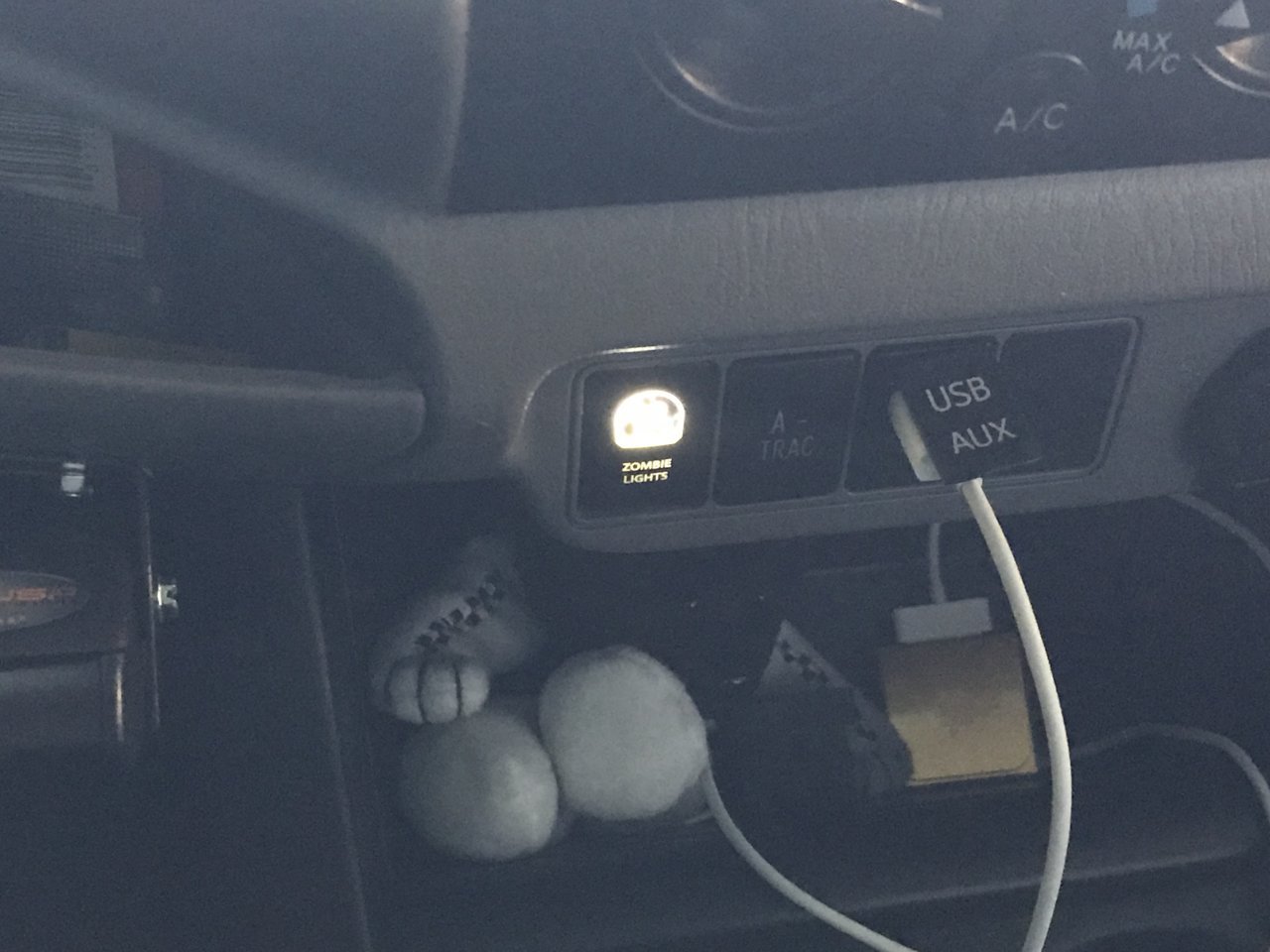

    1,300

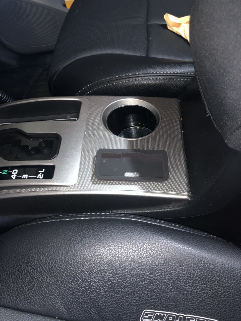

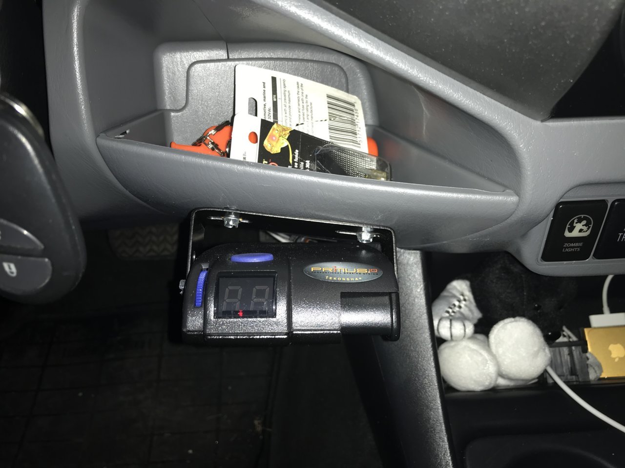

    Like the center console mounting position. I've thought about putting a light bar switch there too.

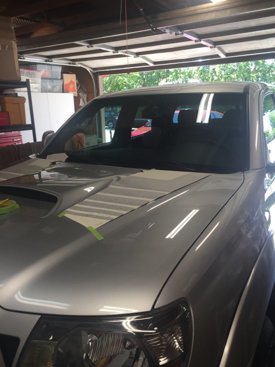

    ProComp Pro Runner shocks n struts Painted engine cover Fog anytime mod Cherrybomb muffler Bestop 3/16 tailgate plate and top cap Where do I begin with all the camo
    I like the doors. I also like the hood but i think it'd look better if the scoop was blacked out as well.

    That hood looks BOSS, Sir! Retro Hot Wheels look. Love it!

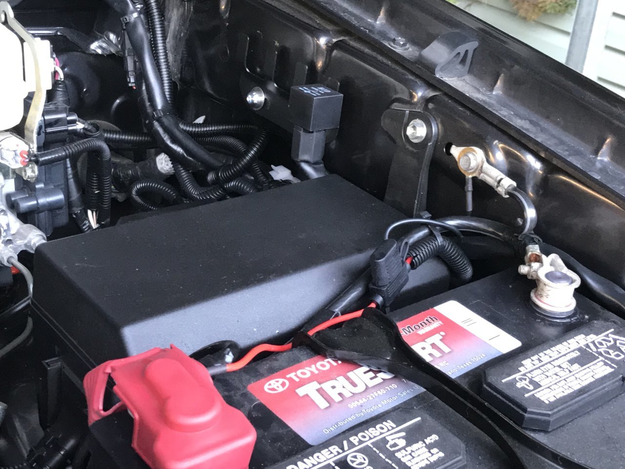

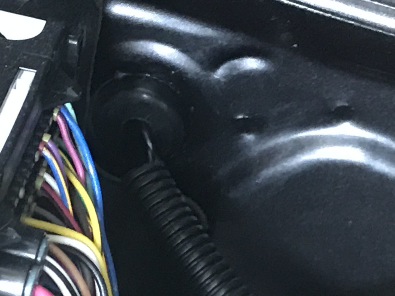

    Finally found time to wire up the CaliRaised ditch lights. I’ll have to take pics....decided to put in two locations where I can disconnect the switch especially being in the center console area. If the switch goes bad, I can disconnect under dash and tear up the bad switch to replaced and not have to take apart center console. Split the two Led's on the switch (white) so when regular lights are turned on lower led comes on. Makes it easy to find the switch. Top led comes on when I press the switch on. Decided to go through firewall at grommet just right of brake fluid. Purchased one from Lowe’s. Just took my time. Want pictures?

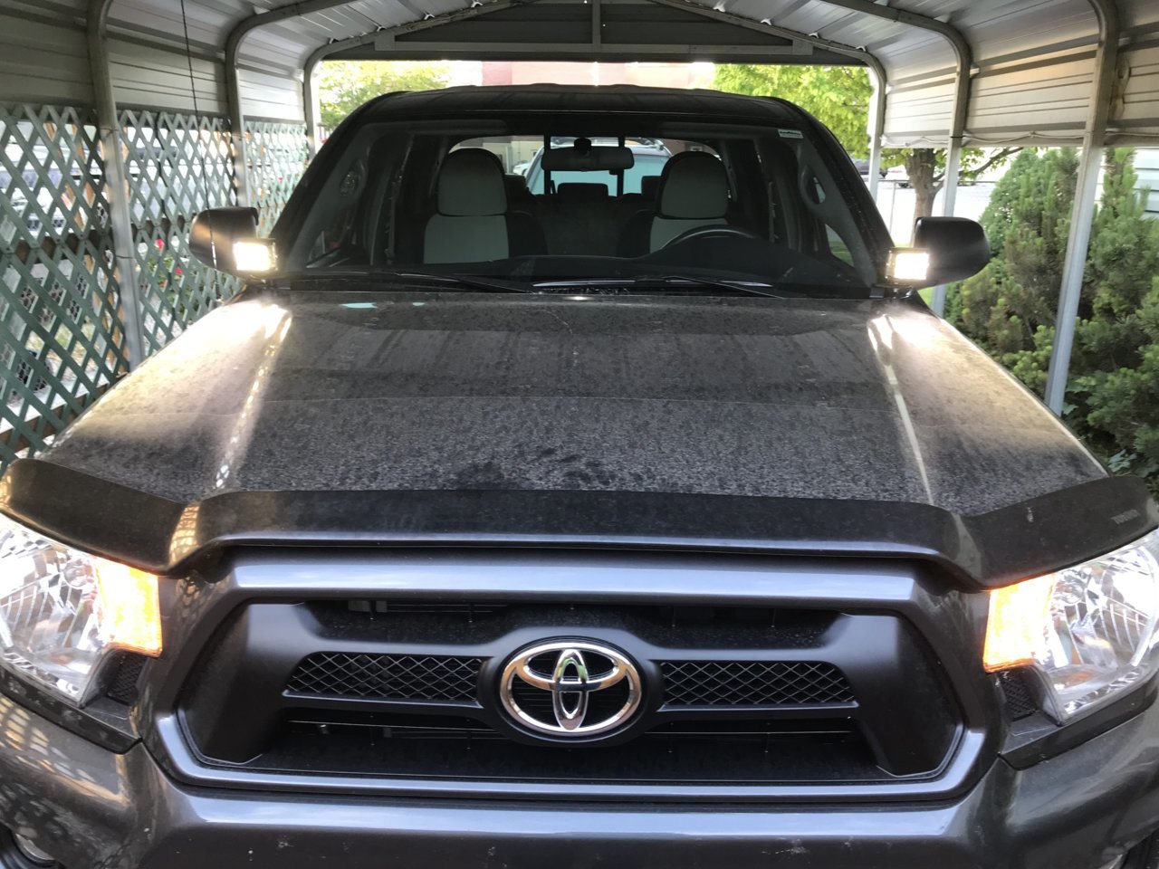

    I have a switch that says ditch lights, but wanted something different—more entertaining.
    Added relay plate from Caliraised where I can add 3 more relays for future.
    Picture doesn’t show it, but wire is tight through grommet.
    Clean install of wires. Redline tuning hood struts should be standard from factory. Installed these months ago. Had them also in my 05.
    Since I tow in the Rockies, knowing transmission temp is mandatory.
    Caliraised ditch lights. No switch locations available on left side. Had to use center.

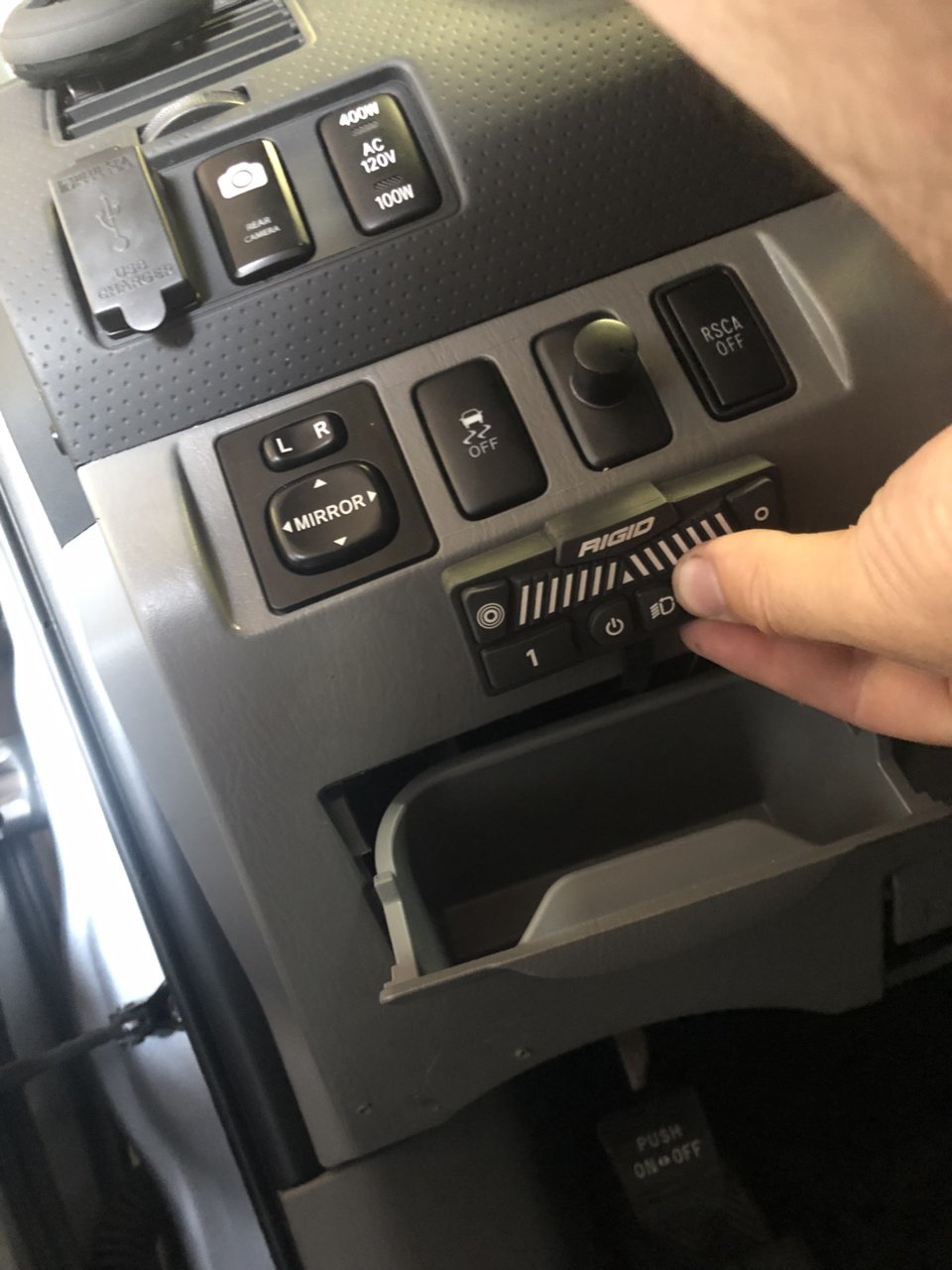

    It’s my rigid adapt light bar control
