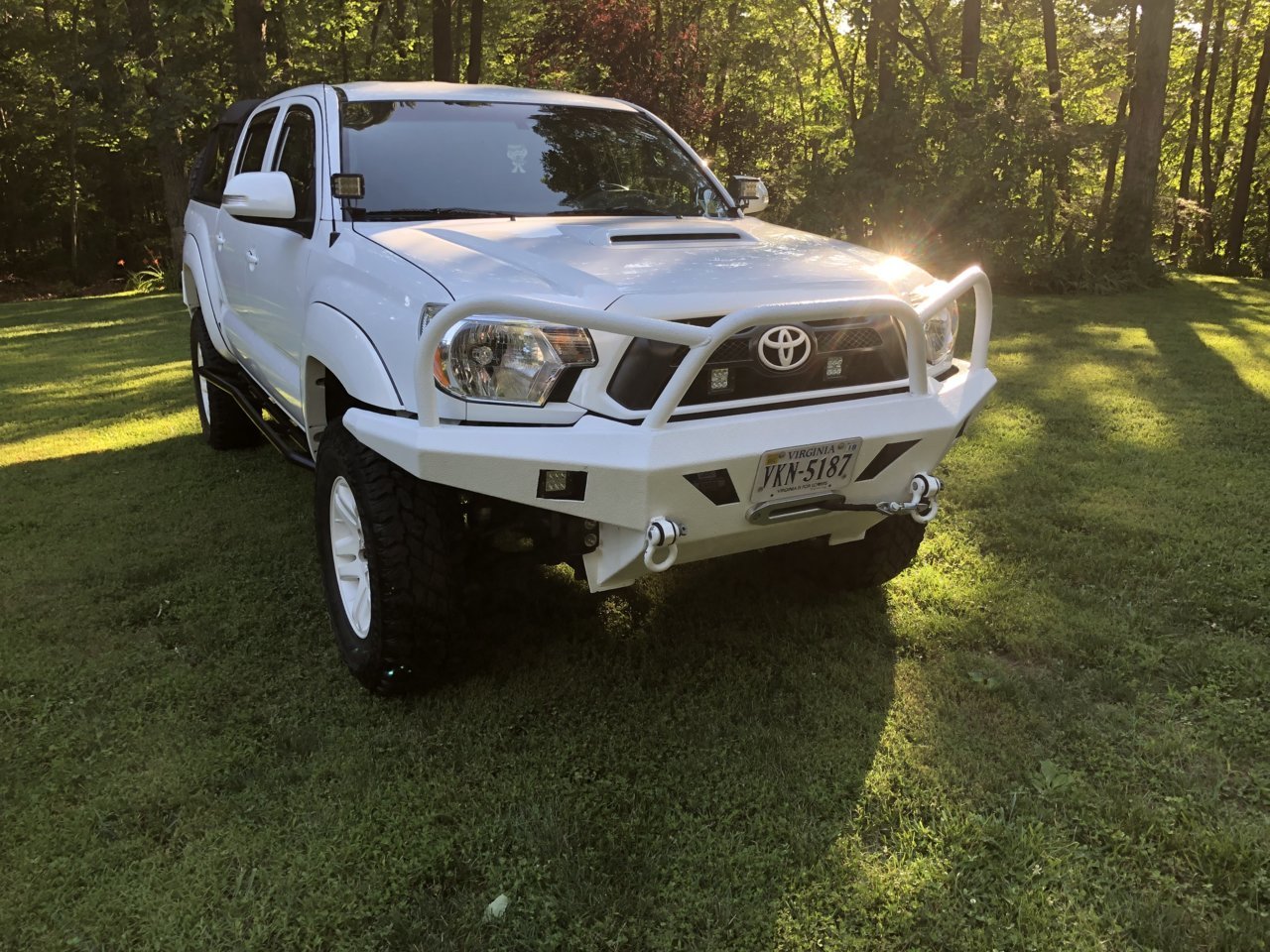

    GRILLIN SOME PODS:

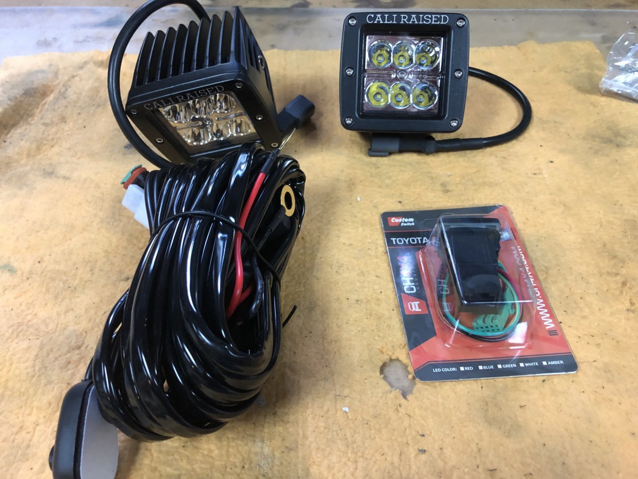

    I found a good deal on TW for a pair of @CaliRaisedLed spot pods a little while ago brand new still in the boxes so I snagged them. I wanted one to mount on the swingout in the rear to replace an Amazon light. I know it makes no difference but I like to keep the lights prety much the same. So I mounted the one on thee rear.
    I like @CaliRaisedLed lights they have much better light output than the cheap Amazon lights, the finish is durable, I have never had one fog, and they are priced reasonably compared to others. For something I only use occasionally I couldn't ask for any better product.
    So now I have a left over pod "What to do?" I contacted @CaliRaisedLed and ordered a single pod and a wiring harness. Then I ordered a CH4x4 push switch for the interior.
    I had wanted to place some lights to fill the small void in front of the truck left from the ditch lights and to simply boost forward lighting. Sometimes during deer season I have to get the truck up in on the mountain and not just the 4 wlr so extra lighting really helps. When I had my Dodge I felt like I was flying blind sometimes lighting was so poor. I'm not into this IG crap or trying to look like any kinda overlander thing I just wanted some more light and, well, it's just fun dicking with the truck. I didn't want any big light bar or anything hanging around where it could be snagged by branches or anything. Hell I would hide the ditch lights if I could figure out how to do it.

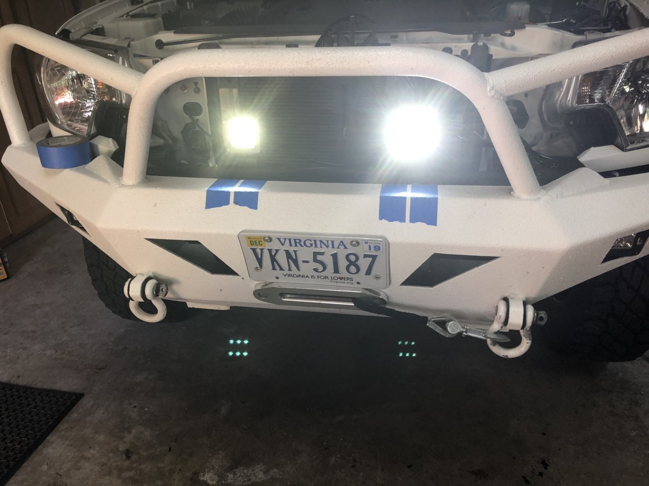

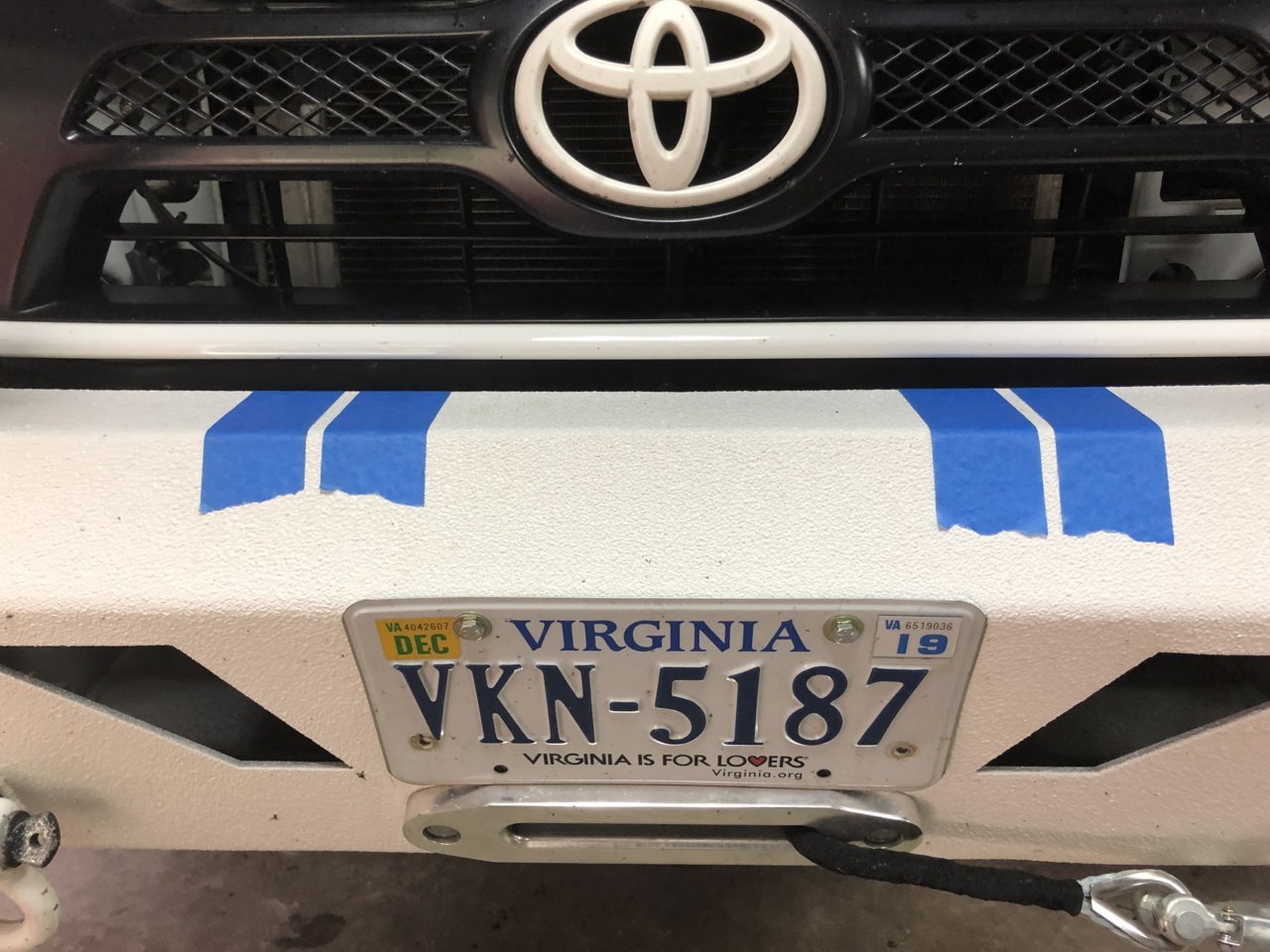

    I marked the bumper with tape where I wanted the lights mounted in the grill so I could locate mounting locations for the brackets

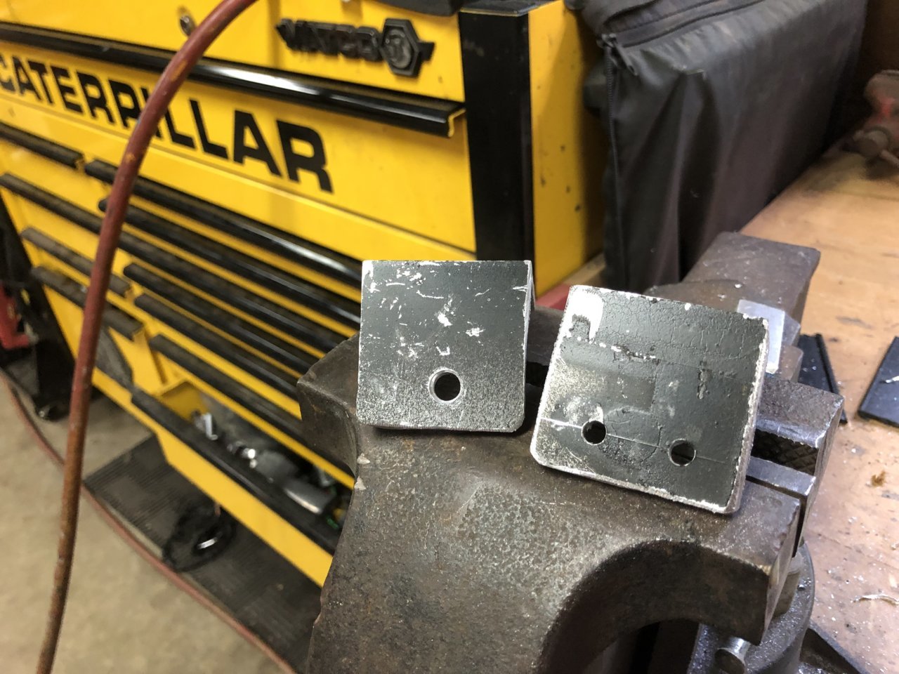

    I fabbed up 2 brackets out of aluminum angle and mounted them to the cross brace behind the lower grill

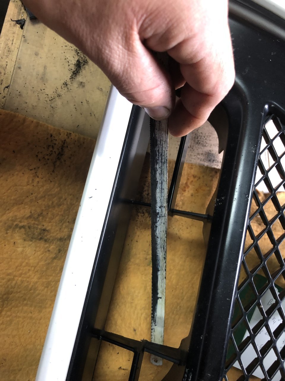

    I cut the grill out with a hacksaw blade and a cut off wheel and located the lights

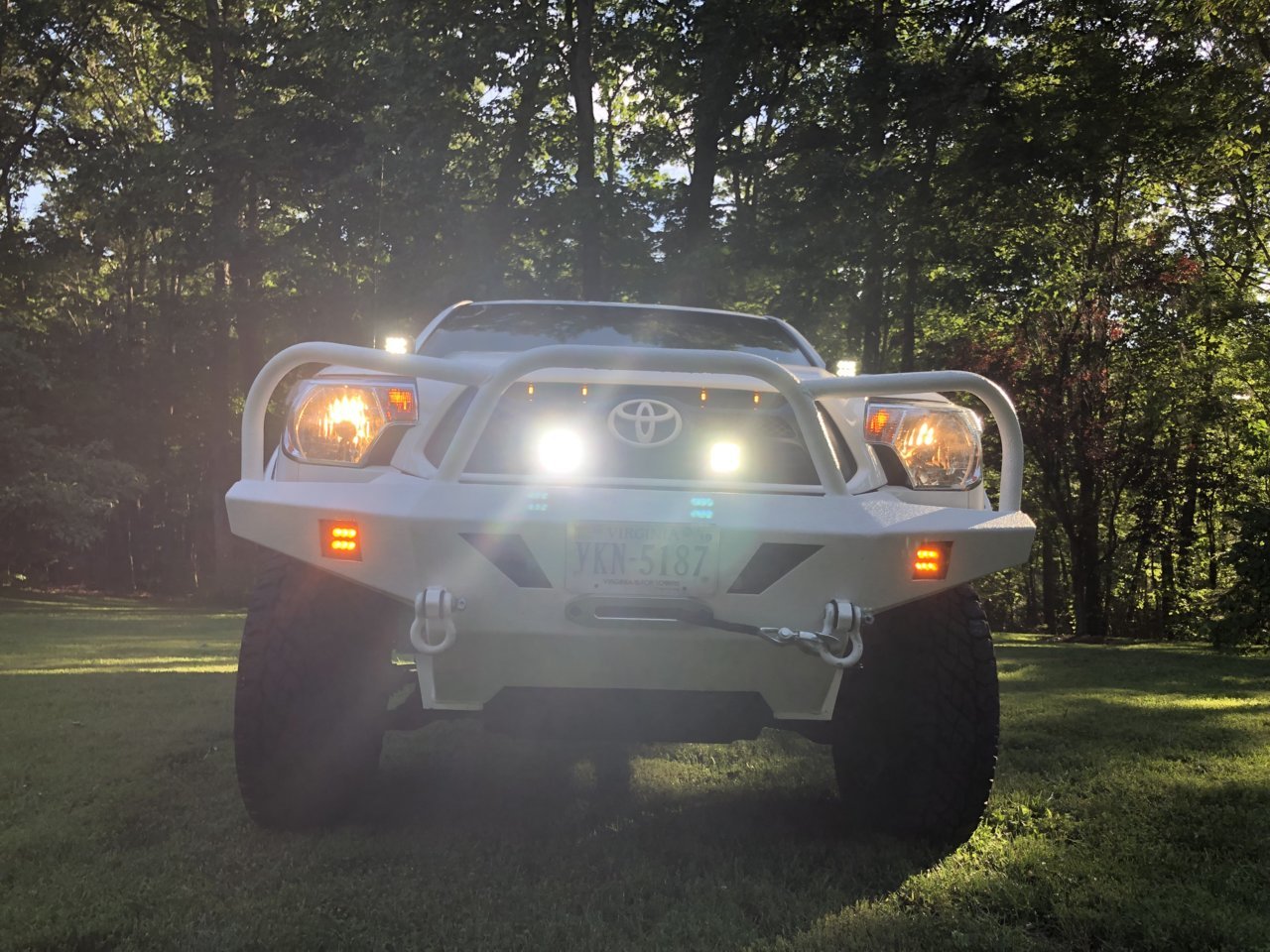

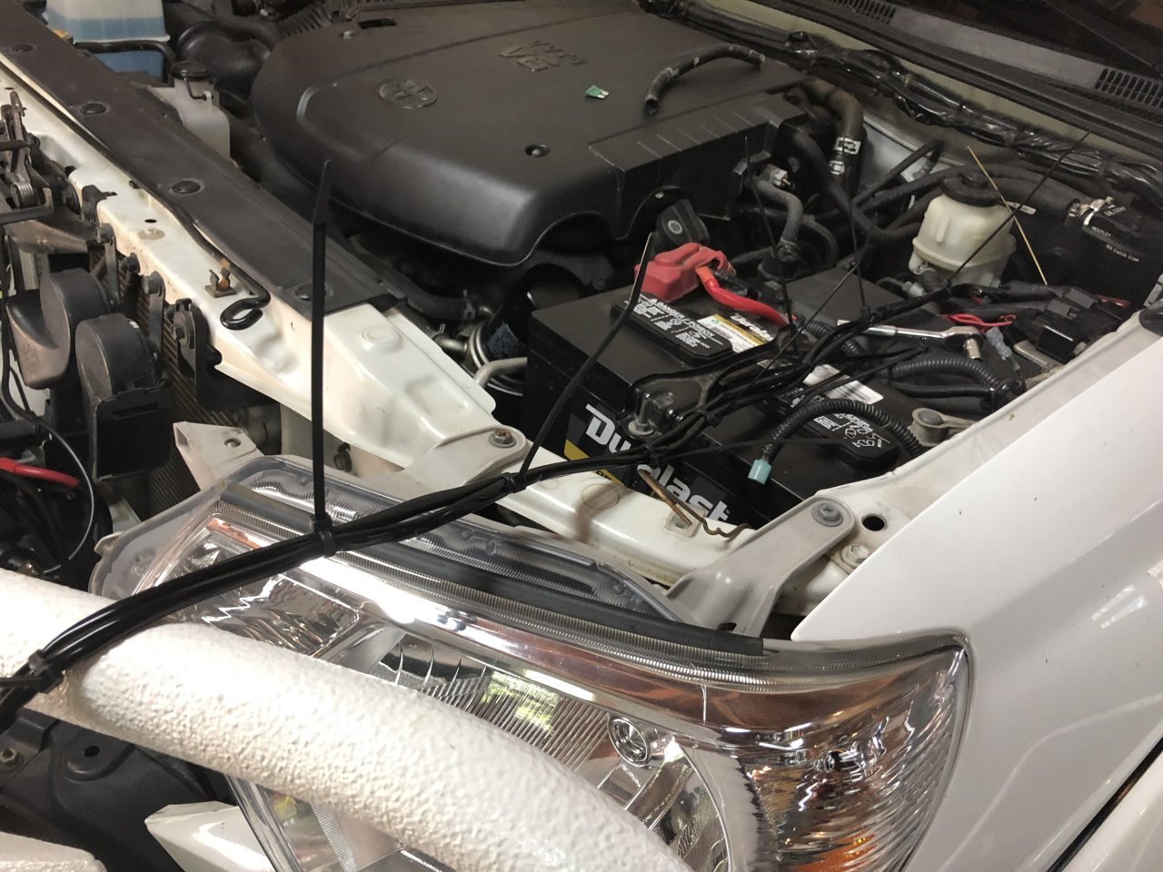

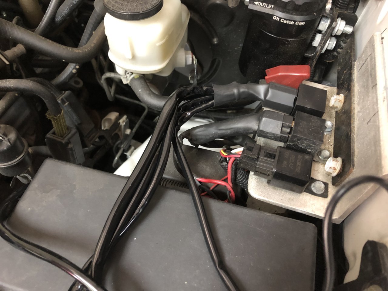

    I mounted the relay to the relay bracket I made with the others, ran the harness to the front and the interior, installed the CH4x4 switch, hooked up the lights and tested them.

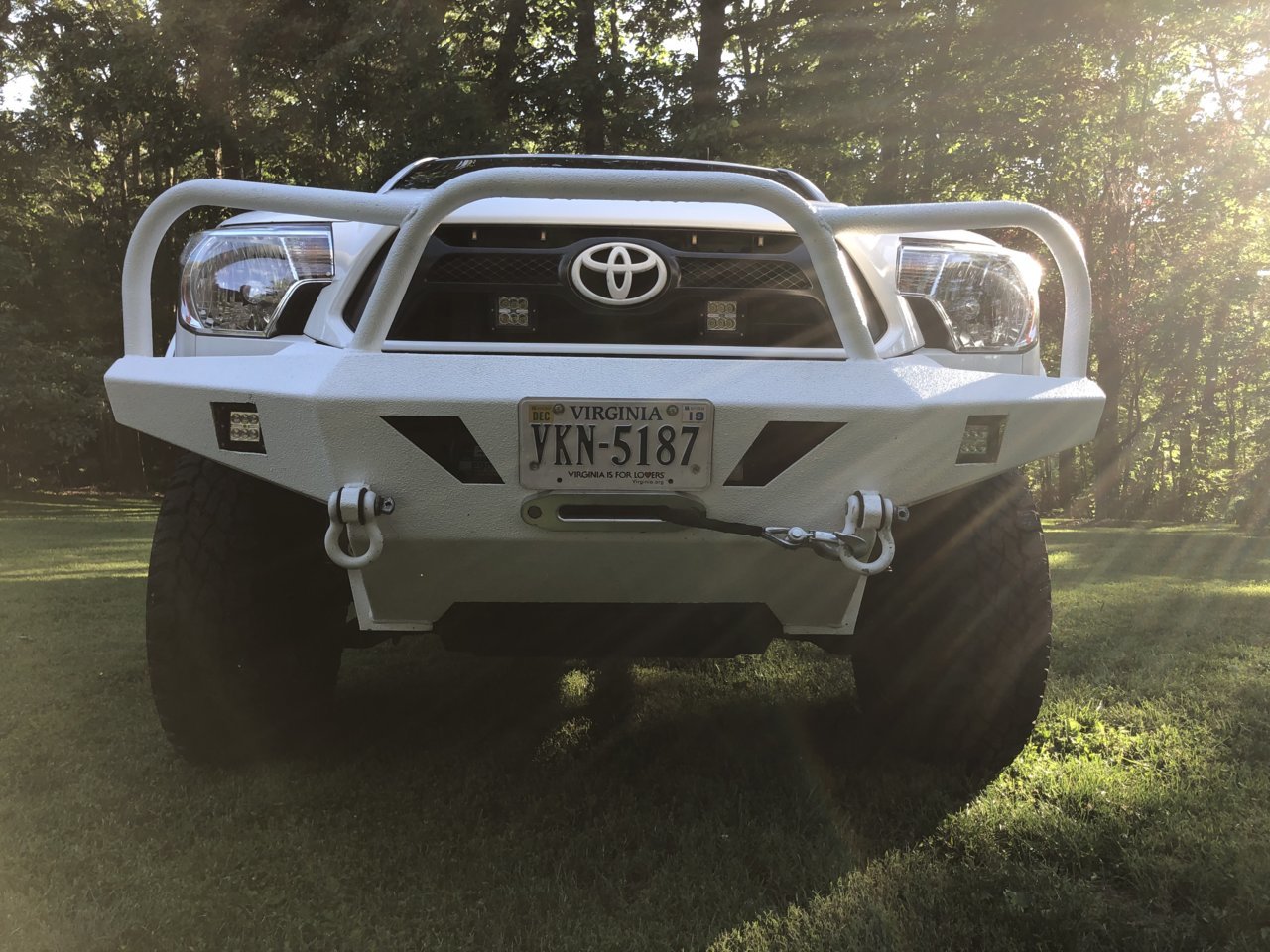

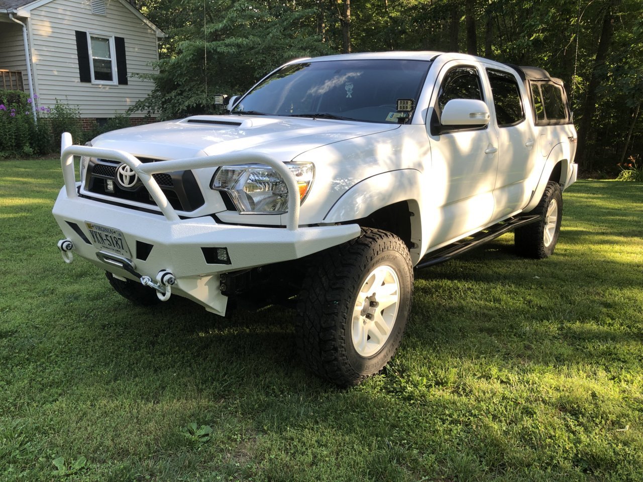

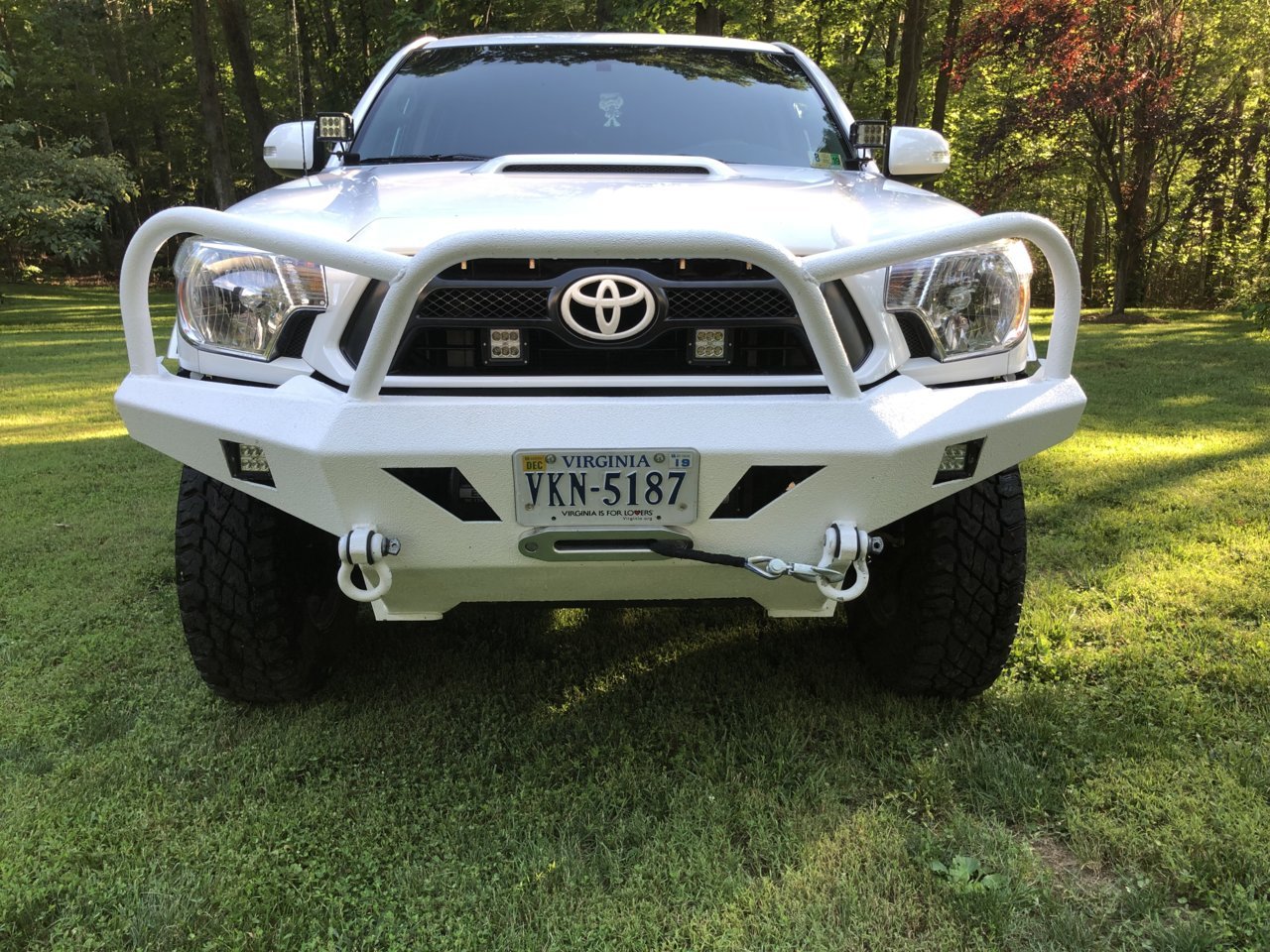

    I had to do quite a bit more trimming to fit the grill as I wanted but a little at a time I got what I desired
    So now there are @CaliRaisedLed ppods in the grill, amber pods for fogs, side projecting ditch lights, and a single in the rear to go along with the flush mounted lights in the bumper

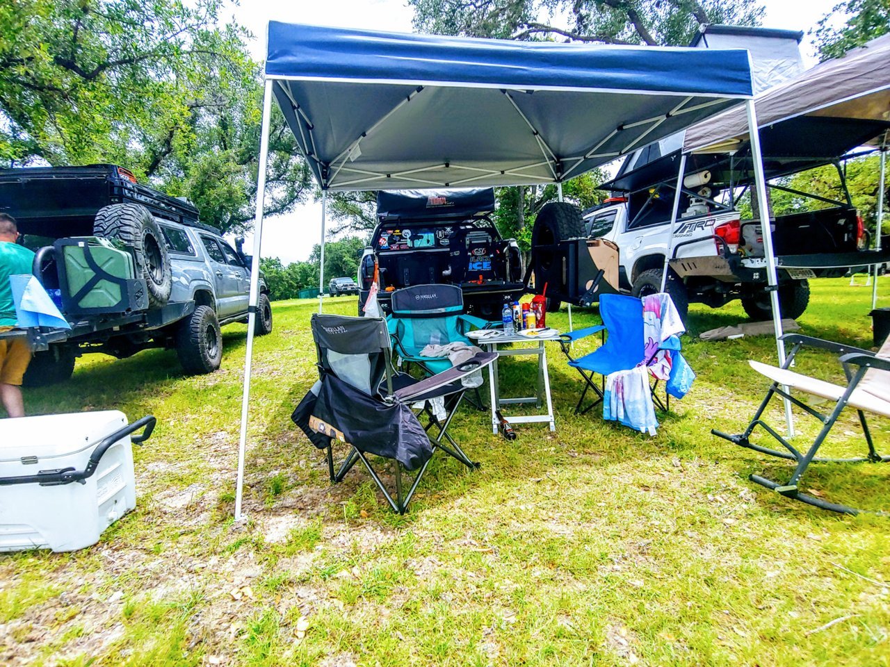

    Nice! What lake did you guys go to Grapevine or Lewisville?

    Technically The Colorado River near Lake Travis

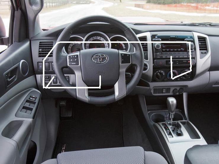

    Because the first time I did the easier run which turned out to be not so good. I did look at both options before starting the first time and didn't think I was going to run into any issues running the harness down low.
    This is how the new harness is run. I also removed the harness for the CH4x4 switches and ran it with the radio harness.

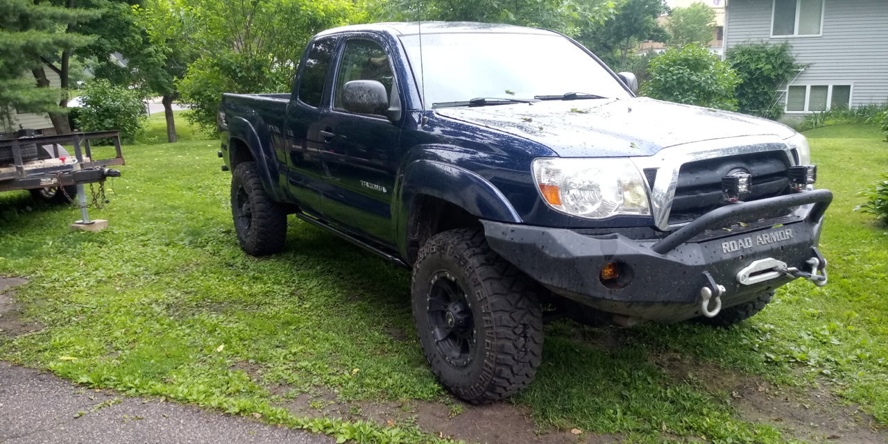

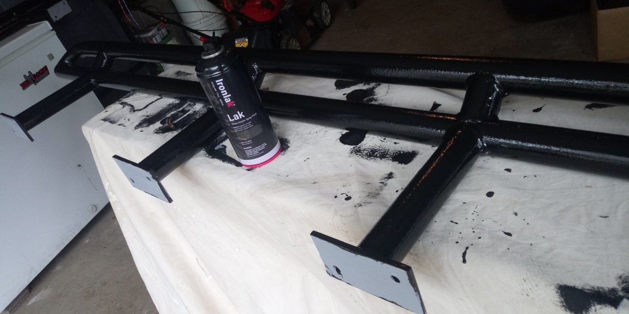

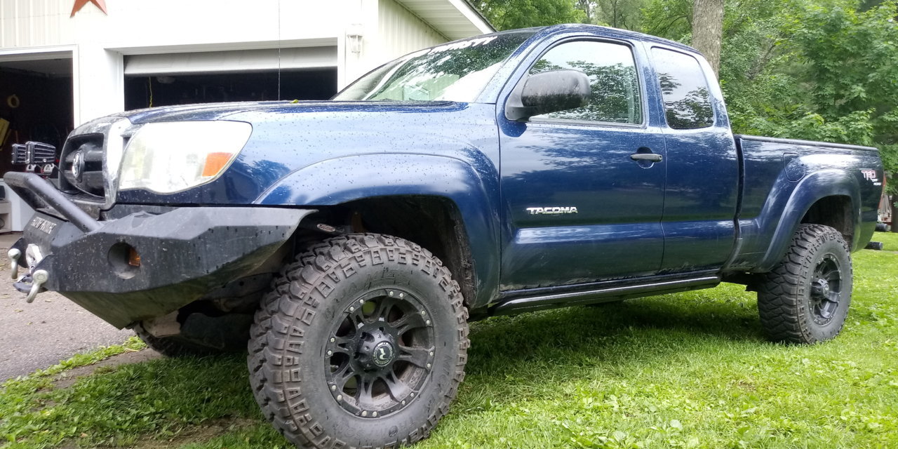

    I got up early this morning to touch up some spots that i missed yday painting and mounted them back on the truck.
    This isnt a rock crawler, but i wanted rock sliders because of unseen stuff in mud holes [logs, rocks, random stuff].

    You want to drop that bumper down a bit. If its sitting that flush with the fenders, you'll pop them or bend them when you flex. 1/8-1/4"

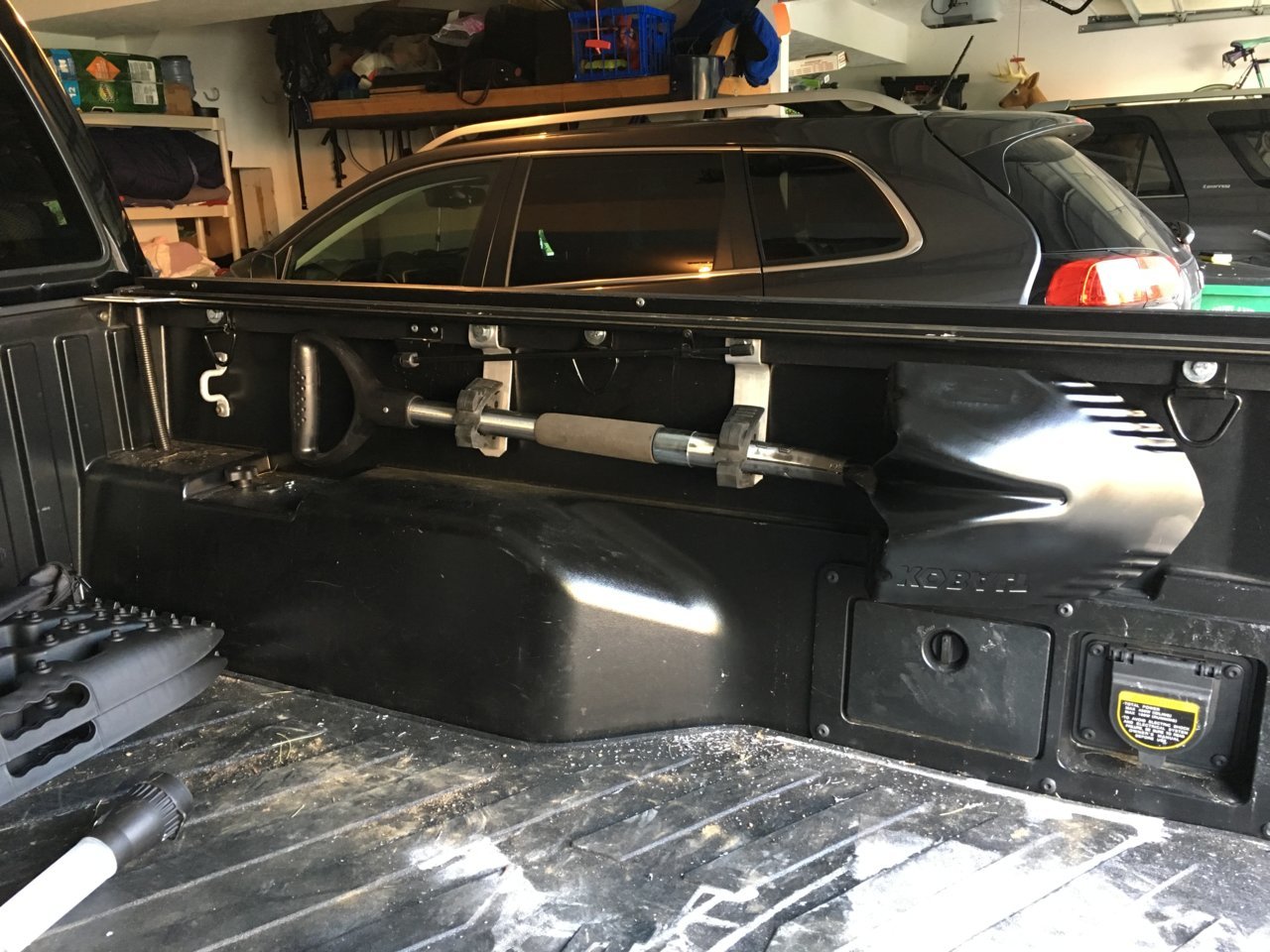

    Added a shovel to the bed. Fab’d some simple aluminum brackets and combined with Quick Fists. Removed Bakflip rail. Slipped a couple of T Slot nuts in, drilled a couple of holes in the rail and mounted brackets. Nice and solid. Out of the way. Kobalt shovel is steel and should hold up. DD60B0FB-065B-408F-90B4-0C2C0E70ED6E.jpgC450B4D7-D6B2-4C44-A407-89C485CD7064.jpg

    Very nice. Why is your bed so shiny?

    i was just thinking the same thing!
    It looks like my 2006 bed had a little more room than your 2014. Looking at it from the back, that far right corner is filled in where mine is open. Is that a pocket?
