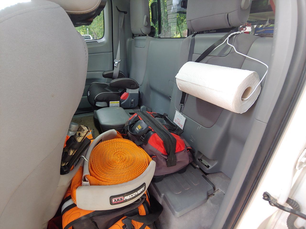

    Made a paper towel roll holder that I can move anywhere in the truck with a rubber-coated coat hanger

    Well now that's handy

    I just cut the bottom in the middle, and bent them like the backend of a fishing hook, but about 25% larger than the diameter of the cardboard tube. It Doesn't spin, but it's also locked in on the coat hanger. You have to pull, relatively, hard to get the roll off the coathanger lol.

    Hey coat hangers are cheap make a new one with every new paper towel roll

    This'll last a while, until metal fatigue from re-bending kills it
