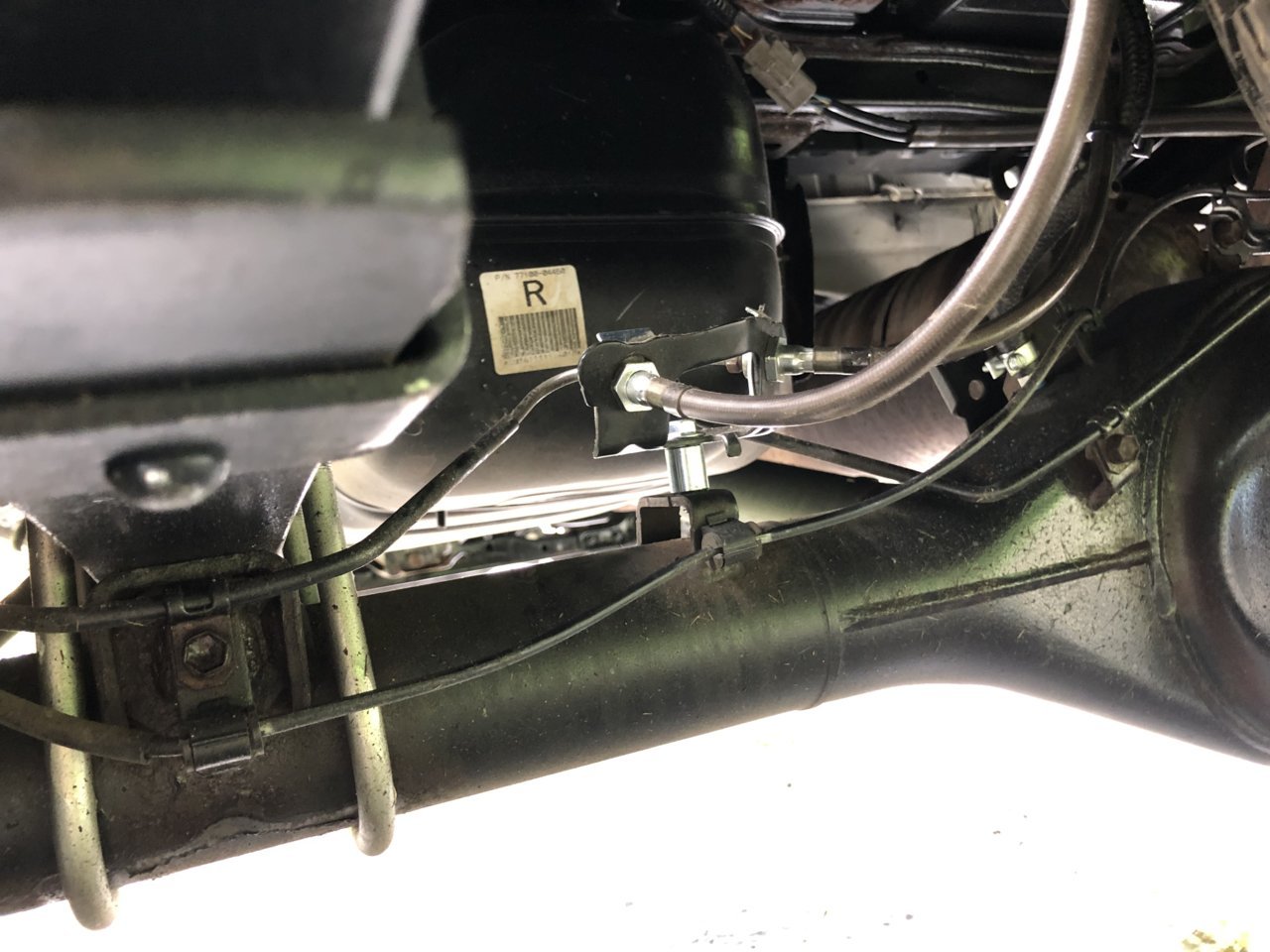

    Replaced the R/F wheel bearing/hub assembly and brake rotor dust shield.
    Installed a 3/4" spacer for my brake hose bracket. You can also see that I unclipped the ABS wire harness.

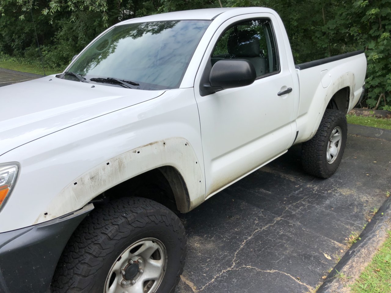

    Removed flares before washing the truck tomorrow and installing Bushwackers.

    After pulling the stock flares today, I noticed that the bumper piece and the fender piece aren't clipped or bolted together.
    The Bushwacker flare instructions want you to bolt the two new pieces together (there are 2 holes for this). Mine didn't come with the holes and Bushwacker said I could drill them.
    After seeing the factory flares, I won't be bolting the Bushwacker pieces together, makes bumper removal so much easier.
