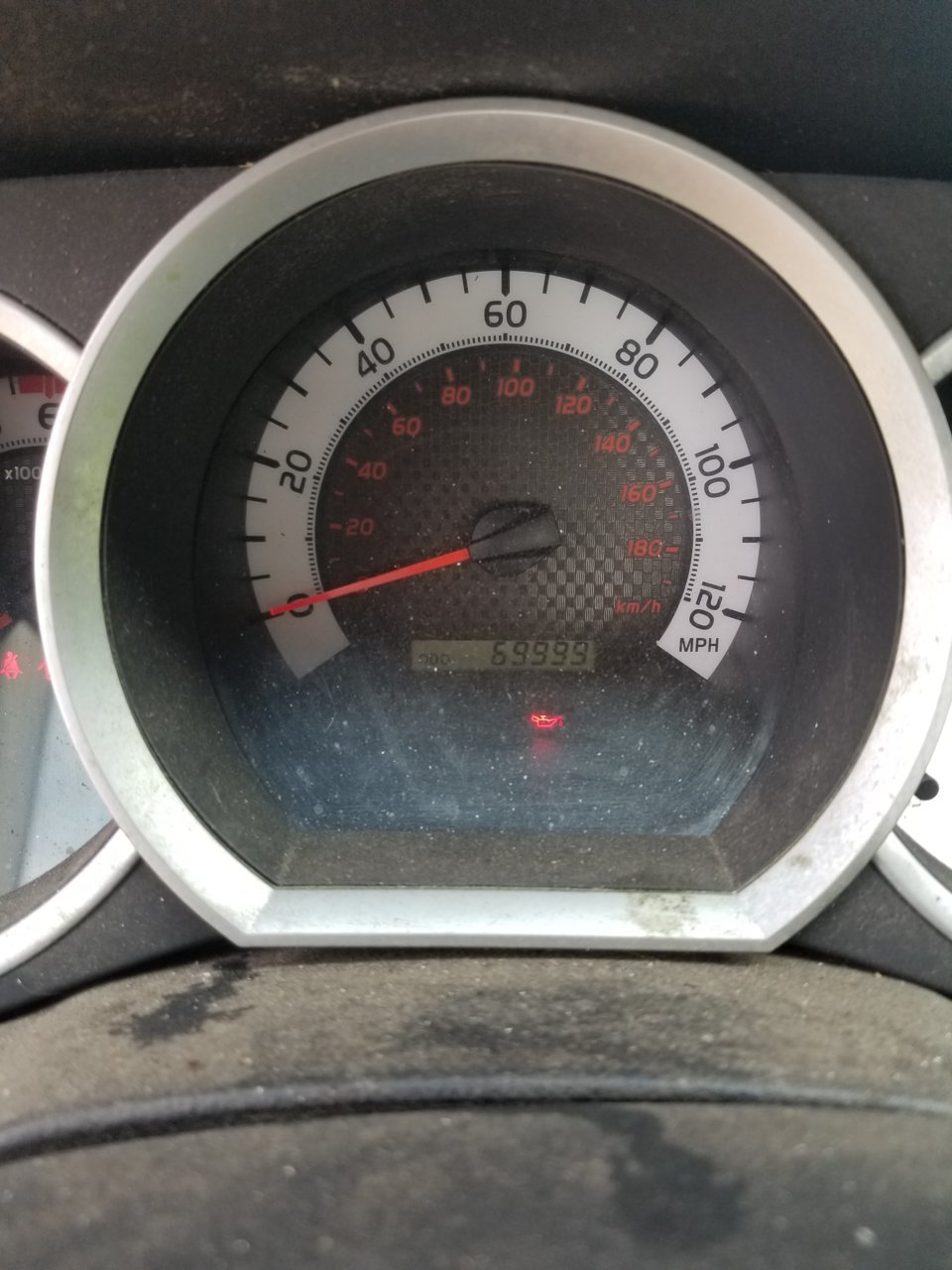

    This is what I just hit today after getting home from work. I'll hit 70k on way to work in 5am
    4popper FTW!

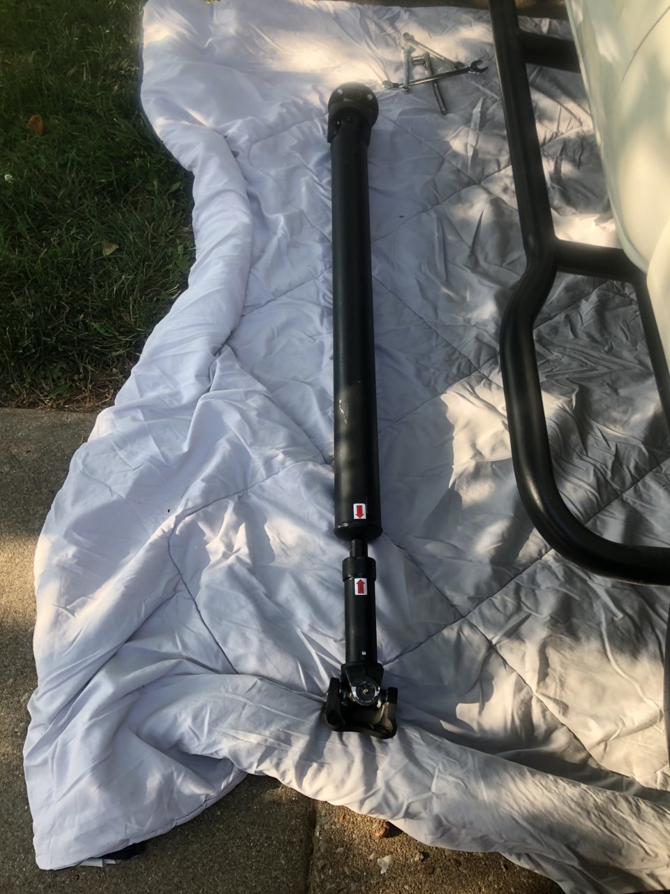

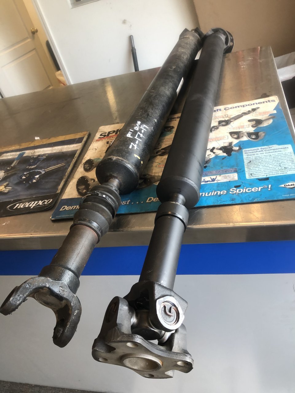

    So after installing an OME suspension my driveline started to make noise. Despite OME techs recommending the suspension I bought for the winch, ARB bumper etc. it made the driveline angle too steep. I made it a little better with shins but it was too steep to correct. Greasing the yoke helped because it would fill in the splines a bit but it was a temp fix. I went to a local driveline shop and had a custom driveshaft made. This one can accommodate up to a 26 degree change. So I put it on this morning.

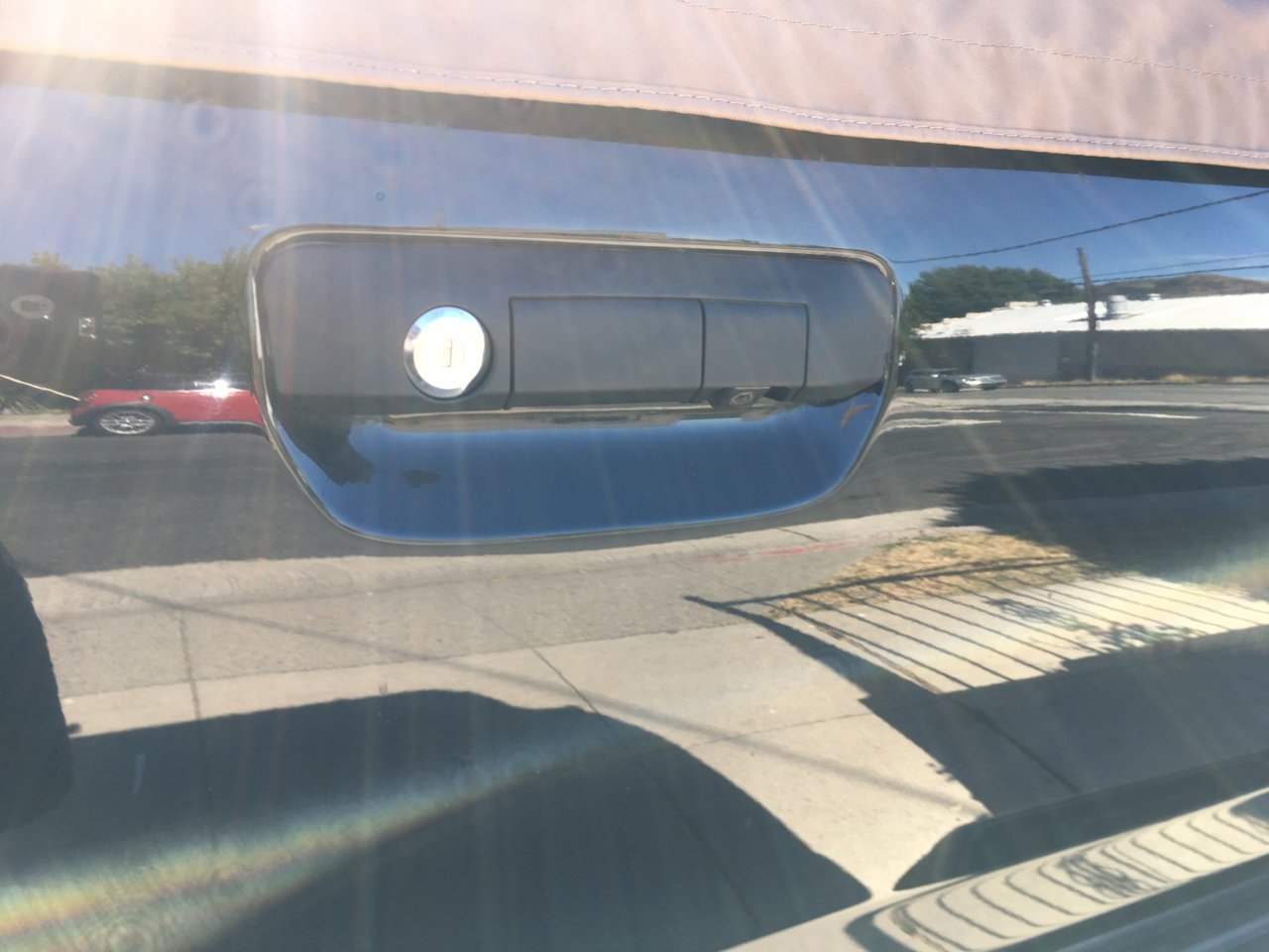

    Also got the PopNLock in.

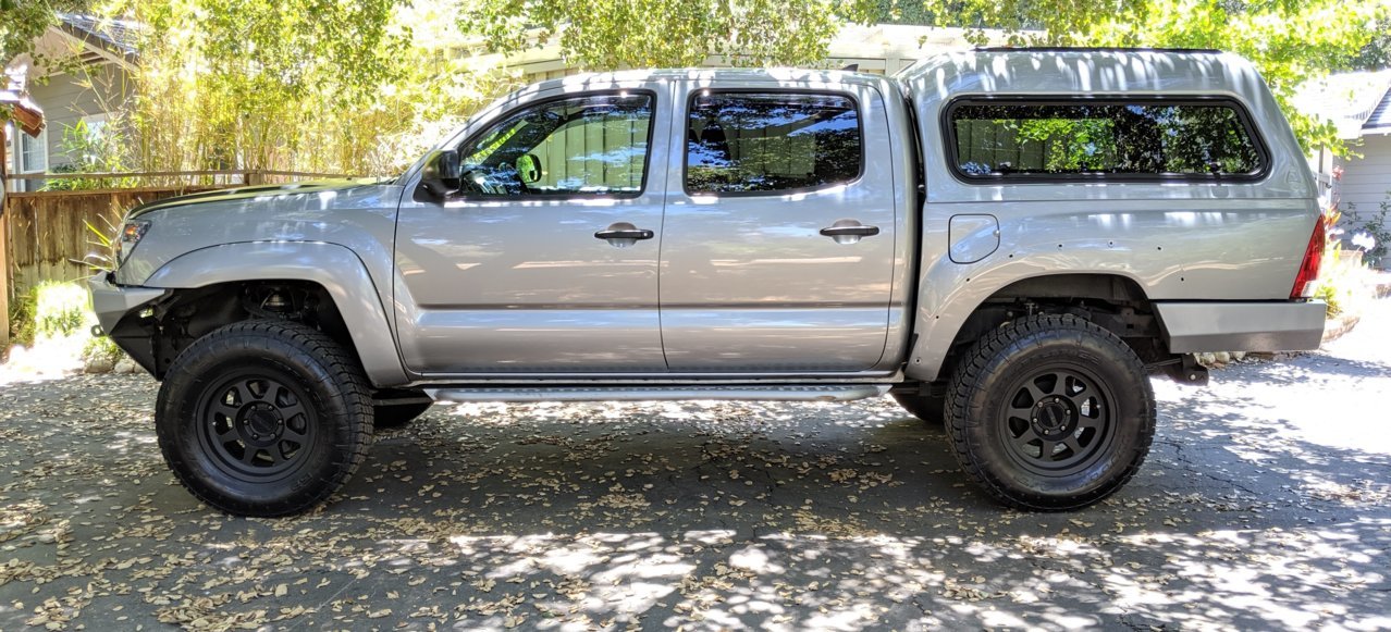

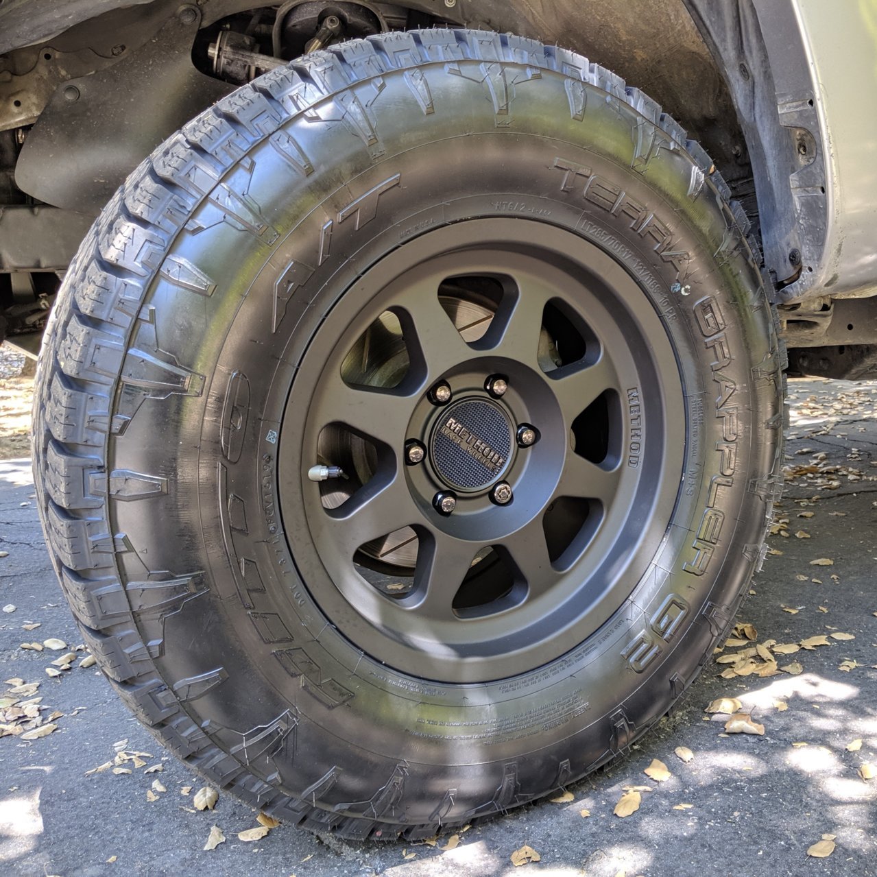

    Wheels and tires this week.
    Method 701 17"
    Nitto Terragrappler G2s 265/70 10ply
    finally got the flares trimmed and back on
