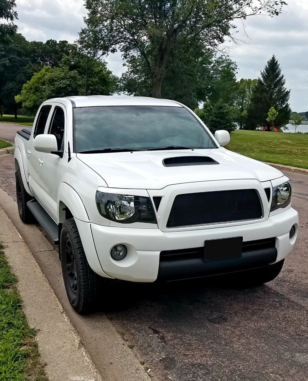

    Tinted front windows and plasti dipped hood scoop insert20190803_203724.jpg 20190803_133116.jpg

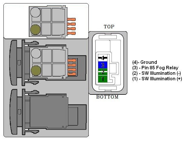

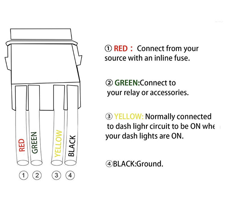

    tried.... but failed. got one of those novelty fog light switches. can’t seem to find the right combo to wire it in place of the stock switch. any suggestions?
    i get the fog lights to go on and off, but the switch leds don’t illuminate when they’re supposed to. then i can get the switch leds to go in and off, but the dogs don’t work.

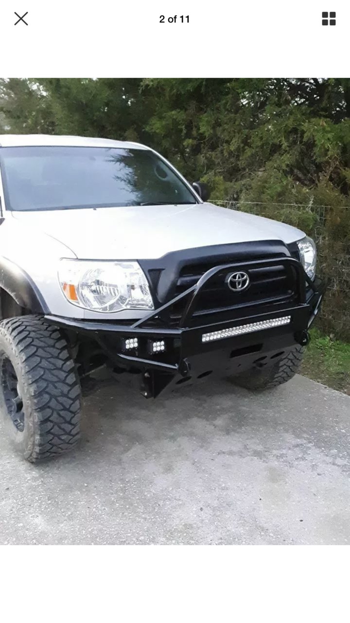

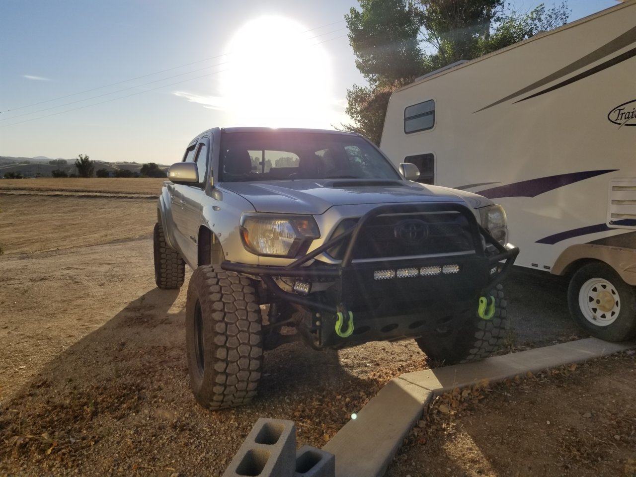

    My truck was backed into and I need your help on deciding if I should stick with replacing the stock front bumper or go with this hybrid off road bumper? I like the look of both and I can’t decide. I need some input53ECB136-DEEE-45B7-95B7-8320F3F19D65.jpg

    You have conflicting wiring diagrams. One has 12v switched to relay and the other switches relay to ground.

    I've wired a few of these types of switches into my truck. You need to tap the yellow wire into another lit up dash switch. And the ground needs to be tapped into the dash swich ground because they ground through the dimmer switch. The ground wire is only for the switch LEDs it has nothing to do with the fogs.

    I vote hybrid, I have one and I love it! Also gives you better approach angle and can take a hit from a car or a rock lol

    sorry, should have clarified the first diagram is of the stock wires. the second is of the new plug wires. i thought it was going to be plug n play, guess not.

    I vote factory with US Offroad WINCH bumper.

    to use the oem harness you need an oem switch, as you can see the wiring is different and the two switches aren't interchangeable. You could us the new switch buy only with all new wiring.

    yeah got it. thanks.
