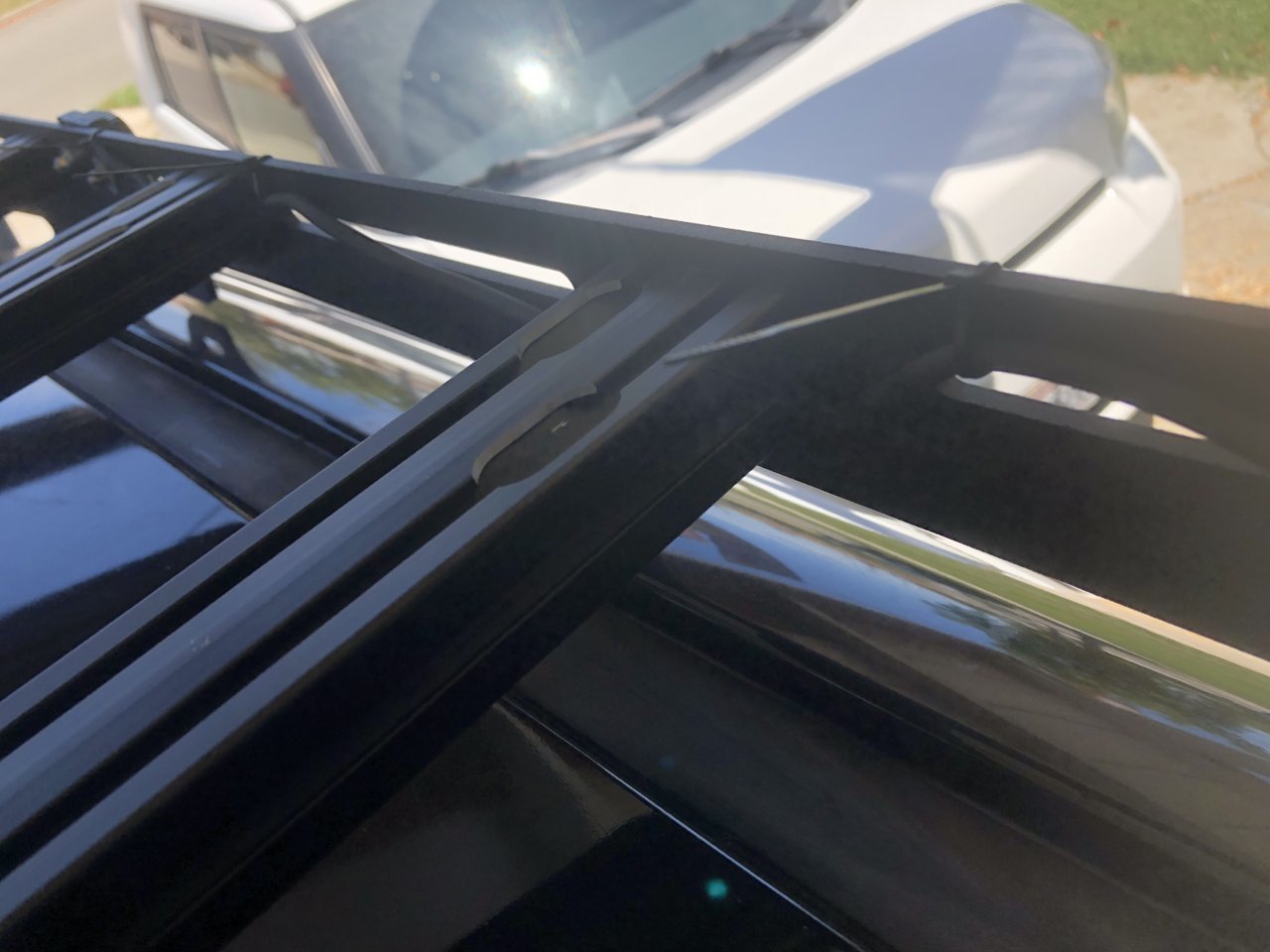

    I think you’re asking about how it was ran on the prinsu?
    I looked around here and didn’t find much so just used zip ties for now. Didn’t get very good pictures.B6D36371-648D-494C-8A69-53963A5C8F54.jpg
    I was thinking to try something like these so it doesn’t interfere with moving the crossbars. Not sure how they would hold up though.

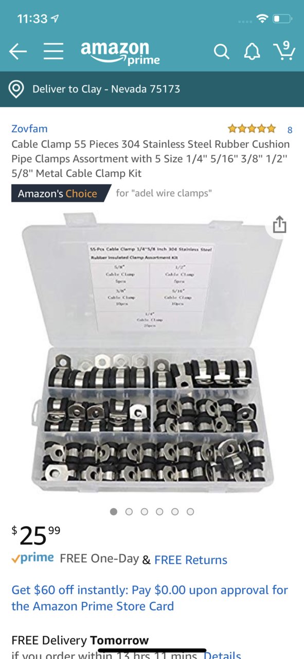

    Nice! the panduit squares are good but in the weather they could come loose over time I’d try some adel clamps that can mount to the rack with a screw and nut. I was curious to where you ran the wire to your power source, did you drop it in the back of the cab and through to the battery or what?
    These

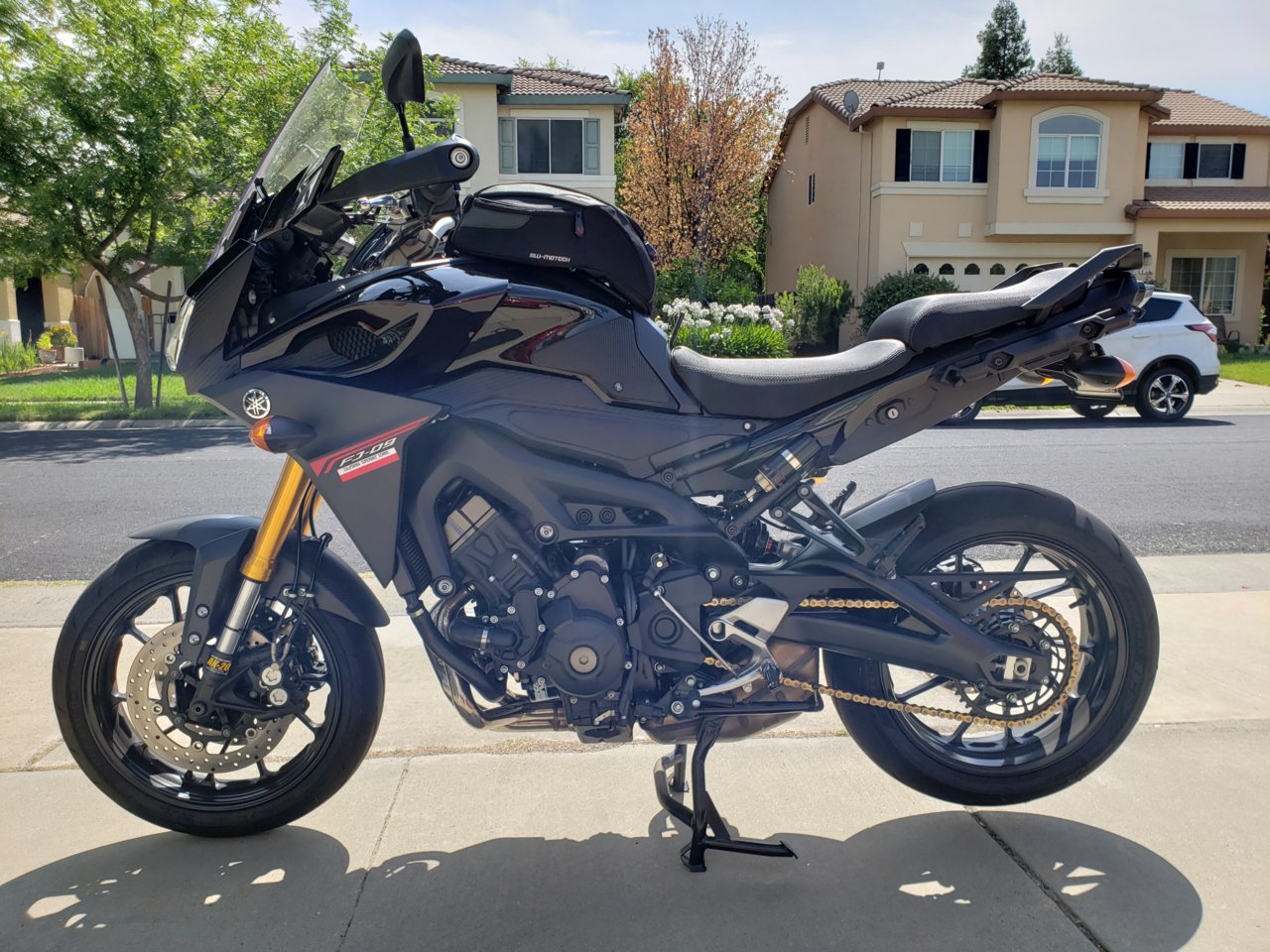

    We have very similar taste in motorcycles. Do you usually haul in the bed?

    Yea I figured they wouldn’t hold up too well in the weather, I’ll have to try those clamps.
    I ran it down the windshield, one wire on each side.(passenger side was a pretty snug fit, driver sides kinda loose, but seems fine so far) Then under the plastic/rubber and out under the hood. Positive wire to fuse box.
    Same for passenger side and then just ran it across. I ran two switches so I can turn on one side at a time. Didn’t take that many pictures, if your interested I can get more today under the hood. 5B030D6A-4A20-4026-812F-184CDBDCB432.jpgBBD032F3-69B9-4383-BBC2-EFEA0037EE47.jpg
