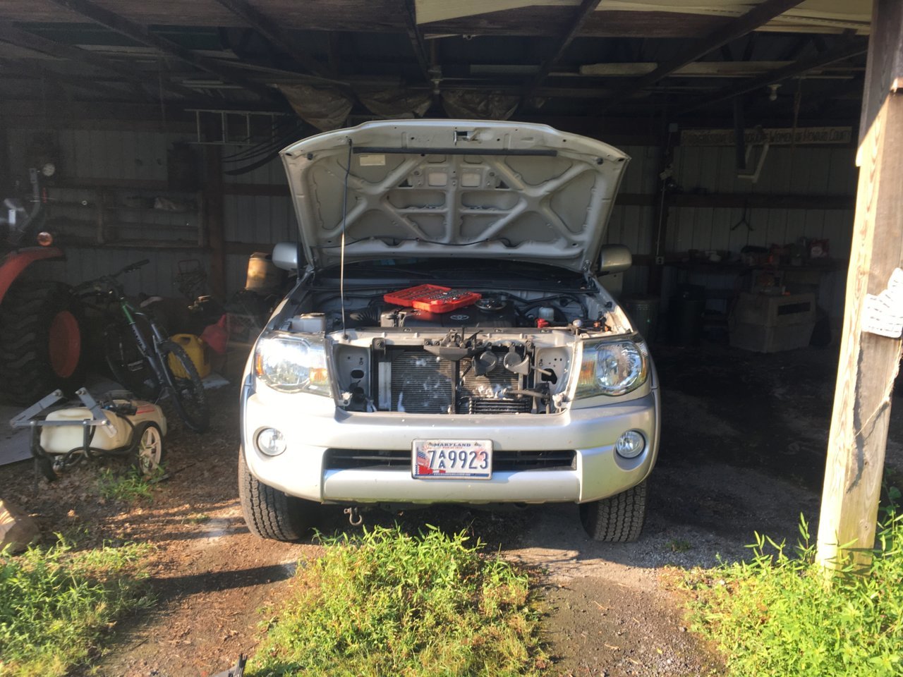

    Cleaned the heat exchanger. I had no idea the grille was so easy to remove!

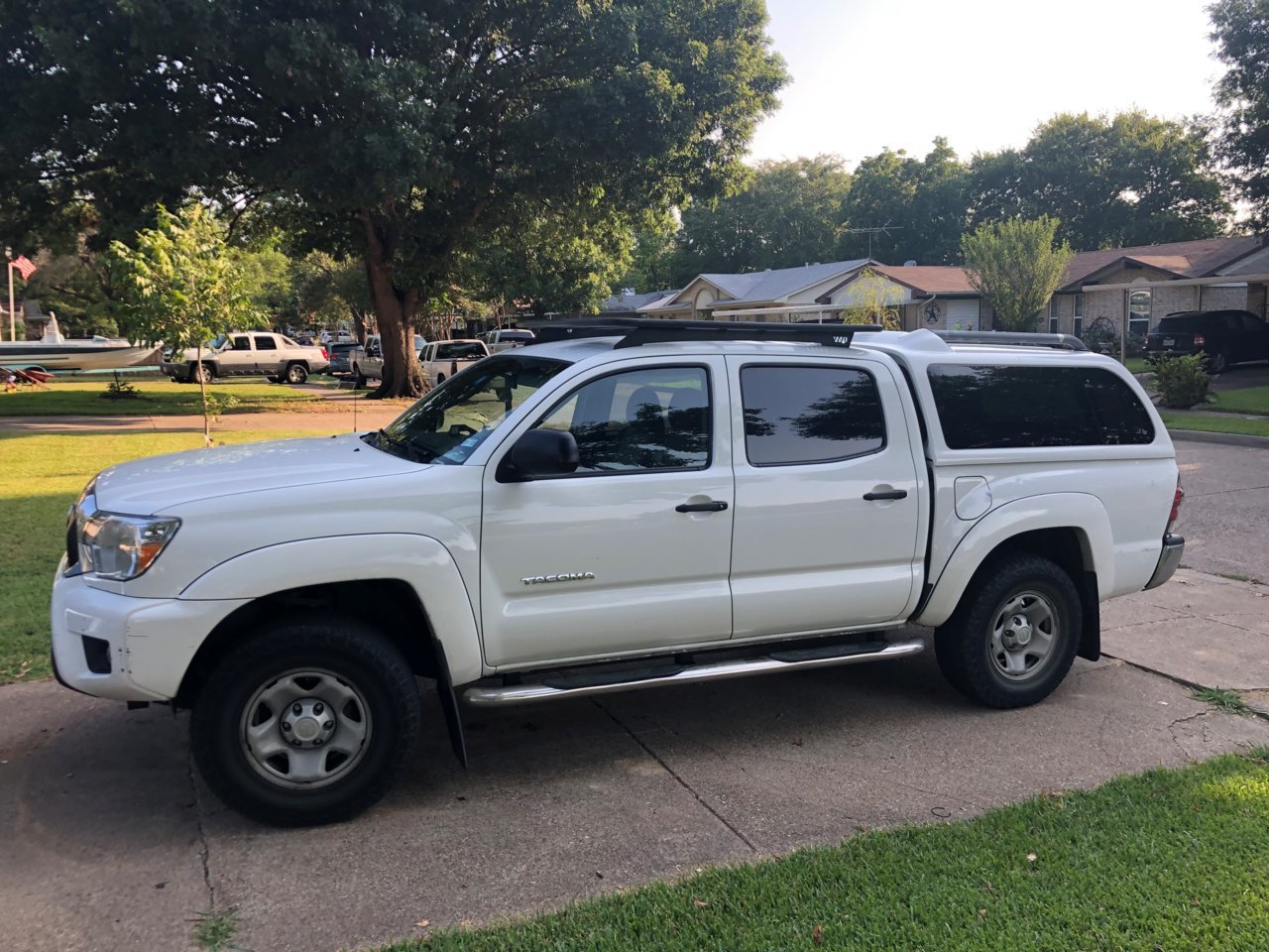

    Bought a Snugtop XTR Camper and mounted the Warrior Products Roof Rack

    How you like the rack so far? What are your plans for it?

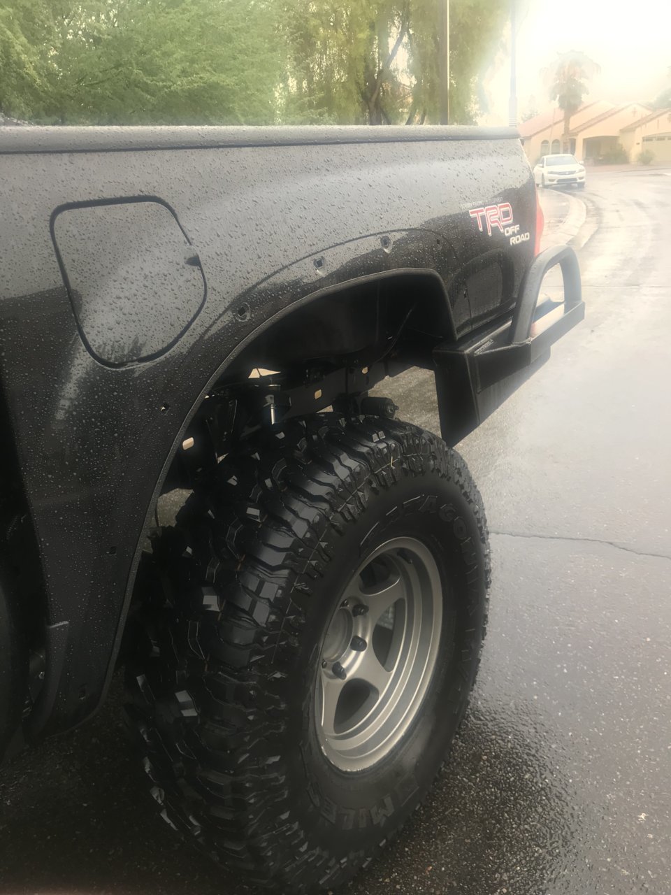

    How do you like those tires so far?

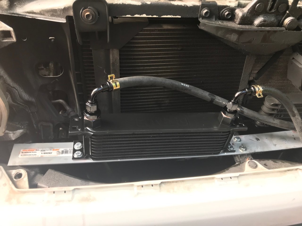

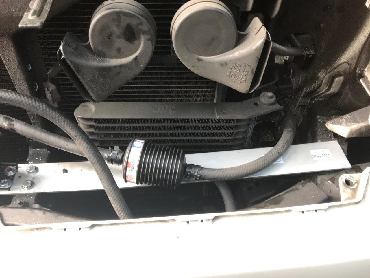

    Finished my add on ATF cooler , used some Aluminum flats bolted to existing grill support.
    Dropped pan temp about 20F in driving to what looks like an average of about 147C.
    Still have original cooler and magnefine inline as well
    Since cooler holds about 6 ounces or fluid I filled it first before hooking it so i dont have to worry about the finiky fluid level in the trans. Already did one drain and fill just to because I hear some of these come under filled from that factory. real easy with the ultragauge showing me pan temp so i dont have to worry about jumping wires on the ODBC connector
    If temp drops to low once fall/winter arrives i have a oil thermostat ready to install also
