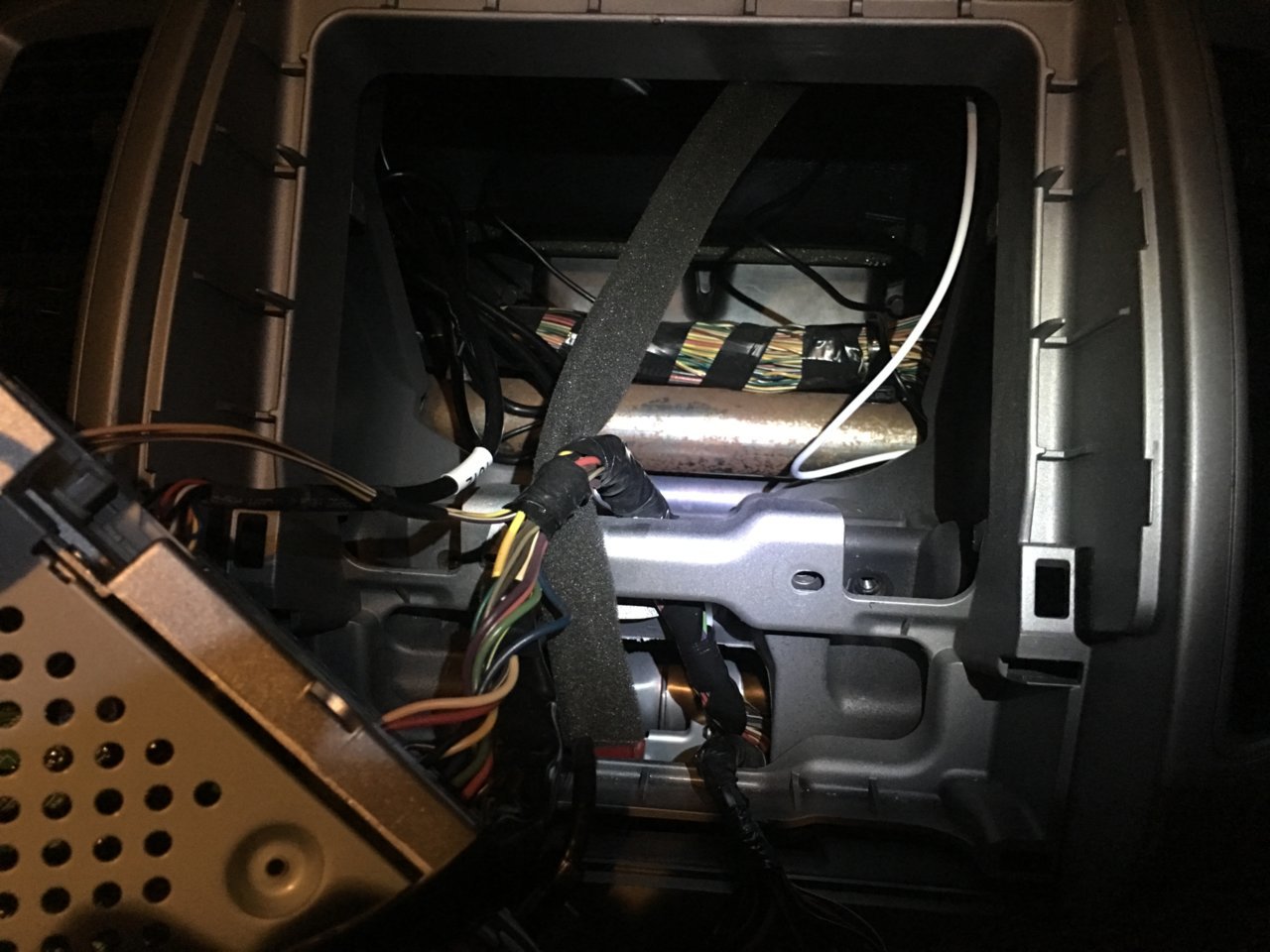

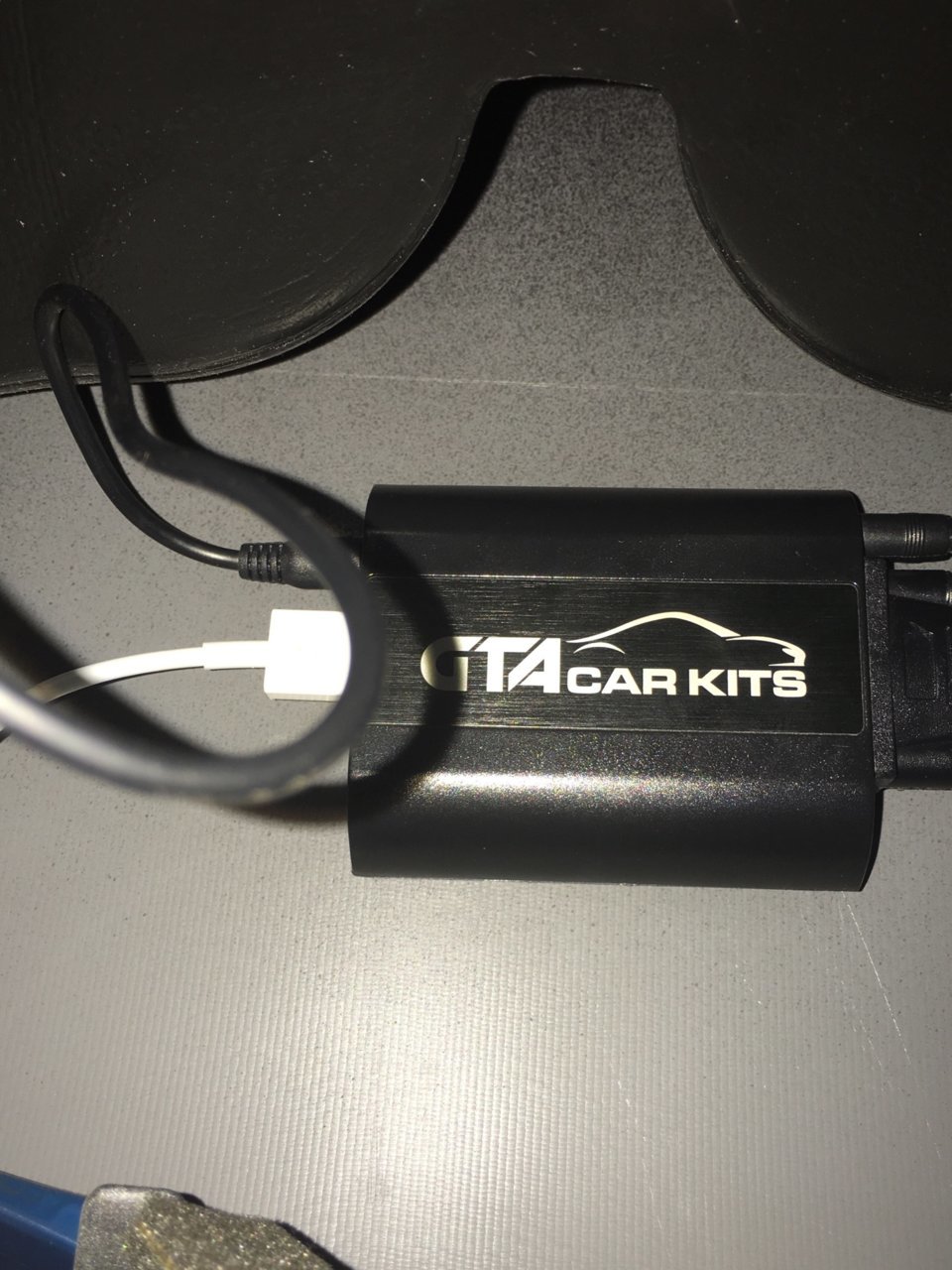

    Been living with the radio for two years after getting the truck when my dad died... This winter the fam and I will be doing a lot of traveling in the truck, so I needed to add Bluetooth to the mix. After a lot of research and the desire to keep things looking stock, I picked up the GTA Car kit for my Rosie. Very straightforward install with everything being plug and play. Didn’t want to just tuck the receiver anywhere, so I used some industrial Velcro and mounted it to the underside of the dash, right above the stereo. Will see how it works in the California heat. ED6210BD-CE7B-47C9-9F66-F45F5185636B.jpg D3E08282-86E9-4400-ADCA-4496386BCB88.jpg

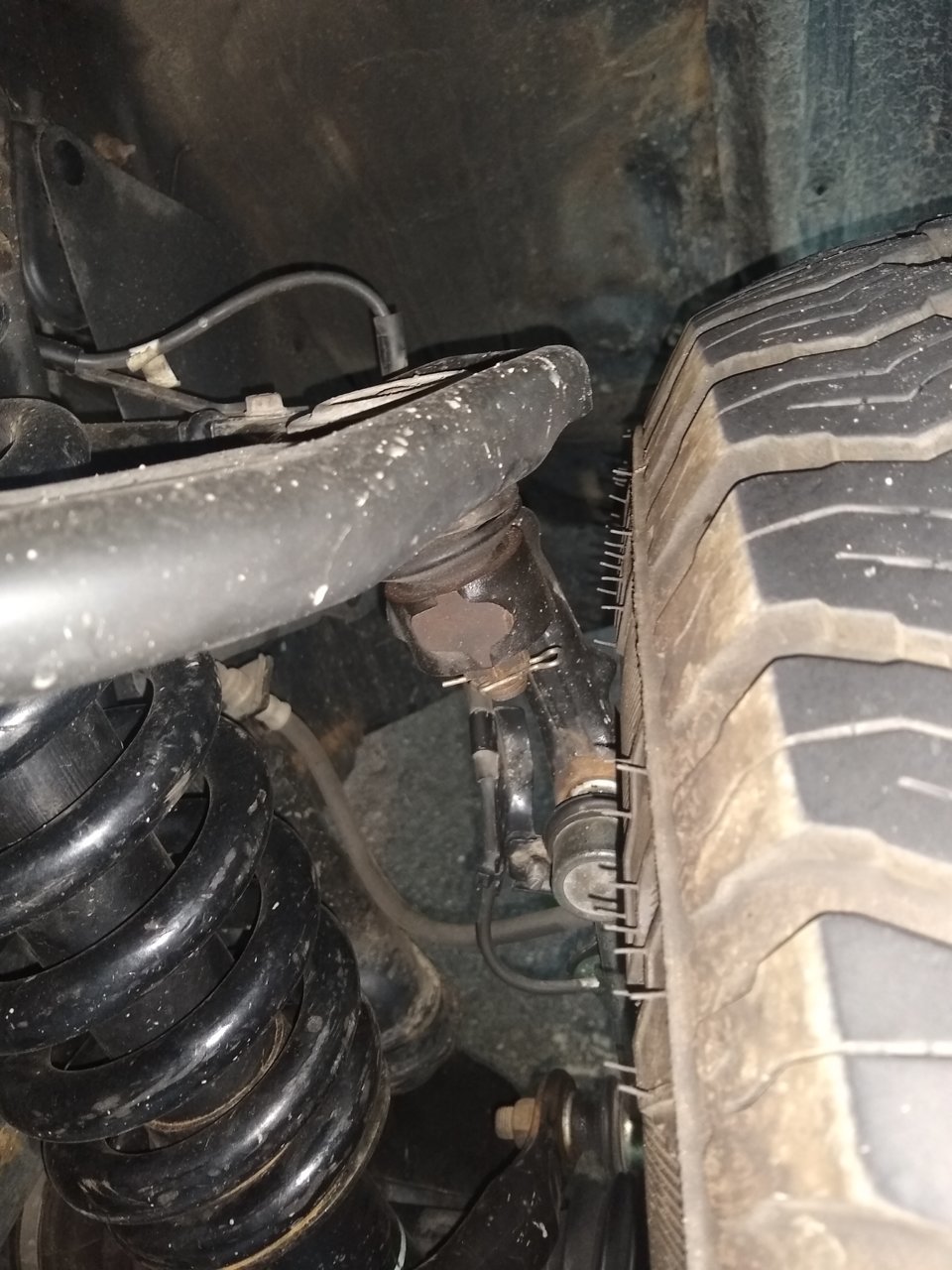

    Dobinson’s coils and shocks. SOS sliders, ditch light brackets, and front skid. Rigid ditch lights. BFG KO(dos) More minor stuff.

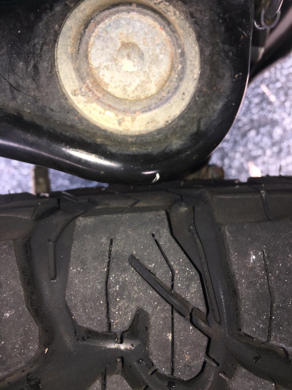

    This is what I ended up with.
    Had major rub on front side of uca. 1.25” spacers and now I get a little on front of fender at flex.

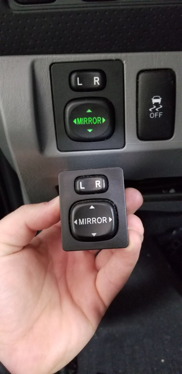

    Swapped out my non lighted side mirror switch to the lighted one.

    niceeeee... where did you get that from?

    Actually bought it from another TW member a while back, and it's just been sitting on the shelf in the garage for a while. Wife took the kids to her friend's house, so finally have some ME time to do stuff.
    Not sure where the TW member I bought it from got it though. Sorry.

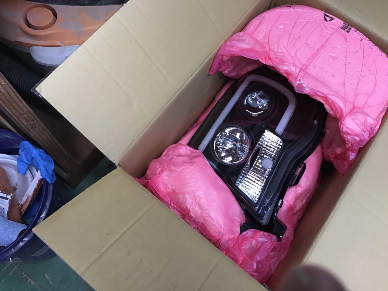

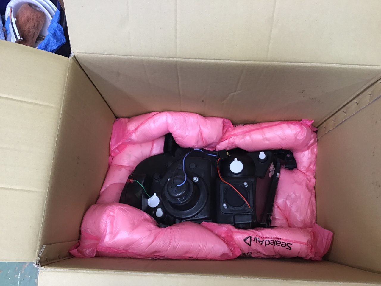

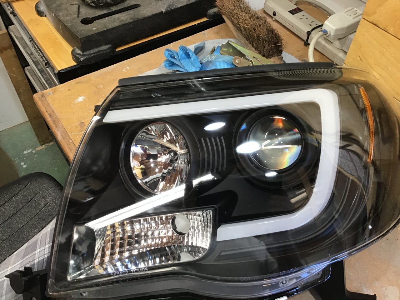

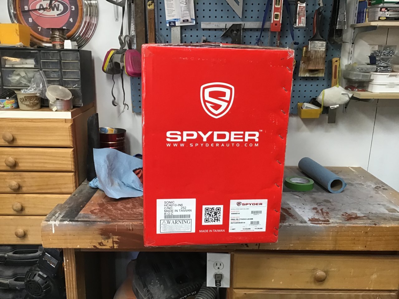

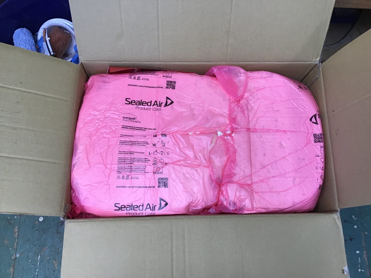

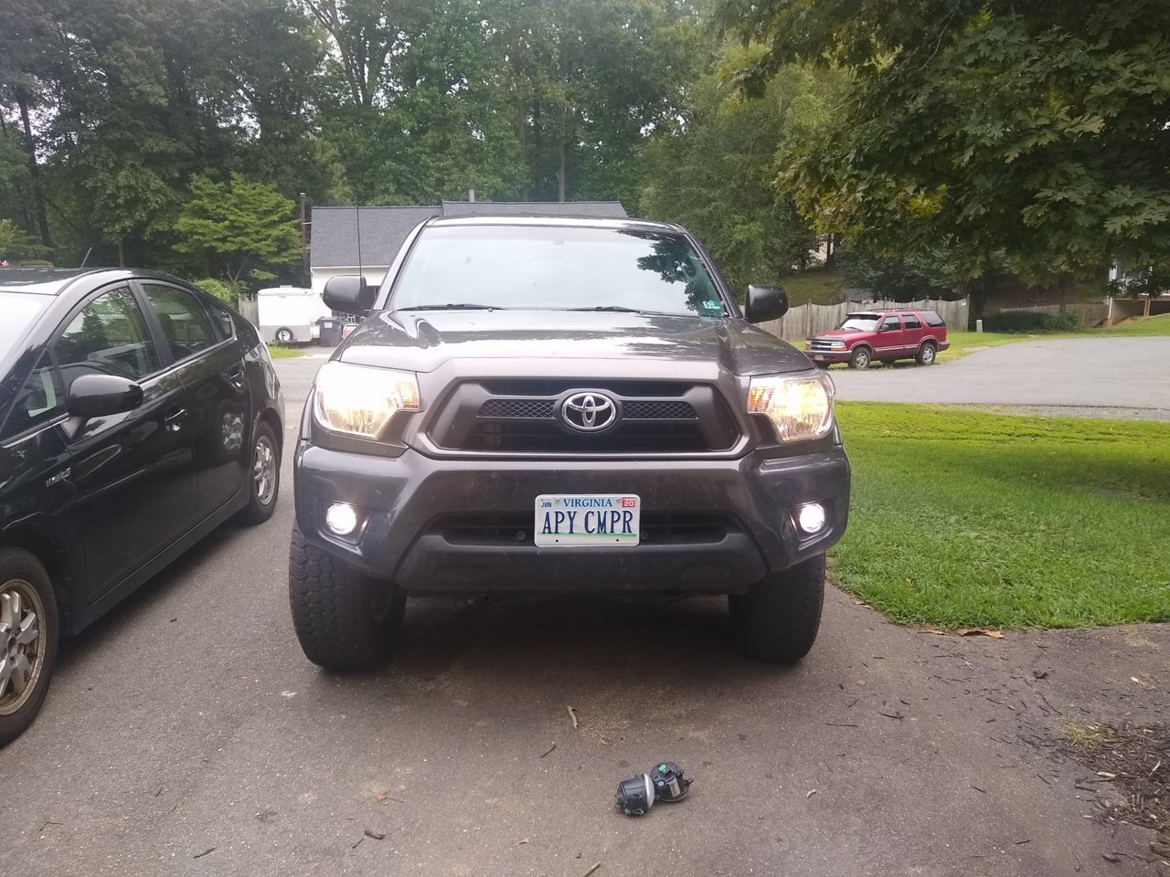

    Got my project for today, yesterday. Big red box. Spider Headlight. Unpacked them and inspected for flaws and proper sealing, all looks good now if it doesn’t get to hot. Install guide is absolute crap, has nothing to do with the lights I got. Looking at the lights and some YouTube figured it out. Looks like the side marker are not used as the plug is used for the LED light bar DRL. May do some research and see how I can change it and splice into the OEM DRL circuit using the Wiring in the OEM harness at the lights.

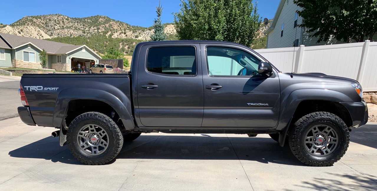

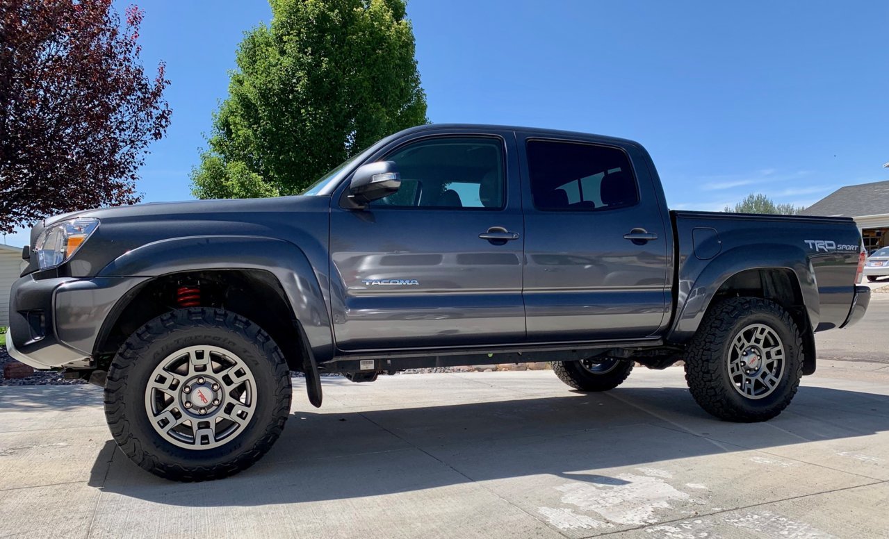

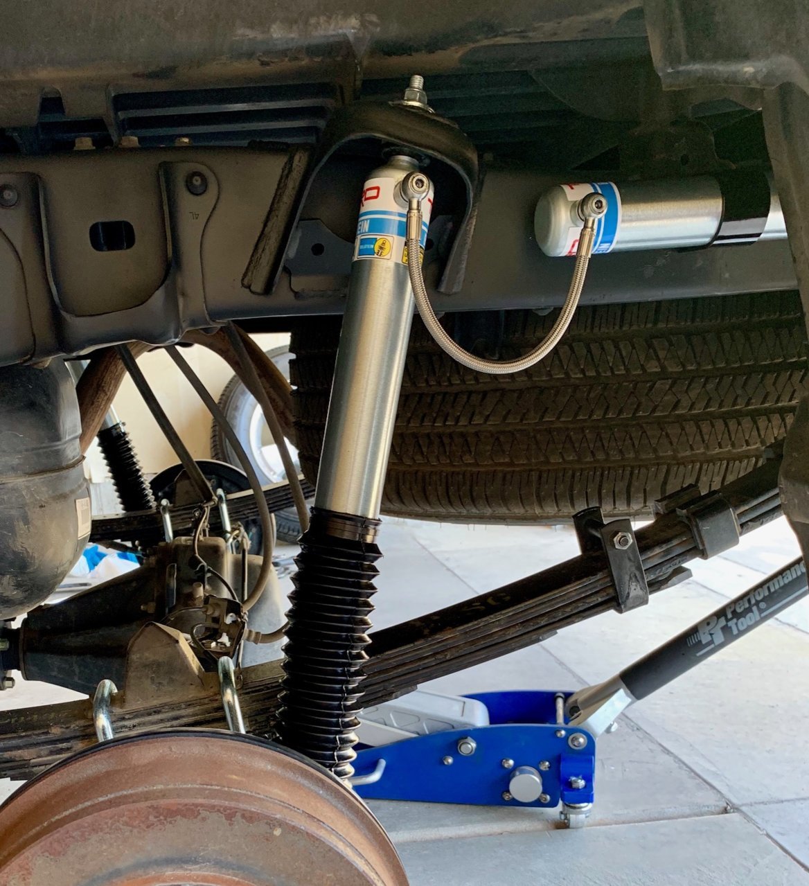

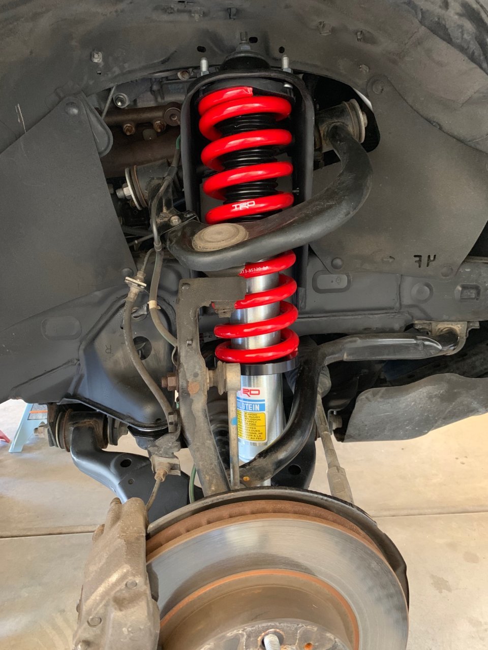

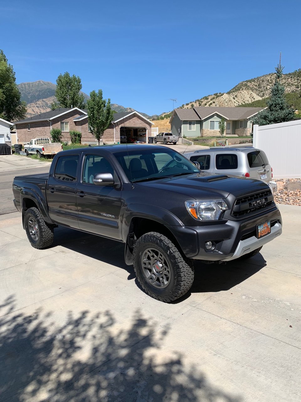

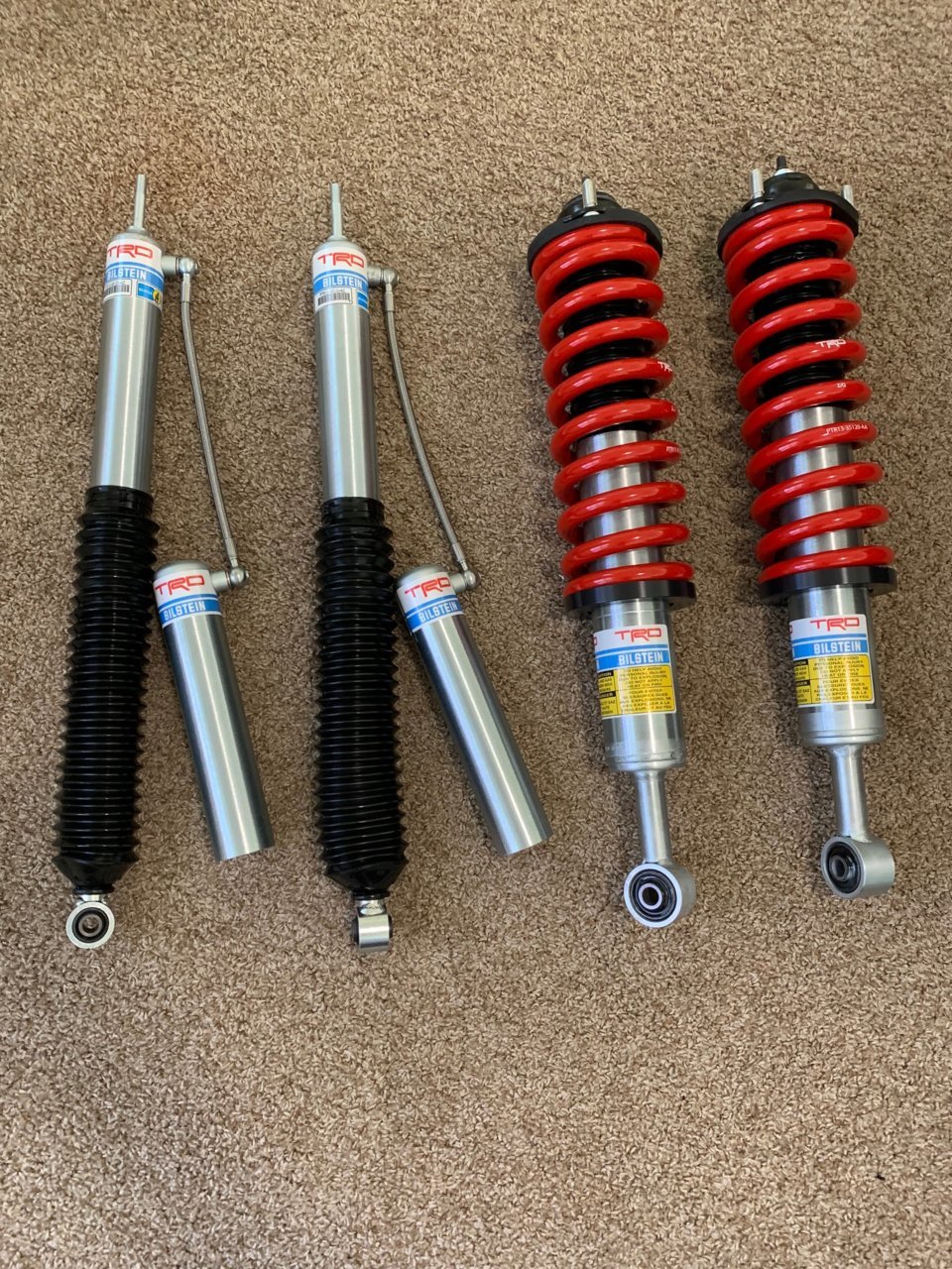

    Finally (after a few months) installed my TRD TX Baja suspension, Icon AAL and new wheels and tires.

    Good looking truck! How much lift does that end up giving you?

    I measured 2" in the front and 1" in the rear. I removed the OEM overload spring, I'm undecided if I should have left it on, because I really don't have any rake now. Maybe the coils will settle a little. Plus I gained 1" from the tires.
