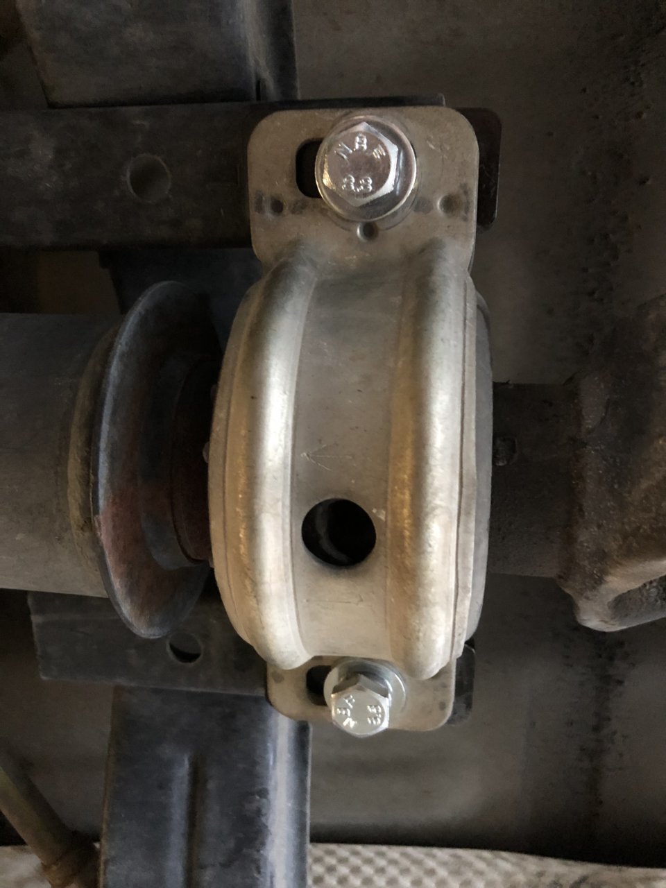

    Installed OME Driveshaft spacer kit and greased the drive shaft, JBA UCAs, Sway Bar end links and outer tie rods. Here’s a pic of the spacer kit installed. Seemed to smooth it out nicely. B66AA153-9F37-467D-A379-1A9D120E38C6.jpg

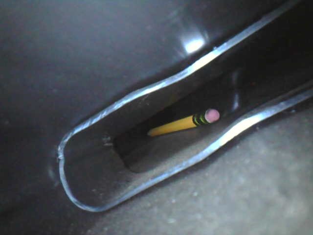

    Where is that location?

    How hard of a job was this? I need to do this soon.

    Undo 2 bolts. Inset spacer. Put bolts back in.

    Is this the part that reduces the take off shaking after lifting the truck? If so, do you have a link to the part that you bought?

    Yes it is although it seems people’s results may vary. It is always best to measure angles and figure out what is really causing your driveshaft to vibrate.
    For my 2015 I purchased this ome kit to reduce my angle after lift and it helped but not totally gone. I will need to calculate and get correct angle shims for the leaf spring perch
    If you search for fk29 arb on Amazon it should come up. Think it was about 20$ to my door

    Under the passenger seat.

    holy shit i need to check there. has sounded like something is rolling around underneath driver seat for like a year

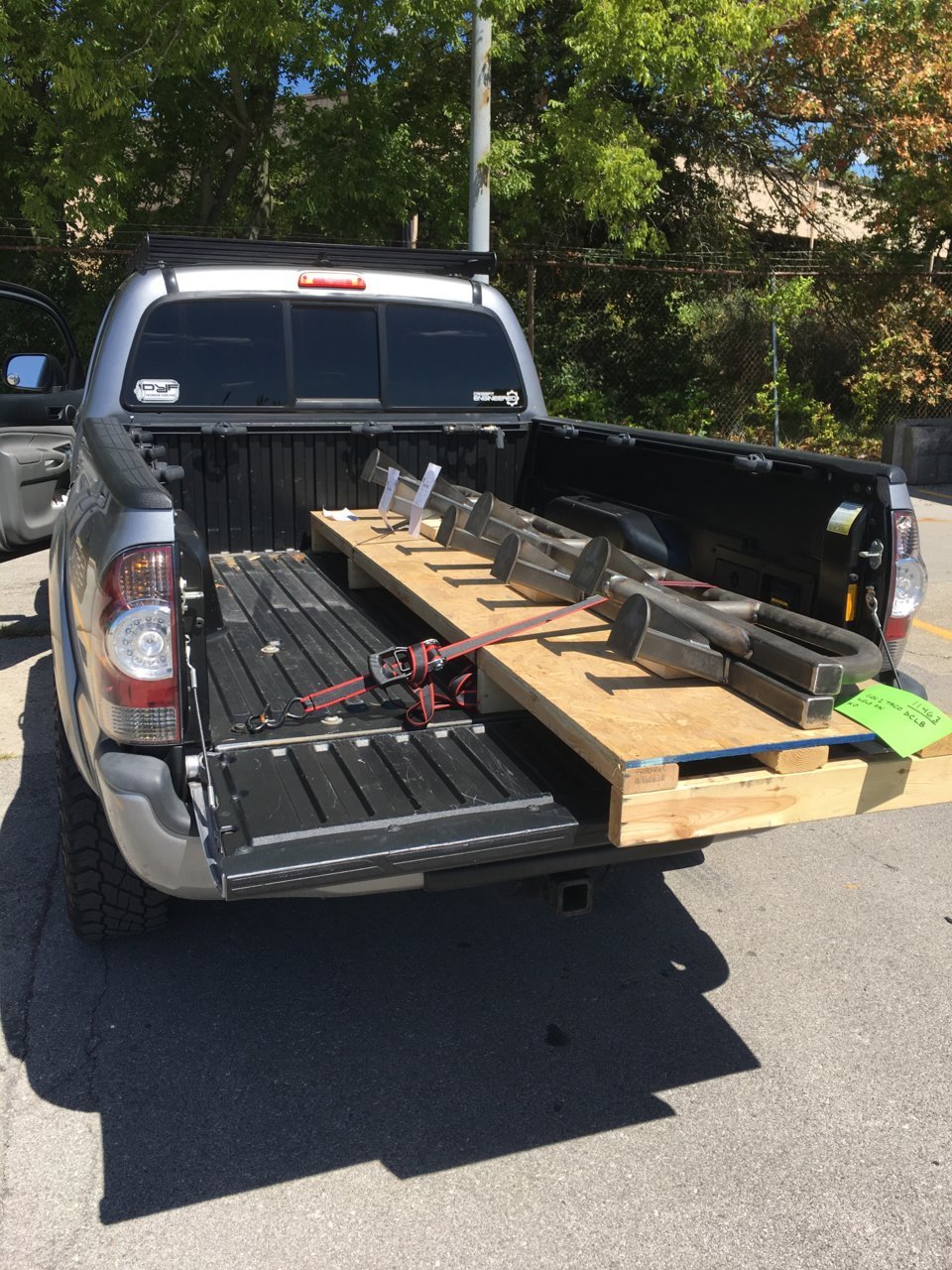

    These arrived today. I bet you can guess my next project.

    Love me some @SOS CONCEPTS sliders!

    Oh, ok, looks like the plastic heating duct, thanx.

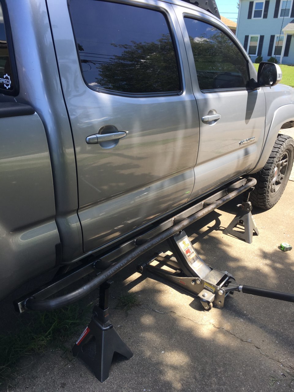

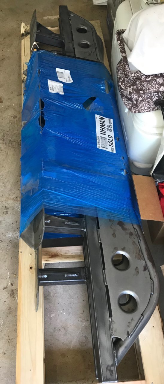

    71E4FF4D-2051-4952-ADFA-485B4CB4A078.jpg Not today but close enough.

    I’m getting my sliders in a couple weeks and I’m trying to decide mounting angle. What degree angle are y’all mounting at?

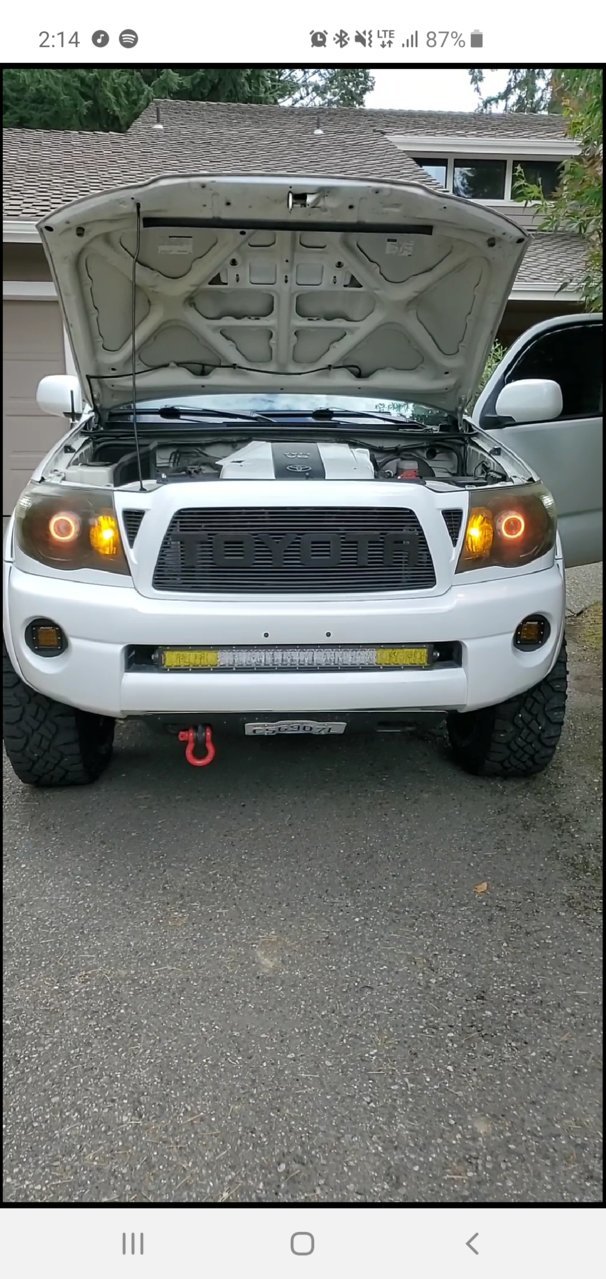

    My halos blink now

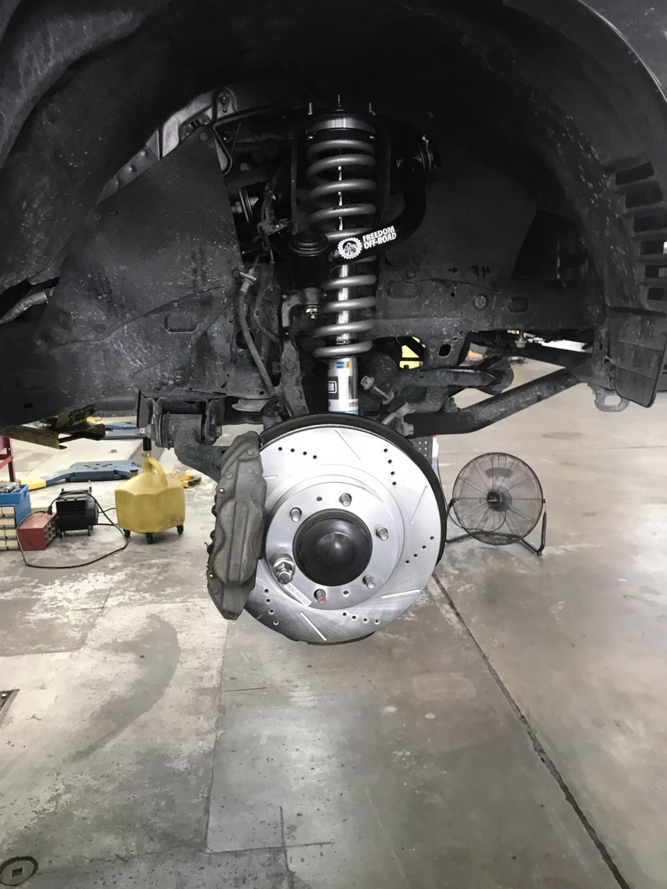

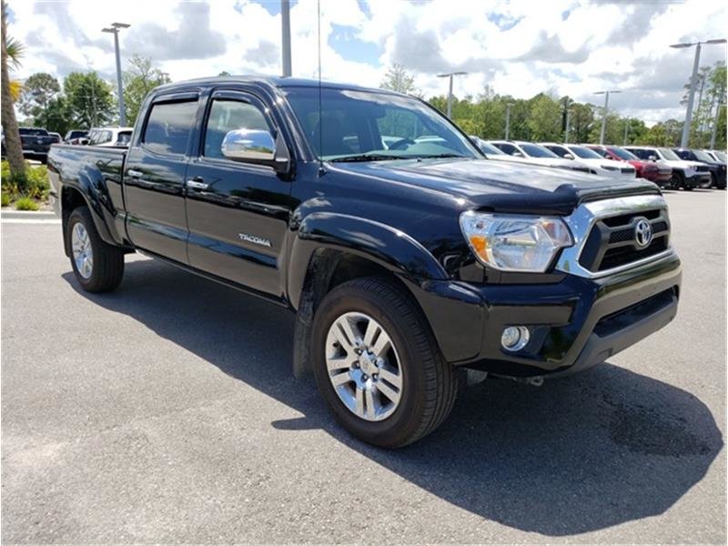

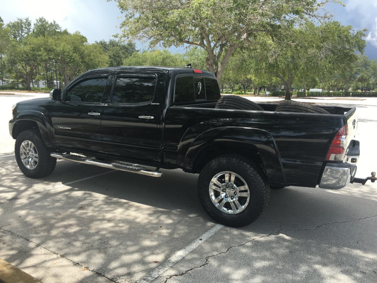

    Ok, heeere we go!
    My new to me 2015 DCLB, from stock to badass lol, super stoked!
    Toytec BK0510 kit 3"/2"
    Freedom Offroad UCA's
    Falken Wild Peak LT265/70R18 on stock Limited wheels 32.9 inches of sexy hahaha
    Power Stop K137 kit, front rotors and ceramic pads
    Ditched the mud flaps doesn't look like I'll need to trim anything but we'll see. Probably gonna ditch the chrome boards next.
    From stock to kickass:
    front end:
    nice
    Love it!!
