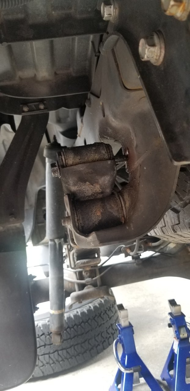

    On the truck I used factory holes. you do have to cut the rubber filler for the bracket to go through

    I might have to drop the u bolts pretty hard just removing the bottom bolt, dont think I can move it to the side enough to sneak the bolt in

    Hard to see here, but have you jacked up the truck by the frame to allow the leaf pack to droop fully?

    355
    Florida
    2010 Trd or , dcsb pyrite mica
    Yes still no go

    You need to jack the frame up. Do not put the jack under the rear diff. :)

    I'll try that I had the Jack under the rear and another Jack on the hitch, I'll try just the frame this time, waiting for the weather to pass bipolar fl rain

    Get it as high in the air as you can and place jackstands under the frame, support the free end of the axle while you do it, watch those brake lines. Once it's up there, lower the free end of the axle until the brake lines are taught, that should give you enough rotation on that shackle to get the bolt turned around.

    could the bolt be "caught" on the frame keeping it from drooping fully? apply some downward force on the axle once it's only supported at the frame.
    watch the brake lines (maybe disconnect the bracket that holds the hard lines to the axle).
    If you haven't thought about it already, be sure to paint/coat the spot that has rubbed so that ruse doesn't form.

    Thanks I didn't even think about the brake lines
