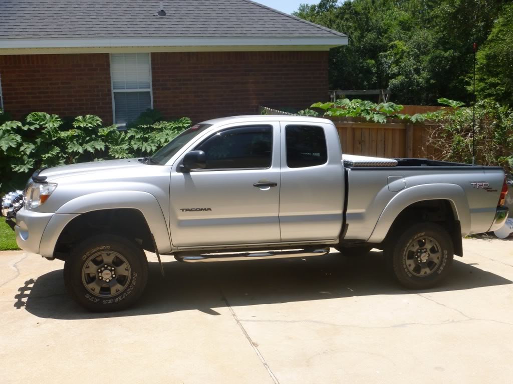

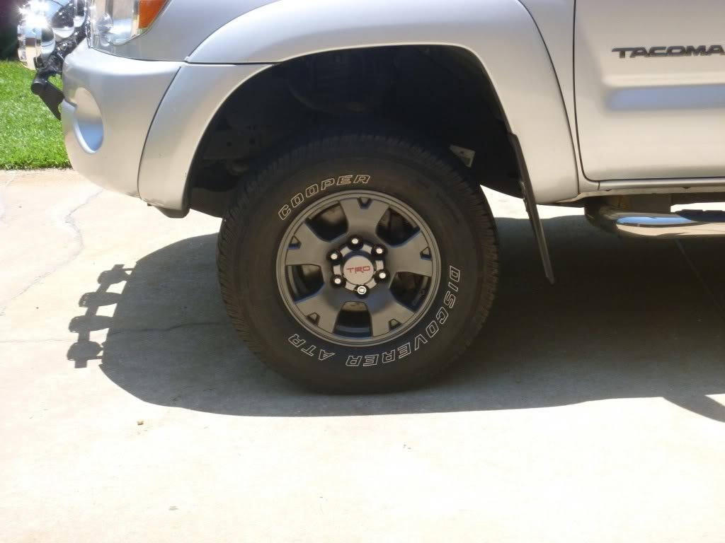

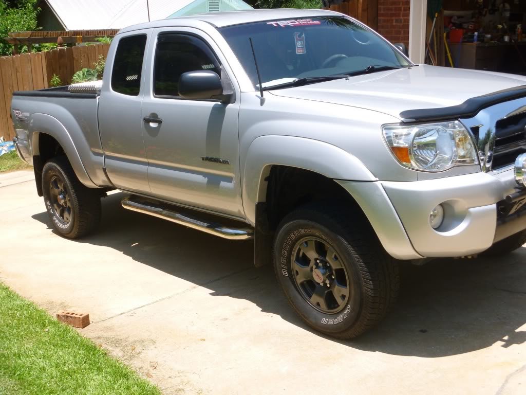

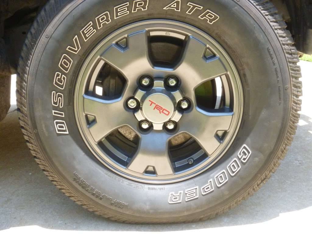

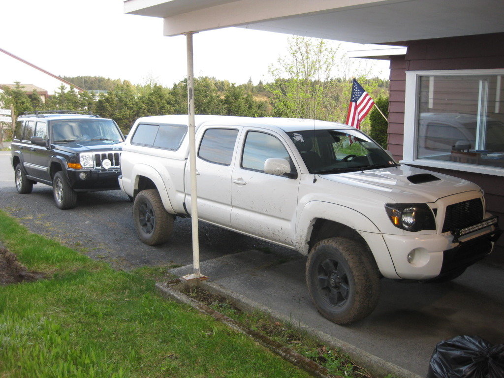

    Just got done painting my wheels. I sanded them completely with 320 grit until all the shine was dull and they were dull in finish. I then taped off the tires and primed with Duplicolor sandalbe primer. I then hit them with 3 coats of Duplicolor graphite wheel paint and let them dry over night. I topped them off with FJ Cruiser center caps. I love the way they came out and really like the way my truck is sitting now, I think I'm pretty much done with mods for now, except maybe the diff breather relocation:cool:

    Looks badass man!!!!

    Thank ya! :D

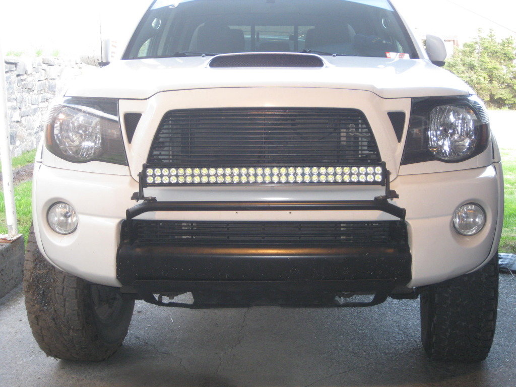

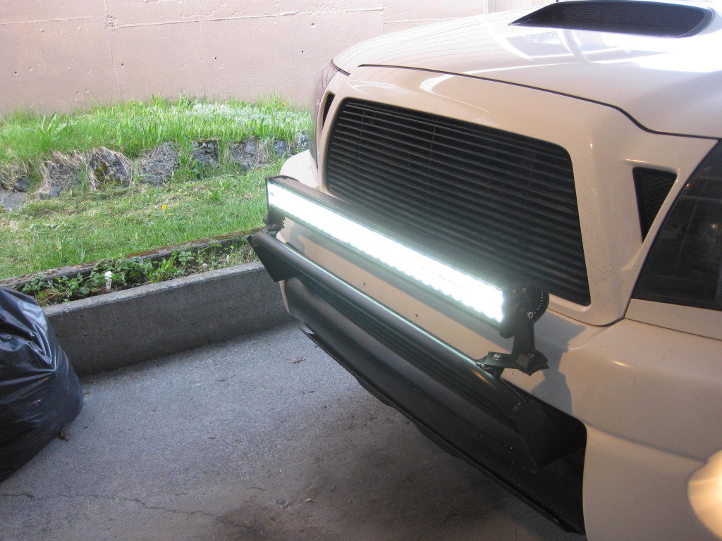

    mounted my light bar today!!! thanks to Jake (Jeverich) for all the help.

    they look really good man! I wanna this too

    Thanks!! It wasn't too hard, and like with all painting, prep is key!

    Love the look. I've thought about doing the same, but I'm not sure how they would look with MGM.

    Put up a picture of your truck in the photoshop request thread and ask someone to make your rims that color, might give you a better idea!!
