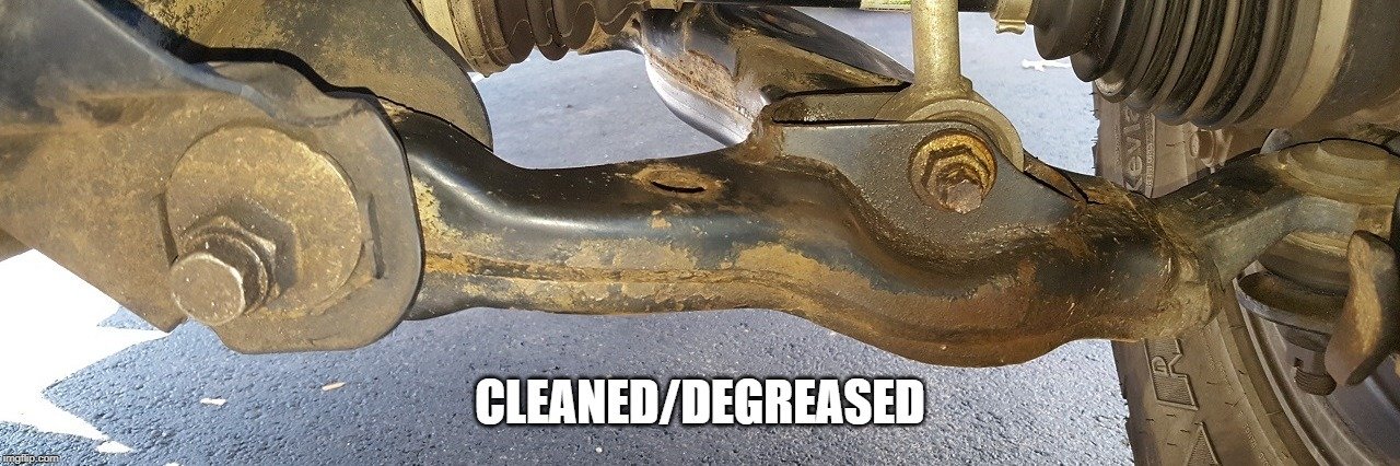

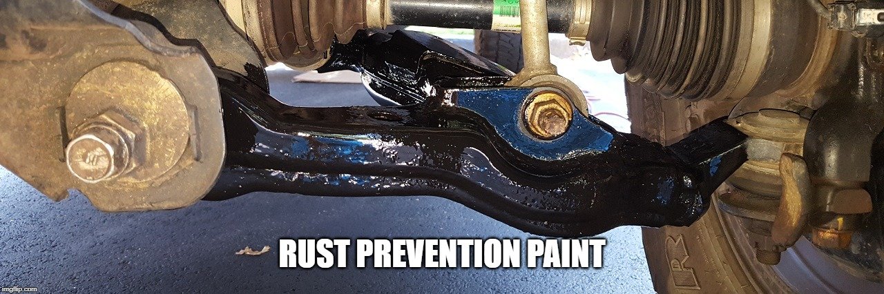

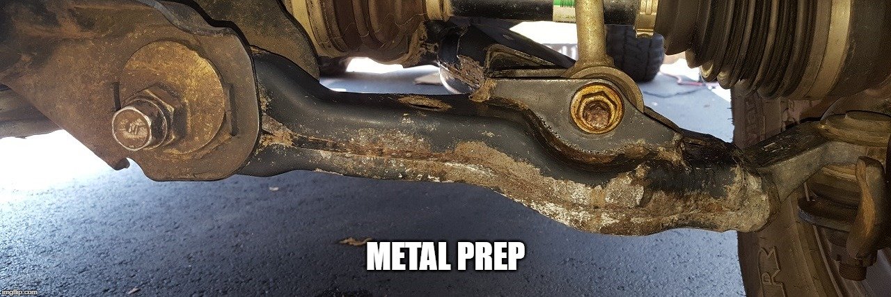

    It's official. I'm a fan of POR-15. :bananadance::bananadance::bananadance: Tested out the kit below on my LCAs since my skids are off. Man what a difference!
    POR-15 Stop Rust Kit: https://amzn.to/30fWs3J

    Does this kit have something for UV protection? I’ve heard that POR15 breaks down in direct sunlight.
  10. Sep 22, 2019 at 12:14 PM
    That one old guy
    That one old guy Well-Known Member
    Mar 12, 2019
    #286340
    1,339
    Chuck
    08 Base 4x4 2.7 Access 5spd
    Stockish
    Yes, POR 15 does sell a topcoat for UV protection. Don't see where the underside (frame, etc) would need it, unless it's on it's roof most of the time. Good stuff, but $$$$$!

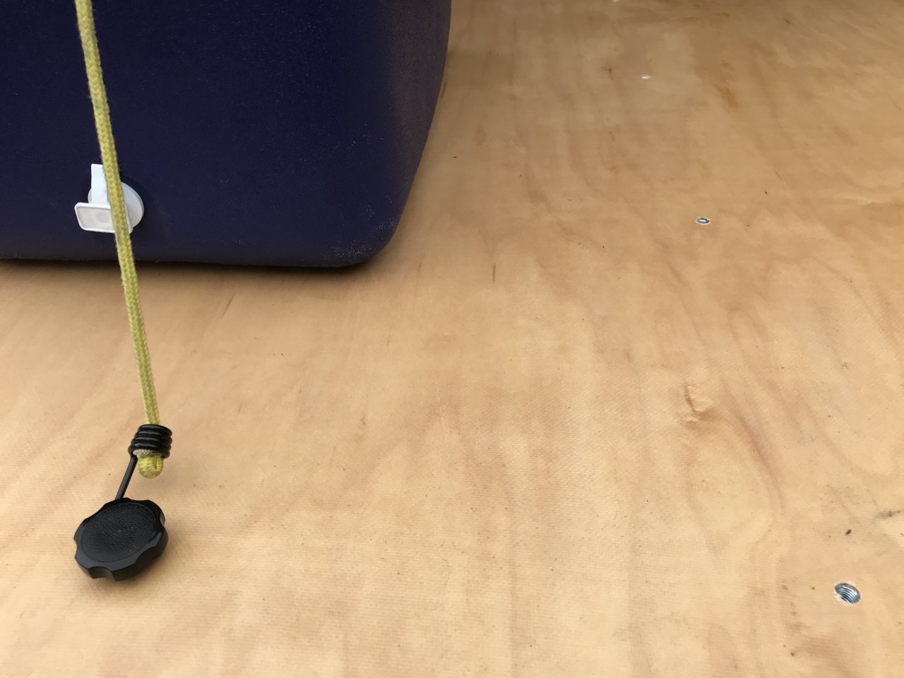

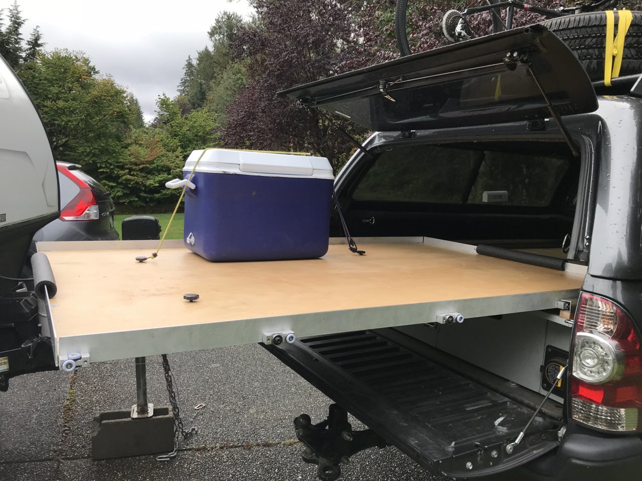

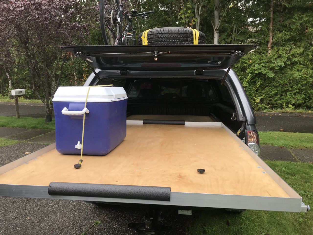

    Trial fit of the DIY bed slide before finishing with roll-on bed liner. Also need to sort out the latch mechanism so it stays put where I slide it to - and not fall out on the ground.
    I don't expect to carry heavy stuff - model airplanes, kites, camp chairs - and use it for a launch/recovery platform for camera drones.
    Skate wheel bearings and furniture sliders in a aluminum channel.
    Drilled and set a bunch of T-nuts in the underside, before laying up the fiberglass. These show through on a 1'x1' grid so I can move tie down hardware around for various loads.
