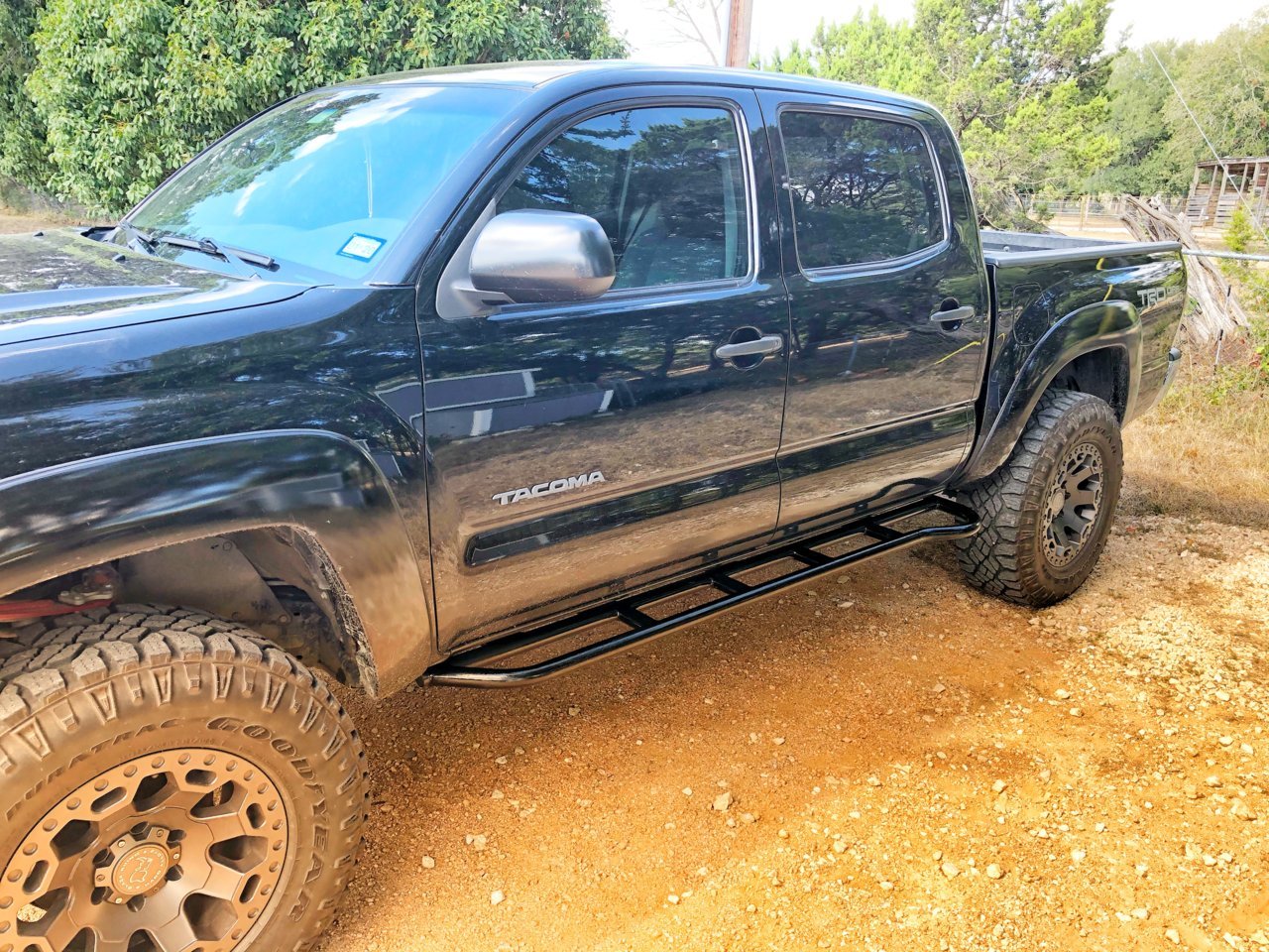

    First on race day!
    Secrets
    Custom fabricated rock sliders built and installed by good friend @Bigdaddy4760

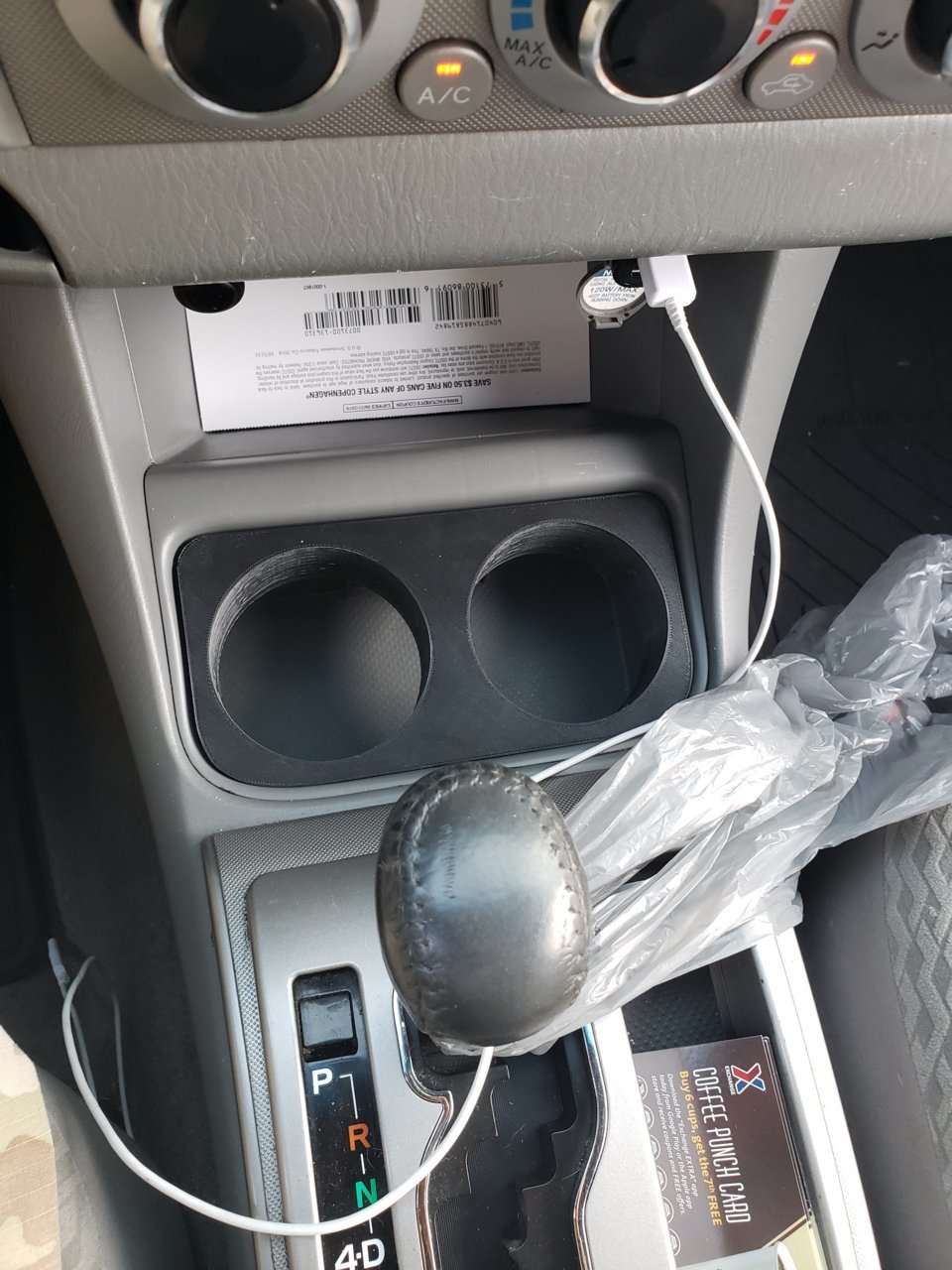

    Got my cup holder insert from @rns0504 and put it in. Don't have to worry about my coffee spilling anymore!!!

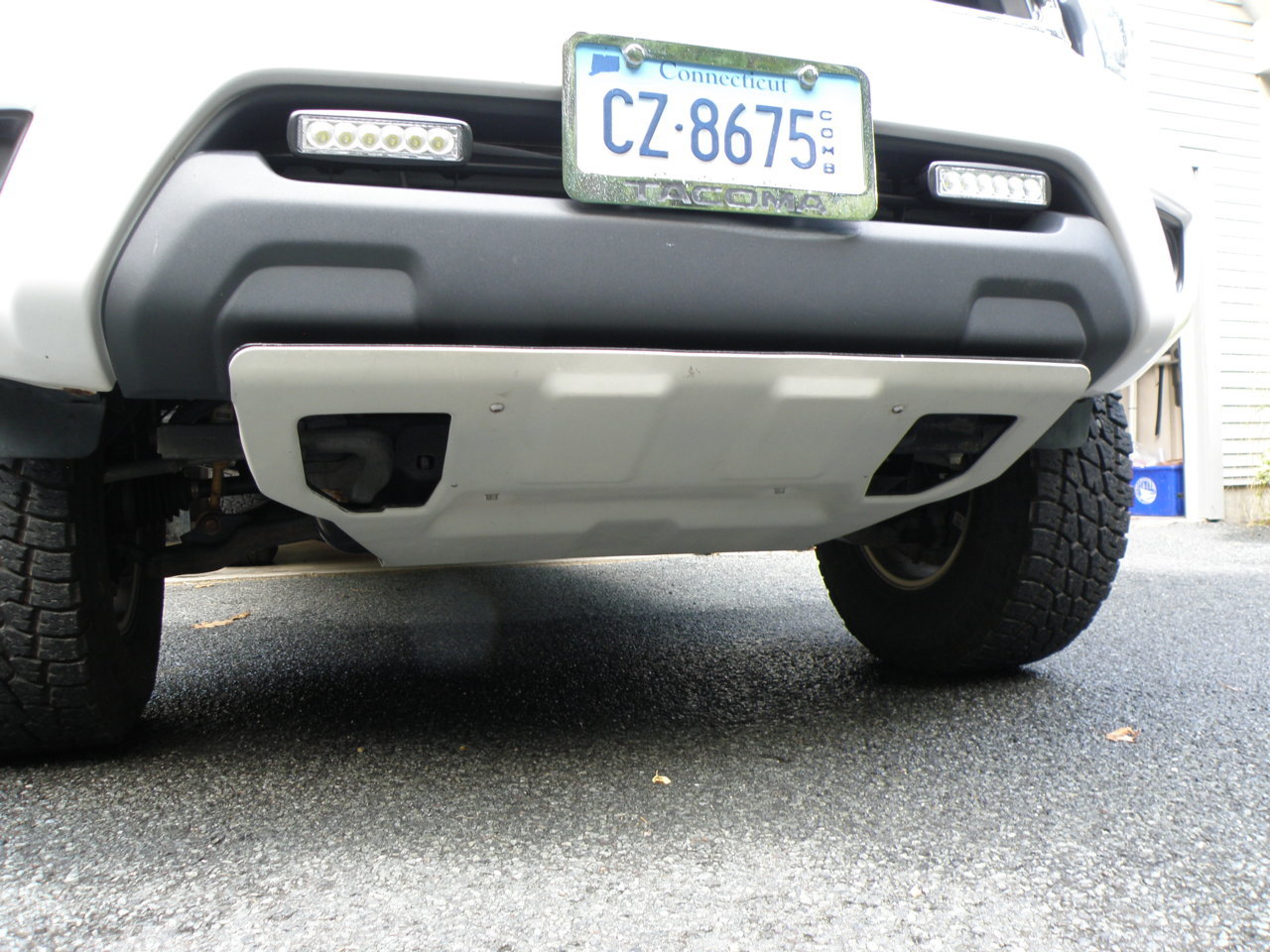

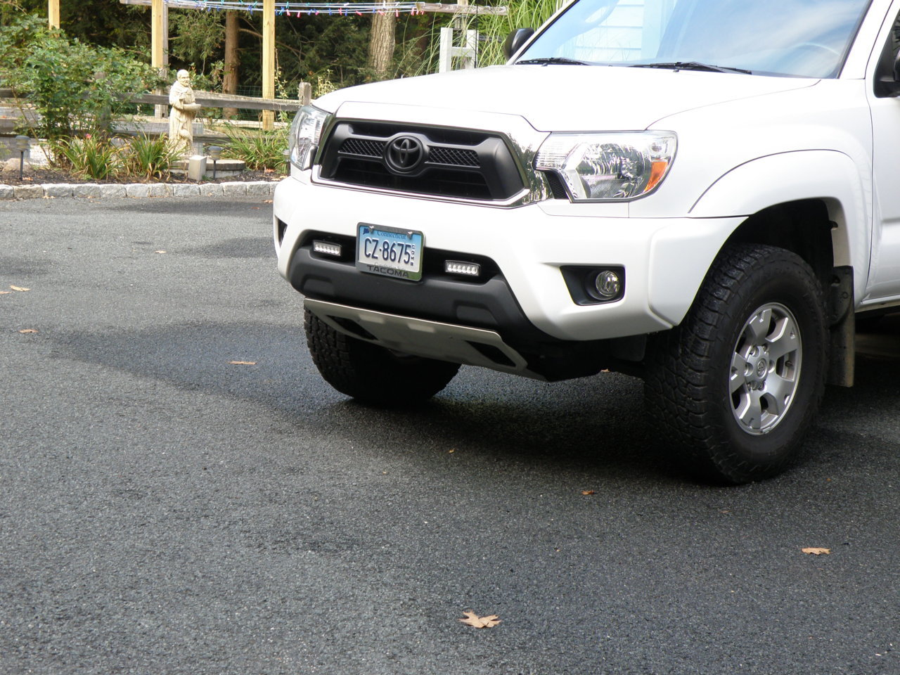

    This morning a spent a couple hours combining the 2 OEM optional aluminum skid plates that I picked up here and on craigslist to make a very solid 1/4" thick solid skid plate ...

    What did you have to do?? I'm picking that skid plate tomorrow for 100

    I picked up one here in fair condition and mounted it, it was nice but felt it needed a bit more. While thinking of how I could reinforce it I came across another on Craigslist that was like new. I decide to see if I could layer the two together, I had to swage the rim on the lower plate (work slow, aluminum can split) to get them to fit, I then installed 2 pop-rivets to keep them aligned during install, used longer attachment bolts and once bolted in they made a very solid skid plate. All the access holes work and do not interfere with anything. I will need to add a trim along the front edge for cosmetics.
