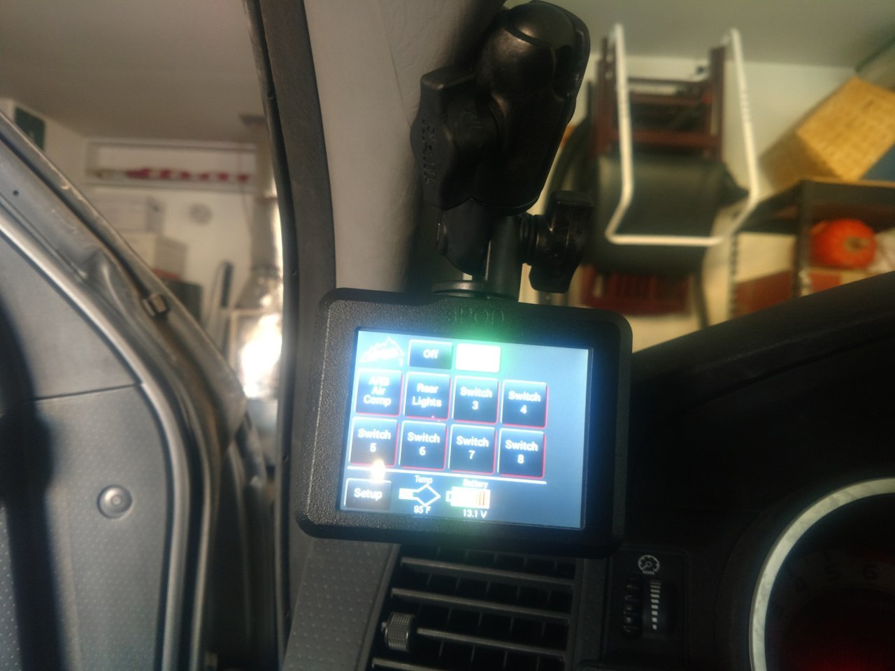

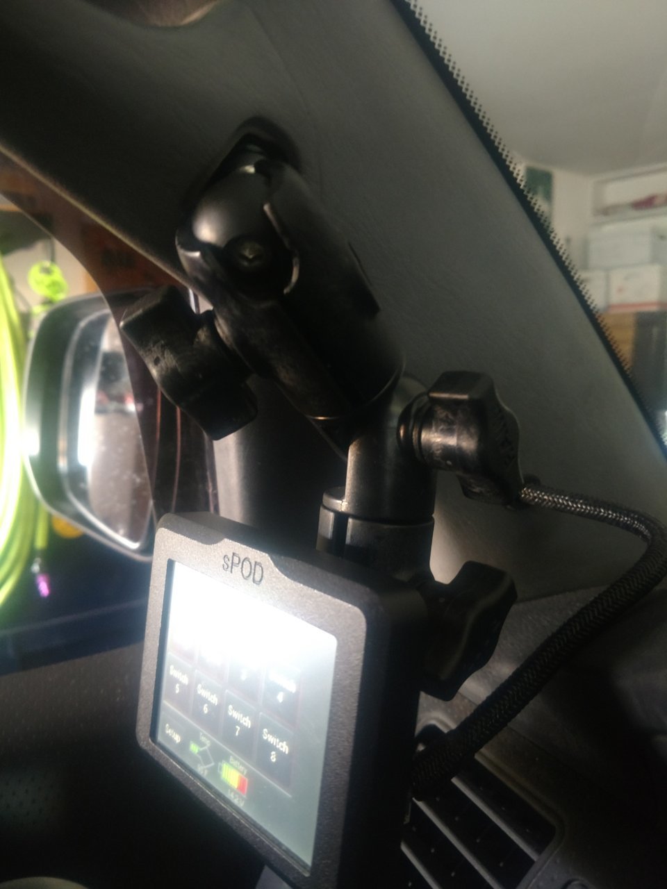

    I did the A-Pillar RAM Mount mod and mounted spod controller.IMG_20191110_155401749.jpg IMG_20191110_154943830.jpg

    That turned out nice. I remember when you first posted that you were building it. Even better when you DIY :thumbsup:

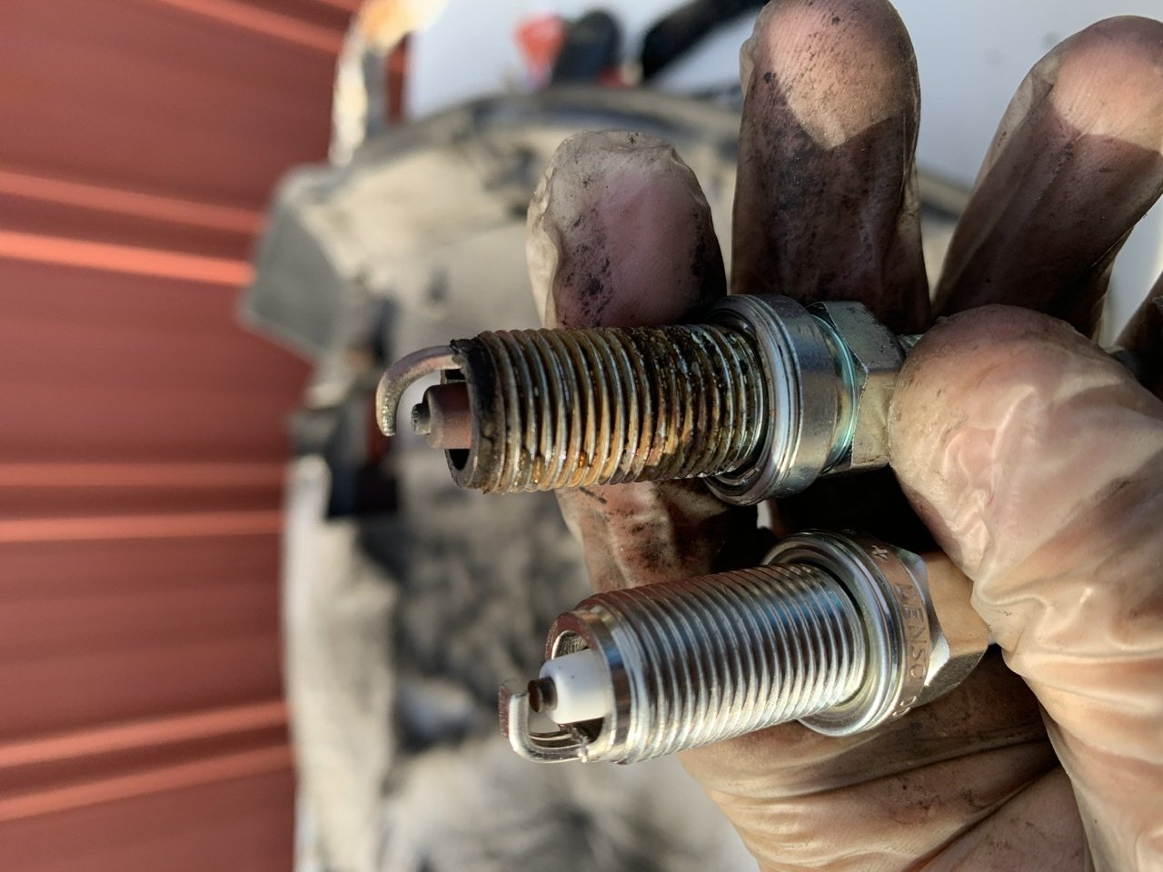

    My 06 got some new plugs today... she’s much happier.

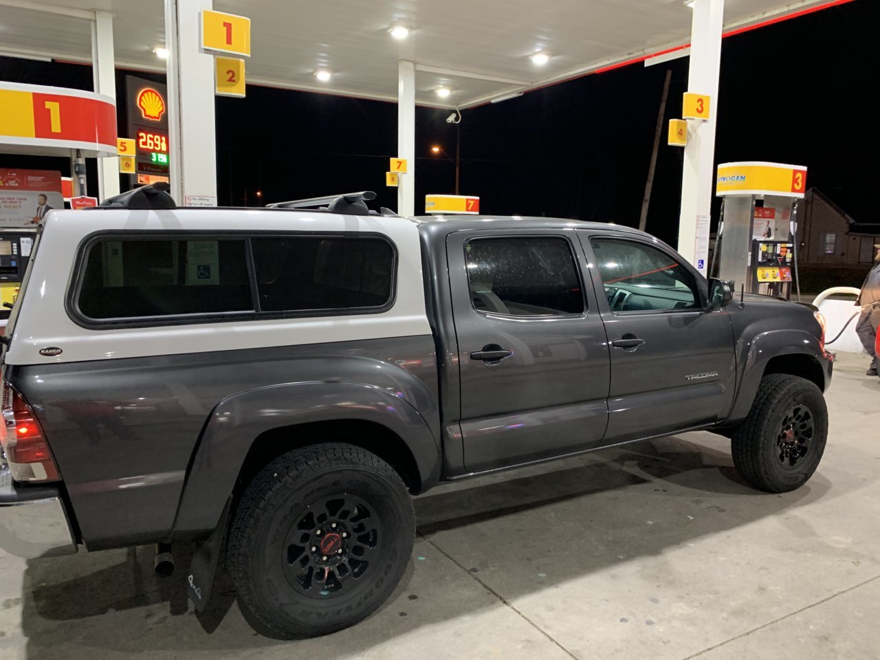

    Finally found a cap, personally think the white looks good on the grey.

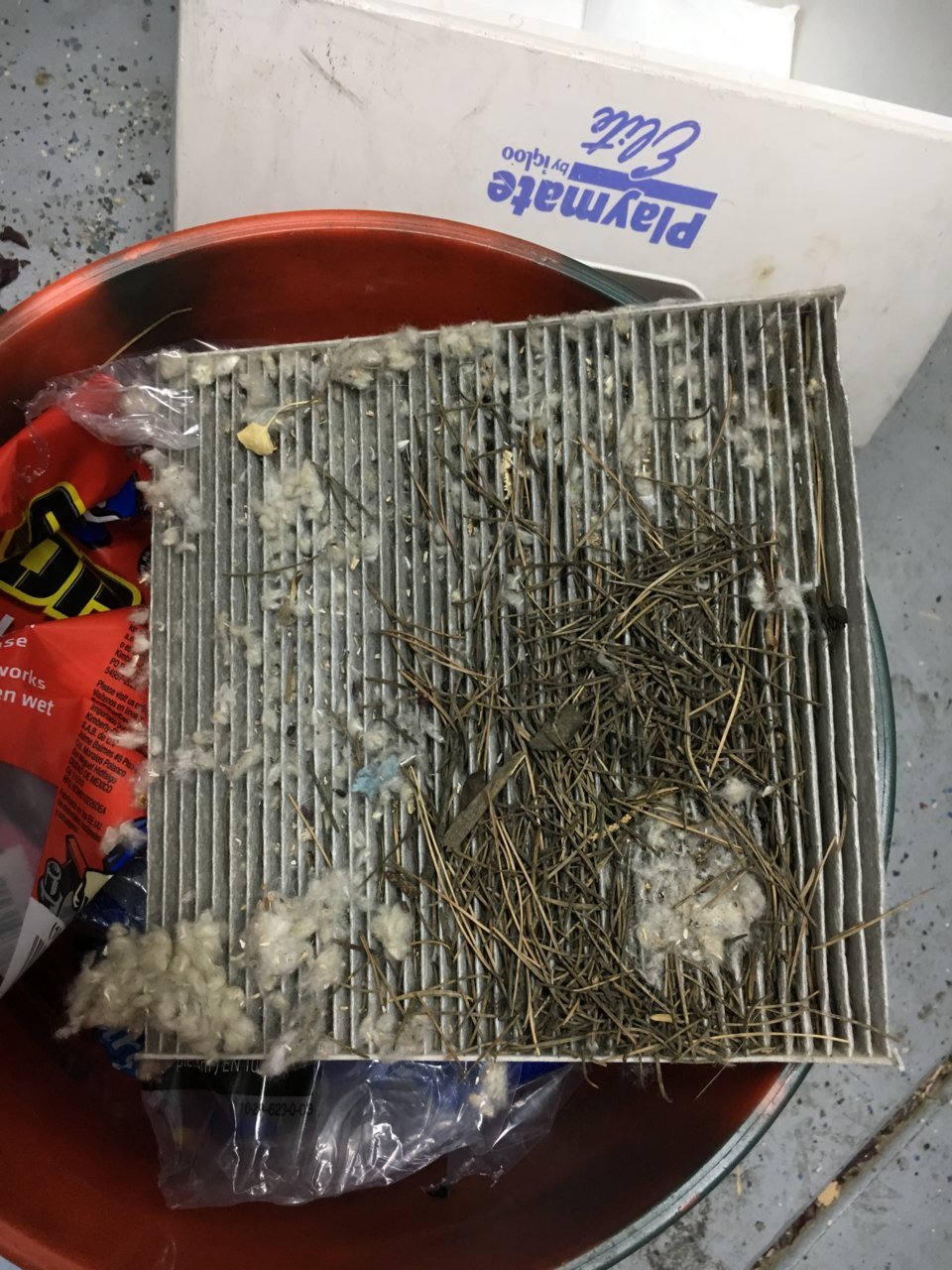

    Mice had built a.nest in.my cabin filter.PO never changed it

    you win dude:bowdown: this could make the beginnings of a fun thread: who has the dirtiest cabin filter

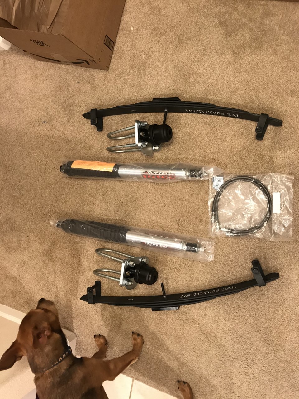

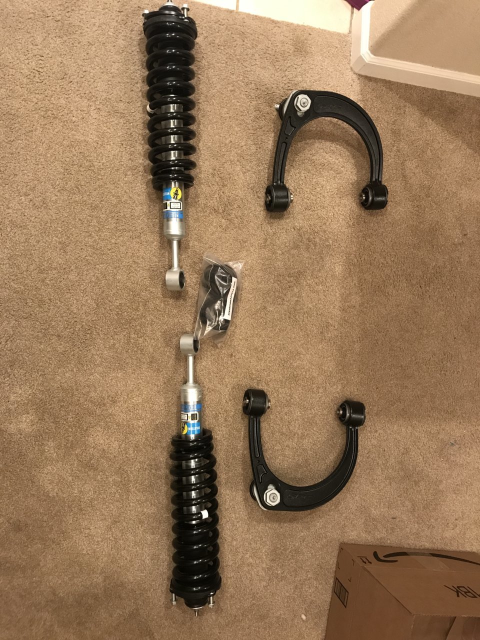

    Got the job done with help from @johntoyota huge thanks to him. We got through the front end in just a couple hours yesterday. and somehow during such a quick install, we still ended up getting bitched at by a grumpy old neighbor driving by in the complex while we had it up on jacks and had the grille off. Always fun to meet such pleasant neighbors. Anyways Got the spc‘s set at the +3° Setting for now
    For the rear aal had to grind off the one rivet but grabbed an angle grinder and cut a hex into the head and then some bigass pliers and broke it off and grinded it down and put a coating of rust prevention over it.
    The drivers side leaf bolts were no problem, i did it one side at a time rather than both at the same time, the ubolt flip kit + super bumps went in super easy once it was all undone and the toytec boss rears fit like a glove. Holy hell did i have a rough time first getting the front leaf bolt to break loose on the passenger side. Soaked it in wd40, had a 2 ft breaker bar on it, then finally just put a wrench on the inner nut used another flanged nut overtop that to keep it from popping off and whacked it with the hammer til it finally broke. But that only got the nut free on the back for some reason the threads wouldn’t grab on anything to get the bolt out of the bushing, and the part of the frame the bolt goes through was so friggin tight i had to use the pry bar to get it free.
    i think we’re supposed to get some snow tonight tomorrow so i finished it up with barely perfect timing, i lost the sunlight by the time i got the passenger side in there and bolted back together so wasn’t able to get a final after photo with it all donezo, but i did get one after getting just the front done yesterday haha so it’s got quite the gangsta lean
    Still need to do the extended rear brake lines, cb drop bracket, and i got some ditch lights with the roof rack i put on a while back so i scooped up a auxbeam wiring harness’s, switch and ditch light brackets to go on next
    very happy with the new height though and picking up some 285s early this week and getting the alignment scheduled for right after that. I’ll keep an ear out for the spc clunk and hopefully i got a lucky set

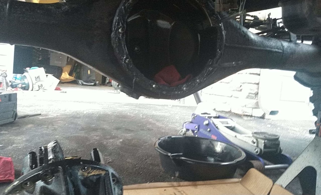

    2 weeks ago I put a new diff in, i was too cold to care enough to scrape the old gasket off and seal it properly. So today the diff came out again for the third time in a month.

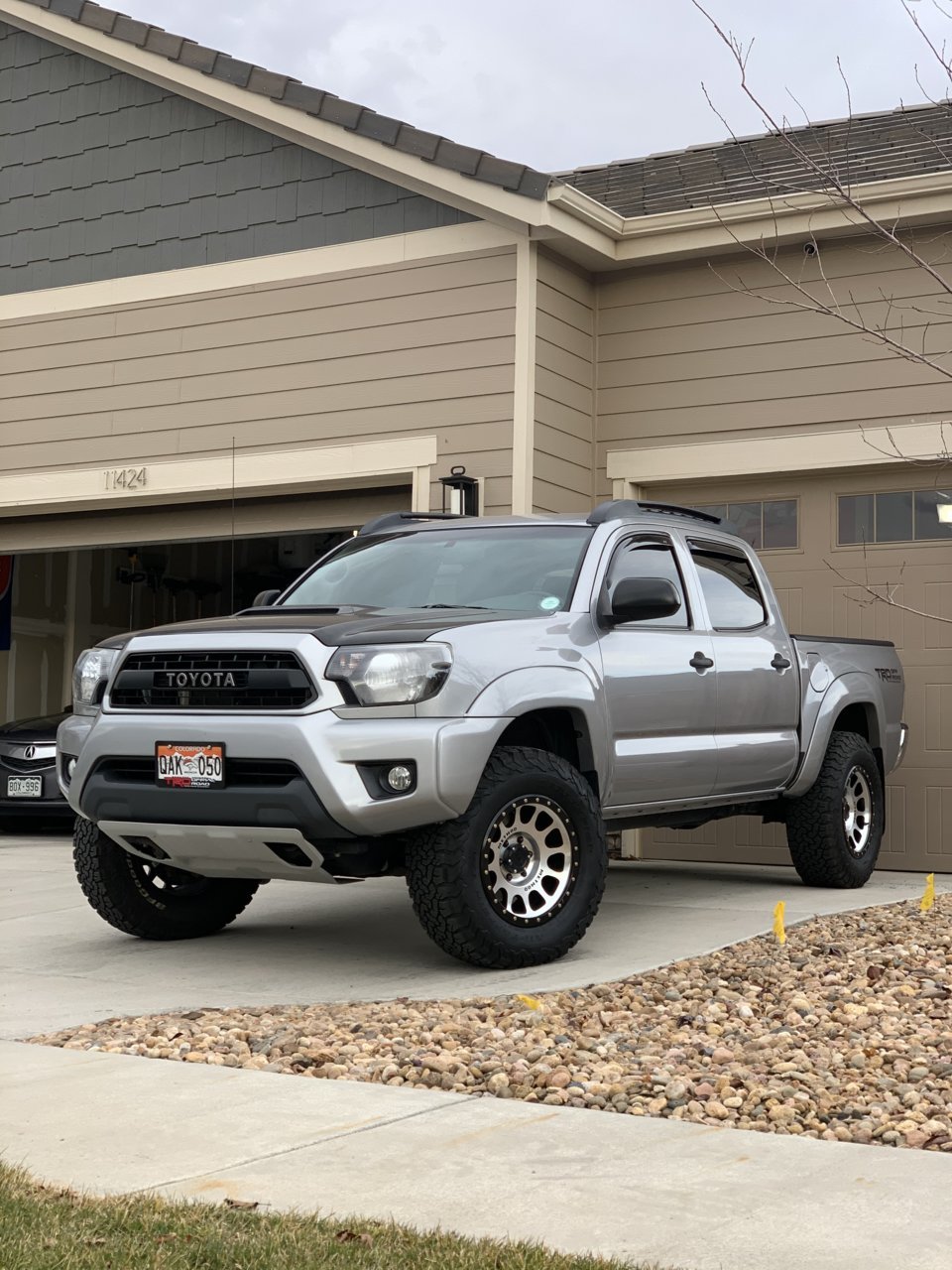

    Added the sport hood, got some tint, added the wind visor/rain guards, and roof rack... busy busy......
