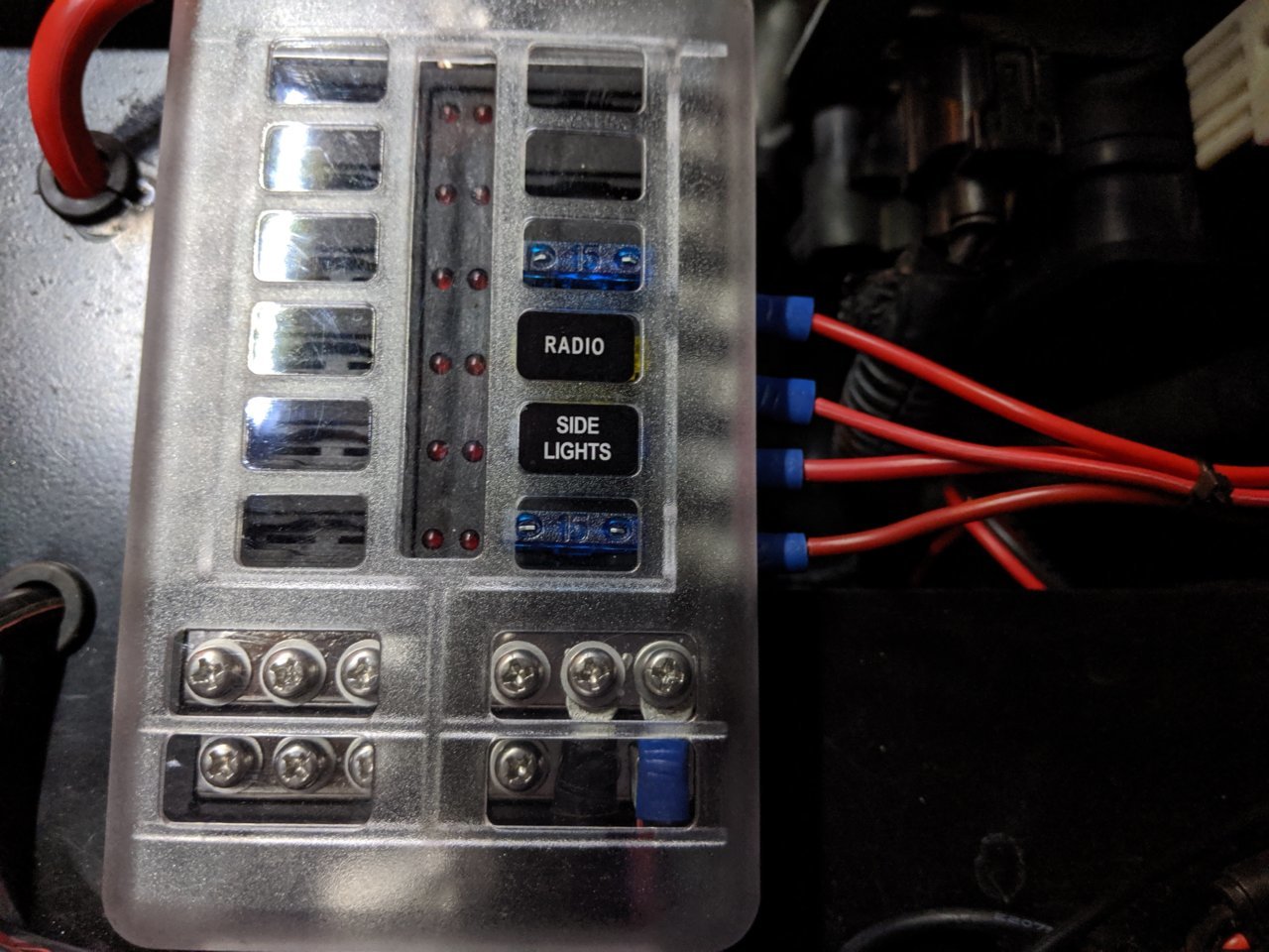

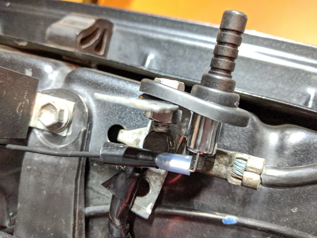

    Basically you have the negative hooked up to ground..in my case the ground is in my aux fuse box. The positive is hooked up to the bottom of the switch pin. When you open the hood the switch pin make a connection with the positive (the switch is spring loaded) and when you close the hood, the pin disconnects from the power allowing the power to be off. Very simple to be honest.
    Here's a short link to a video.. YouTube wouldn't let me upload it. I hope this helps.
    https://photos.app.goo.gl/JrCysG74yjAzoAMw9

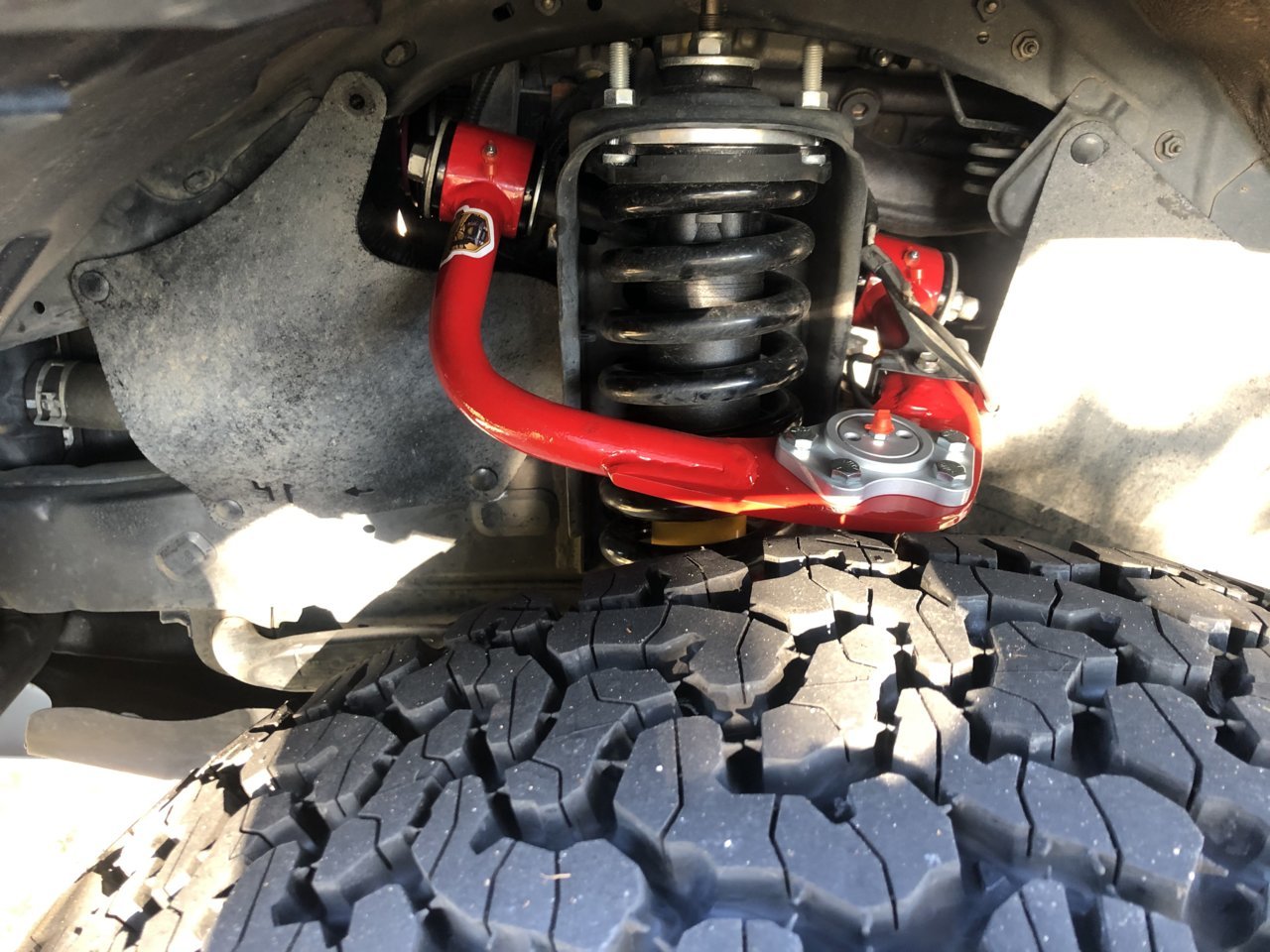

    Added some JBA UCA’s and got it aligned.

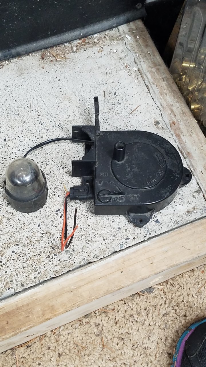

    One of my favorite unk yard finds, although never got around to installing in my old 4R.

    What about just adding a switch next to/in line with the hood switch?
