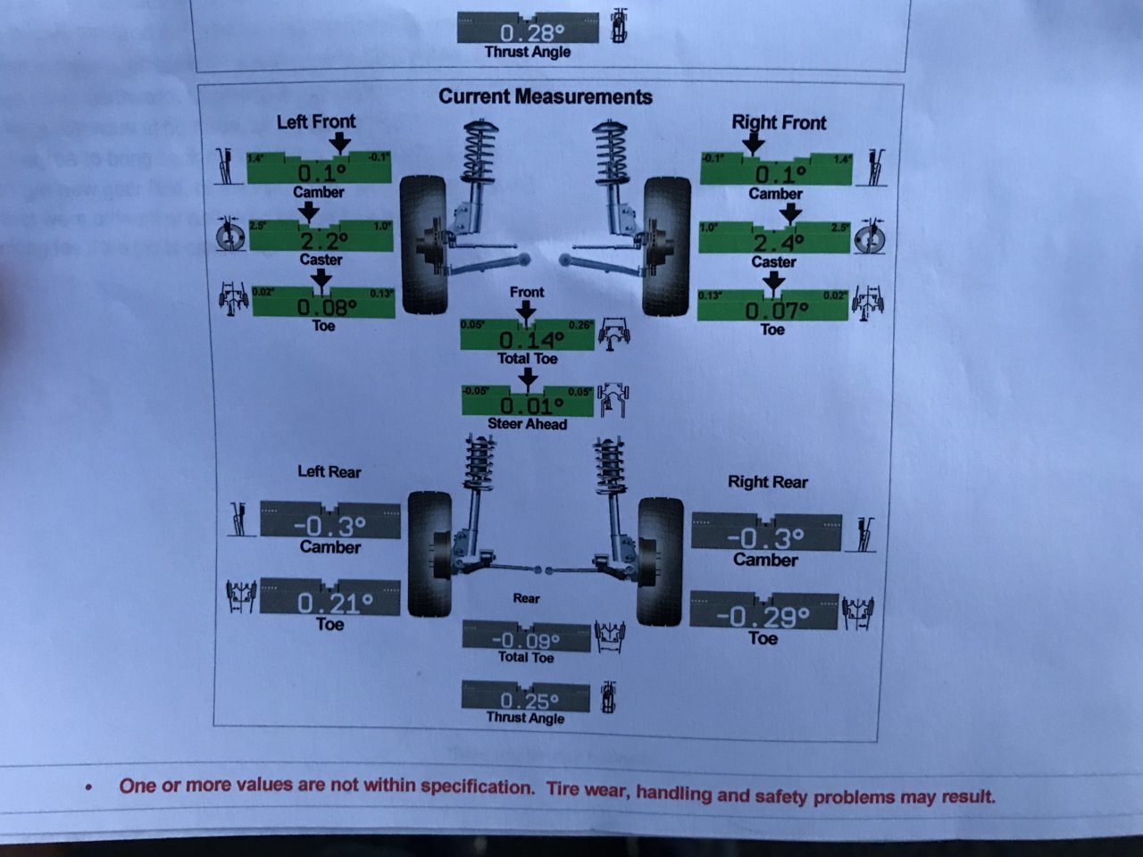

    Got the alignment done with the new tires, i think it still needs some tweaking though, it’s a slight pull to the right
    also is the rear toe#s way outta whack or is that normal?
    gonna drive it for a day or two and see if it’s still consistent before bringing it back to them to get it totally straight so i can go “look ma no hands!”

    solid rear axle. No adjustments possible on the rear.

    That’s what i thought, kewl

    both your rear wheels are pointed to the right, which indicates the rear solid axle is not perpendicular to the direction of travel. This may have something to do with your pull. have you done anything on the rear suspension recently? .25 degree to the right means that the left side is about .3" further forward than the right side. i dont think there is that much play in the alignment pins
