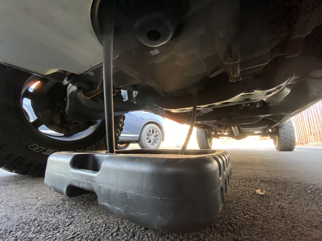

    Did my oil change, and found this.
    Should I worry? I don’t do long distance driving. 2-3x a week, I put maybe 12km if that lol. Very short distance driving, 90% of the time.

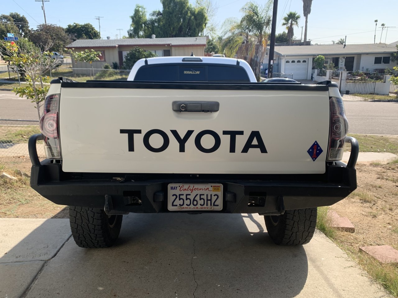

    OH THAT SUCKS!!
    I thought I was gonna bring that back... LMAO!
    Btw, the TOYOTA is 3 1/2" tall and about 23 3/4" long fyi

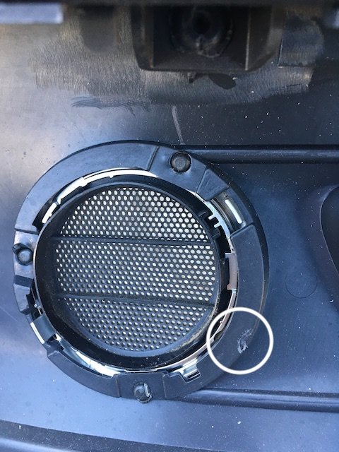

    Put the driver's side bead molding on both doors and added some padding around the tweeter in the driver's door. It's been buzzing slightly at certain volumes. Noticed there was a small wear mark from one the bolts holding the speaker in place on the back side of the door panel, so I cut a piece to fit around it- No more buzzing!. Yes, I was buzzing while driving..:rasta:

    Perfectly normal

    Go for longer rides and evaporate the moisture that is collecting in the engine.
    What you see there is all of the goo, there is probably more in the valve covers. It collects there because that is actually a cooler part of the engine.
    Mine does the same . 20 - 30 miles on the highway helps remove he moisture.

    Normal condensation from making short trips

    That's freakin crazy. I'd crap my pants if my trucks oil looked like that. But I see you're not the only one to write that it's normal. It must have to do with his trucks short trips and the weather/climate. Idk, yikes.

    His oil doesn't look like that....just froth at the top of the filler neck. Normal in cool to colder climates.

    Cold weather+short trips do this. I freaked out the first time my truck did it too, but I found out it’s normal.
