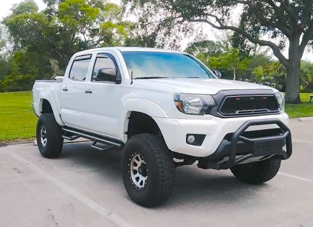

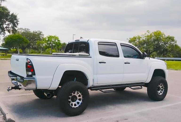

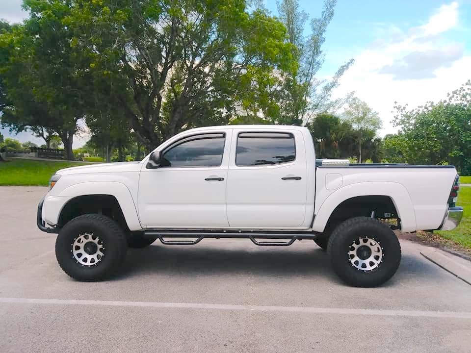

    Yes, I have bigger splash guards! The front bumper stretches, but you have to loosen some of the screws below and push it up a bit to close the gap. The front gap is around 1/4 or less, but it will end up having almost nothing if you play with it. Just look at mine!

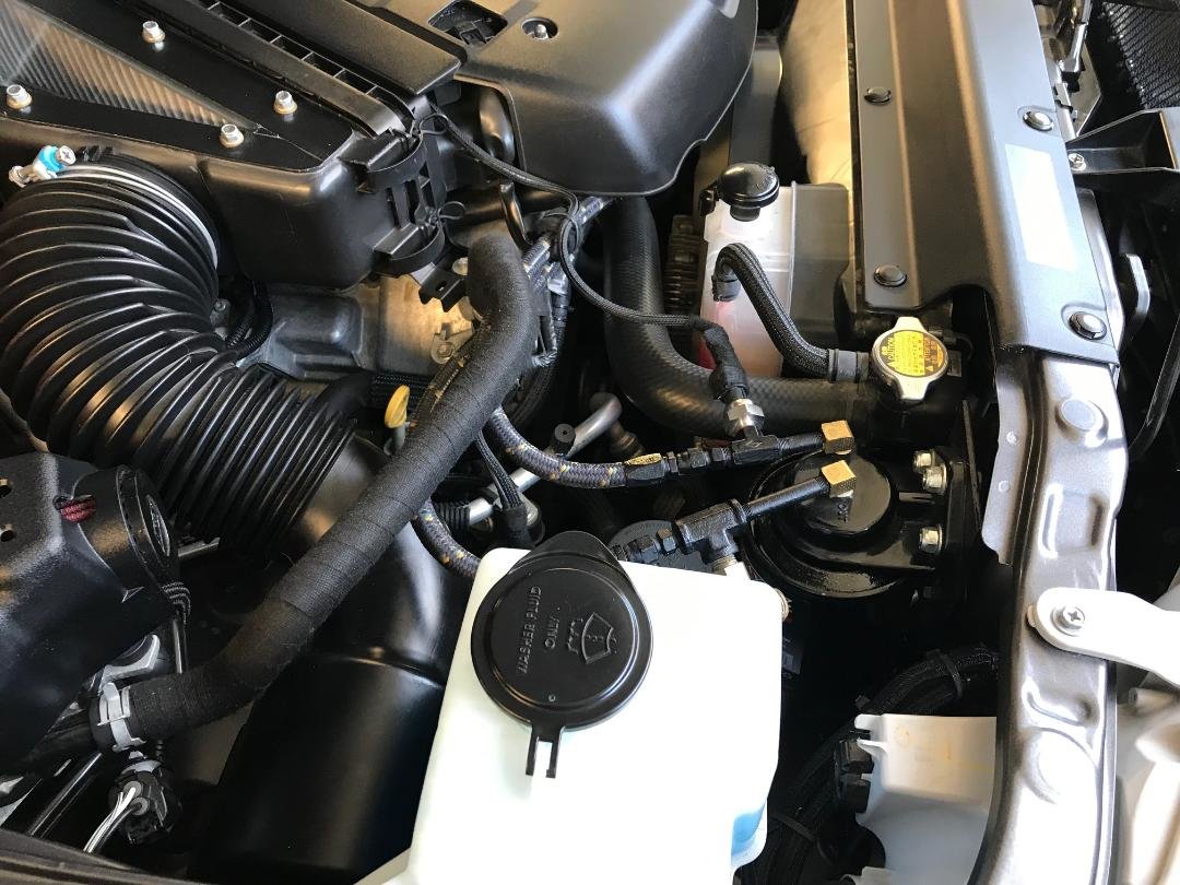

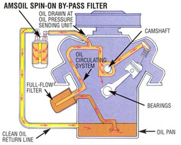

    By pass oil filter return...filters 8% flow of the system, into a 2 micron filter ...98% efficient (OEM filter usually rated around 20 microns, human hair = 75 microns =/-)

    Oh yeah I see it now.
    Looks good!
    Thanks for the info.

    well now that is interesting

    Ok, that seems pretty cool. I'm gunna go search writeup. Lol

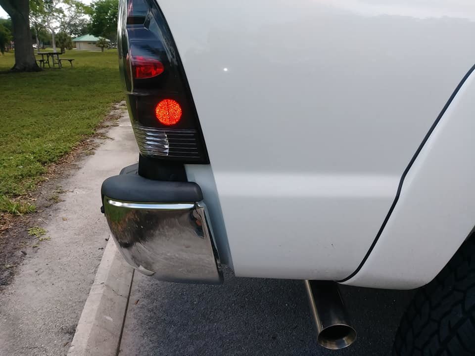

    As you can see the front gap could be fixed. The gap of the rear bumper is not big deal in the 2nd gen, but I am not sure how it's going to look on the 3rd gen. I say go for it! But never go bigger than a 1 inch BL.
