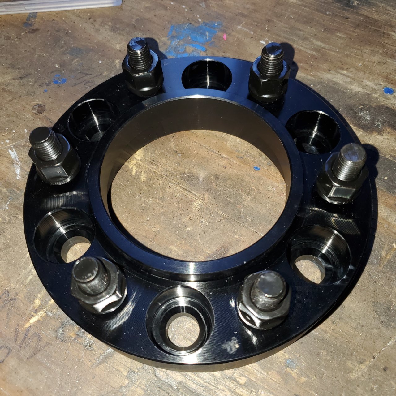

    It sounds like the back spacing of your wheels are incorrect. Spacers will be required with those wheels. Unless you're into some serious fast paced offroading spacers will be fine. Tacomas use hub centric wheels which means the tight fit of the hub and the wheel is what centers the wheel in the hub instead of the lug nuts centering them. That means hub centric spacers are required. Tacoma 6 lug hubs have a hub diameter of 106 mm and most spacers specifically built for Tacomas have a hub bore of 106.1 mm. When I bought spacers for my Tacoma I think the thinnest spacers I could find were 3/4" but they were somewhat pricey. I went with 1 1/4" at a little over $100 for 4 spacers. The spacers came with the required extra lug nuts. You can see where the wheel would sit on the spacer at the hub.
    By the way, the thicker the spacer the more cutting that's required on the fenders, inner fenders, and mid cab mount.

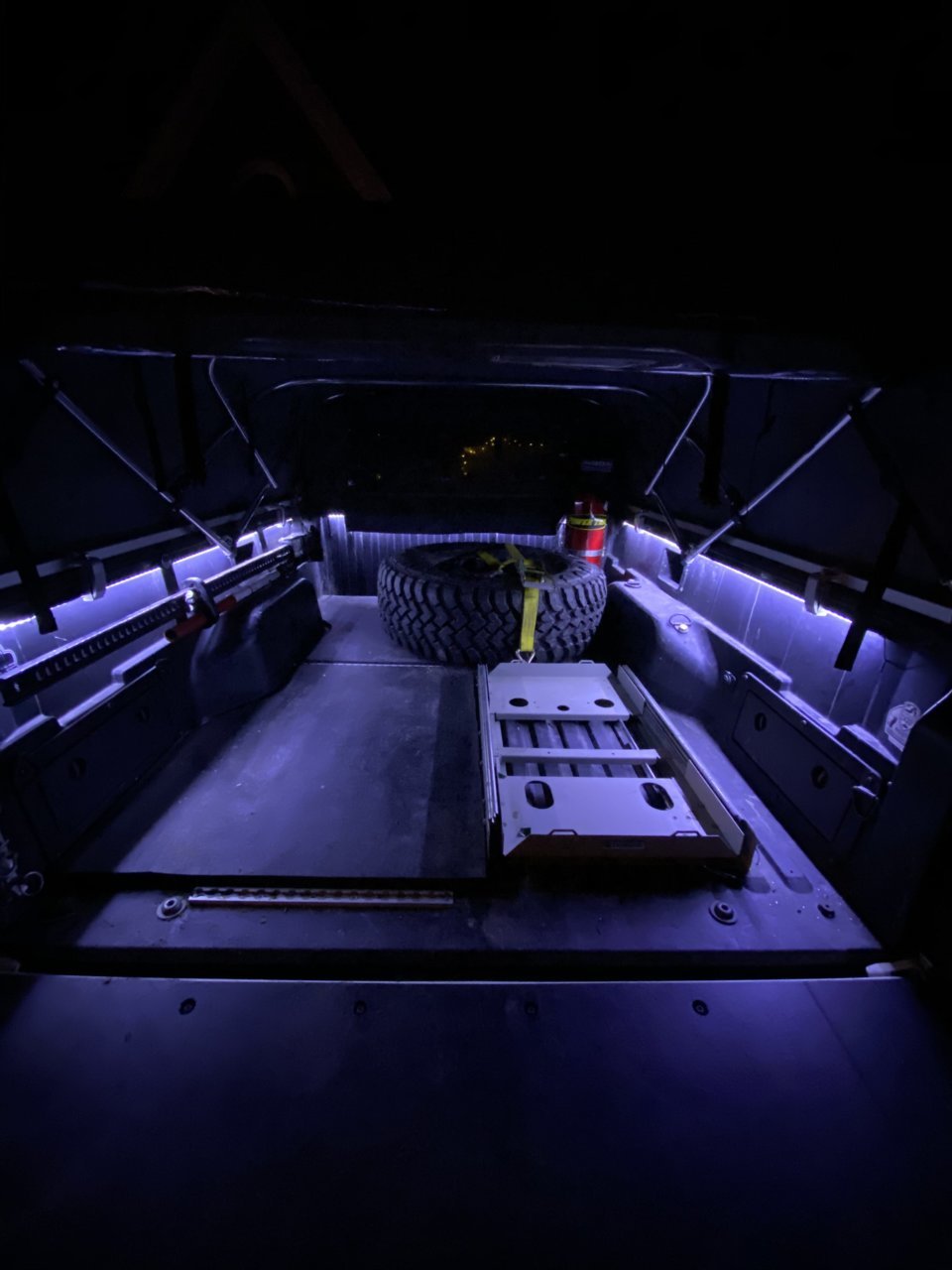

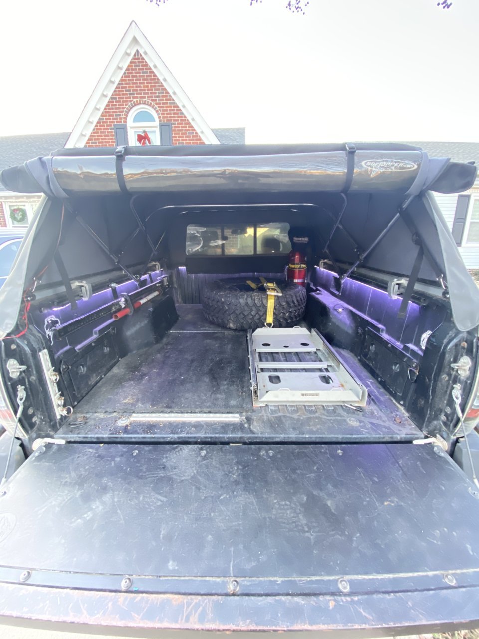

    Been sitting on the led bed light kit for over a year :anonymous: finally installed it today for no particular reason.

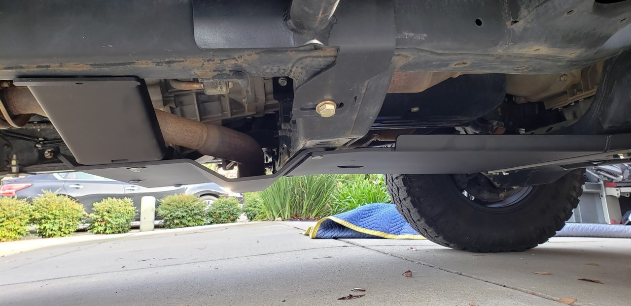

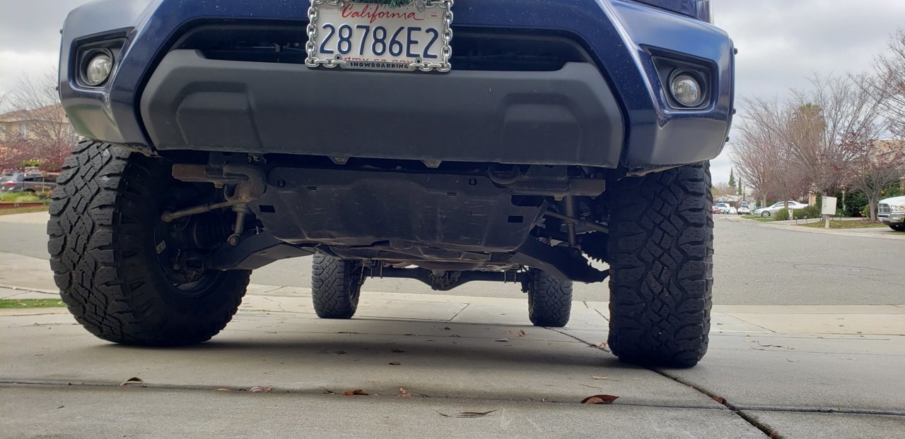

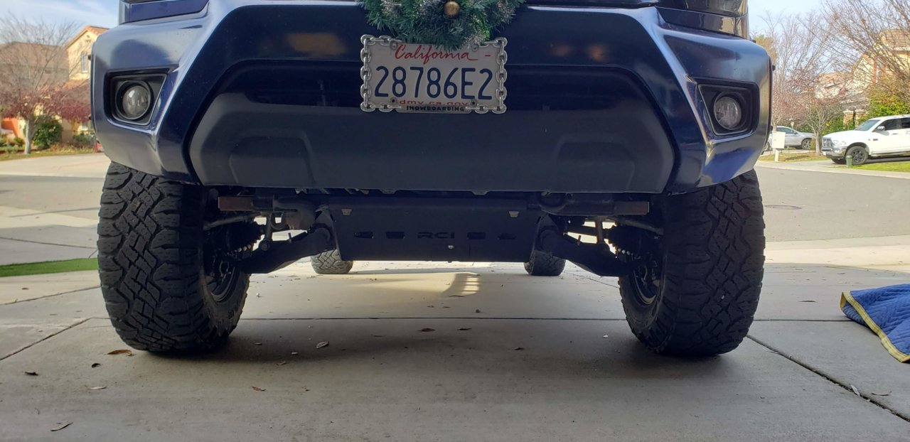

    Installed RCI skids today! Got the Front Skid, transmission, and t-case skids.
