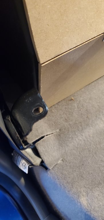

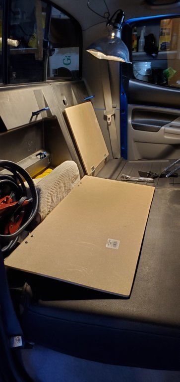

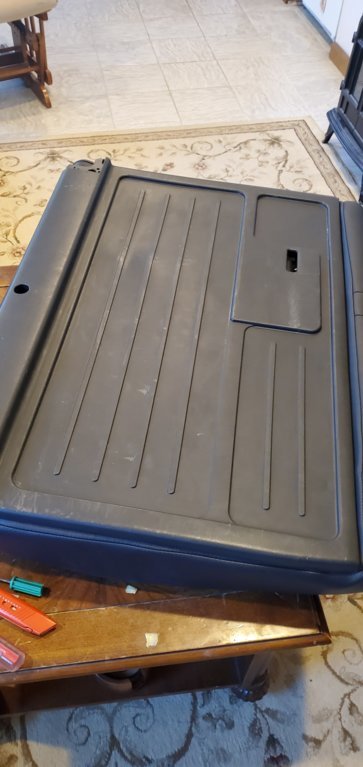

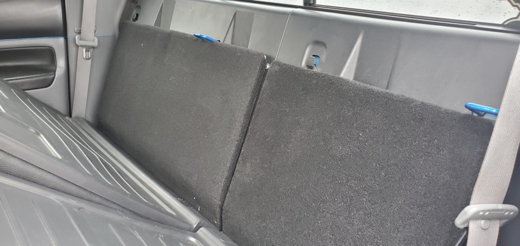

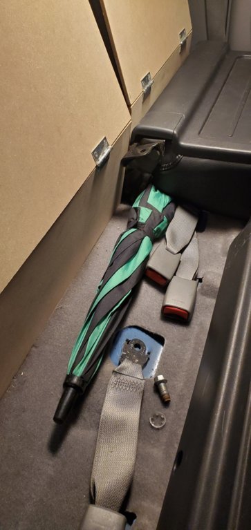

    Wheels and Tires: 17x8" Ultra Goliath wheels with P285/70R17 Falken Wildpeak AT3/W tires, Suspension: Fox coilovers set at 2", TC UCA's, 1.5" lift 3 leaf pack with overload left in Other: TRD SS exhaust, Pioneer AVIC 4100 H/U with Android Auto (awesomeness), sat radio bluetooth, Accessories: Toyota roof rack, black Toyota running board steps, cargo divider, weathertech floor liners, Literider roll up soft tonneau, thule bars over tonneau, USB ports front and rear, seat heaters, birddawg mirror riser Cosmetic: window tint, grillcraft black mesh upper/lower grill, vinyl armrest in doors, Clazzio black seat covers with blue stitch, Redline steering wheel wrap Lighting: fogs only mod, back up lights, amber interior accent lighting, amber 10" LED light bar in hood scoop, 33" LED bar behind the lower grill, amber lamin-x on fog lights, Tacomabeast headlights and matching tails.

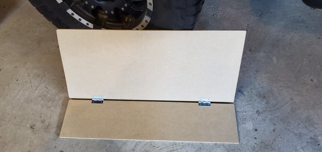

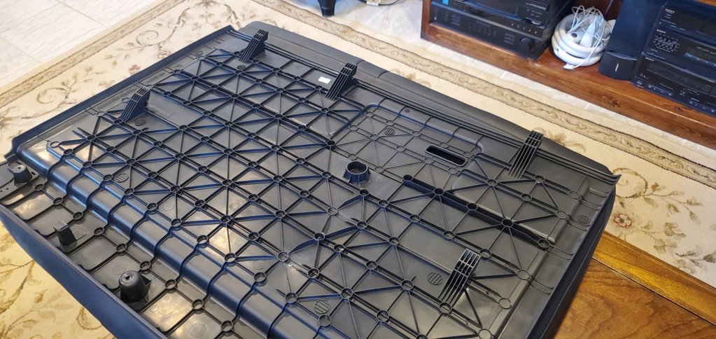

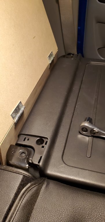

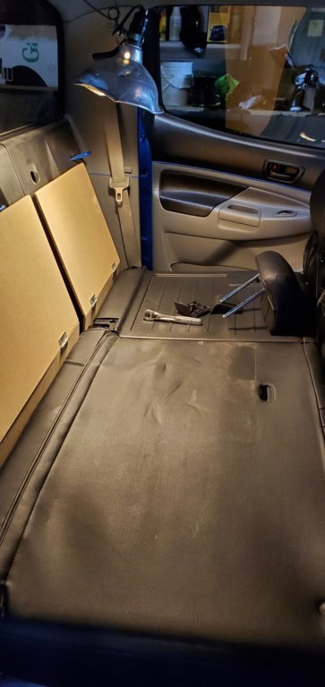

    So I did something I've been wanting to do for a while now. I covered my seats with Clazzio a few years ago and never liked the fact that the hard rear seat backs were covered. So I removed the hard seat back and moved it outside the seat cover. Required a couple slits in the clazzios but then I was able to just attach it over the seat cover. Also did not like that my tools and storage items behind the seats were exposed when the seats were down. Items would fall out of the storage area when braking. So I made some secondary hatches to keep closed when the seats were folded down. Still need to cover them with black bunk board carpet. Tried just using stick on velcro to keep them closed. Velcro was stronger than the sticky side so that didn't work. Switched to magnets.
    SimplehHatches made from 1/4" MDF board:
    Two bolts under plastic caps to remove seat back:
    Cover reinstalled after removing hard back. Slits cut to attach backing.
    This is what the back side of the seat back looks like and why I needed to cut the slits in the cover:
    Working on it in my living room:
    Reinstalling (just poked a hole in the seat cover where the bolt needed to go through):
    Driver side seat back done vs before pic of the passenger side:
    Storage hatch door open:
    Bunk carpet installed on hatch doors:
    Magnets from home depot did not work because the magnetic disc had to be glued to the hatch and the hot melt glue did not hold. Magnets stronger than glue. So I have ordered magnetic discs with a hole in the middle so they can be screwed to the hatch door. Then I should be done.
