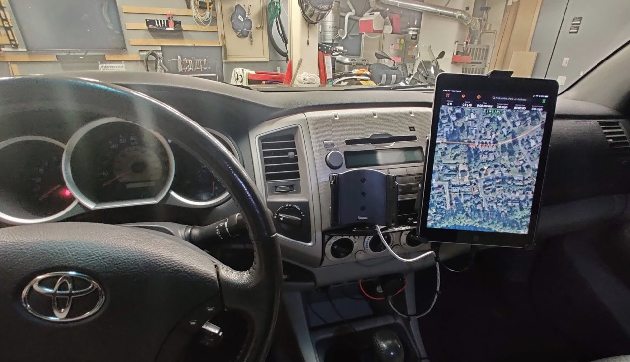

    Added the Tech Deck Xtreme Duty and mounted up the screens.
    Playing with the Gaia map setup.

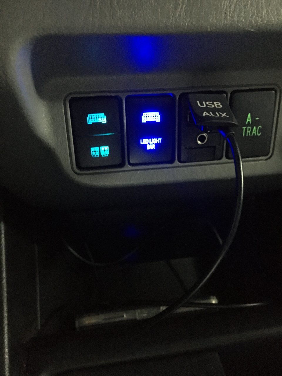

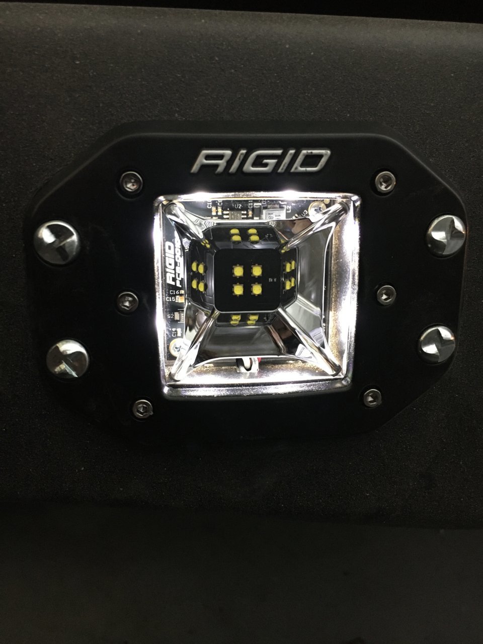

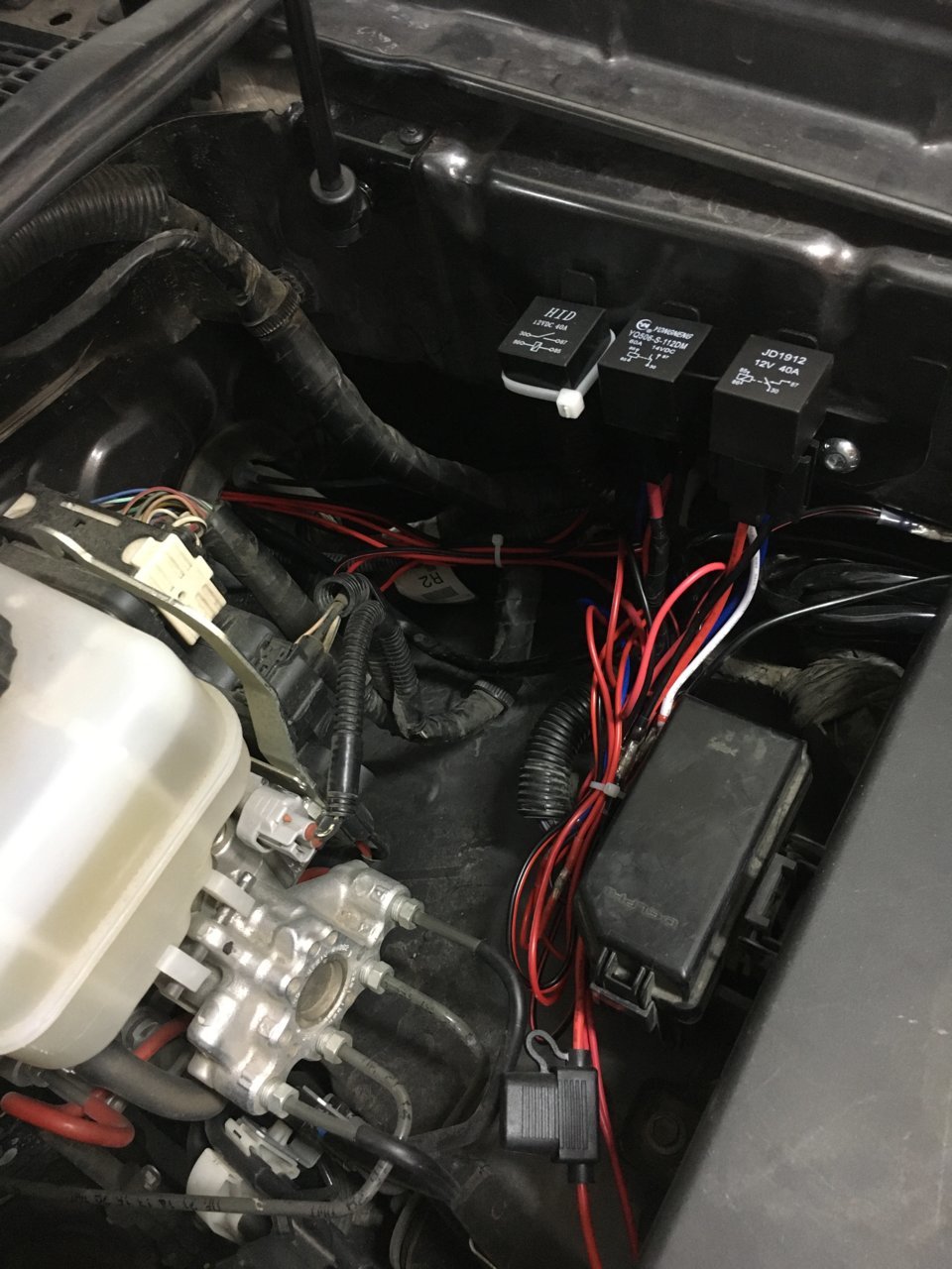

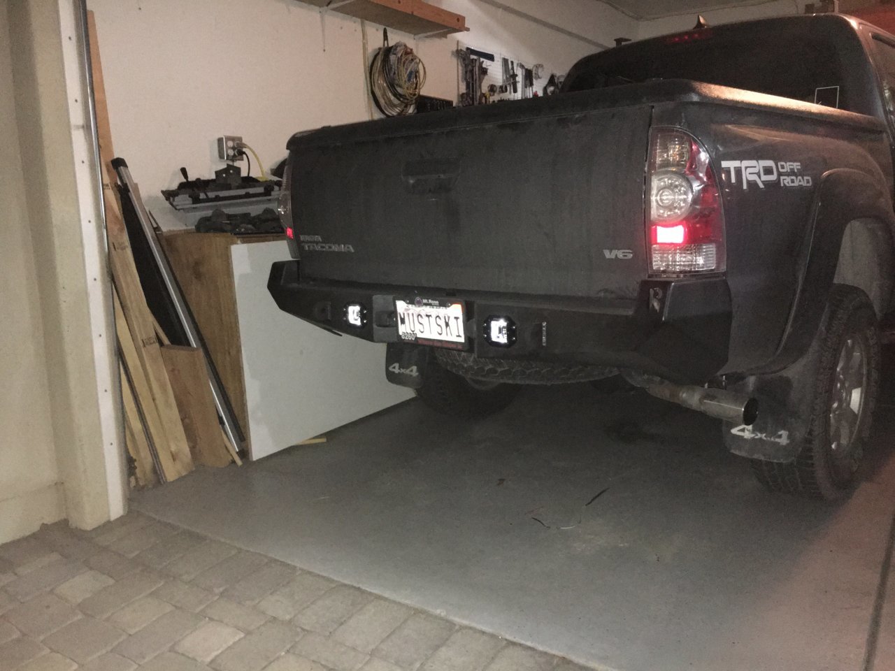

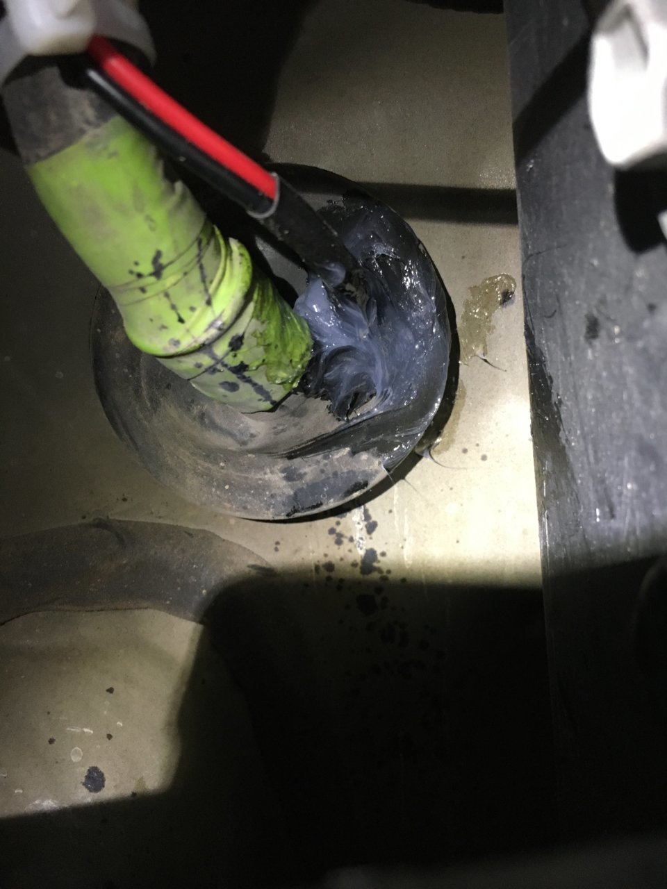

    Finally finished installing my rigid Radiant scene lights in the rear bumper. The wiring in the engine bay leaves something to be desired. Has anyone had water issues with the relays right there? I decided to route the light power wires with the main harness through the firewall and out the floor grommet. Sealed it with RTV inside and outside so hopefully that doesn’t leak. I think I’m just about done with the truck except for tires. Just waiting for these to wear a little more.
    C52F1091-4C1F-41DB-8499-8F1A5102AA45.jpg 77A53319-15C5-45F3-837F-4CA219FF6CB2.jpg 986A008F-6E11-4AD7-8856-CD605C0D7D55.jpg A1B64A0B-B7F6-4699-B72F-26E0D04A7567.jpg DFA7FEF8-33E7-4BF8-906C-AEED837A8D3B.jpg

    I actually had an issue where it would power up - connect to everything - steering wheel controls, android auto apps, etc --> but it wouldn't produce sound. After going back and forth with Crutchfield, I decided to send it back. I've reinstalled the stock HU and simply decided to run an iPad as the primary screen for GPS, etc.
    See my latest post on the Tech Deck.

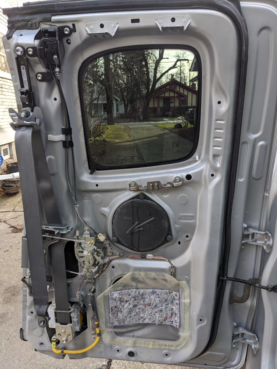

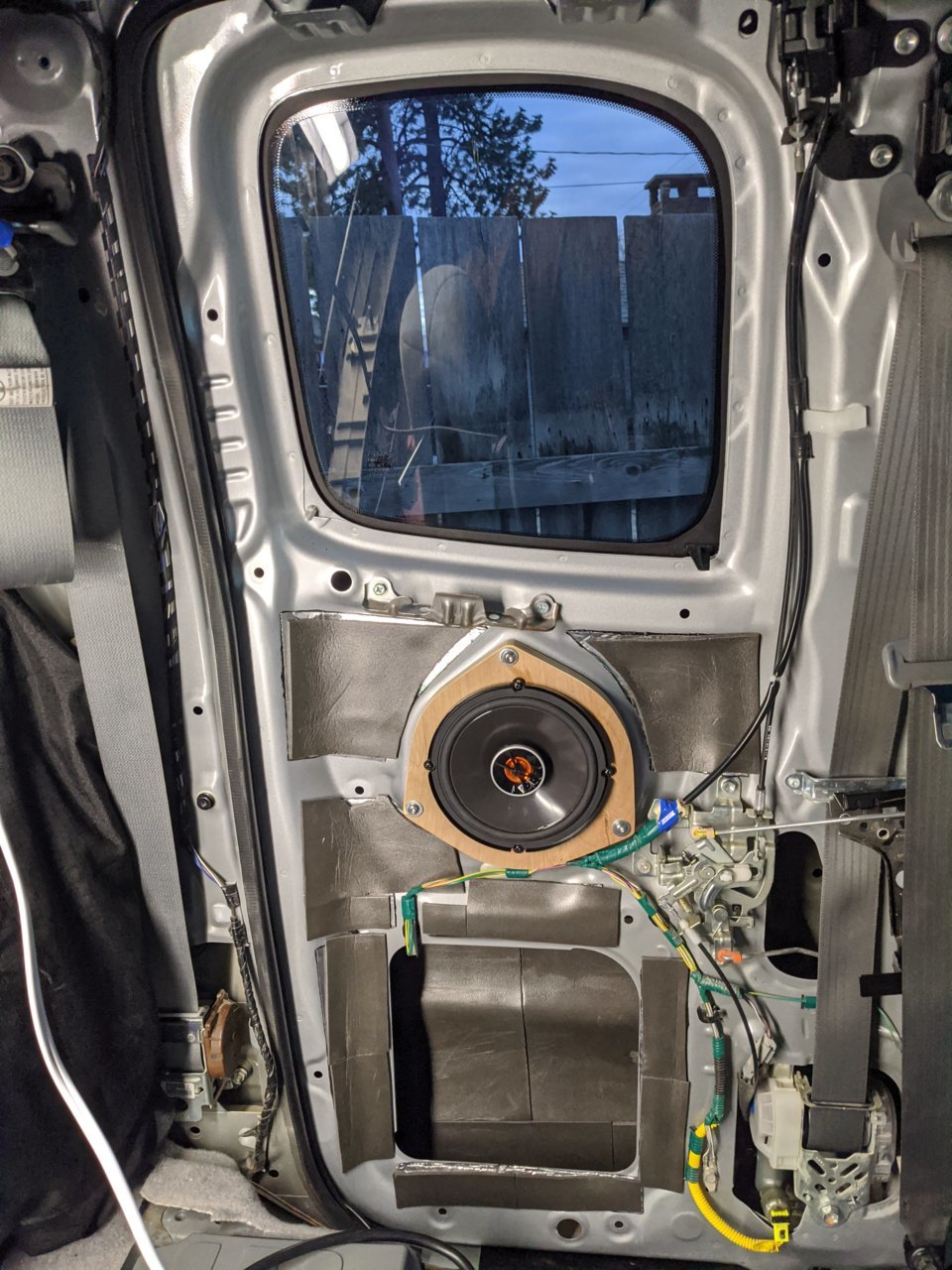

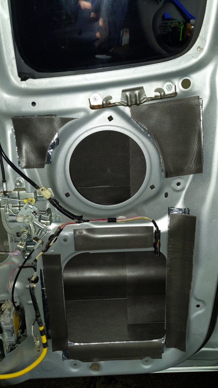

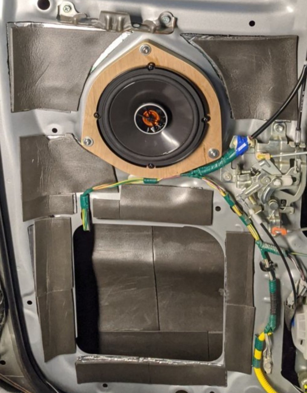

    Yes I used dynomat on that Ranger. The Ranger has a larger area to work with there.
    You did a sweet job installing those speakers.

    That wiring looks a lot better than mine!
