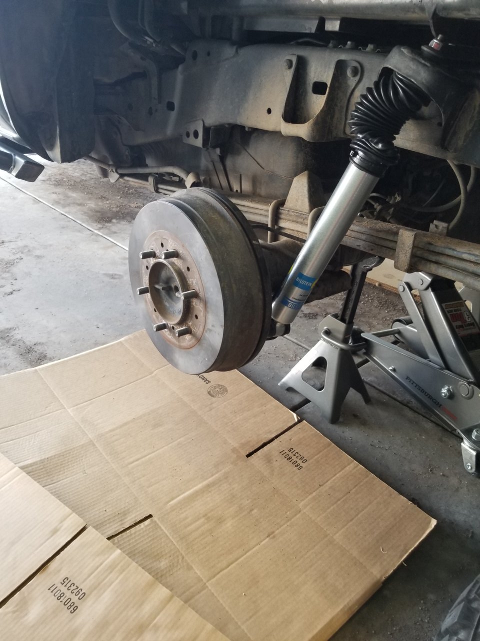

    You should prob trim those u bolts while you have the tires off!

    I need to install my shims first. The instructions say I have to drill a hole if I have OME springs but it doesn't say how big of a hole and where.

    It's like the axle drops too much as I had to add a spacer for the brake line bracket and unclip the wheel speed sensor harness from the bracket where the charcoal canister is.
    The shock boots constantly get pulled off.

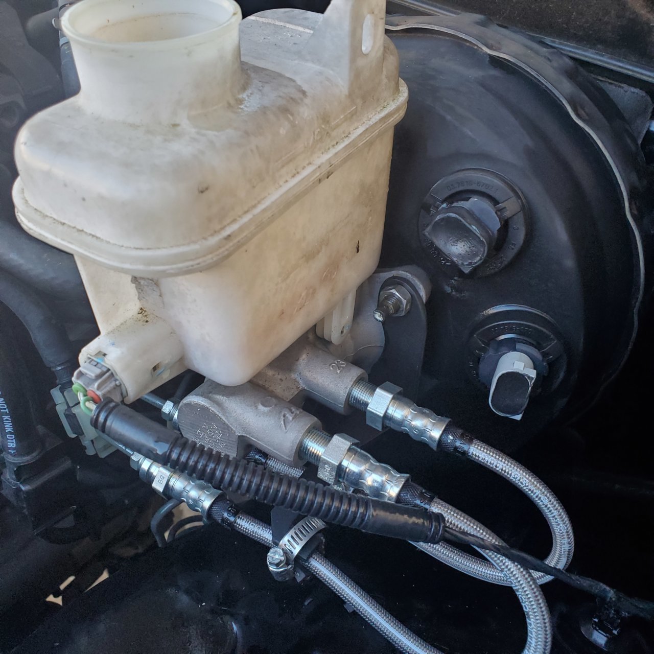

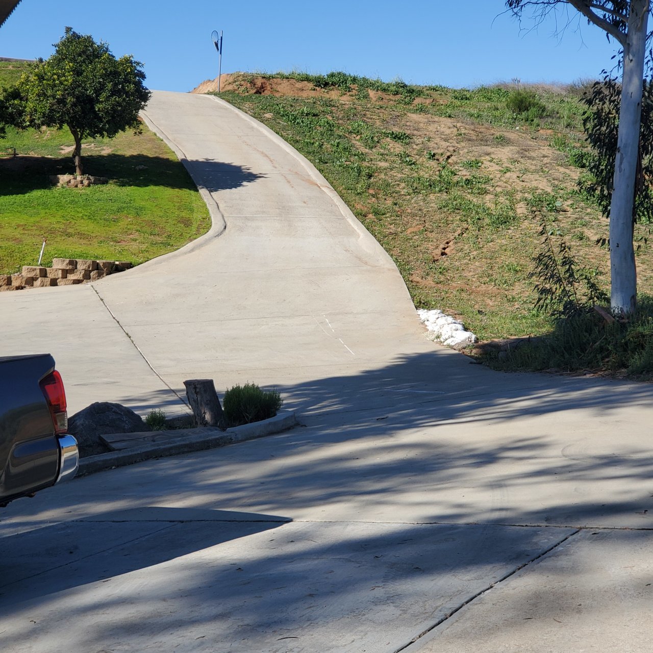

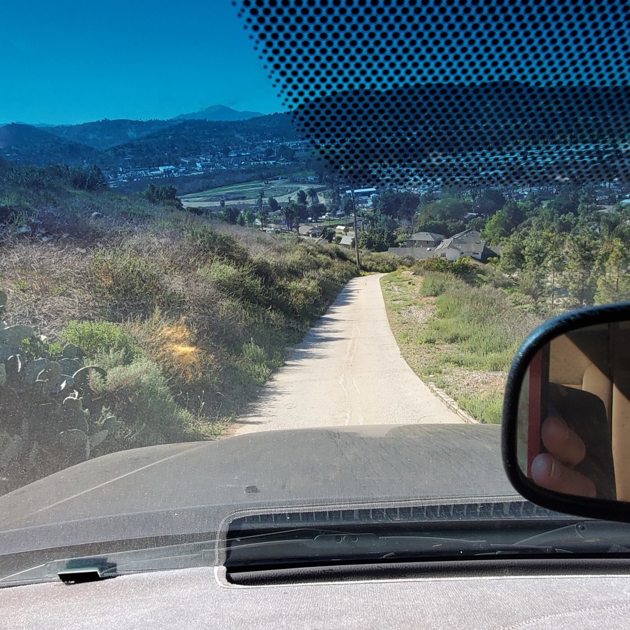

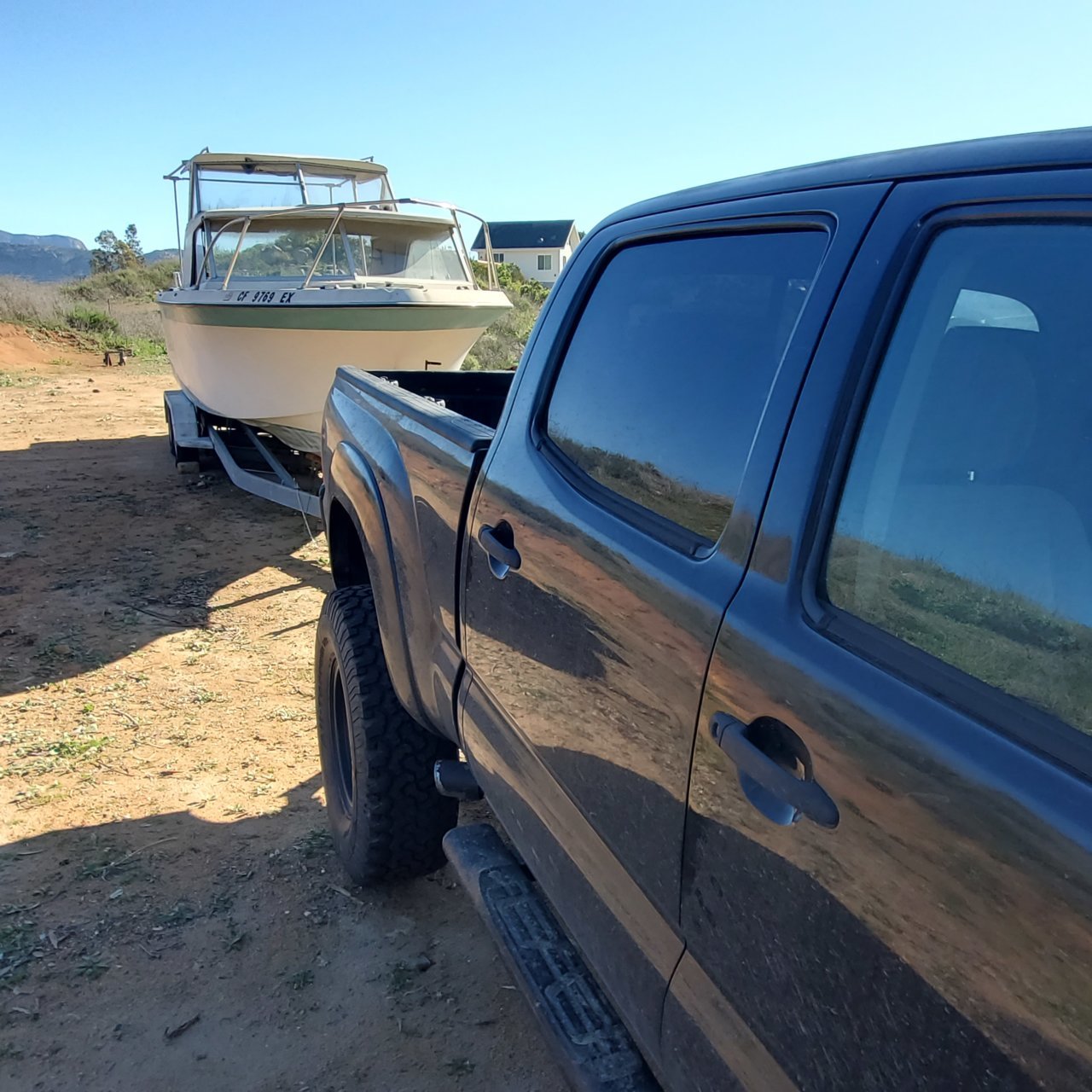

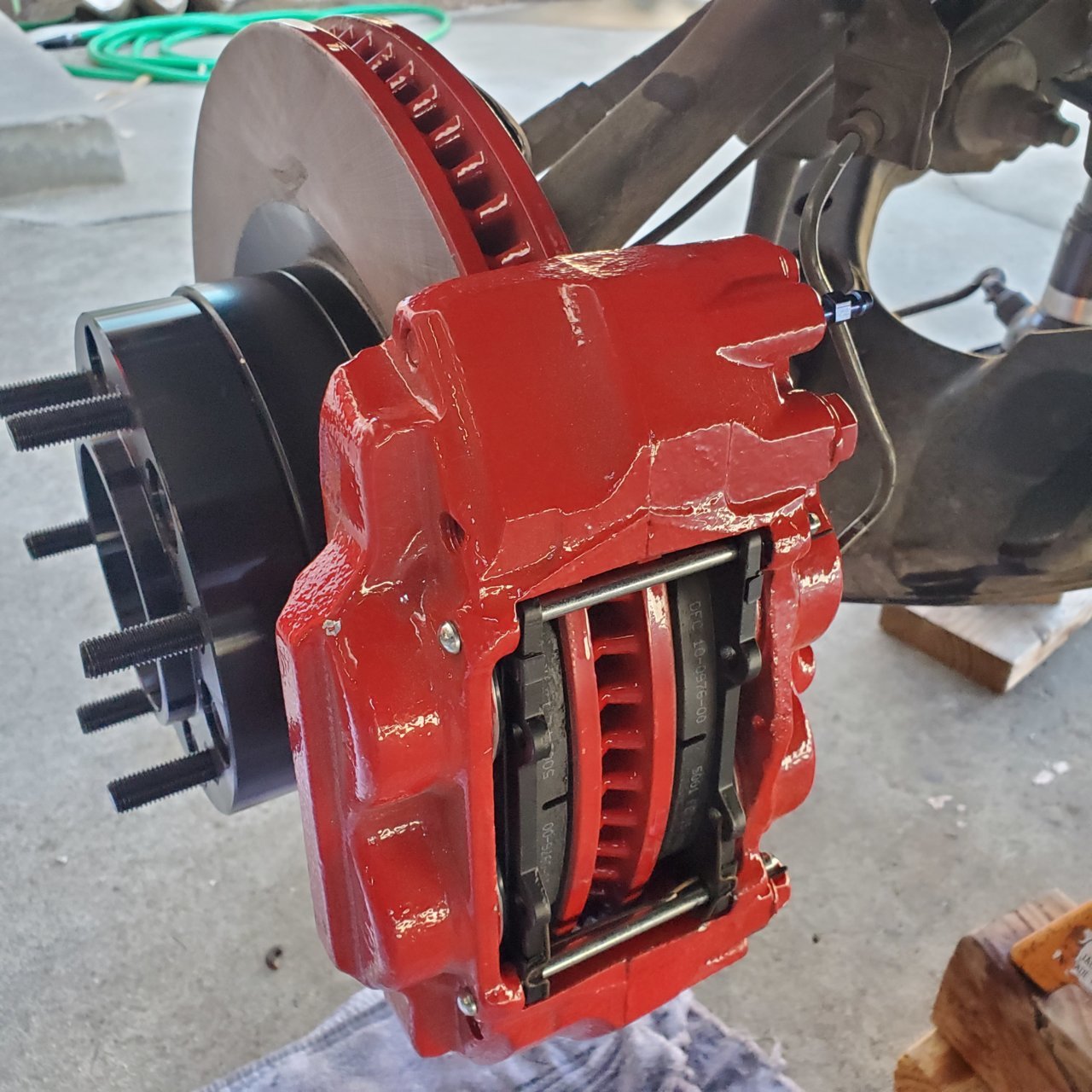

    Today I towed a heavy assed 26' long boat...
    Up a short 15*+ concrete incline from a dead stop half way up with stock gears and 37's (both back tires left marks :) )
    and proceeded down a 20*+ incline
    These new brakes are nothing short of f______g incredible! I'm so f_____g happy about the end result!!

    The OME centering pin (M10) runs a little larger then normal (3/8”) pins, looks like you have the 095R leafs so you may have enough length on the OME pin then you need to drill out the shim to fit the OME pin. if your shims came with new pins you can just use those and no need to drill the shim.

    I put in a wheelers shim and didn’t need to drill. Just trim the center bolt flush with the nut then trim the u bolts not a bad job at all.
