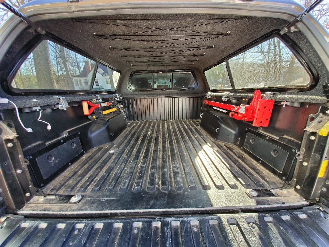

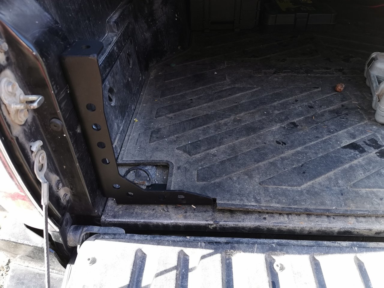

    Pulled out the bed bolts and slathered them in antisieze. Luckily they were all still in rather good shape. Installed Relentless Fab quickfist and hilift mounts. Was going to make them myself, but for $100 I couldn't turn them down. Also got my Tepui rtt "assembled" so I can get it installed tomorrow.

    How much room do you have under that hi lift jack? Do the mounts rest on the little lip above the wheel cover? If any of that makes sense

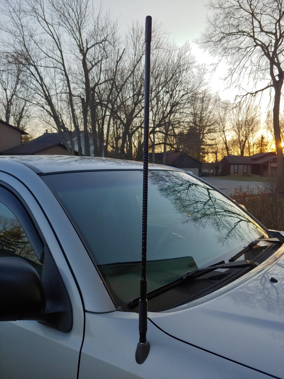

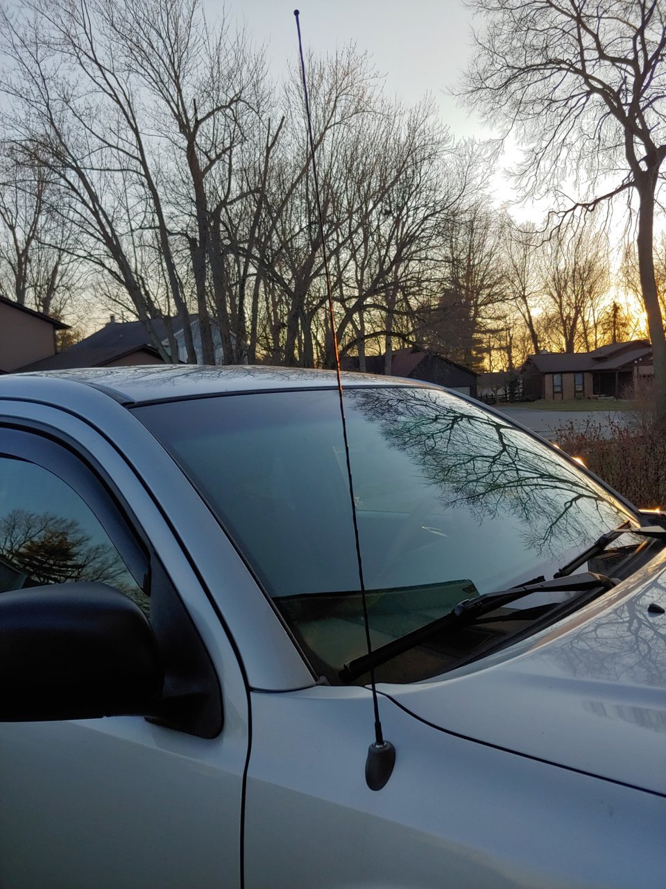

    Swapped antennas from the OEM whip to a modified CB antenna I got from a member here. First thing I did was take the tip off the firestik and extend it to the fullest possible length. It's just about the exact length it needs to be to be 1/4 wavelength for the middle of the FM band.
    from
    to

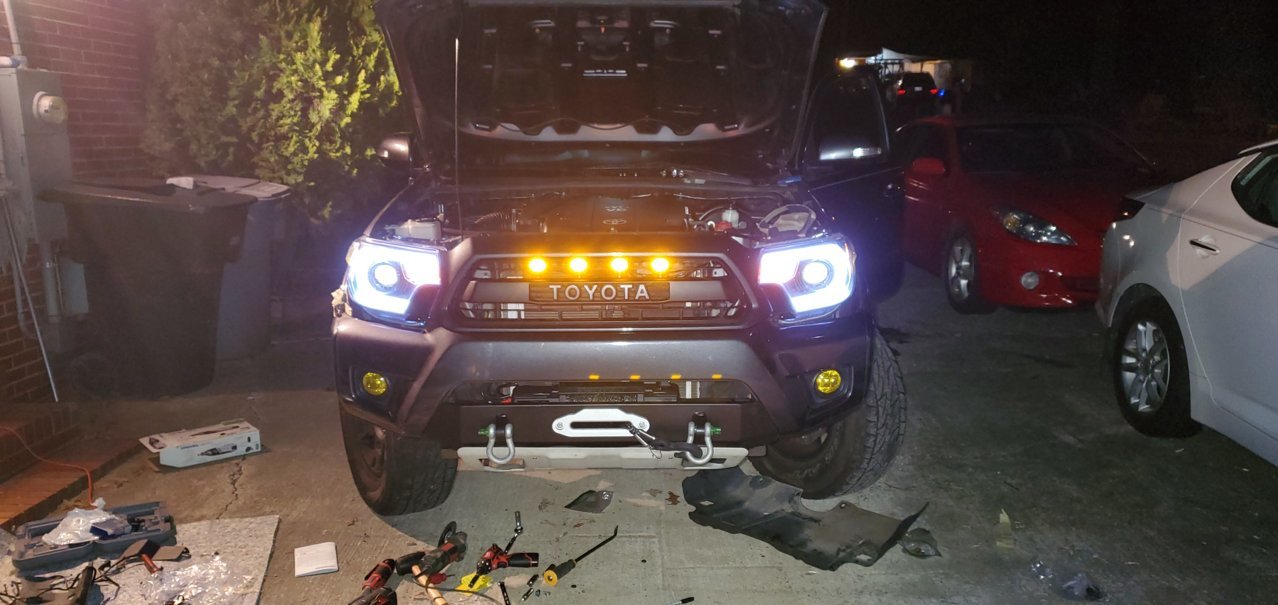

    installed witch mount from @usoffroad with smittybilt x20 winch

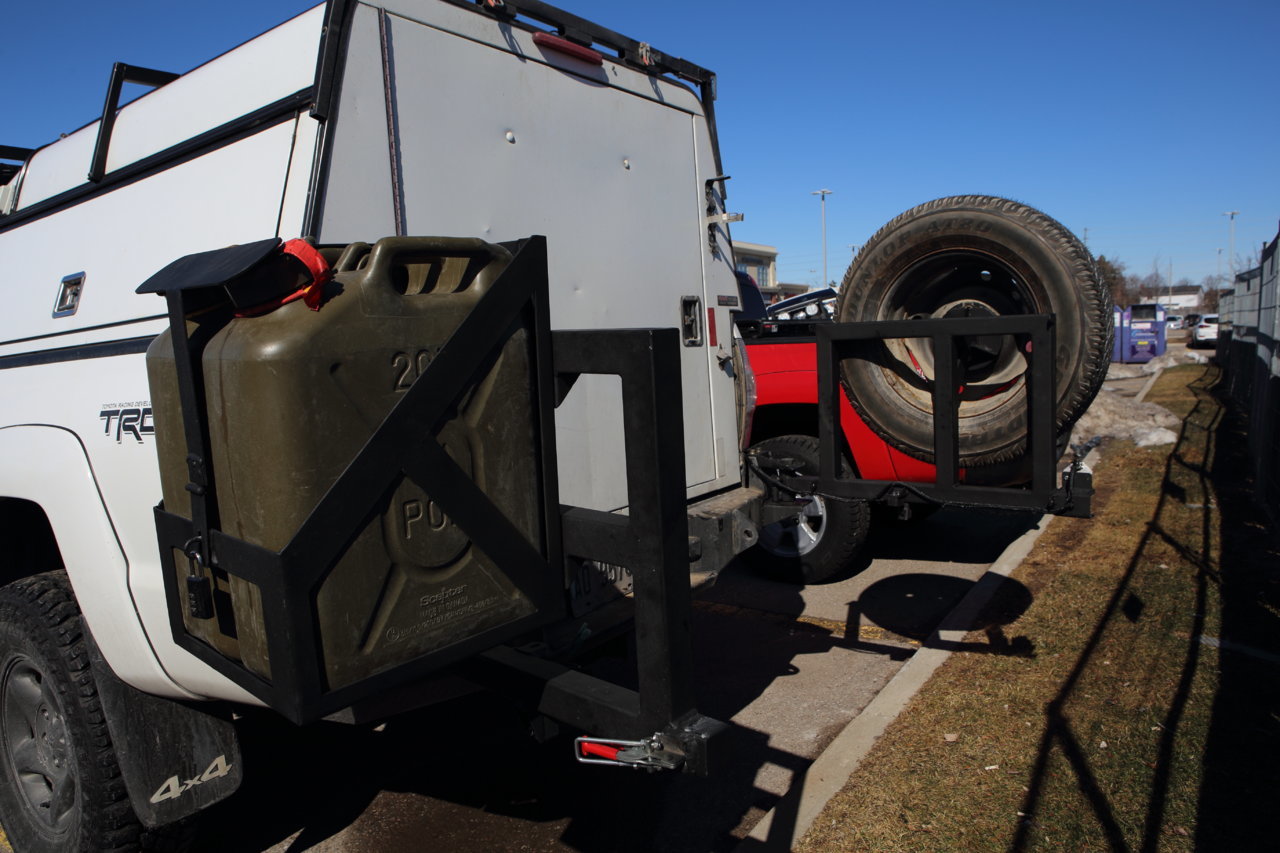

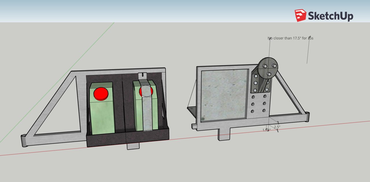

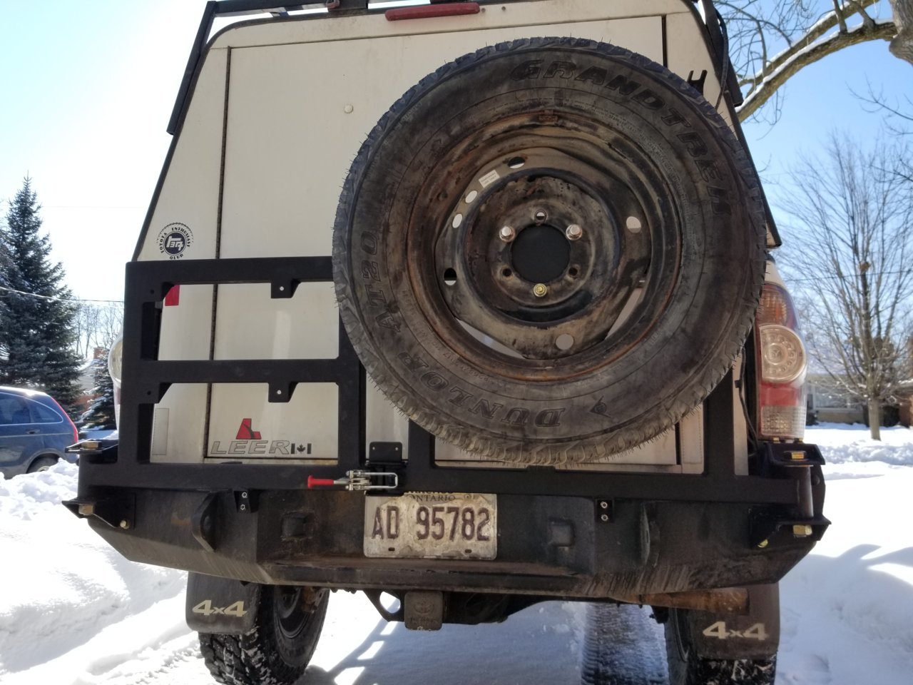

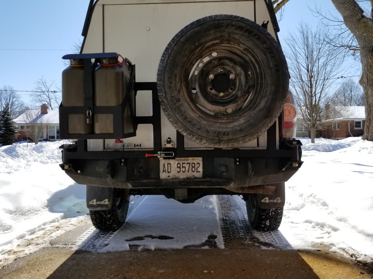

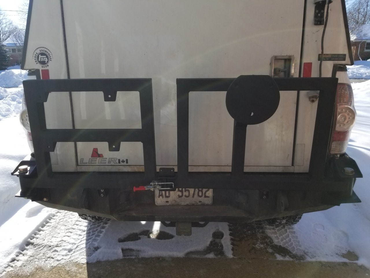

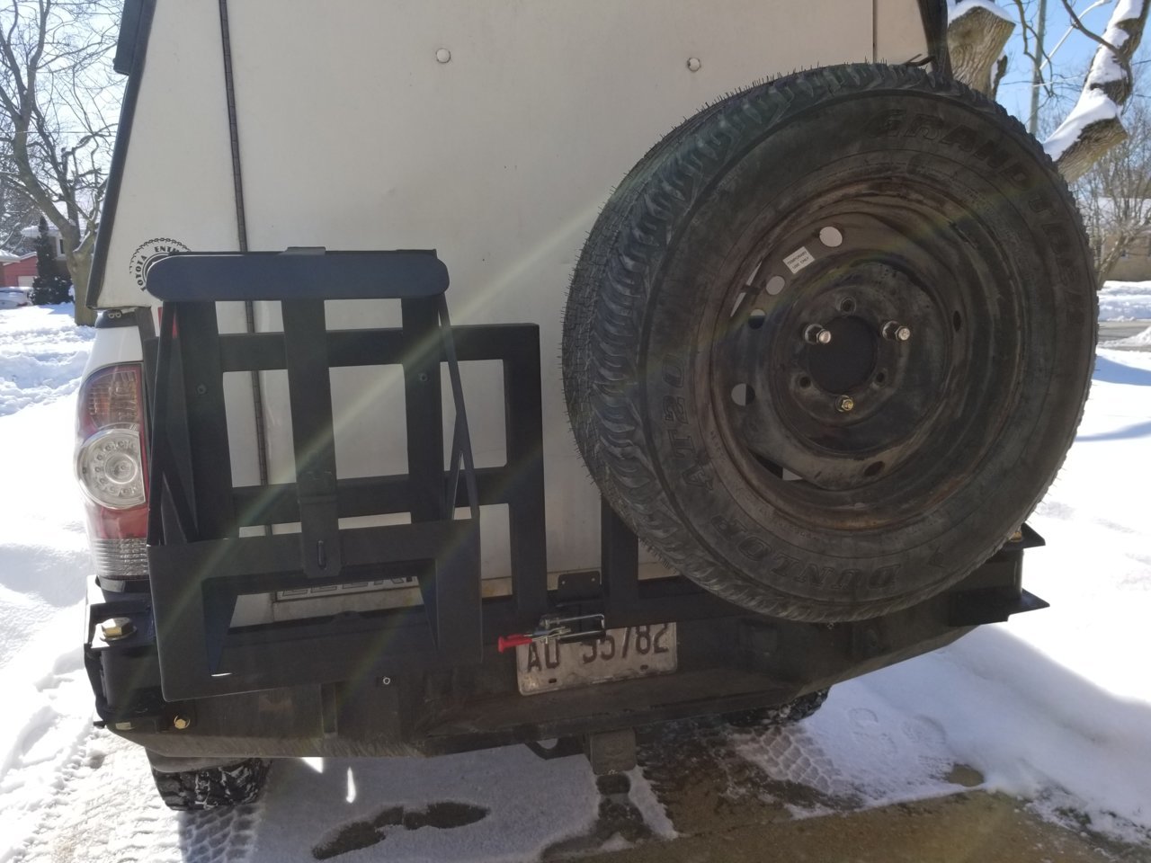

    I finished a four month long project.
    Dual Tire Carrier .jpg 20200307_092258.jpg 20200307_094044.jpg 20200307_095206.jpg 20200307_111000.jpgIMG_0291.jpg IMG_0301.jpg IMG_0298.jpg IMG_0308.jpg Copy of IMG_0277.jpg

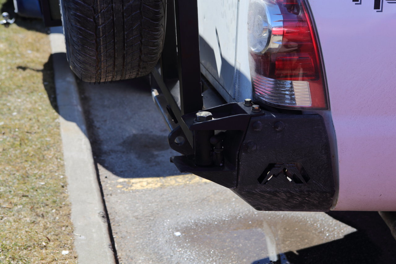

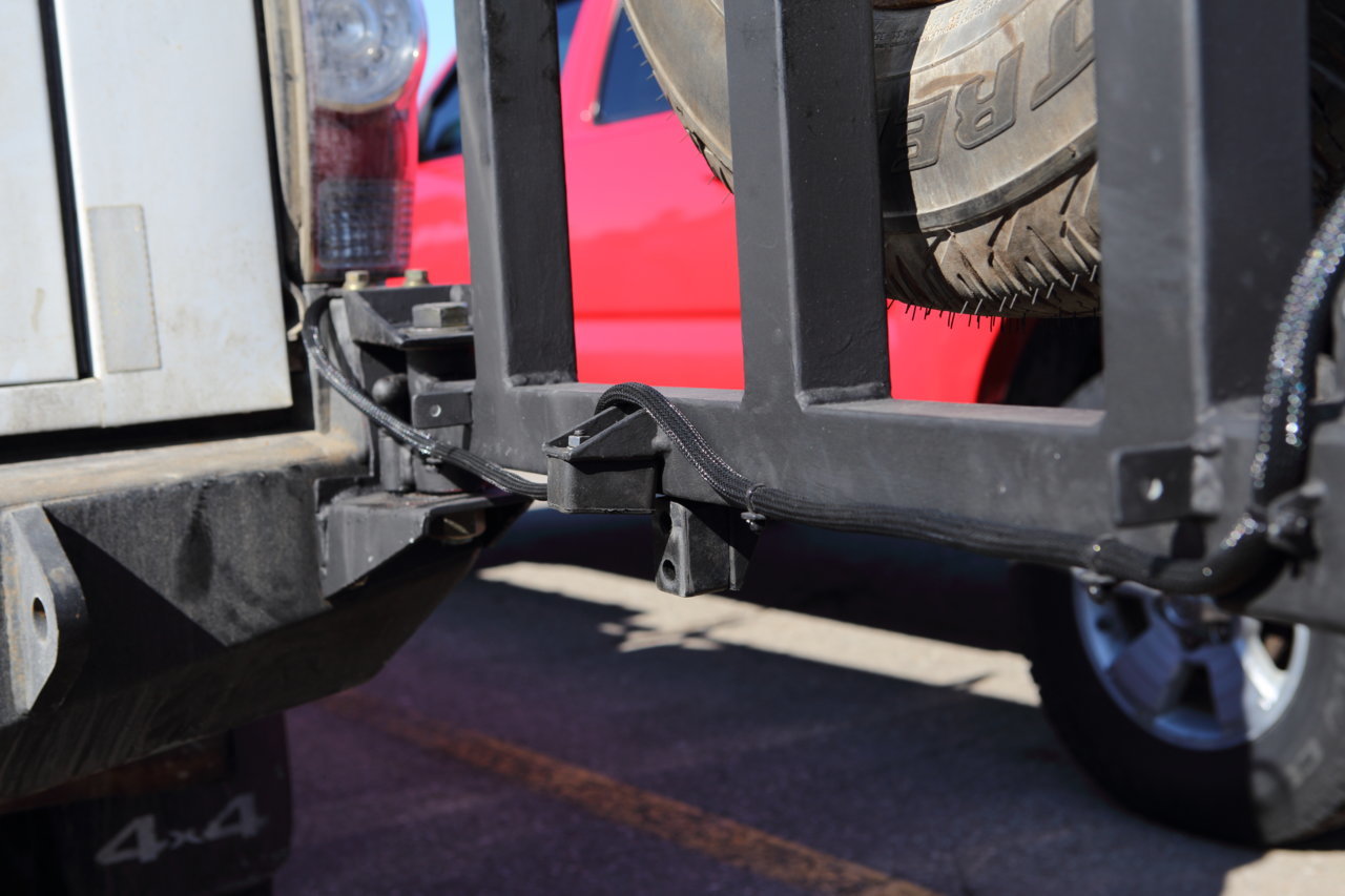

    Did you attach the spindles yourself via drilling or did your bumper come pre built for a swing out ?

    20191127_183830.jpg 20191127_191923.jpg 20200105_120853.jpg 20200113_185811.jpg 20200115_194029.jpg 20200115_194201.jpg 20200115_194340.jpg
    does that answer it? lol

    Yep. Weld those side plates to the bumper lol. We tried your method and it flexed way too bad.
