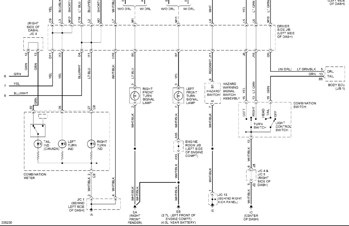

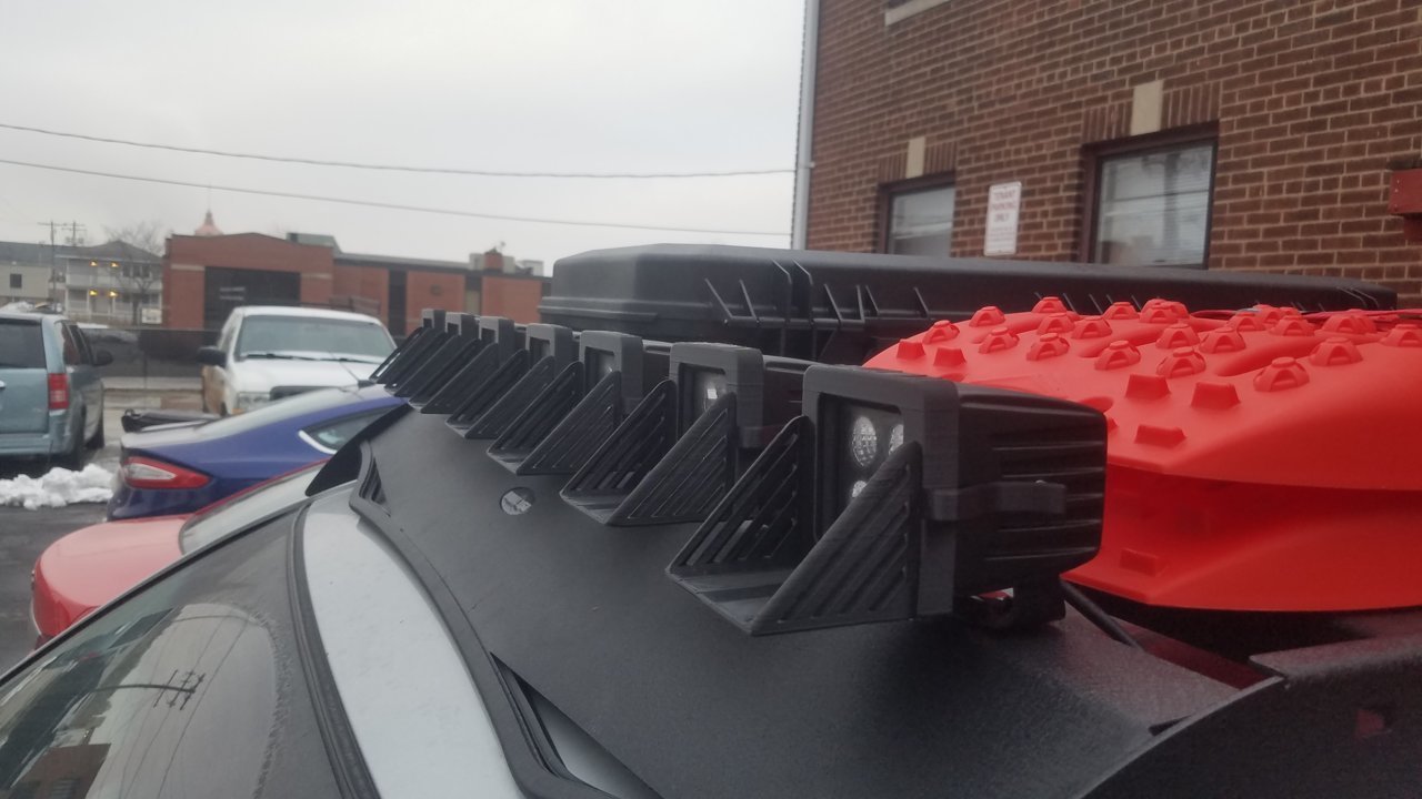

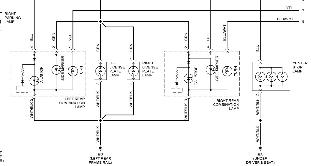

    Been reading up... one wire from the blinker needs to be grounded and the other tapped into the rear turn signals. Just gotta find a clear enough guide so I don’t mess it up. I’ll be sure to document what I do/find out to make it available in stupid people terms for people like me who want to do it as well.

    Just to help get you started. Wire Diagram for my 09 PreRunner DC 4.0L
    Screenshot 2020-03-11 at 11.33.00 PM.jpg Screenshot 2020-03-11 at 11.35.06 PM.jpg
    Good Luck!

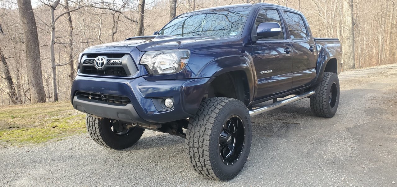

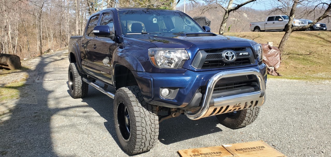

    Removed the bull bar. Next is replacing the chrome step bars with black N-Fab step bars or maybe the knock-off eBay ones. Anybody recommend the eBay ones?

    I have ones from EBay. I’ve had them on the truck for over a year and have been happy with them.

    Why not just tap it to the front turn signals?

    From what I've read, it can cause issues if you have the Daytime Running Lights since it would also have the blinkers perma-on while DRL are on.
