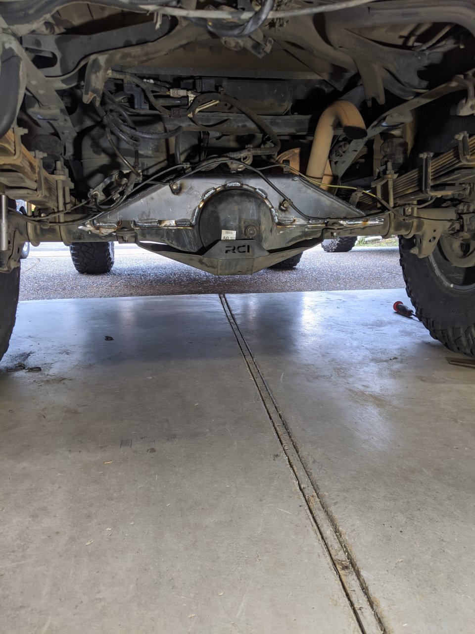

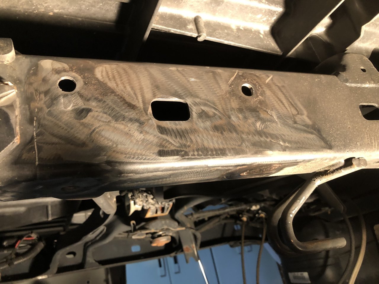

    Added a rear truss

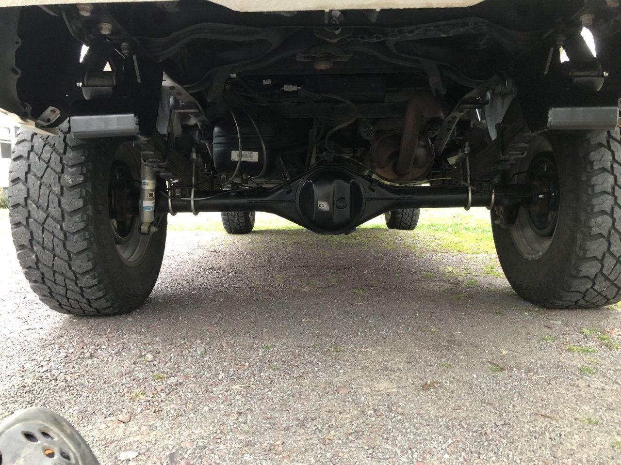

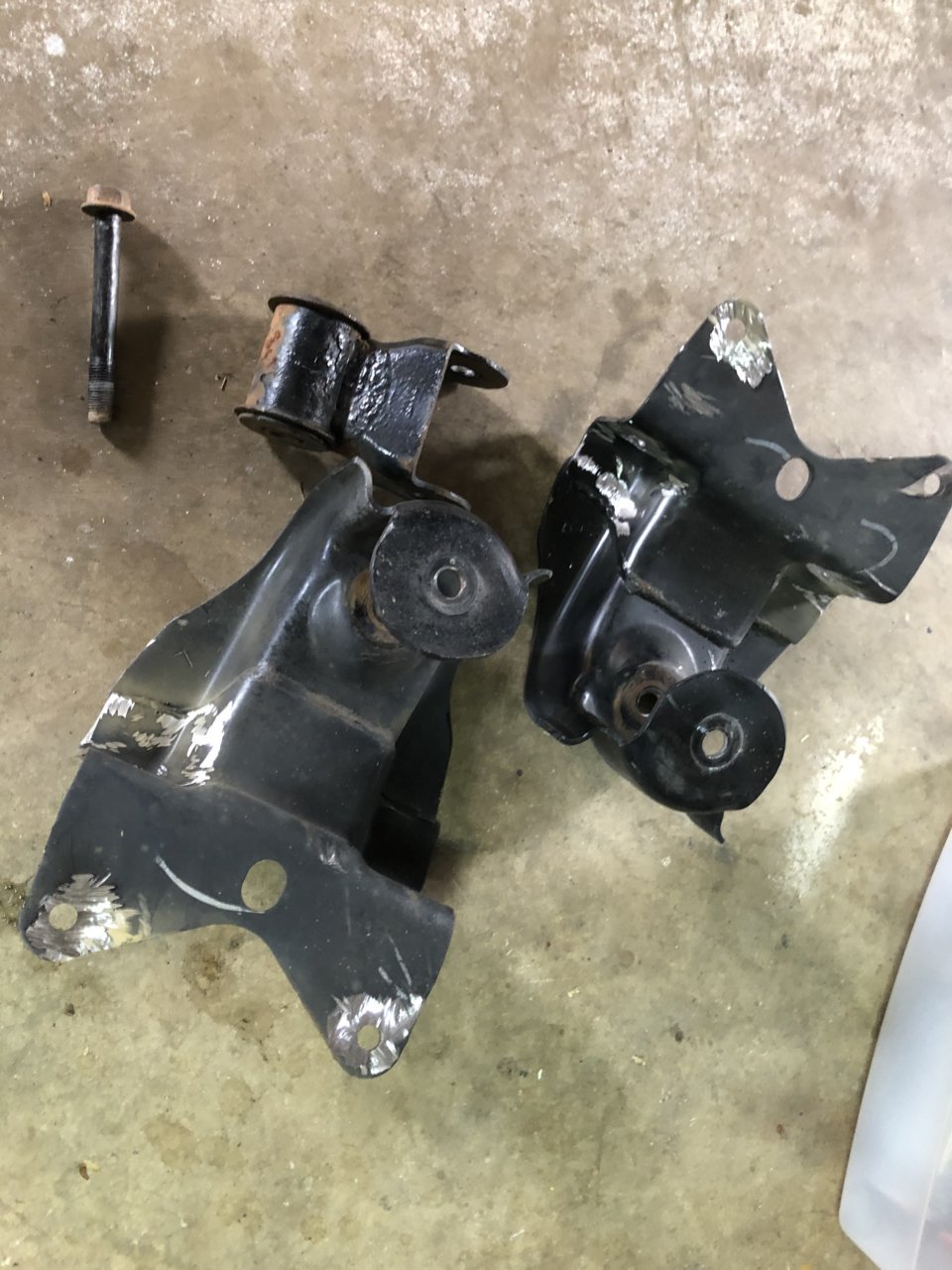

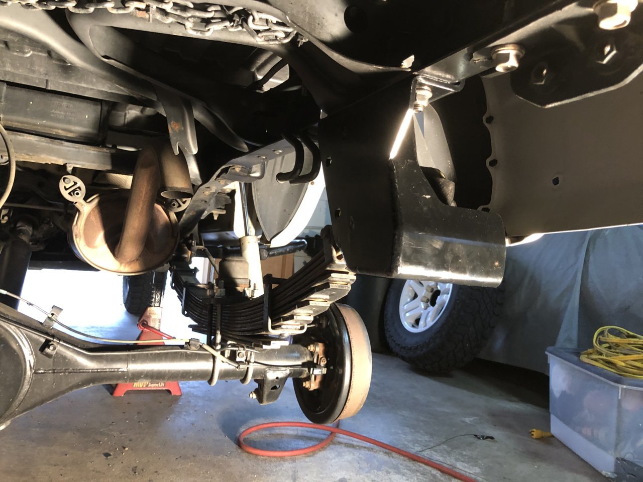

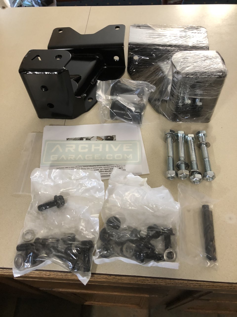

    Finally installed the Hammer Hangers

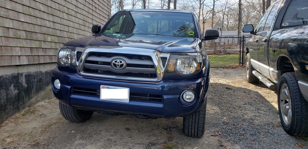

    New Headlights! And I finally got the stuck front diff fill bolt off!

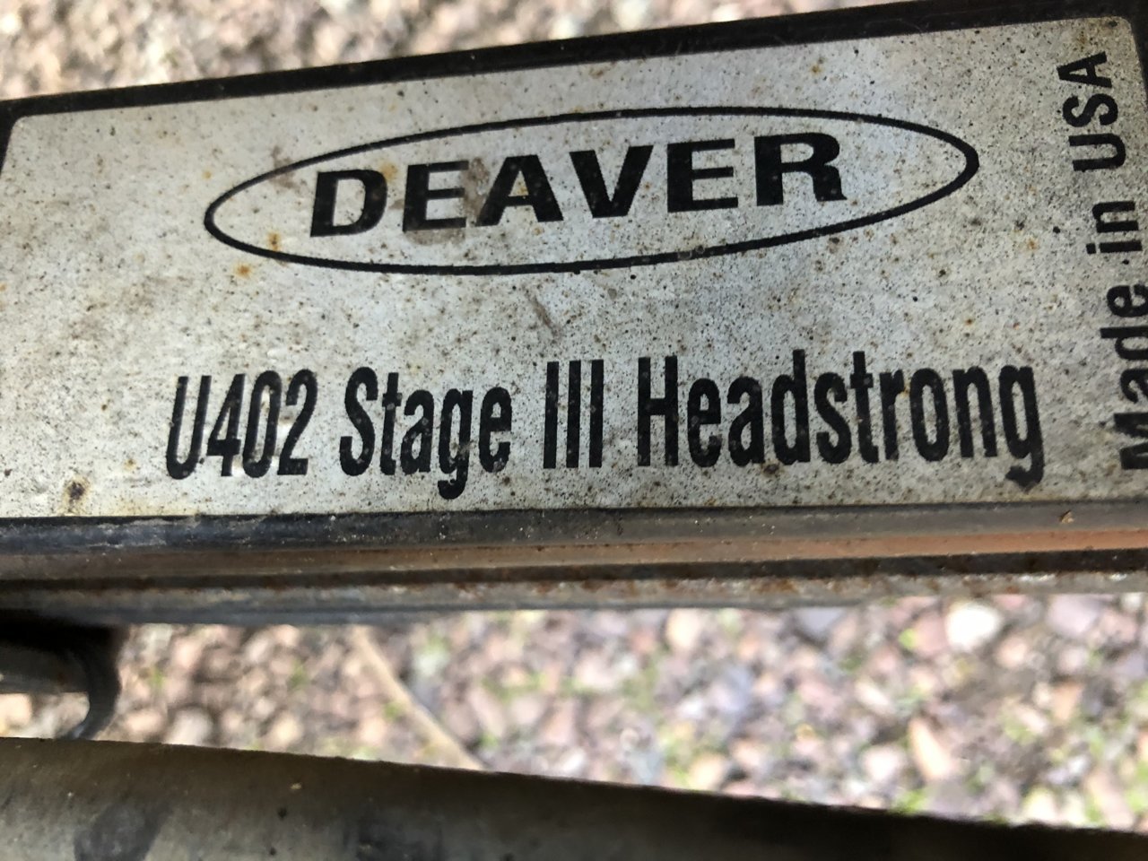

    Good Lord, what leafpack is that?

    How long did it take?

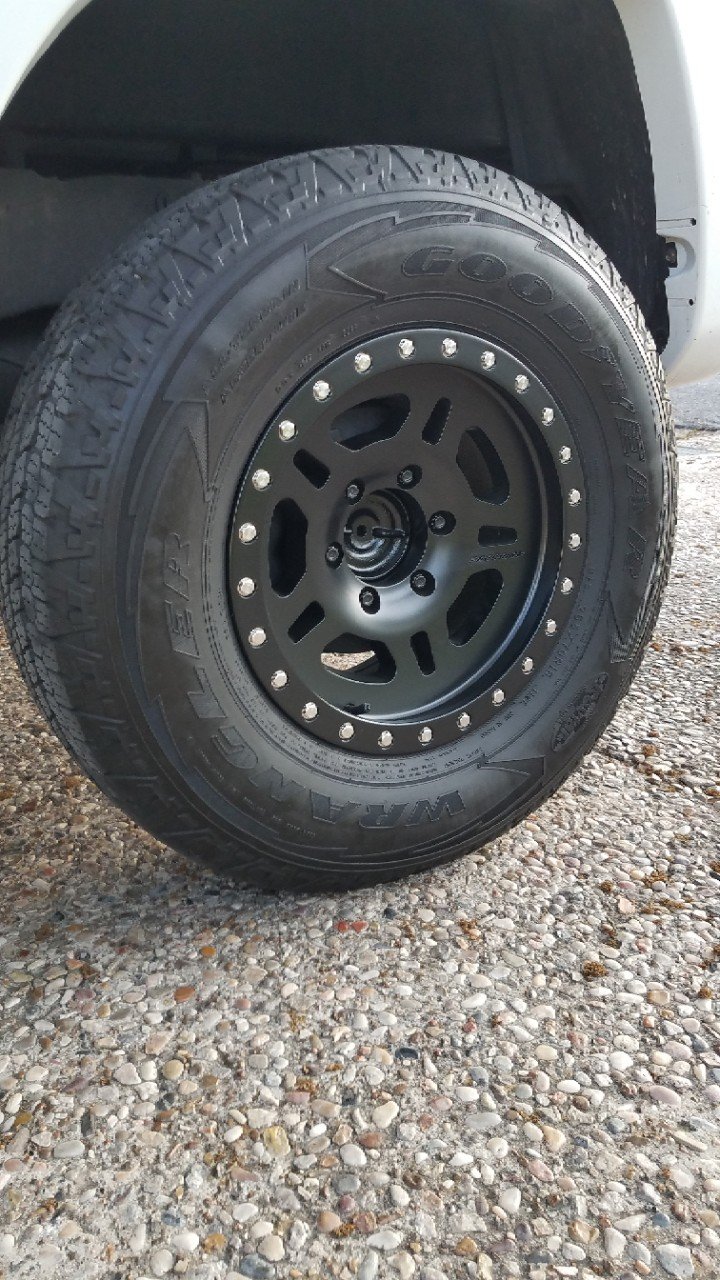

    I did the same with my pro comp center caps. Those look good !

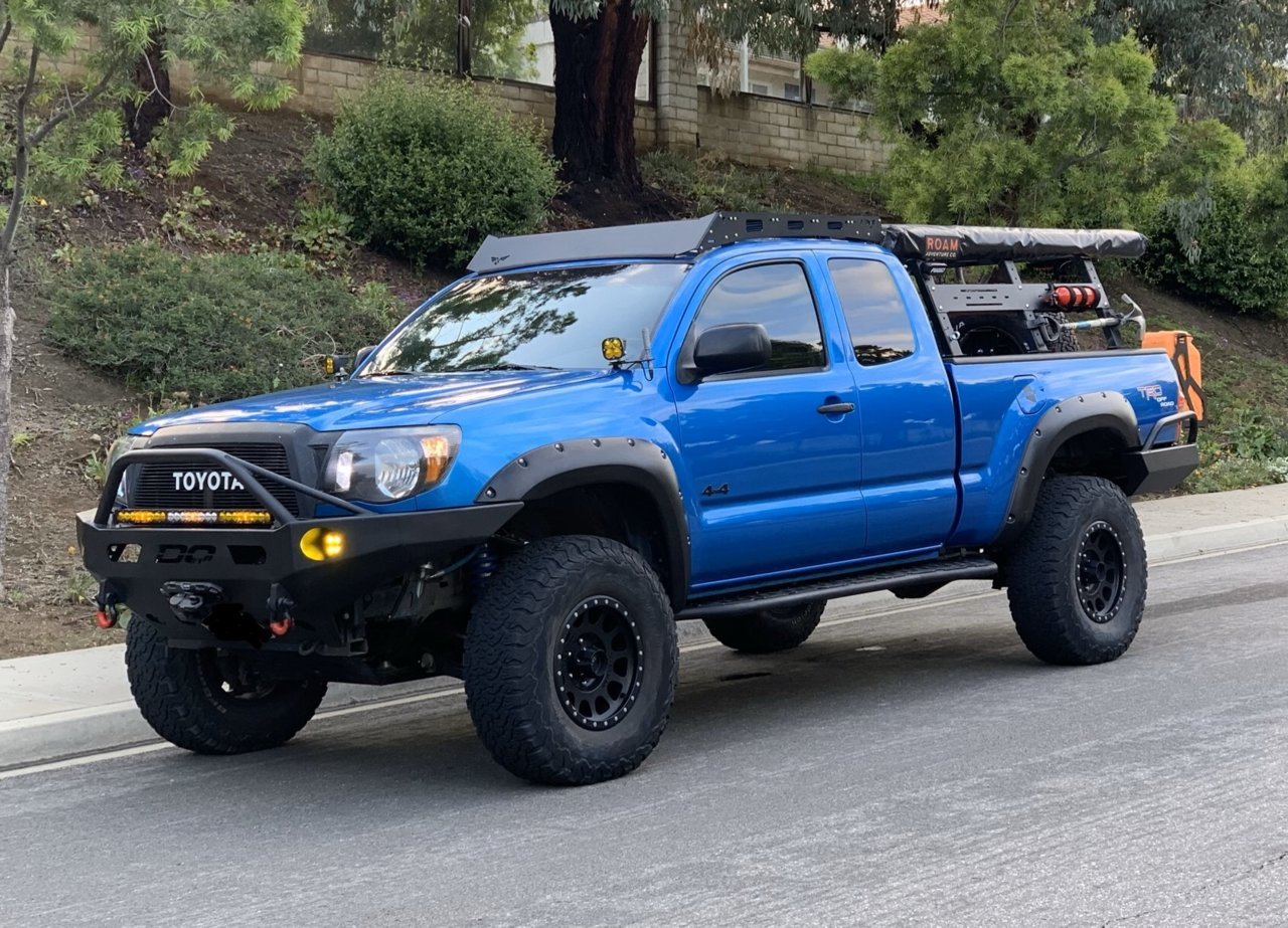

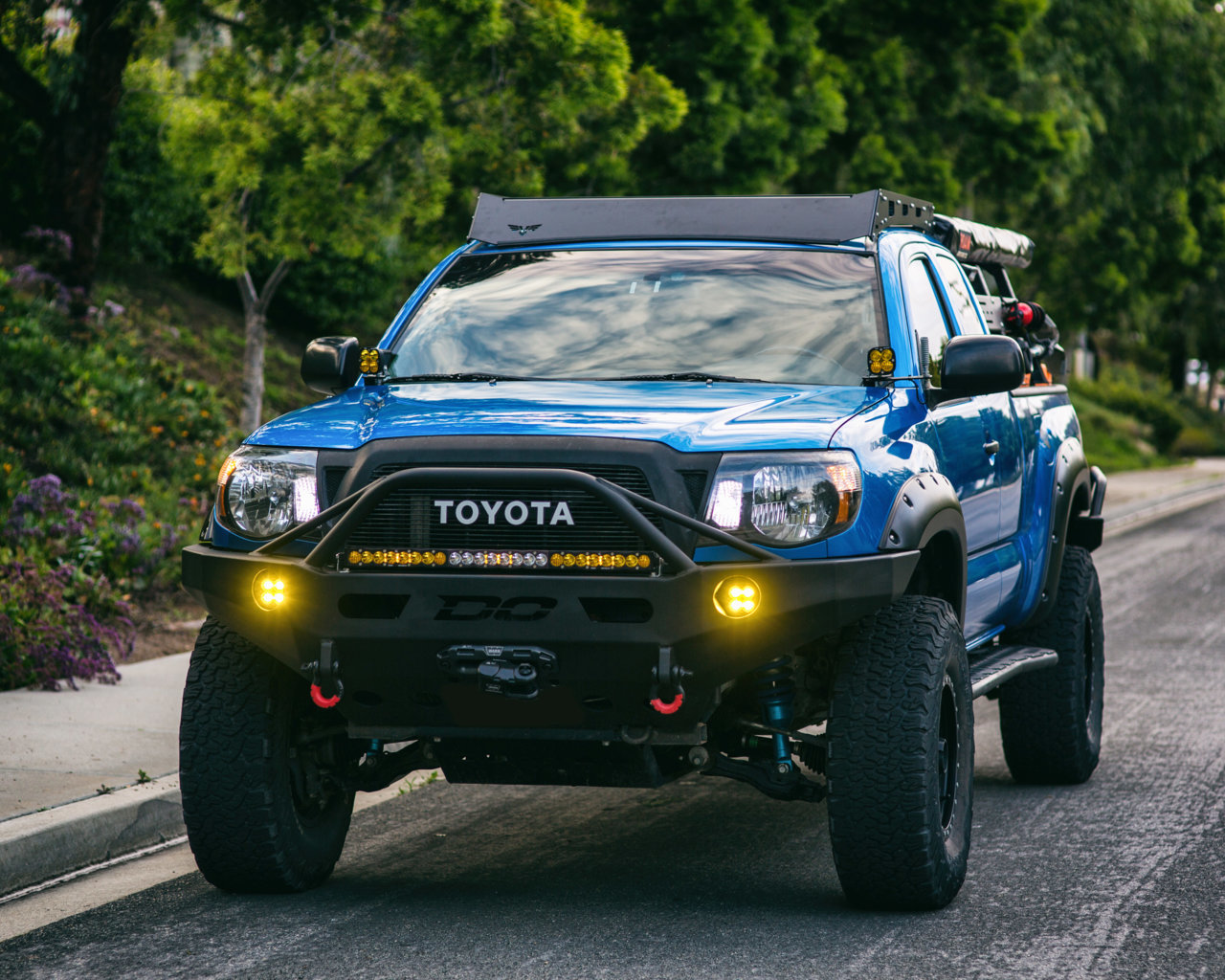

    installed the Victory 4x4 access cab rack. Other than having to drill into the roof and using a ton of RTV silicon, it was a pretty easy and smooth install.

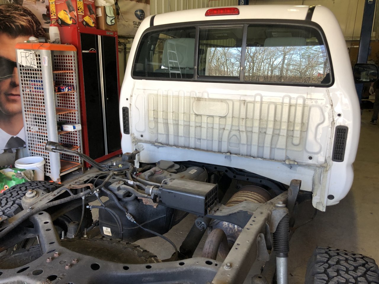

    whats wrong with the tailgate?

    It has a small ding and light scratches, but I'm selling it as I don't need two tailgates.
    The bed I bought came with a tail gate and chrome bumper (V6 SR5 option truck).

    Deaver stage 3 packs rated for 1100lbs they have both overloads for a total of 11 leafs. Thinner leafs so they ride really well while handleing a load wonderfully

    It tok about 3-4 hours to do the install remove the OEM hangers, drill out the rivets, and install the hangers. It tok at least that long figuring out how to remove the OEM bushings from the spring shackles. From whhat I understand the shackles can be ordered without the bushings relatively cheaply but I didn't know that in time.
