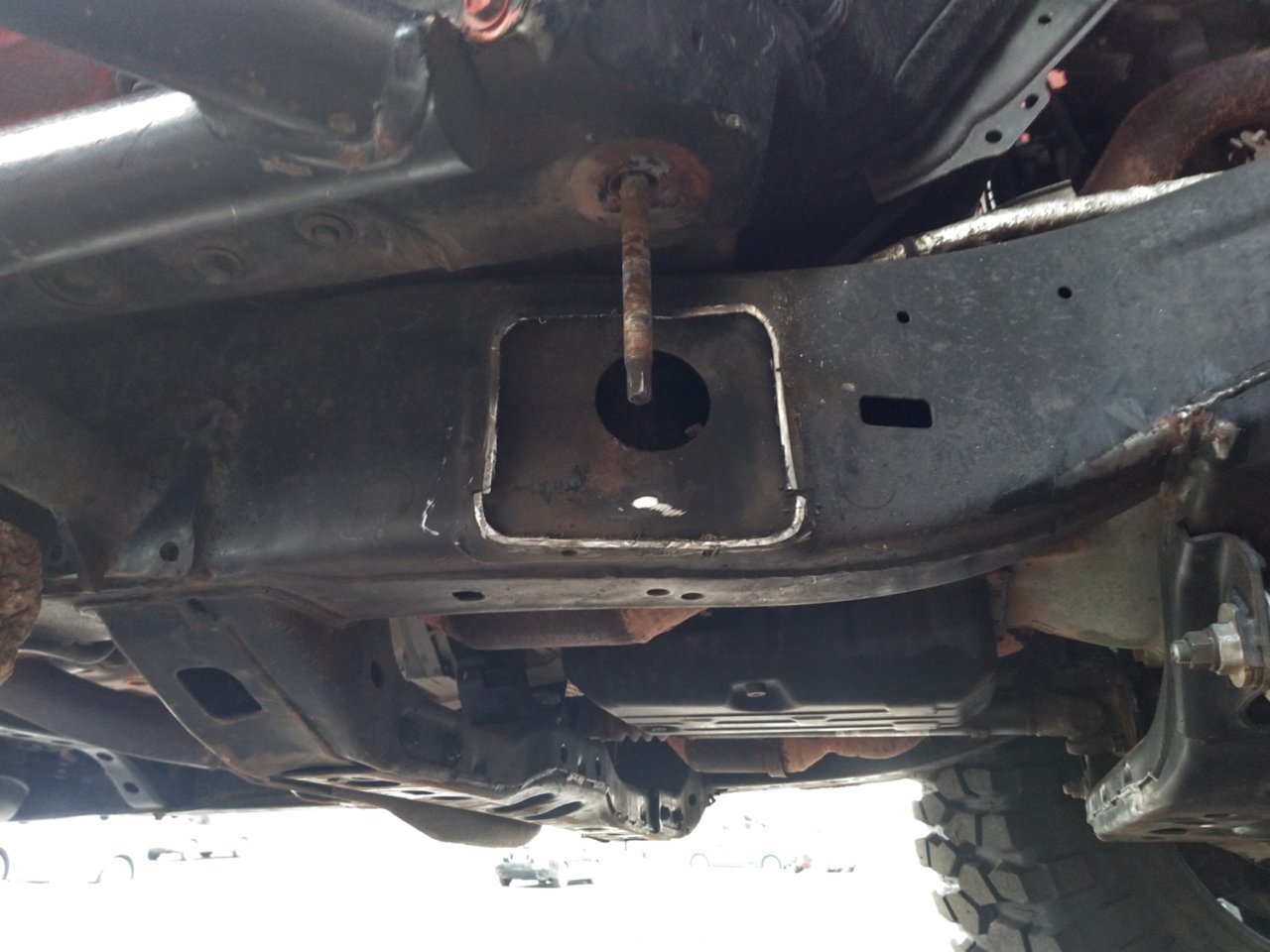

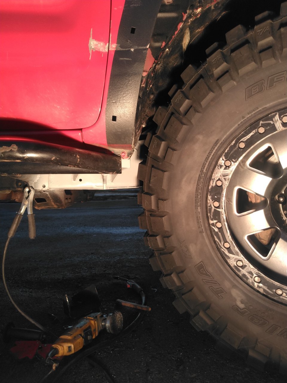

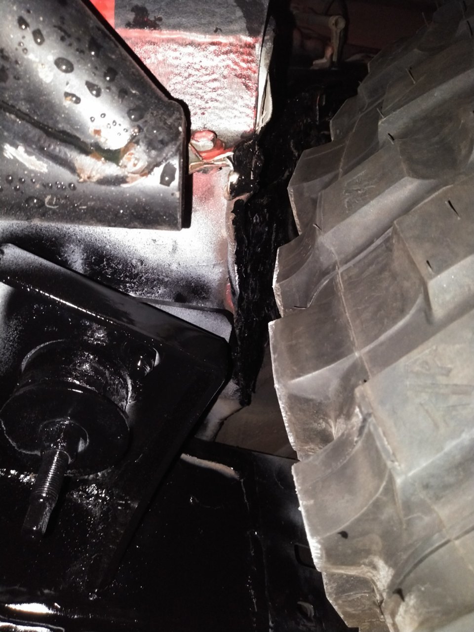

    Passenger side cab mount relocate is done. Driver side maybe tomorrow or next weekend. I went with the red goat fab relocate, I just like the design more. Cutting the old mount off wasn't bad but grinding everything smooth took a while. I was able to beat my firewall back probably another inch with my 12lb sledge. Might need to tub a little this summer but we will see next time i go wheeling.

    Nice work and yeah grinding all that down seems lke it takes forever

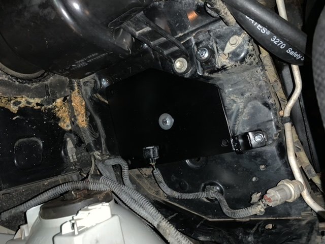

    Painted and installed the compressor mount I had fabricated by a buddy of mine. Now I just need to bolt in the compressor and wire it up. The bracket is beefy because the compressor is too. He did a good job reusing the mount points for the power steering reservoir I relocated.

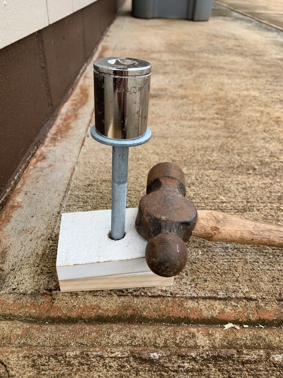

    Rather than beating on them, just sand those keeper rings down. They are only there to keep the washer in place on the assembly line at the factory. That's what I did anyway and then installed the d-ring between the washer and the bolt head. And like @kalaukoa said, plenty of-anti seize when you reinstall.

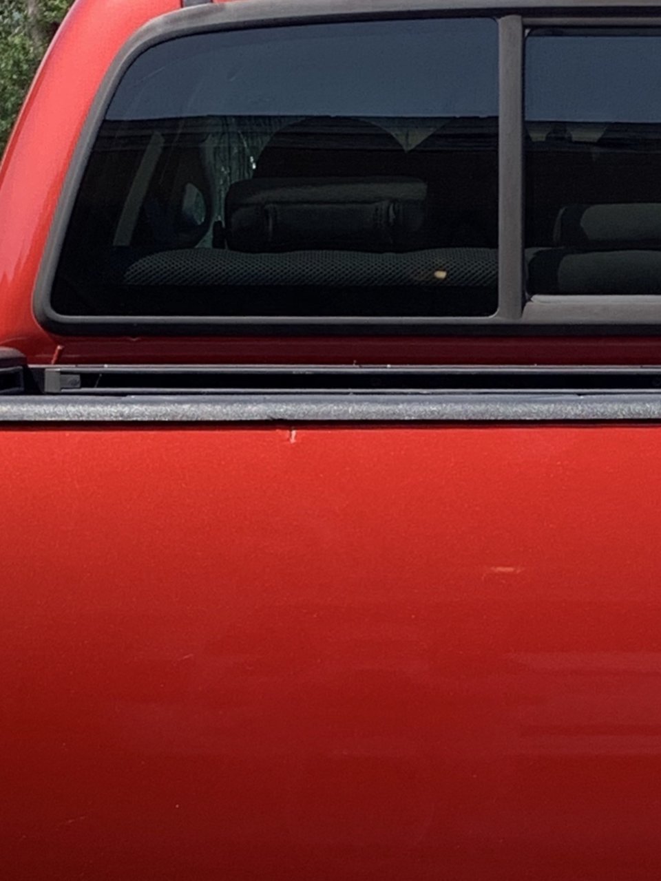

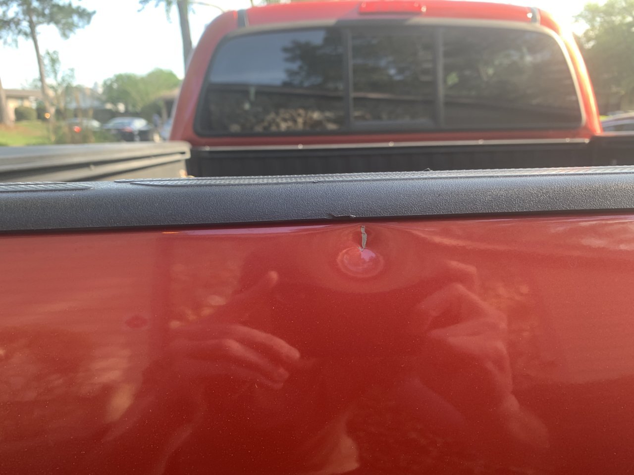

    pulled a boneheaded move moving my girlfriends couch.:annoyed:
    Googled PDR to check out some reviews, found a fella who quoted me a fair price. Met up with him.
    After the job was finished, 6 or 7 minutes later, “Free of charge, have a nice day.”
    Good people are doing good things every day!
