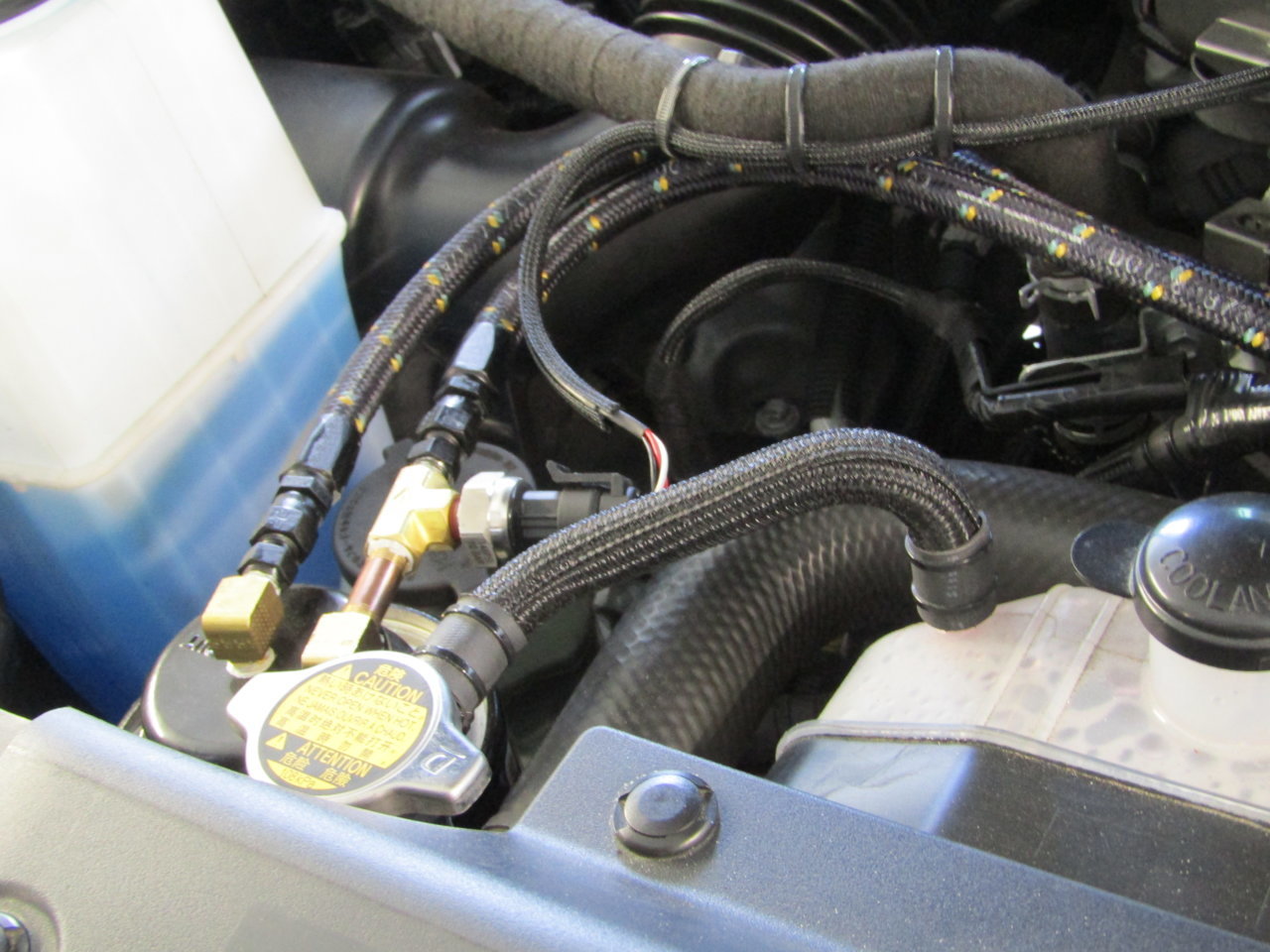

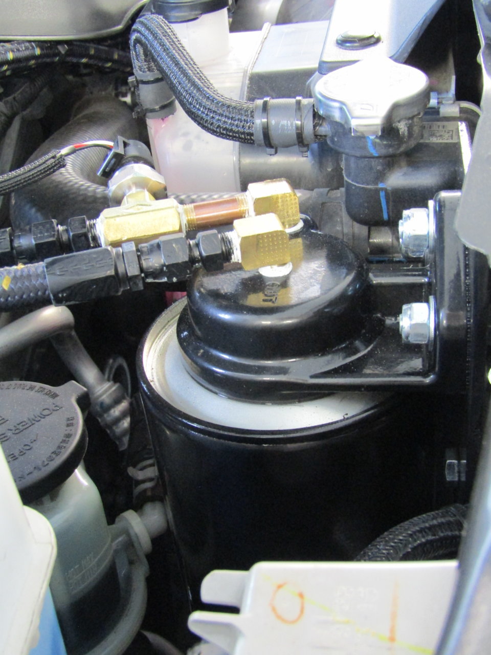

    brass fitting in aluminum cap?
    ok ok sorry...its the return from the by pass oil filter system......OEM oil filter ...filters to 20 micron +/- (micron" is an abbreviated term for "micrometer", or a millionth of a meter (1/1,000,000 meters). This is about . 00004 inches. For Size comparison, a human red blood cell is about 5 microns across.) This filter is 98% efficient at 2 microns. The system supply comes from a tee fitting under the LOP switch, filters 7-8%of total flow, and returns the clean oil thru the fitting in the fill cap.

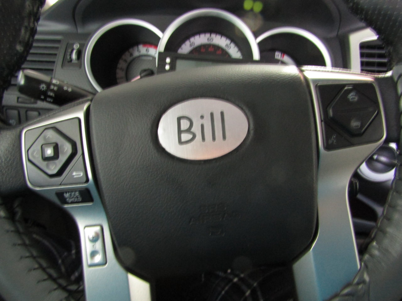

    thats very nice....
    when you get really old ya gotta do something like this so you know who ya are.. :rofl:

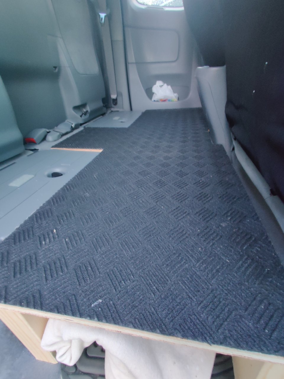

    May steal some ideas from this for my fridge mount. Like the grip top too
