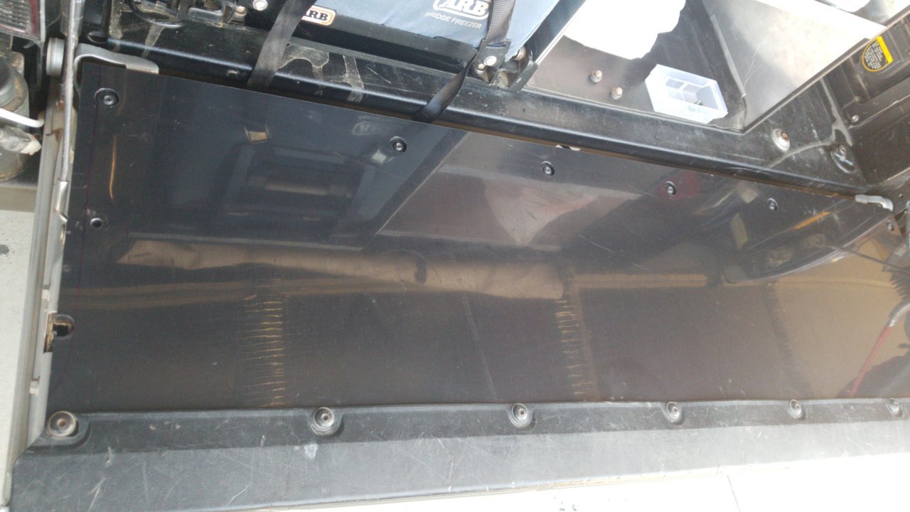

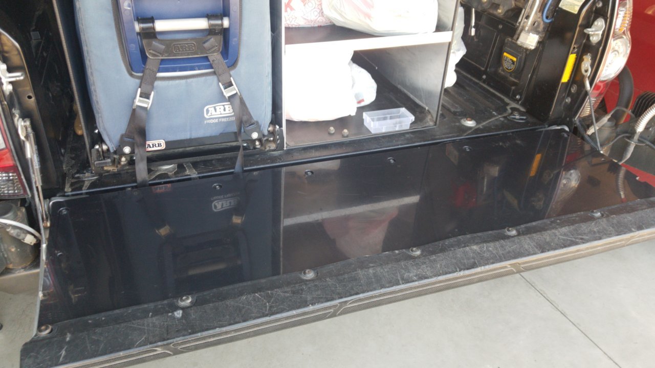

    Build and installed a HDPE plastic tail gate liner for more comfort sitting on the tailgate and to have a flat working surface when camping.

    by the lack of logos you probably saved yourself $200 as well! nice work, looks great

    Yes, pretty much true. The material including shipping cost me $75 + 2h of my time for work.

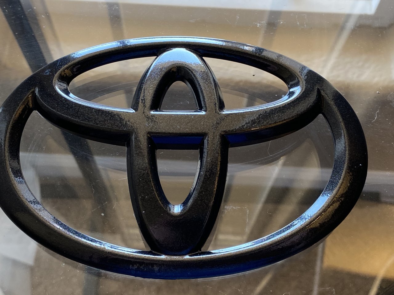

    It doesn’t. I used about 3 thin coats of primer and paint

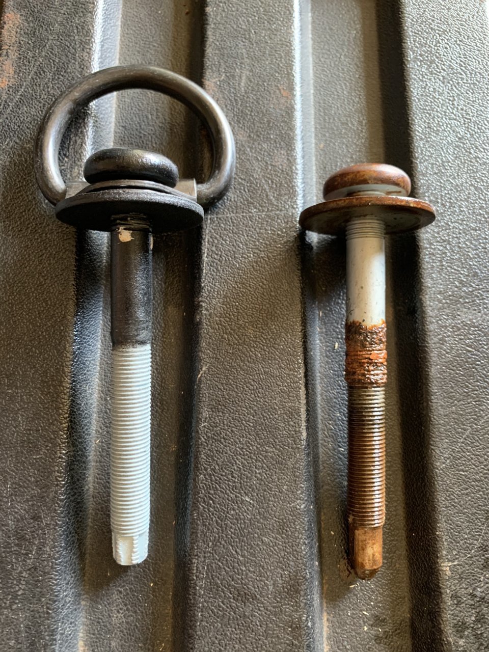

    D-Rings are for a Dodge Sprinter: 5170492AA
    I added 4 of these to those very bolts as well

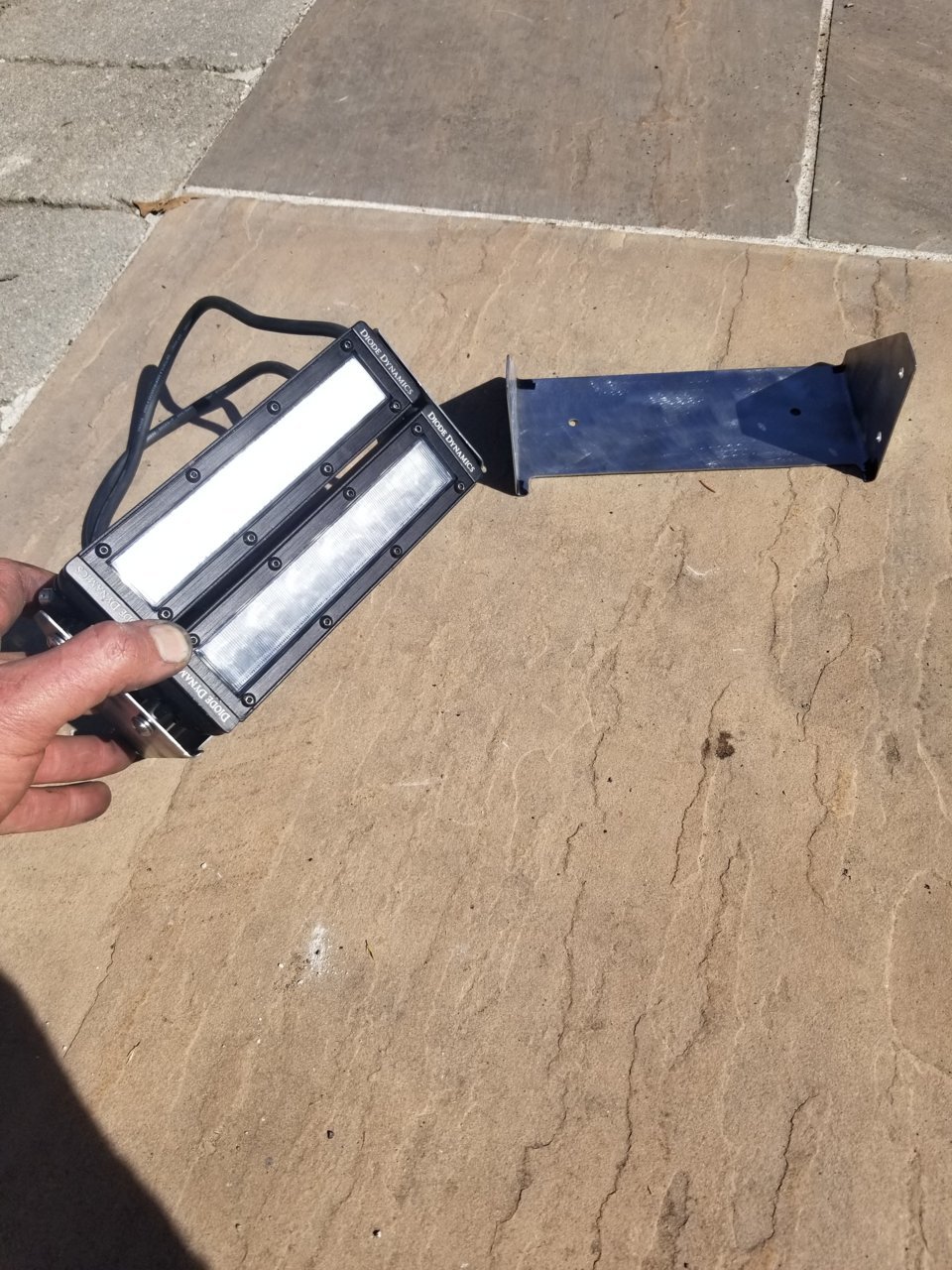

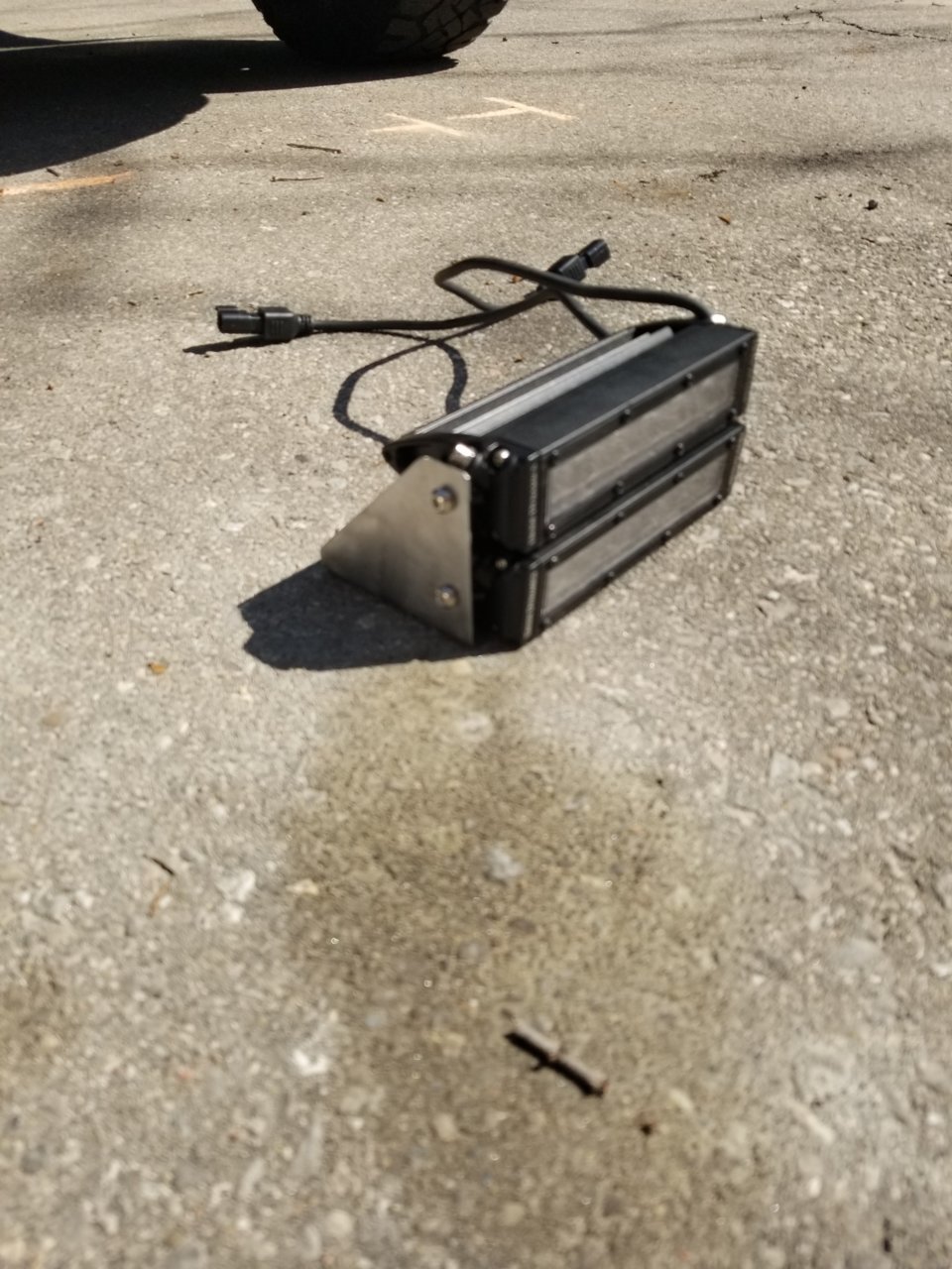

    Designed these brackets in SolidWorks and then made 2x by hand. Turned out pretty good. Need to paint. Was going to weld to front receiver but decided I will tap front receiver M6 instead and bolt on. 18 gauge.
    Will be 1x DRIVING and 1x WIDE Diode Dynamics SS6 each side when done.

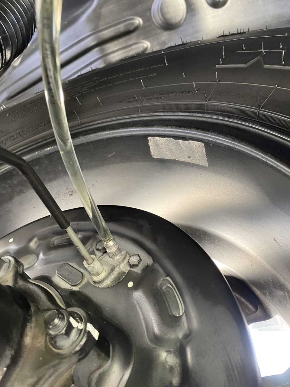

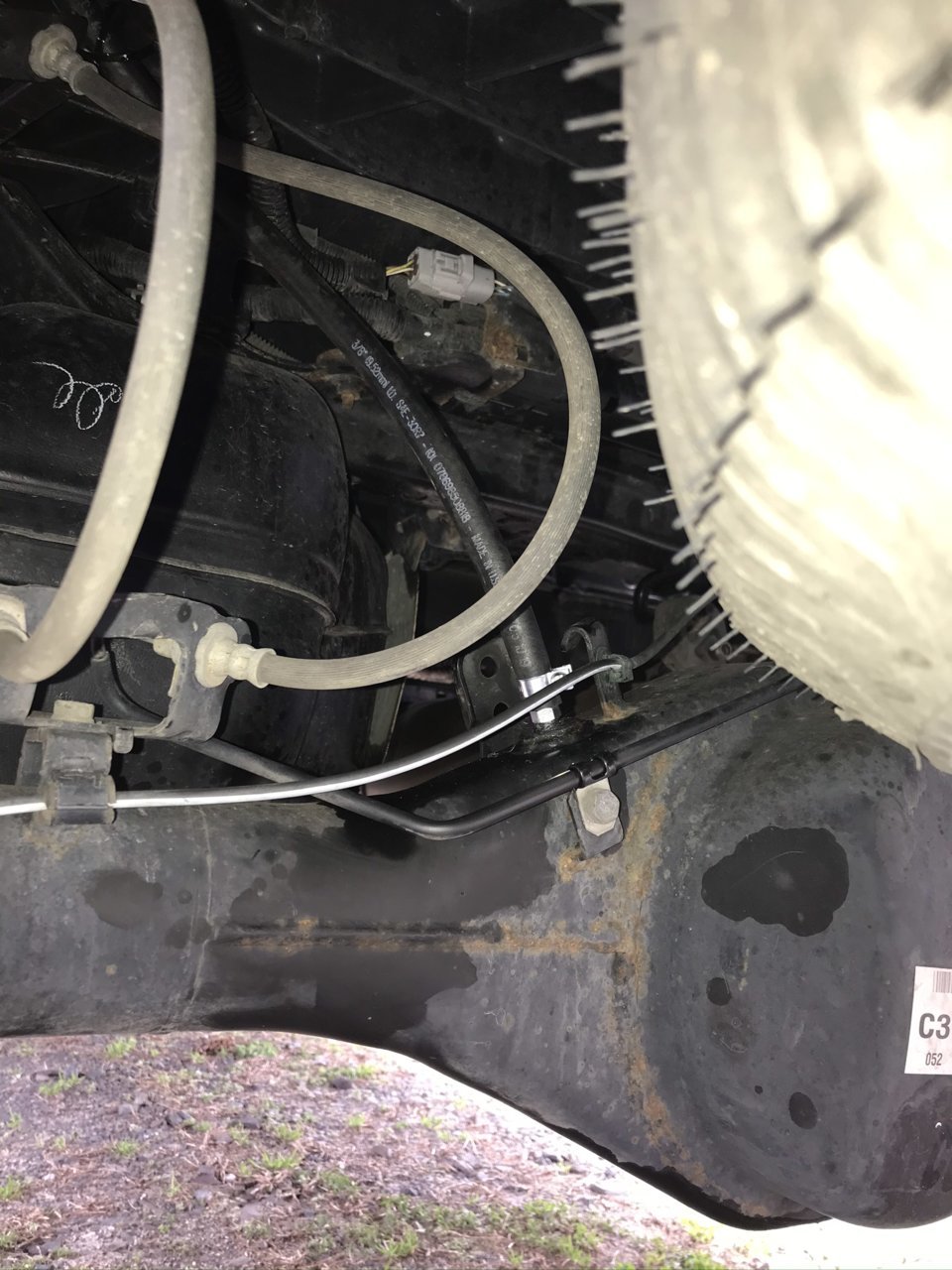

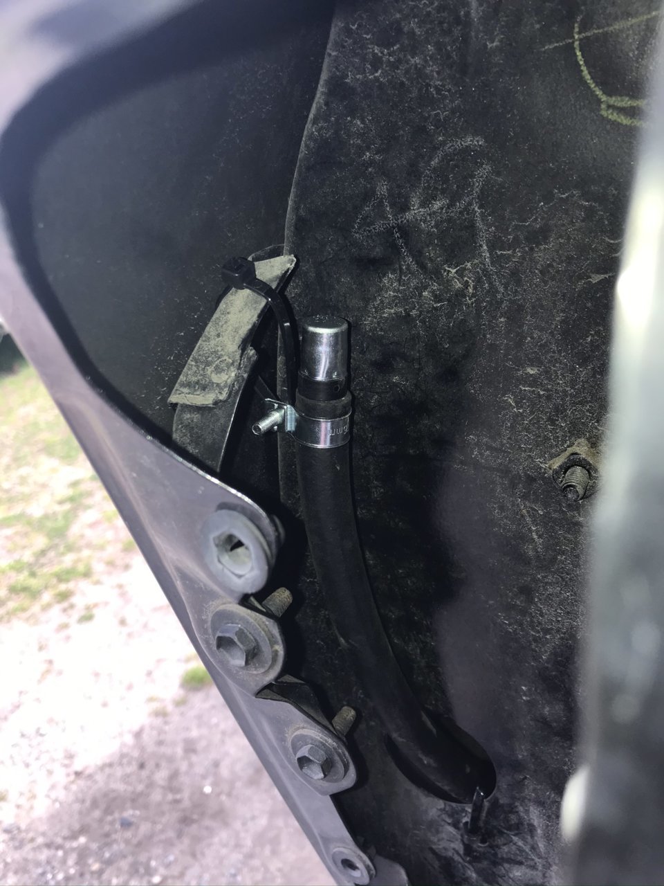

    Rear diff breather taillight relocation

    Is it me or does that line need a little more slack ?

    The breather line? It’s snug, but there’s no kinks in the line.

    Ah, that’s right, forgot about that. Thanks good catch, I’ll slack it up a bit.
