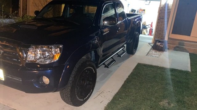

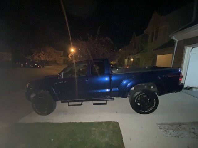

    Got my Bilstein 5100 today threw them in the front to try and level out. Kinda dark rn but will see tomorrow

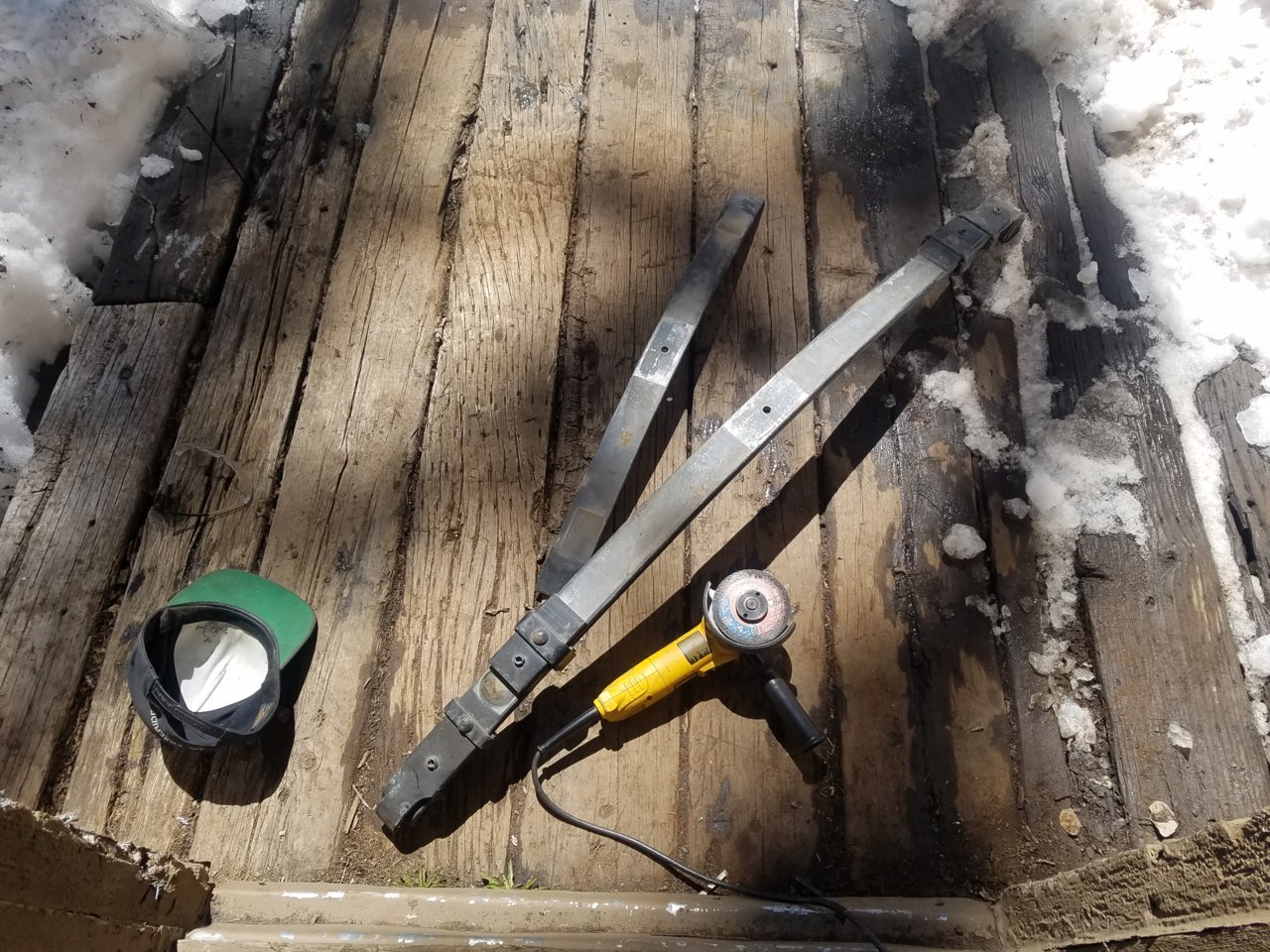

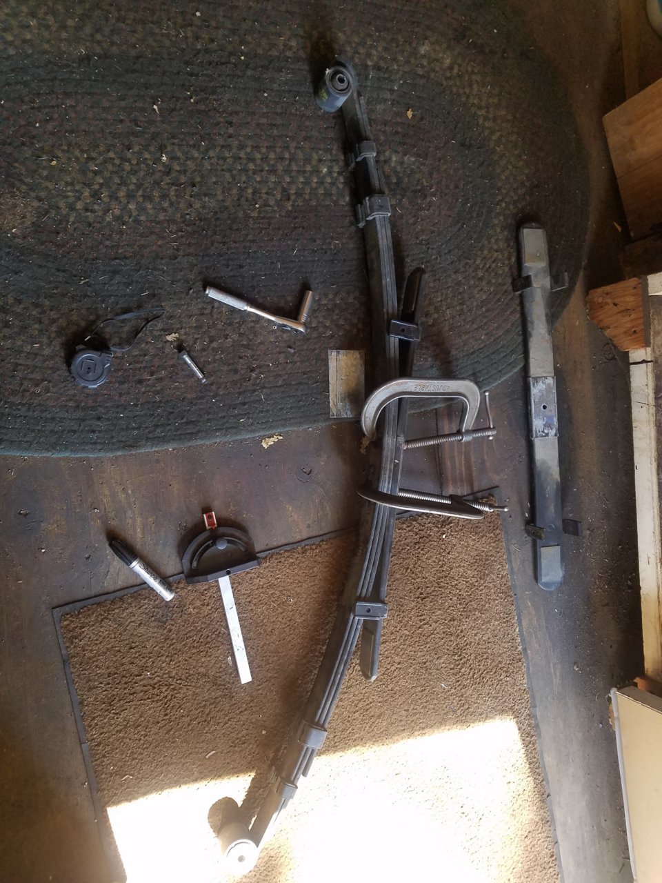

    Last year I put some 2019 TRD Sport suspension on my wife's 2006 Sport. It rides way better than what it replaced. With the new TRD kit, the front end was lifted about an inch. As for the rear, I never really liked the ride with the recall springs (sagged quick and it often bounces off the bumpstops when geared up), so....I had my stock 2014 leaf springs on CL for sale the last year with zero bites that were just taking up space in the shop. I figured, instead of spending $115+ on an add-a-leaf, I would just cut up my 2014 pack and do some trial and error testing with a DIY add-a-leaf (this wasn't my first time doing this).
    Each stock leaf is 5" shorter both front and rear than the next bigger leaf, so I made some cuts where my add-a-leaf would have a 5" shorter taper. I can always cut more later so figured this was a good place to start.

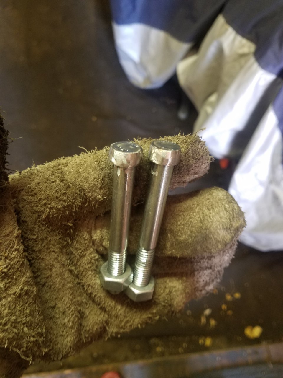

    Ground down some 8.8 hardware for longer locating pins.
    I had some Wheelers 1/2" spacers in the shop from my previous OME lift on my 2014 truck so decided to install those on the front. Then painted up the leafs and tore things down on the rear while the paint was drying. I thought about drilling holes in the springs to add the anti-friction washers but figured drilling spring steel wasn't gonna be easy so decided against it. Figured I'd add grease instead.

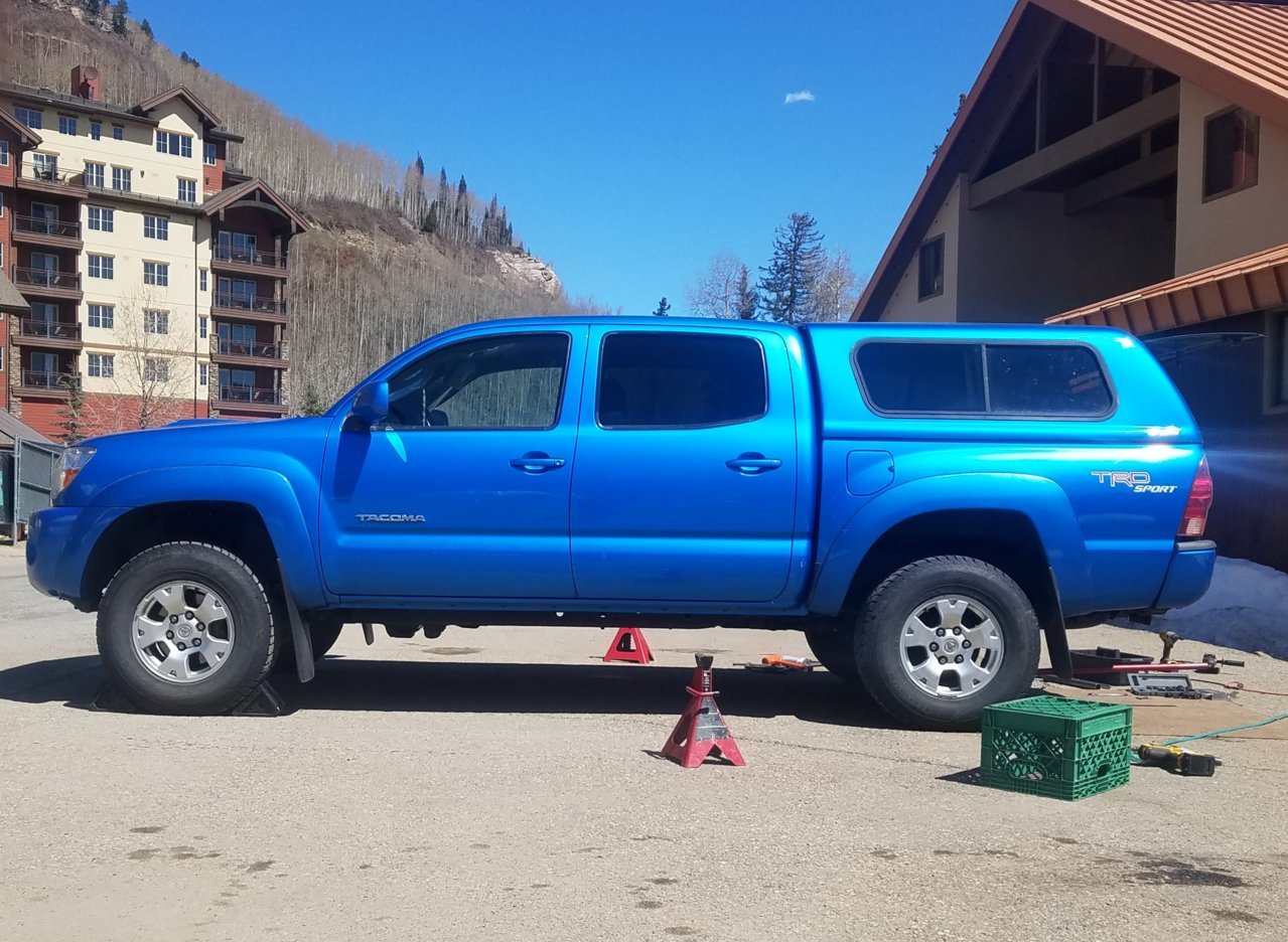

    No pics of the tear down and install but here's a before and an after about 2" later.

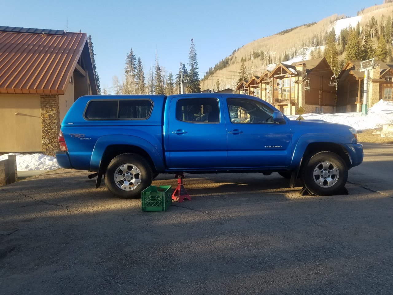

    And the After (rear sits about 1/2" higher but will wait for to see if it settles before I mess with it again).
    Stoked to have done this with parts I had laying around in the shop. Now I can mount my truck's 275 70 R17 on her 17" Sport wheels (pictured are the winter pizza cutters) and I can go up to a 33..my motivation all along!!!

    And PS...it rides great. Rear is firm but compliant and doesn't limit twist or up-travel.
