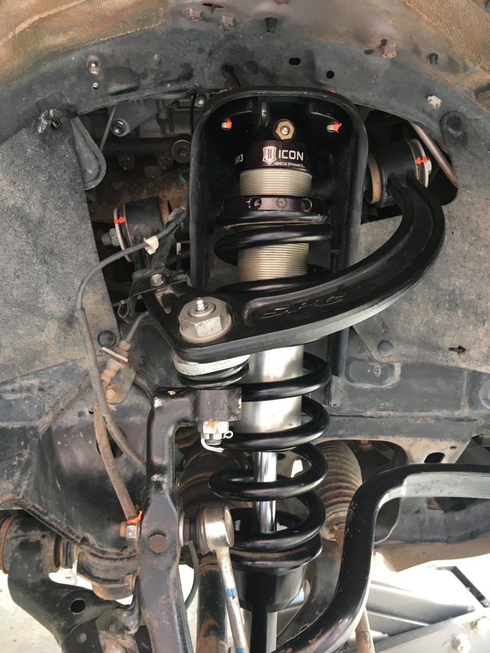

    Adjusted the pre-load while I had it up on stands, I notice a little bit of difference.
    Before & After pics

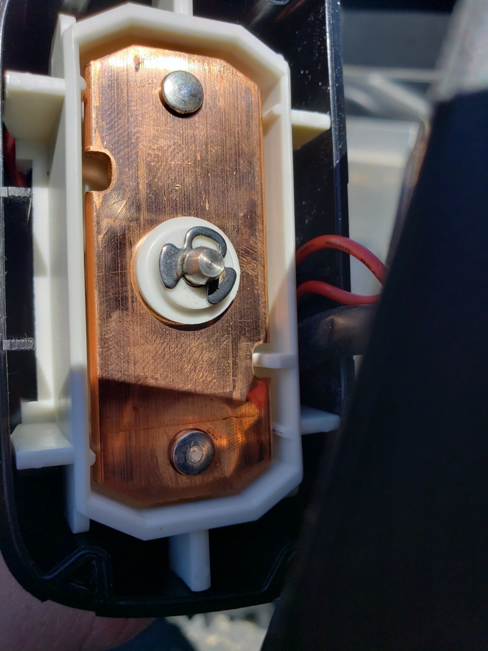

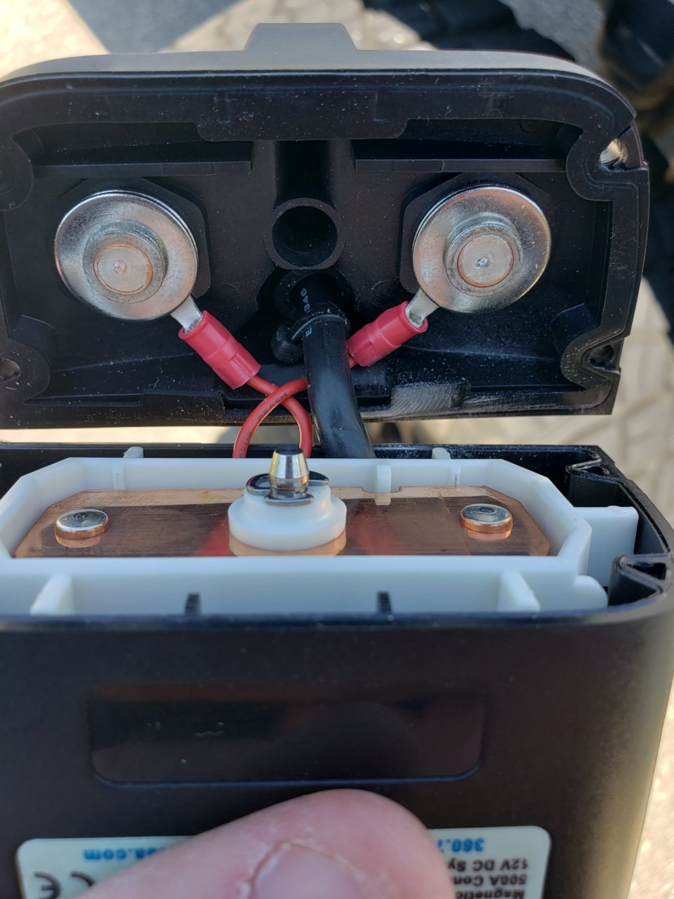

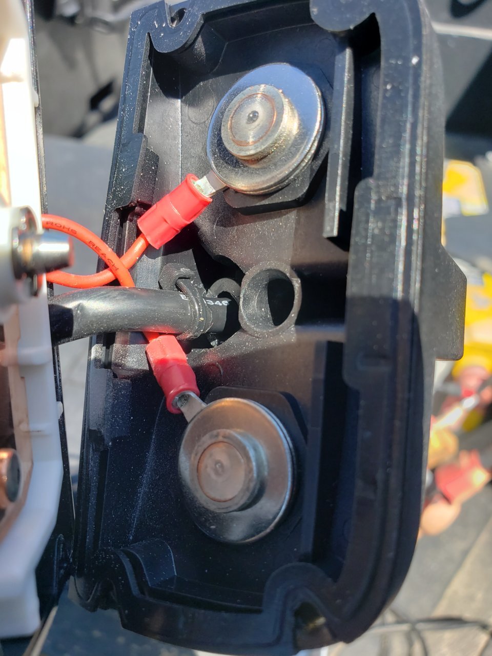

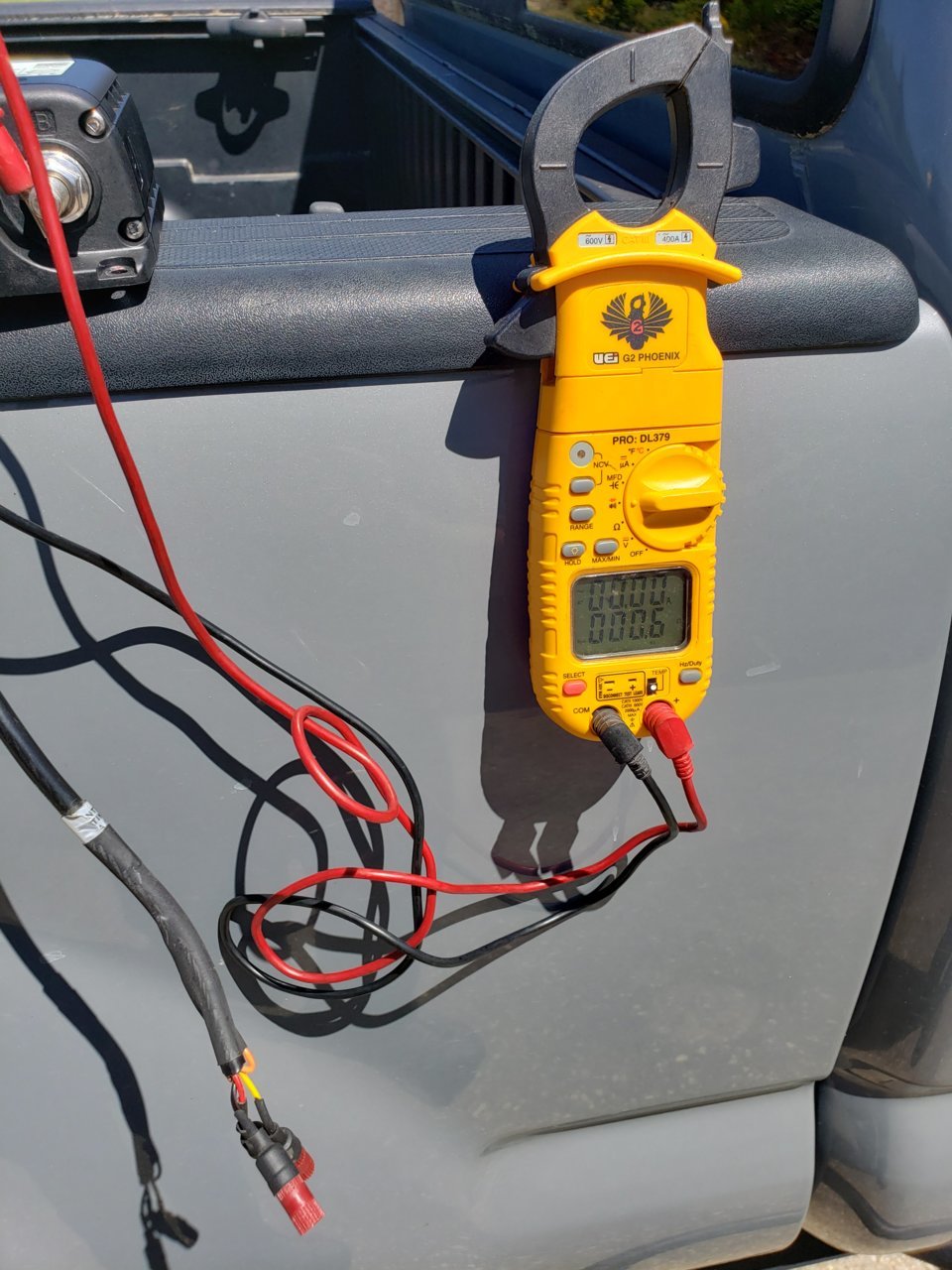

    So my ML ACR stopped working using the remote switch about 2 months ago. My batteries wouldn't link and the switch would double blink saying there was a failure. I didnt want to spend another $170 on a replacement so I opened up the ACR and grabbed the multimeter.
    Prior to opening it, with the latching switch depressed, I got 3.6 ohms of resistance across A and B terminals. Not horrible, but I wanted to see if resistance had anything to do with the remote function not working.
    Bottom and top contractors
    I grabbed some 2000G sandpaper and went at the contacts to smooth out the high spots and rough areas caused by arcing.
    0.6 ohms post sanding and reassembly.
    It works now. Coincidence? I dunno. I'll see how long this lasts.

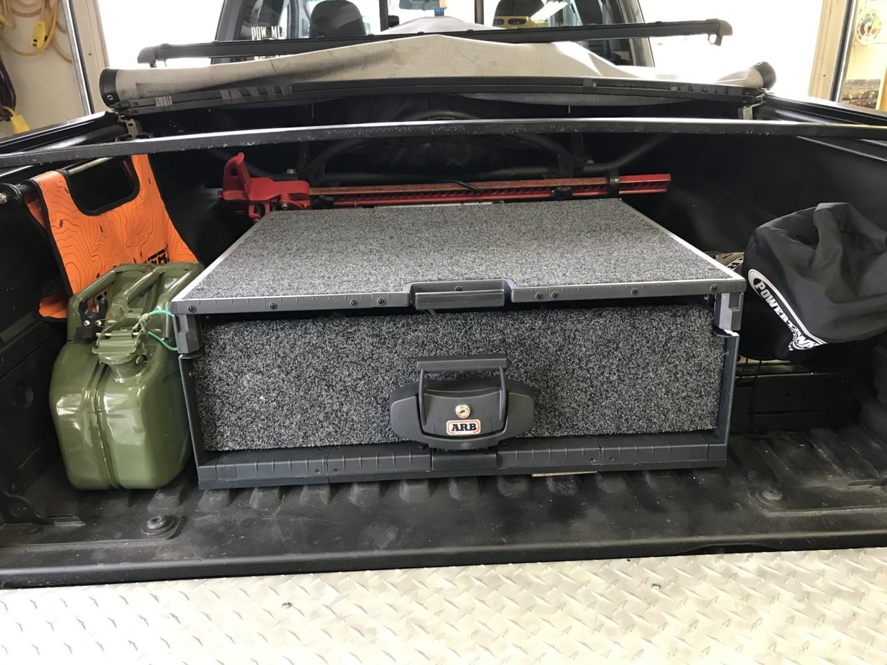

    not cheap but I have an ARB meant for a JK jeep, but it fits perfect with my tire carrier etc....well made, was an ez install, works well.. I have a slider on the top with my air system.. both drawer and slider lock open so if ur on a hill they stay...

    no not a co inky dinky... a new mech relay closed should read aprox 0.2 Ohmn across the relay......so ur reading was indicitive of an issue, good trouble shooting....
    in the 70's elevators were all mech relay controlled and every tech carried on of these..https://www.grainger.com/product/23...wcid=AL!2966!3!281698275348!!!g!470161363430!
    and checked the most used relays on every service call, and did a fast clean of the pads....(and many other controllers as well)

    Right on. I didn't know what the standard resistance was for a closed relay. Never bothered to check. Thanks for validating my suspicion :thumbsup:
    I might pick up a pocket burnisher. It exists for a reason. Thanks Bill
